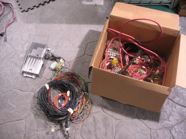

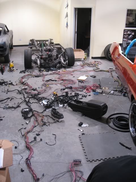

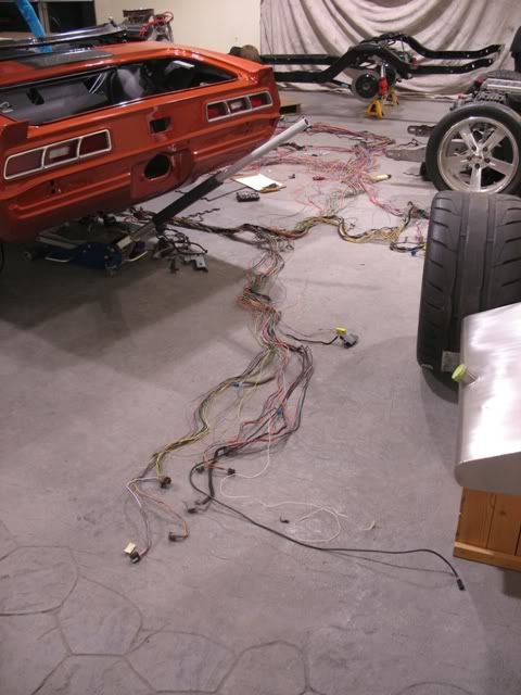

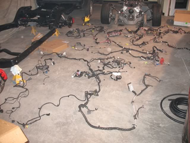

Here is some wiring nightmares for you. Our RS-V camaro has a 2009 Cadillac CTS-V dash, so naturally we need most of the Cadillac body harness and the mess that follows it. Once we laid it all out, we could start to eliminate hundreds of useless circuits. I will let you know how it goes.....I have as much documents as possible from GM on the electrical system, but I have my fingers crossed!
http://i1204.photobucket.com/albums/...iringstart.jpg
http://i1204.photobucket.com/albums/...ro/wiring1.jpg
This harness takes up more space than the car itself!!

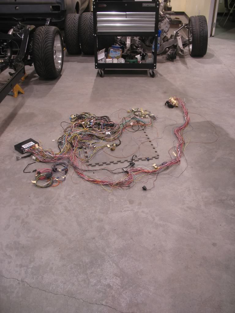

http://i1204.photobucket.com/albums/...ro/wiring2.jpg
This is what we have deleted so far...... it looks like alot until you look at the rest of it!
http://i1204.photobucket.com/albums/...gdeletions.jpg

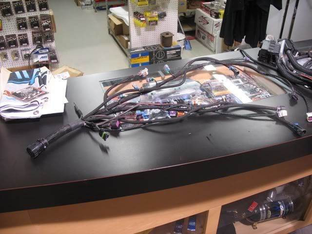

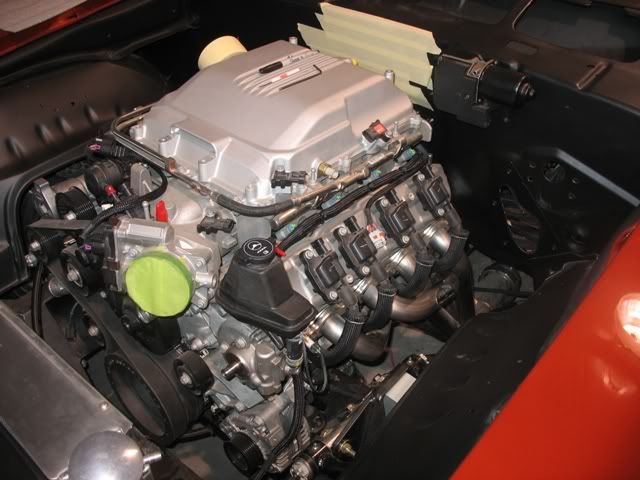

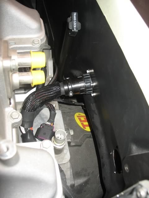

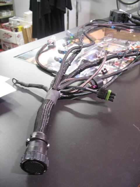

Here is a Mast Motorsports engine harness that we cut up and rerouted around the motor.... we use AMP connectors at the firewall for all the signal wires, and a 22 port weatherpack under the fender for all the power wires. The end result is a pretty clean engine bay, and once we finish our cnc'd coil cover/faux valve covers you wont see much for wiring.
I thought those AMP connectors would be a nice option until I had to buy a bunch of overpriced crimpers!! But its really nice to have a huge selection of crimping tools. I hate those cheap insulated terminals that get used too much! We hooked up a great deal on weatherpaks too, so all our plugs are nice! I also have a huge selection of the expandable sleeving and split sleeving, which finishes off the wires nice!
http://i1204.photobucket.com/albums/...essreroute.jpg
http://i1204.photobucket.com/albums/...streroute2.jpg
A couple leads are still hanging on the motor, like the o2 and lower sensors, still have to plug them in and clamp the wires down nicely
http://i1204.photobucket.com/albums/...stharness3.jpg

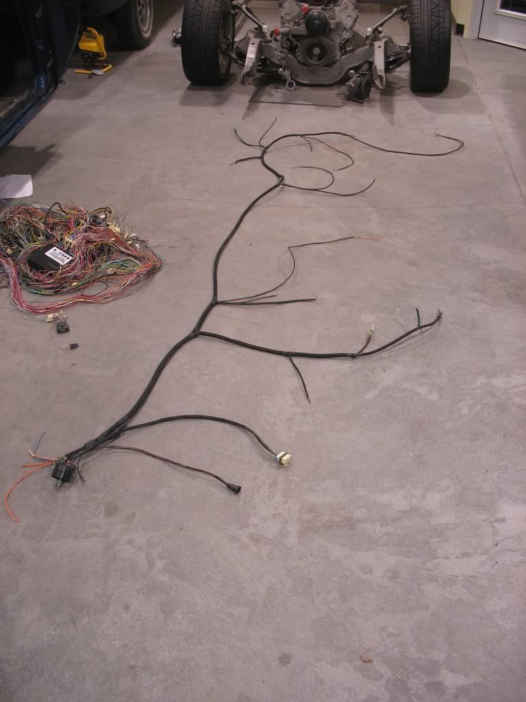

Got the ctsv harness down to the bare essentials!
http://i1204.photobucket.com/albums/...svremnants.jpg
And this is what it gets finished to as it goes in piece by piece, in sleeving and heat shrink.
