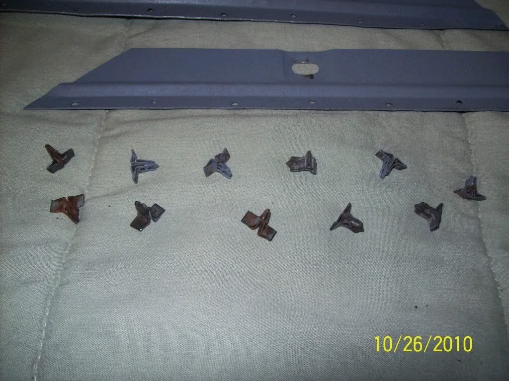

Im looking for these fastener clips(69 camaro) to attach the headlliner retainers to the roof. If these are no longer available Im curious what you have used. Thanks Rich
http://i168.photobucket.com/albums/u188/ragtp/clips.jpg

Drill a 1/8 hole right next to the clip hole and rivet.

Thanks for the rivet idea, I ended up buying a monster rivet tool with two foot handles. Used 1/4 alluminum rivets with a 3/8 dia. head. They fit in the existing holes in the roof with a slight reaming. Worked out nice.
Have a great New Year- Thanks again Rich
