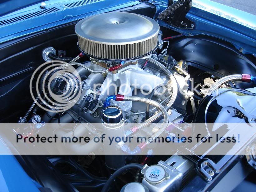

In the car with all the gingerbread on it:
http://i394.photobucket.com/albums/p...e/ls1rtsde.jpg
I'm so stoked and ready to see what it'll do. The swap should also make the Del Mar trip a blast. Hopefully I don't get into too much trouble at the autocross for the drag radials again. Thanks for looking, Dave

Nice set up. Looks a lot like mine. What brand catch can are you using?
NOPANTS68 01-27-2011 07:23 PM
Thanks, I think it's a Steff's.

Cris@JCG 01-28-2011 07:24 AM
Very nice!! Intrested in cover that you used for wiring harness on the firewall..

NOPANTS68 01-28-2011 10:36 AM
that's a little bulkhead a buddy machined for me that has a snout that holds the harness through the firewall. It's a two piece design that clamshells around the harness.
