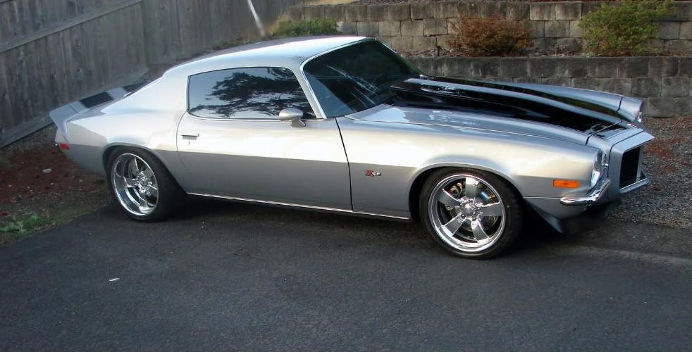

JayR 02-01-2011 04:00 PM
Here's one we put shoes on. This is our Fuel wheel which is a simple classic 5 spoke but not the same old 5 spoke.
http://i256.photobucket.com/albums/h...s/DSC06934.jpg
