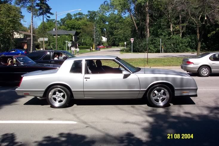

Welcome to the site! Glad to see another g-body on here. I have a 87 Monte Carlo ss done G-Machine style, it has a lot of supension upgades done to it, So if you have any questions feel free to ask! :thumbsup:

Bishop_007 01-17-2006 11:31 PM
YES! That's what I'm talking about! I LLLLike that!
Are you running discs in the back?
Did you go with tubular control arms, in either front or back?
Shocks or airbags?
Transmission?
Rear end gearing?
Exhaust header set up?
I plan to have an 8pt roll cage, 5pt harness, 20gal fuel cell, 383sb 450+HP, tubular control arms, drop spindles, possibly air bag it, fiberglass dash and console, fiberglass deck lid and hood, lexan windshield and rear window, vent the opera windows (replacing the glass) and run torque thrust II rims. I want to make it as light as possible and still be able to run it through the autocross.
I'm also looking at the Strange Engineering complete rear end package w/discs. So I've got a loooooong road ahead for sure.
McssGmachine 01-18-2006 07:39 AM
Thanks for the compliment! Now to answer your questions.
No rear disc yet, but getting the bear track system in a few months.
Yes,I have tubular UCA's from hotckis in the front and Currietrac in the rear
I use edelbrock IAS shocks, That work pretty good for what they are.
I use an automatic 2004r that built, but i want to get a manual.
The rear end is from a GN it has 3.73 gears in it.
The headers are hookers 1 5/8 with 3" exhaust all the why back.
Here let me give you some advice on your front supension setup. I have the b-body spindle swap and it handles great, but the system has alot of bumpsteer in it. I would go with the G5 setup from SC&C talk to marcus he's on this site great guy to talk to. if you have any more questions just ask . :thumbsup:
