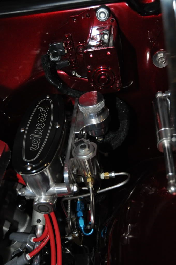

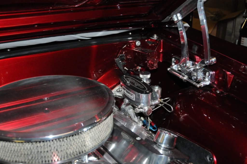

Does anybody have any good advice concerning this? Here's a pic of the engine compartment
http://i297.photobucket.com/albums/m...s/DSC_4884.jpg
http://i297.photobucket.com/albums/m...s/DSC_4885.jpg

Anyway, got my gauge back, so this weekend I'm measuring actual line pressure and stroke length on the car. I did talk to both wilwood and carbotech today. The one thing wilwood brought up was that I have one piece of 1/4" line on the car, between the prop valve and the rear "t" above the diff. While that wouldn't affect the front, they said it could impact the rear (though I'm not in total agreement). I also mentioned the 3/4" bore master, and they weren't wildly supportive. Who knows. I need to do some measuring first.
