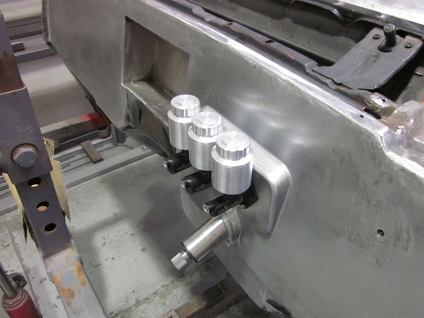

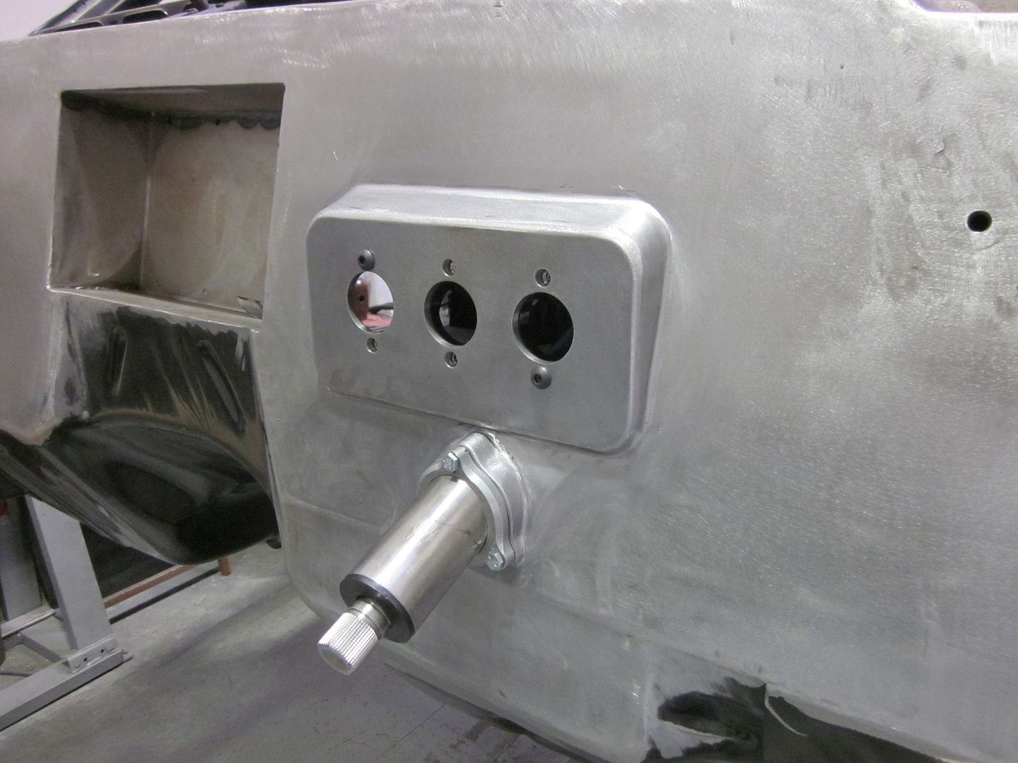

We have been a bit behind on Greg's Chevelle.. but should be ready next week.. So, I call him yesterday & tell him that I have an idea on the firewall which we completely have re-done except for the coil box in the center.. The firewall was flatten out & sits in a angle.. we needed to get the master cylinders sitting level in the engine compartment.. Machined a plate for the Wilwood triple master cylinders with a radius on the edges.. with a steel plate that conforms to my firewall cover..
Greg- This is what happens when you tell me that I trust to dowhat ever you want on the firewall :D
