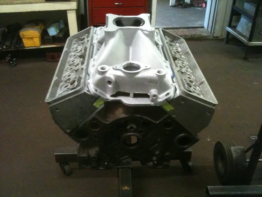

Engine went together..
http://i230.photobucket.com/albums/e...2715007_o1.jpg
