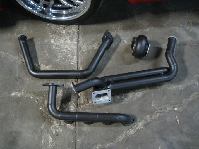

Can we see some of the turbo piping? Cold side and hot side pics would be great.

ya heres the turbo piping.. it was all custom made and with how tight it was in there this was are only resort with keeping the clean, stock look i know its not the best way to make the most power but with the look i wanted i wasnt looking for 1000hp or anything. its all sch 10 stainless. it spools very quick and has a great range i wanted a/c and the power steering where it is.. we didnt have to notch the frame or anything..

Piping looks clean!
Did you use a 2 1/4" or 2 1/2" pipe for the crossover? Do you have any pics from underneath the car? I curious how close you routed that crossover pipe to the trans?
You did one hell of a job! :thumbsup:

i believe the piping is 2 inch and its about an 1inch or so from the tranny i'll have to get some pictures of underneath
