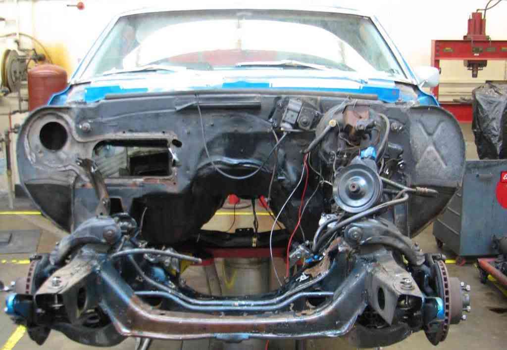

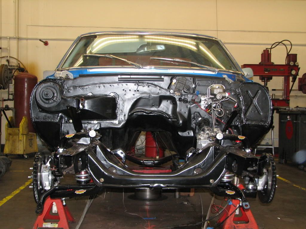

I had pretty good luck with Por-15 and their chassis black paint and brushing it on with 25c foam brushes from Osh.
Before:
http://i328.photobucket.com/albums/l...e_After001.jpg
After:
http://i328.photobucket.com/albums/l...e_After002.jpg

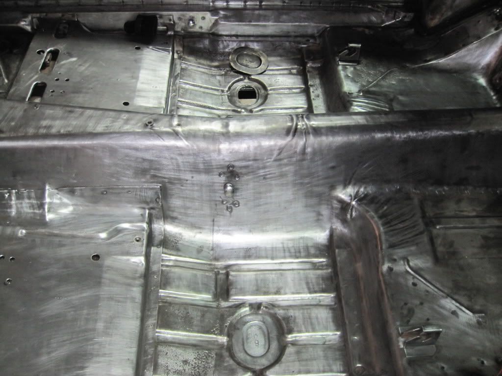

Just did my interior floors as well:
http://i328.photobucket.com/albums/l...orFloor014.jpg
(Before shot)
http://i328.photobucket.com/albums/l...orFloor002.jpg

For the do it yourself guy w/o access to a good air system and spray gun, Por-15 is a nice alternative (can also be sprayed).
One thing thou prep is key and killer don't bother if you aren't going to follow the directions to the letter and make sure everything is perfectly clean. The slightest grease and it will peel off in sheets. Nice thing thou when done right its bullet proof similar to powder coat. Solvents and hammering on it won't phase it.
Another option might be Eastwood's Rust Encapsulator and Extreme Chassis Black in aerosol had good luck with small parts done up that way.

With Por-15 I think its less to do with a smooth surface and more to do with not being completely clean. My engine block was the first item I used Por-15 with and I had to redo around the oil gallery plugs as there was some grease that leaked out which resulted in Por-15 coming off in patches. Once I recleaned and repainted it was fine.
I had no issue with Por-15 sticking to my floors and they were pretty smooth (though roughed up with 240 grit)
http://i328.photobucket.com/albums/l...nterior006.jpg
But I spent weeks getting where I thought they were clean enough for por-15. Then used boiling hot water to reduce the Marine clean and a stiff wire brush several times to get any remaining grease off. In my experience you have to have the surface crazy clean or don't bother, since it will just come off in sheets.
