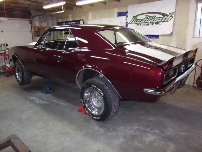

Here's a current project I we are doing now for a client in Wyoming. It's the typical story, he always wanted a Camaro- but once he bought it, he realized how bad a 40 year old car drives!
We are transforming it using the usual suspects- Speedtech, ATS, Rushforth Wheels, Hotchkis suspension, and Nitto tires
enjoy:D
the beginning
http://i250.photobucket.com/albums/g...225_main_f.jpg

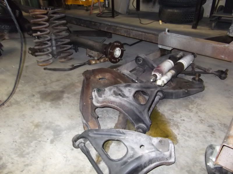

youthpastor 03-10-2011 11:28 AM

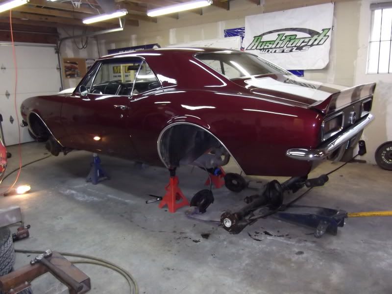

teardown
http://i250.photobucket.com/albums/g...Camaro/015.jpg
http://i250.photobucket.com/albums/g...Camaro/016.jpg

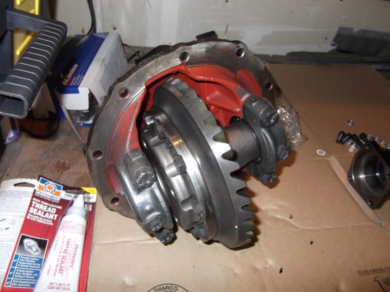

youthpastor 03-10-2011 11:29 AM

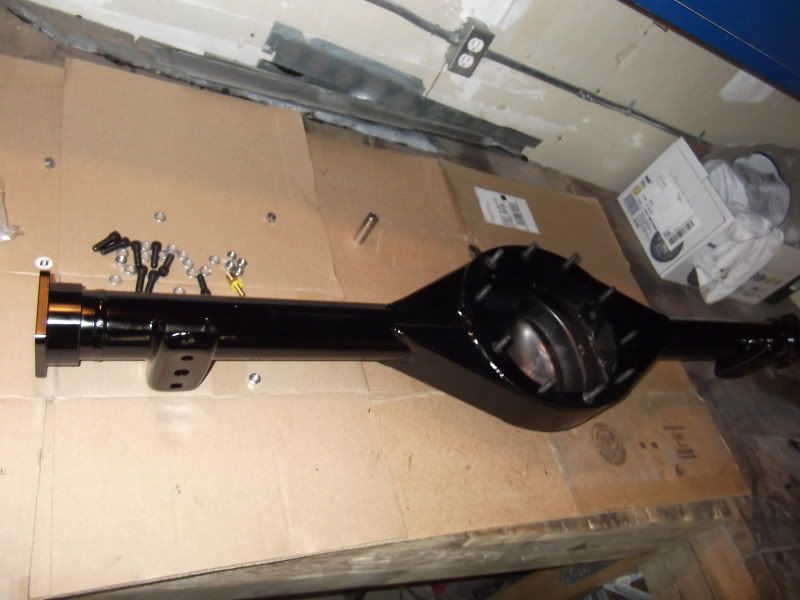

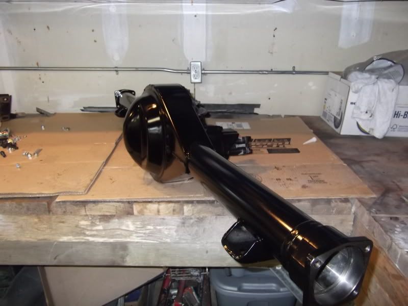

we are going with dropped leafs and a 9" with 4:11
http://i250.photobucket.com/albums/g...scamera007.jpg
http://i250.photobucket.com/albums/g...scamera008.jpg

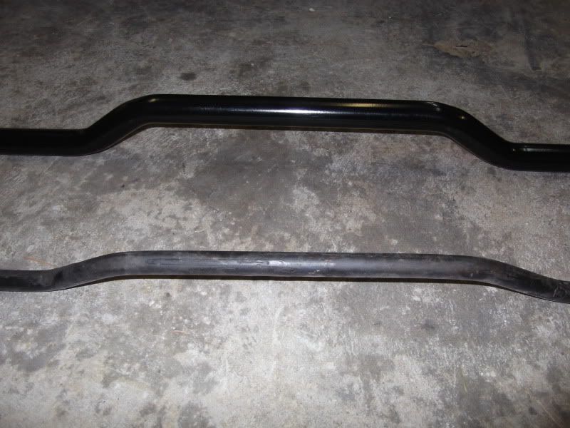

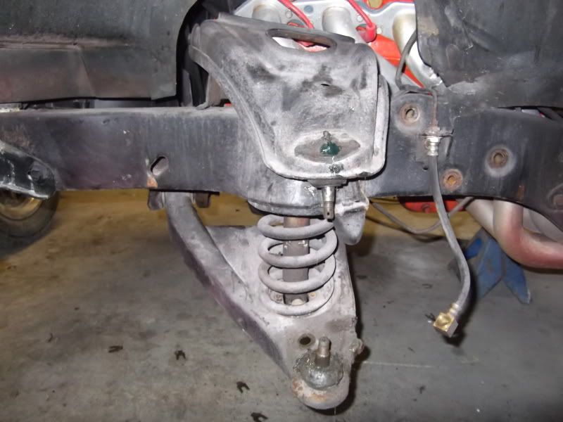

youthpastor 03-10-2011 11:32 AM

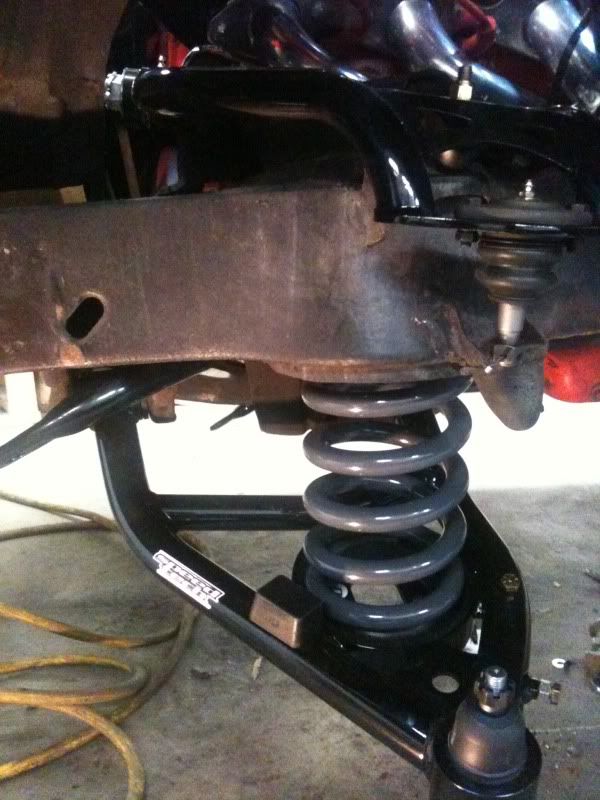

Front Suspension
http://i250.photobucket.com/albums/g...scamera013.jpg

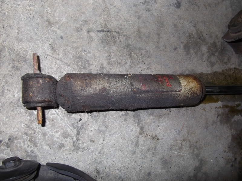

I don't think these were doing much
http://i250.photobucket.com/albums/g...scamera018.jpg
http://i250.photobucket.com/albums/g...scamera017.jpg

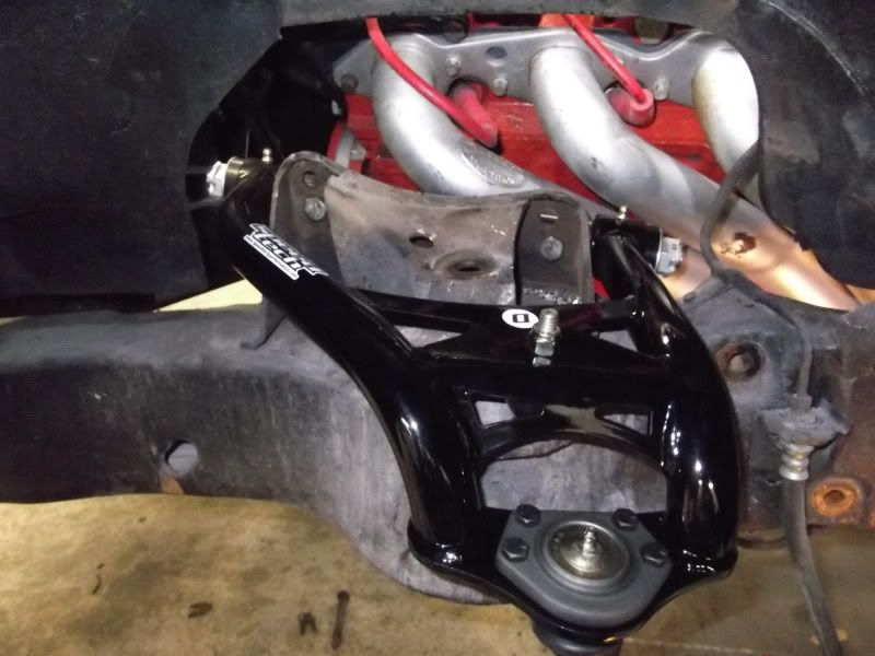

youthpastor 03-10-2011 11:33 AM

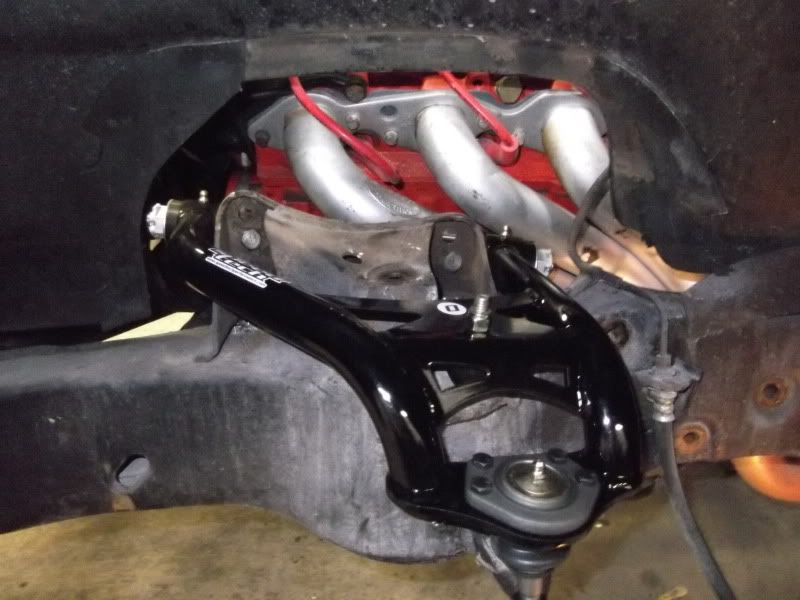

new Speedtech Arms with Gulstrand mod
http://i250.photobucket.com/albums/g...scamera021.jpg
http://i250.photobucket.com/albums/g...scamera022.jpg
http://i250.photobucket.com/albums/g...Camaro/022.jpg

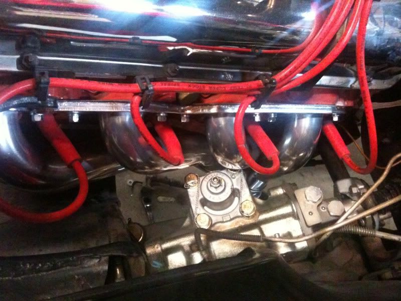

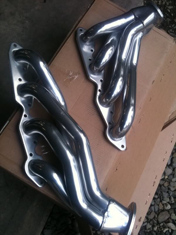

ATS box with new shorty Patriot headers
http://i250.photobucket.com/albums/g...Camaro/019.jpg
http://i250.photobucket.com/albums/g...amaro/0162.jpg
It was a 454, 5 speed, with a 10 bolt mono leaf, no power steering and brakes!

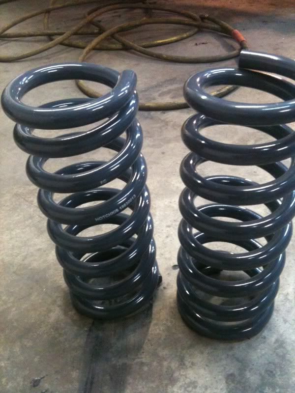

new springs, body bushings and steering

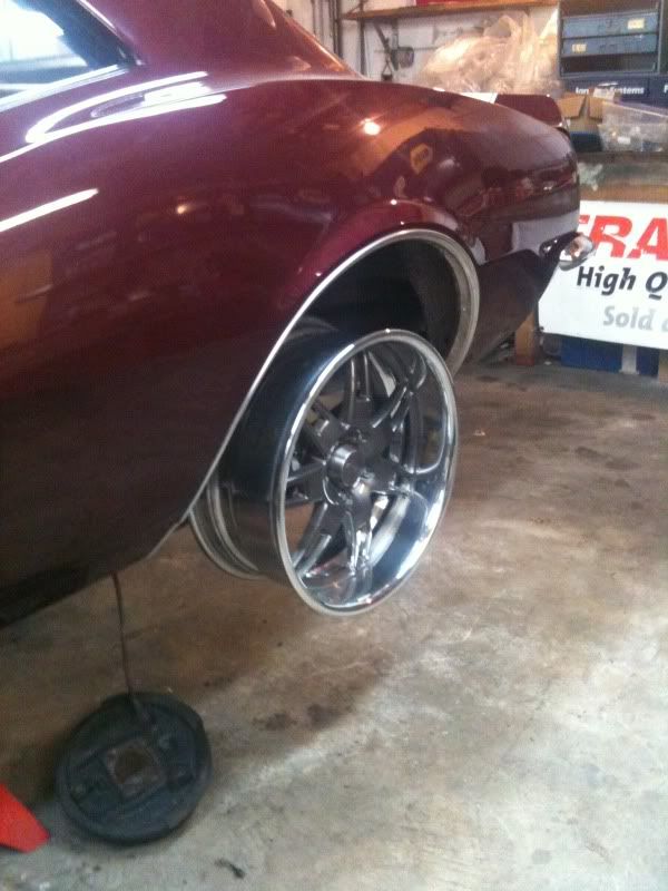

youthpastor 03-10-2011 11:40 AM

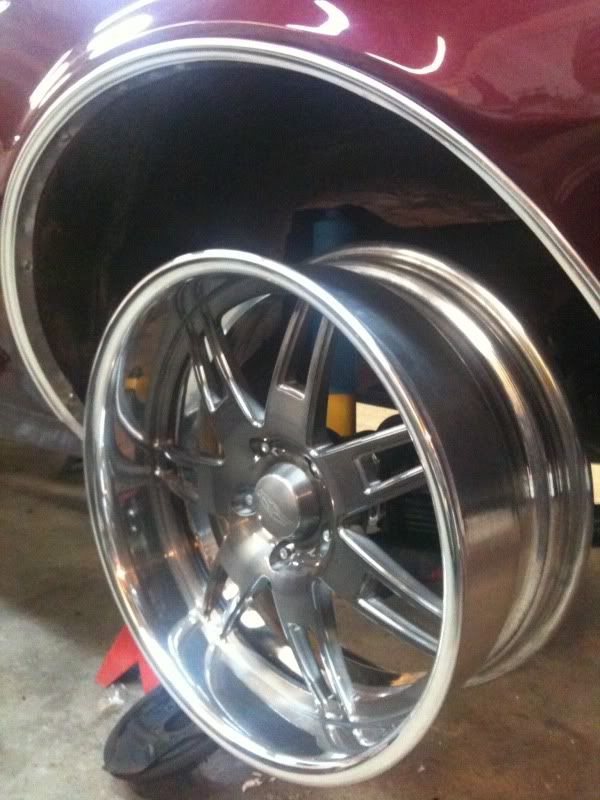

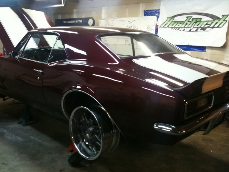

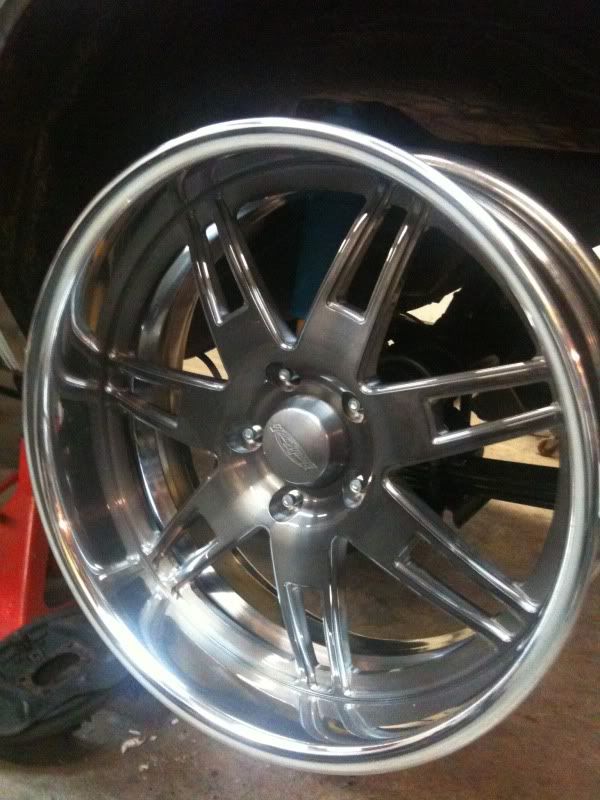

New 18's and 19's
Rushforth Whiplash!
http://i250.photobucket.com/albums/g...amaro/2015.jpg
http://i250.photobucket.com/albums/g...amaro/2014.jpghttp://i250.photobucket.com/albums/g...amaro/2016.jpg[IMG]http:http://i250.photobucket.com/albums/g...amaro/2009.jpg
