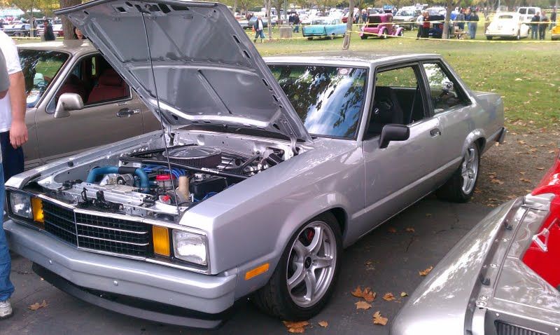

67XR7 06-06-2012 10:47 AM
check out this fairmont at 10:03 https://www.youtube.com/watch?v=_oU-j...eature=related
I'll upload pics of this car so you can see. it will def. encourage you to get yours going!
67XR7 06-06-2012 10:53 AM
heres pics of the car. all the carts were parked very close to each other so this is the best i could get:
http://i35.photobucket.com/albums/d1.../fairmont1.jpg
http://i35.photobucket.com/albums/d1.../fairmont2.jpg
http://i35.photobucket.com/albums/d1.../fairmont3.jpg
67XR7 06-06-2012 03:25 PM
this is true that if you intend to sell it the market will not be that great. BUT they are cheap and use fox body parts sooo building a nice budget car is very possible, and its different!
