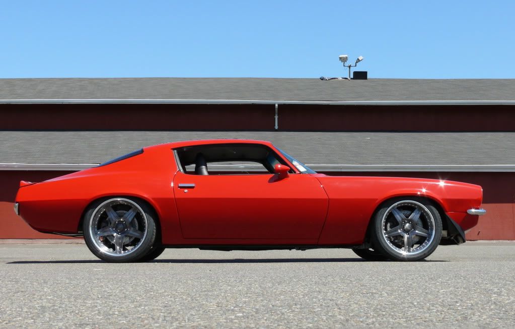

I think they'd look good on the back if the fitment was just right and sitting nice and low and even then, it's not for everyone but 20s up front are going to be a squeeze, especially with a basic off the shelf fitment. Here's a 2nd gen we put 19s and 20s on for you to see how the diameter looks but they were built for the car to fit just right which is one of the reasons he was able to nail this stance which is key for all cars but especially with big wheels. Otherwise, it's a Donk.
http://i256.photobucket.com/albums/h...s2010071-1.jpg

I figured I could get a 20" in the back but idk about the front I wish someone else has done it nice car by the way

Do you know what size tires are in the back?

275/35/20s fit fine. You can go a little bigger if you beat in the seatbelt pocket.
