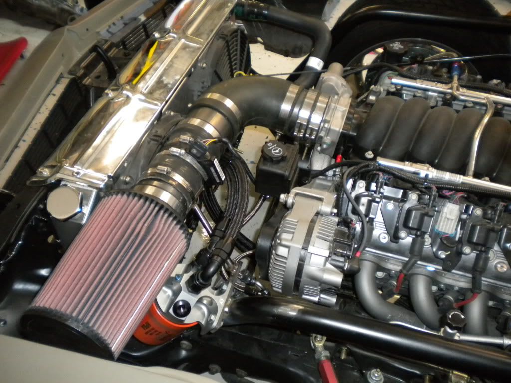

vinz68 03-24-2011 02:46 PM
Here's a pic of mine
[URL=http://img863.imageshack.us/i/img0733r.jpg/]http://img863.imageshack.us/img863/2504/img0733r.jpg[/URL
