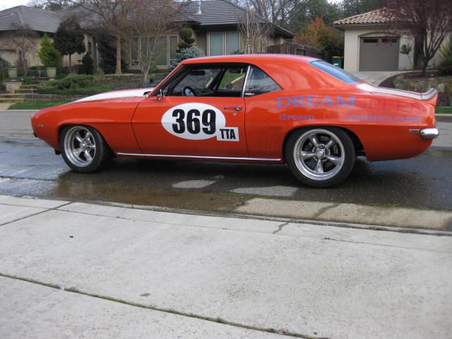

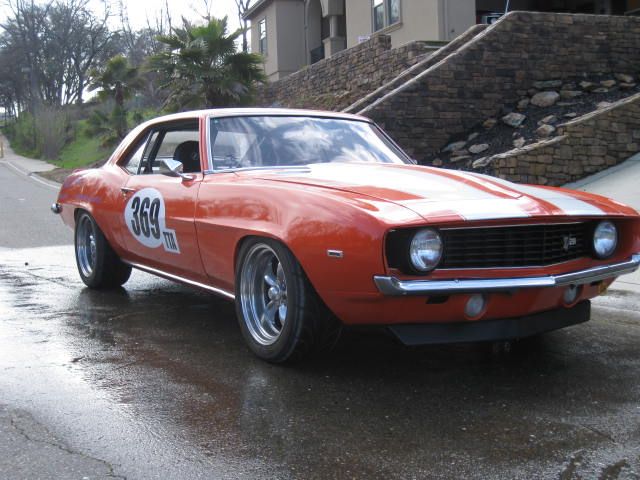

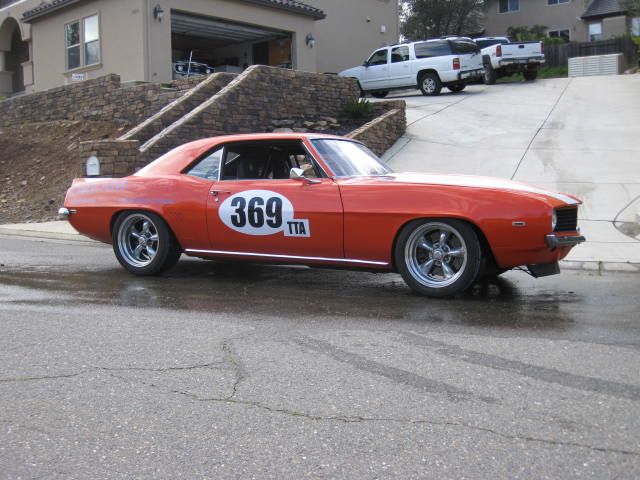

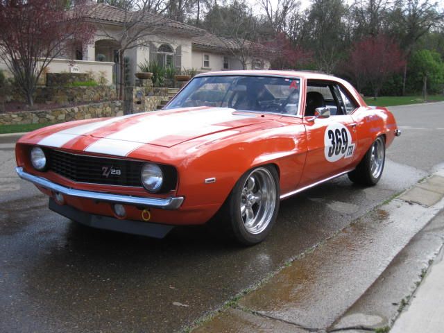

I just installed new wheels/tires would like opinions on stance. To me it's a little too raked. One question is the front too low or rear too high? Currently the rear is 25.25" fender lip to ground, front is 24.5. Car has older HO performance front springs and approx. 10 year old Global West -2" rears. I'm thinking the front is a little low.......1/2?
I have 1" blocks without spring pads in the rear and really don't want to go more than that if possible. I also have new DSE shock plates. This is somewhat temporary as my "present" future plan is SpeedTech's Track Time package......and proper brakes.
Body and paint work is last on my list, it's a driver I've owned 22 years and finally got rid of the wheels I never liked, next is the auto trans which is scheduled to be replaced with an RS600 in May.
http://sieg.smugmug.com/Cars/69-Cama...20_iqDij-M.jpg
http://sieg.smugmug.com/Cars/69-Cama...43_nUV8X-L.jpg
http://sieg.smugmug.com/Cars/69-Cama...28_4DqkX-L.jpg
http://sieg.smugmug.com/Cars/69-Cama...17_3eBzv-L.jpg
All input is appreciated.....except for comments on the colormatch of the doors. :D

Track Junky 03-28-2011 03:36 PM
I think the front stance looks good. I would definitely drop the rear. Direct side view looked good but lengthwise side view looked like the rear was a bit high. IIRC I think I am 23 1/4" to fender lip all the way around.
BTW, car looks great!

19,69camaro 03-28-2011 07:54 PM
First off your car looks great with the blacked out trim and vinyl top. I don't see many that dont look like a grandpa's camaro. As far as ride height is concerned i think with a 1/2 inch drop in the rear it would be spot on.

It those pics the car has about 10 gal. of fuel. The rear springs are very stiff so 5 gals/40 lbs isn't going to drop it much. I'm thinking .5" is money, .25 acceptable. The challenge is how to safely obtain that .5".

Blake Foster 03-28-2011 08:59 PM
i think it looks good
just change out the rear suspension with your "Present Plan"........... and it's all good.:unibrow:
if it was mine i woud go 1/2 to 3/4 front and back.
my .02 keep the change.
