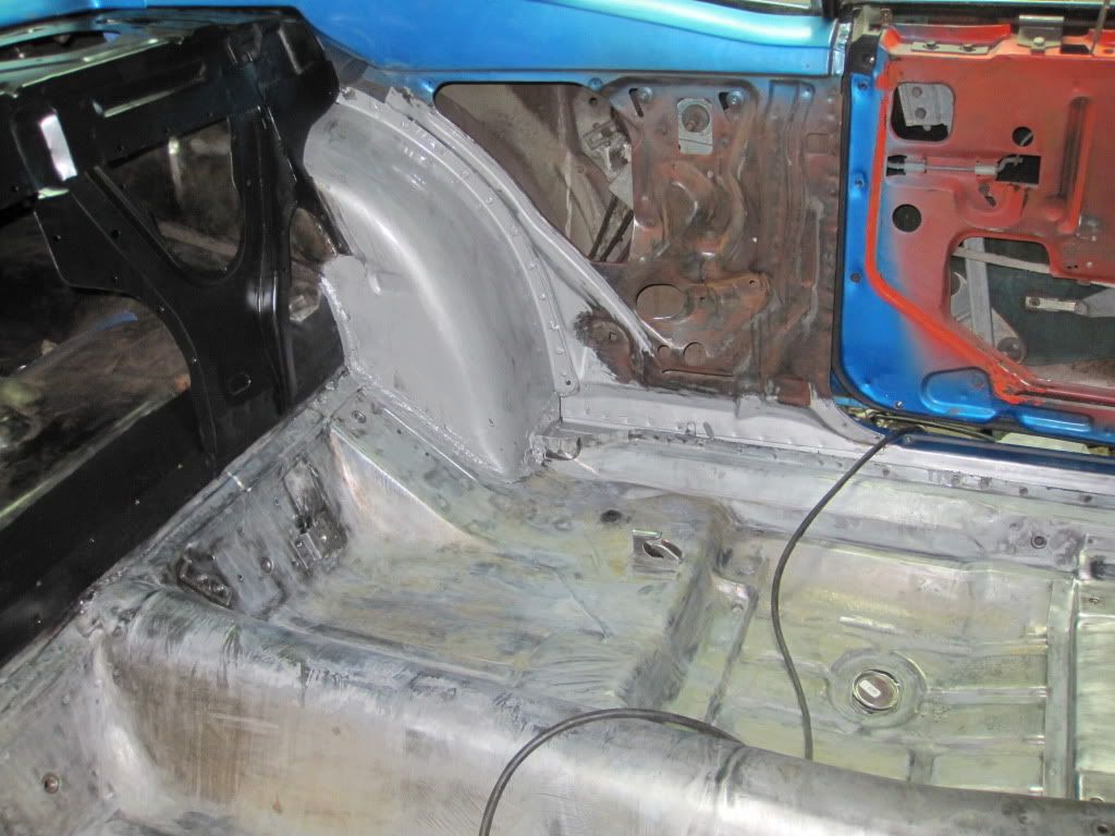

BBC69Camaro 04-05-2011 02:10 PM
Here is a pic of the seat back and seat floor hooks. Its a bit different on the seat back vs the seat floor. But hopefully you will see how you have to push first then kind of pull from the hooks. Sorry don't have a better pic of the hooks.
http://i328.photobucket.com/albums/l...nterior019.jpg
LowchevyII 04-05-2011 02:44 PM
good picture. those are exactly the brackets the nova has. my description was off a bit. been a while since i pulled my seat.
