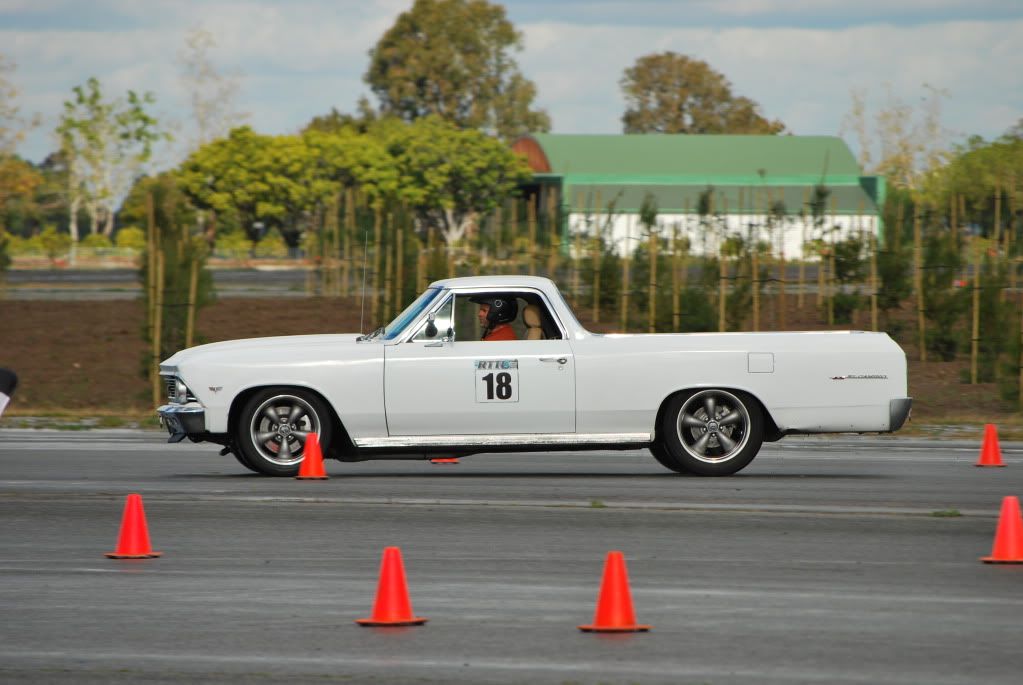

http://i1235.photobucket.com/albums/...a/DSC_0793.jpg
This car has exactly what you are asking about, with QA1 GMP kit. and 550 lb springs. as well as the complete rear kit.
here it has 18 and 20's
