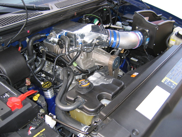

200 degrees? Damn. Do you have any pics of your enclosed setup? I did see the pics you have on your website. Who made the custom intake for the top of that blower?

Here's a pic. The top is open, but actually seals to the bottom of the hood. It drew air from the fenderwell, outside the engine compartment. The upper intake was a sheetmetal piece, can't remember who was making them.
http://www.camcojb.com/lightning/dante%20002.jpg
