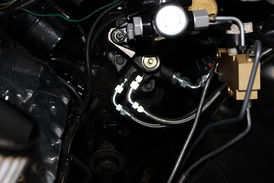

Currently the Hydroboost is in, and the new MC bench bled and hung. I am waiting on some fittings and lines to come in and then I can get started on the plumbing:

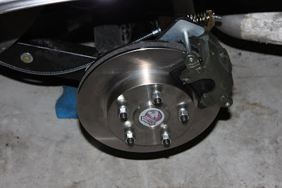

The rear disc kit is in, I just need to go back everything and torque it down. I also need to fill the rear end back up. I ended up going with a pretty basic kit for the time being as I still have 15" rally wheels. I am saving like crazy and can't wait to call Driverz inc. and put in my order. In the meantime this will be plenty and will get the car on the road in time for the few sunny days a year we get here in WA.

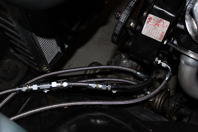

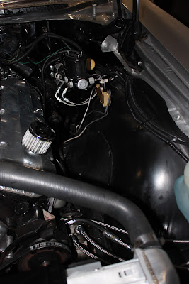

Finished all of the plumbing for the Hydroboost, even got the car on the road for a couple quick trips around the block. There is still some work to do on the braking..feels like I still have some air trapped in there somewhere either in the HB or in the brakes themselves.

Not 100% sure I am happy with how/where the lines turned out, I may try some things to clean them up a little more.

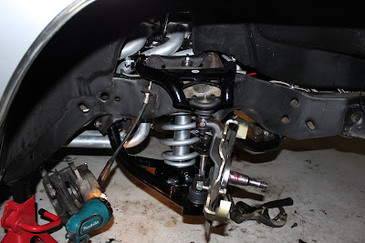

Finished up the speedtech UCA/LCA, QA1 coilover installed a couple of weeks ago and have just been enjoying the car. I still need to replace the stock steering linkage, but the ride quality is greatly improved. Even with my very crappy and old tires.
https://lh3.googleusercontent.com/_q...0/IMG_1072.JPG
I ordered and have been reading Mark Savitske's book on handling and I'm thinking about changing to the Howe Tall BJ's and keeping my stock spindle after new wheels and tires.
