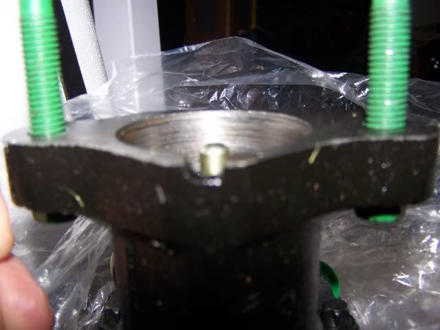

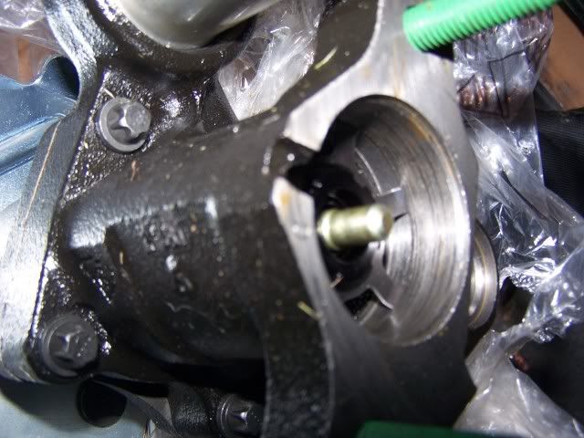

Is this Hydraboost for shallow or deep master "
Hi does this look like its for a shallow or deep master cylinder ? I'm thinking shallow.
http://i172.photobucket.com/albums/w...ictures144.jpg
http://i172.photobucket.com/albums/w...ictures143.jpg
Hydratech® 04-19-2011 02:57 PM
Lat-G family tech
Late / shallow, though it is a late model spec that is actually about .080" to long to work on a typical shallow MC style like the classic '77-'82 Vette MC, so you will have to buzz the tip of this rod carefully (or buzz the dimple in the backside of the MC) otherwise it will dramatically preload the MC pistons upon assembly...
waynieZ 04-19-2011 03:27 PM
Paul; Thank you very much, I appreciate the help.
