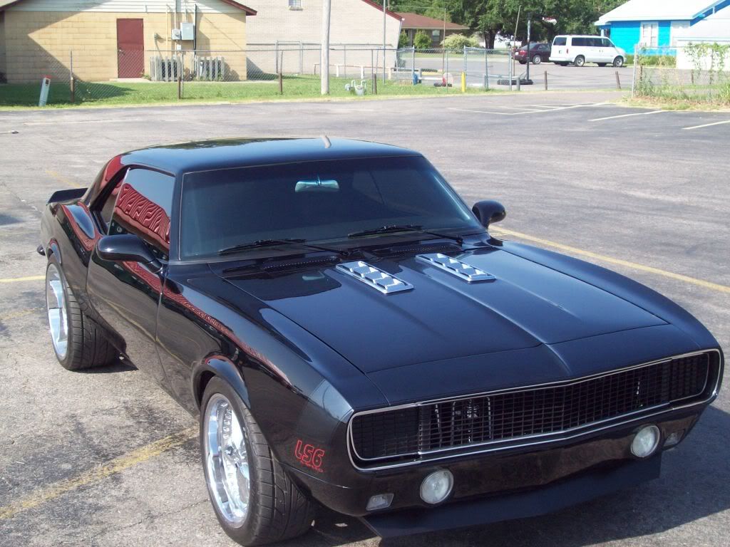

Hey Guys,
Just added some more pictures, front end is on and the glass is in. I modified the openings to use stock glass.

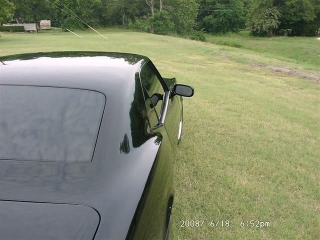

Out of curiousity, what are you doing for the bottom of the windshield to the cal, there arent any pictures of the cal and the finish out between the glass, fender, and cal.. Is the Windshield spaced out at the bottom to where it is above the flat top of the cal and fenders? If So, the factory metal trim wont work anymore, because it isnt shapped right or wide enough to reach the a pillar any more? I went throught that same thing, that is why I had to make the windshield taller and wider.
This is what got by elarging the windshield...
http://i290.photobucket.com/albums/l..._0007_01-2.jpg

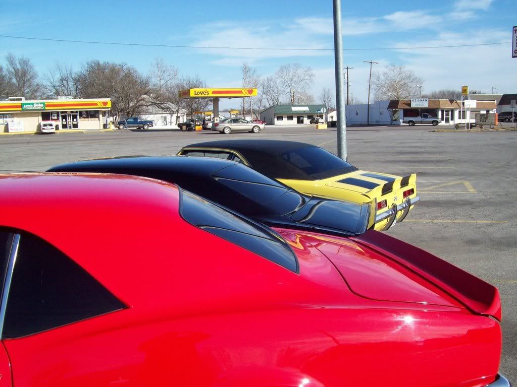

Without Rear weatherstrip on the rear glass...
http://i290.photobucket.com/albums/l...l1/photo49.jpg
With weatherstrip on Rear Glass
http://i290.photobucket.com/albums/l...1/000_0016.jpg

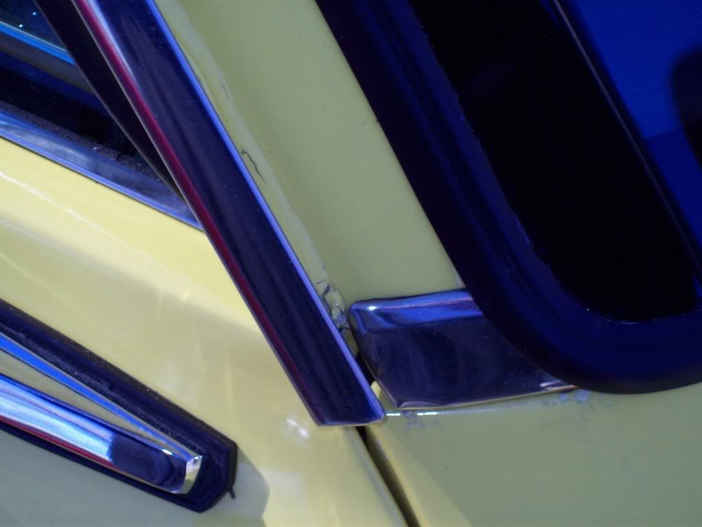

This one here shows one of the options, so you dont have to add to the A-Pillar.. You can paint this piece car color or black to match the rubber and the black out, or do what I did to the picture at the top.
http://i290.photobucket.com/albums/l...000_0009-1.jpg
