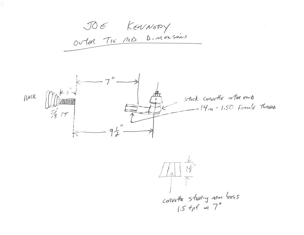

out2kayak 05-09-2011 02:46 PM
Like this:
http://i810.photobucket.com/albums/z...roddrawing.jpg
Thoughts?

funcars 05-09-2011 09:01 PM
I used some stud mounts with rod ends from coleman on my 90 corvette when I made rod end linkage tie rods in the rear. Looks like something similiar might work if you can find the right stud. There are a variety of different tapers and sizes, most for 5/8 threads from Coleman. Give them a call and see if one of these has the taper you need: 833-201, 833-111, 808-950, 808-951.
