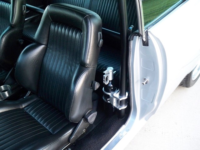

camcojb 05-18-2011 10:18 PM
Safecraft here too,
