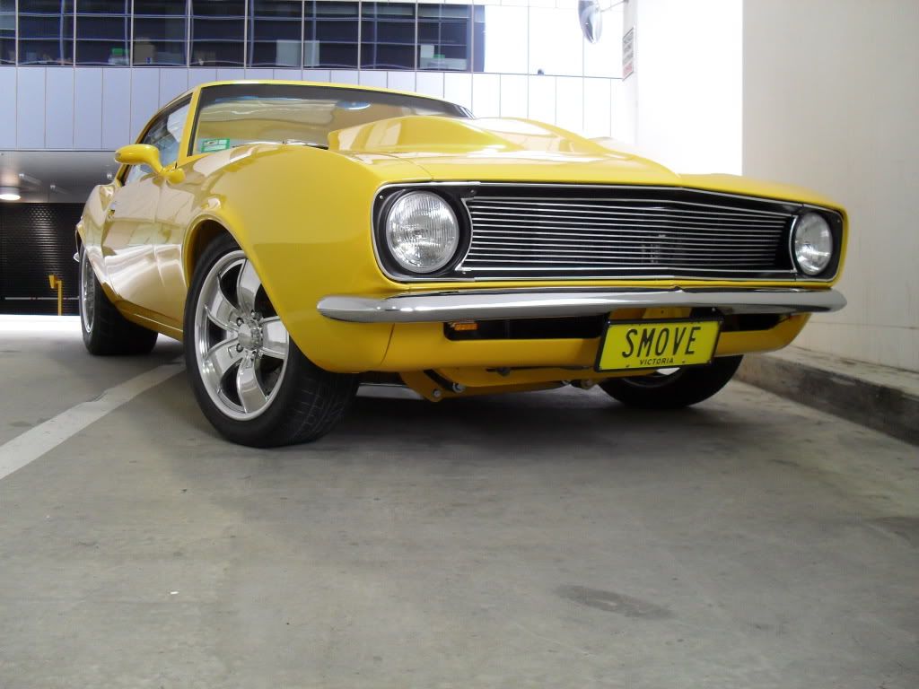

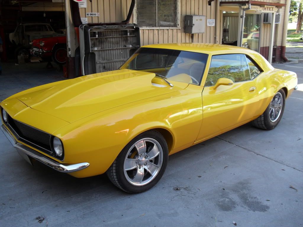

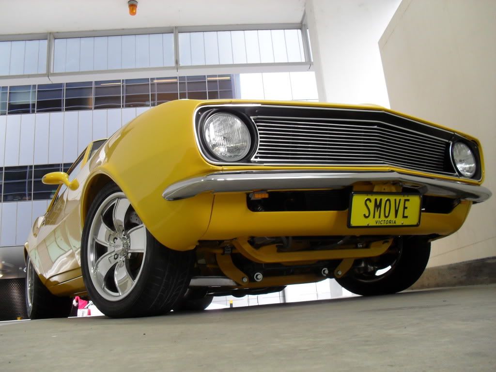

x2..I did exactly the same as everything listed by Sparks, and brought the bumpers in closer to the body also
http://i156.photobucket.com/albums/t...SDC11021-1.jpg
http://i156.photobucket.com/albums/t...d/SDC11211.jpg
http://i156.photobucket.com/albums/t...d/SDC11210.jpg

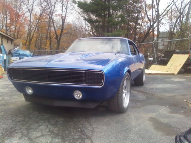

speedshftr 06-03-2011 05:33 PM
http://img.photobucket.com/albums/v4...19-10_1102.jpg
