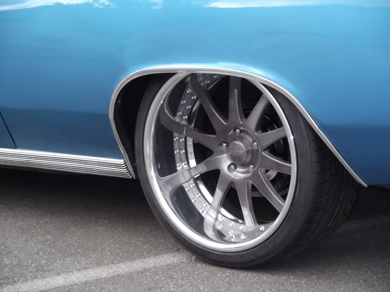

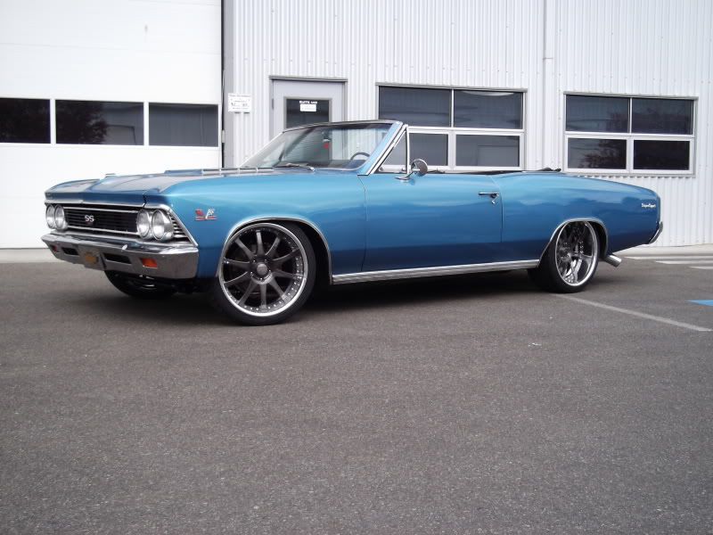

Here is a '66 That came into the shop that started as simple wheel swap...we know how that goes.
He wanted a deep dish wheel without mini-tubbing it, so we ordered up a new 9" Ford that was 2.75 inches narrower. We also installed a Ride Tech kit with shock waves up front along with a muscle bar.
We finished it off with a new carpet kit and repaired a mess of wiring. Rushforth Rated X's
Enjoy:cheers:

66SuperSport 06-13-2011 07:46 PM
Wheel / tire sizes ???
scottysimp7 06-13-2011 08:13 PM
Wow! Looks killer. Love the wheel combo. :unibrow:
56pickup 06-13-2011 08:46 PM
Looks amazing! Even better with out the tuner exhaust! :thumbsup:
youthpastor 06-13-2011 08:50 PM
thanks guys, the guy wanted 20' all the way around. The rears are 20x10 with a 285-30
