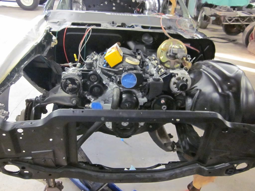

Not the best pic but here's my '72 with a LS1
http://i835.photobucket.com/albums/z...M/IMG_0805.jpg

Originally Posted by MoonMan (Post 354905)
Hi Eric -
You should be good with the Corvette accessories as mentioned and then use the Kwik bracket for the a/c.
Originally Posted by Ron in SoCal (Post 354939)
Thanks guys! That is exactly what I needed to know.:hail:
