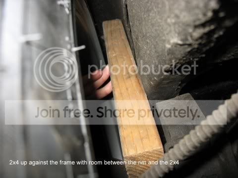

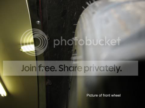

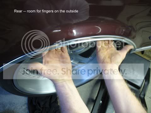

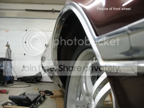

After these PM’s and after Tim Bruning had taken the measurements I decided to call Jon to speed up the process. When I called Jon and was literally called a liar and that my car was modified or somehow different I was flabbergasted. I told Jon that the rear end of my Cutlass, to my knowledge, was not modified in any way and told him he was welcome to talk to Tim Bruning or bring in a third party of his choosing to check the car out. Let me paraphrase a couple of things Jon said:
1) “I did not hold a gun to your head to go with the wheel sizes I recommended!” (Wow, what happened to “recommended fitments that we can suggest with 100% confidence”? and his goal to “Help customers with their custom wheel fitment by taking out all the guess work and the mystery of custom wheel applications, and to provide an honest, and over the top approach to customer service?”)
2) “It’s people like you that make me want to quit selling wheels.” (Wow, why am I being made out as the bad guy when it’s your wheel recommendation that’s in question?)
3) “The rear wheels fit. 3/8" is perfect as far as room to the outer fender.” (Really? What about the 2” of space between the wheel and inner wheel well? 2” wide wheels would “fit” but is that what a pro-touring wheel expert would recommend? If so what about the tech section on Driverz Inc?:
“For tires lower in profile, in most cases, a .5" outer fender and .75" inner fender clearance is acceptable. “ If that’s the case, why would Jon recommend a 2” clearance to the inner fender and expect that the rear of the car could not be lowered without narrowing the rear end unless his assumption that all A Bodies are the same was incorrect?)
I also checked with a few others on classicoldsmobile.com that have 1966 Cutlasses and they all have ample room in the rear wheel well. They all agreed that you could not compare a Chevelle to a Cutlass—they’re both A Bodies but they are very different when it comes to wheel fitment/sizing. Something that Jon should have known—or at least double-checked.
Not convinced? Heck we haven’t even touched on the fitment of the fronts yet—they’re swimming in the wheel wells as well! So much for “You want the wheel and tire pushed as far as possible out to the outer fender.” I will now attach a couple of pics that Tim Bruning took. For those of you that know Tim, you know he’s an honest guy that would never fabricate a story just to back me or anyone else up. I encourage you to contact him if you feel I have not provided a fair assessment of the situation, so you can hear it straight from the horse’s mouth.
Finally, I present you with a couple of Pics of what a professionally recommended pro-touring wheel fitment should look like according to Jon @ Driverz Inc:

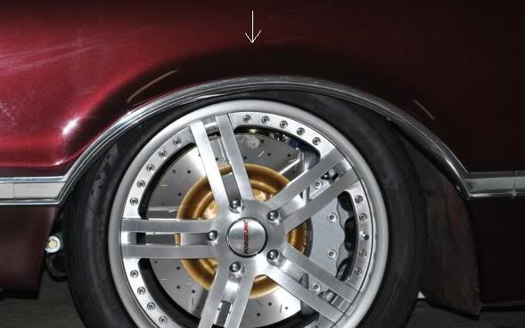

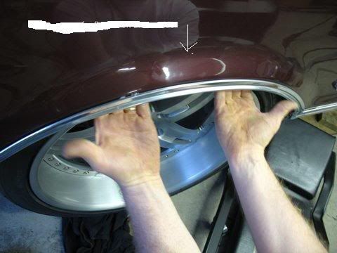

DriverzInc 06-22-2011 06:17 PM
And now I'm at home and I can't think about anything else but this...
We asked Lee if the rear end was stock, and if the wheel wells were stock, and he did say, to his knowledge that they were. That's when we responded and said, then we have a recommended fit that we know "fits".
I'm still not convinced his rear end is stock for his car at 61" from drum to drum.
Also, we take into account a disc brake upgrade, which Lee wants to do, which will push out his wheels another .200" on each side.
Now, Lee is arguing that my definition of "fit" is different. Do they rub? No. But because he has 1.75" of room to go inboard, or wider, he is saying they don't "fit". :willy:
From the photos, and from the conversation I've had with Tim Bruning, I think Lee should narrow the rear end by an 1" (like he intended too) and run a 305 wide tire if he wants to go wider, and fill up his gap more.
Another contributing factor, the photos don't show the upper hump (or wheel well hump) that resides above his rear fender trim by about 2" that if he doesn't narrow his rear end like he said he was going to, is going to be a problem. They should not be 3/8" from the lower fender lip, but from that upper hump.
