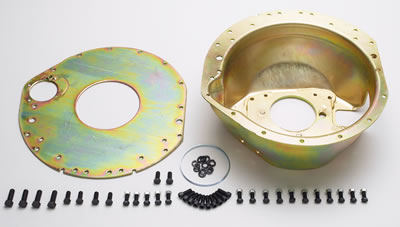

Rick D 08-11-2011 10:40 PM
1 Attachment(s)
Originally Posted by ratman67 (Post 364971)
what is a block saver plate?
Steel plate that goes behind the fly wheel to "save the block" :cheers:
Looks like this:
