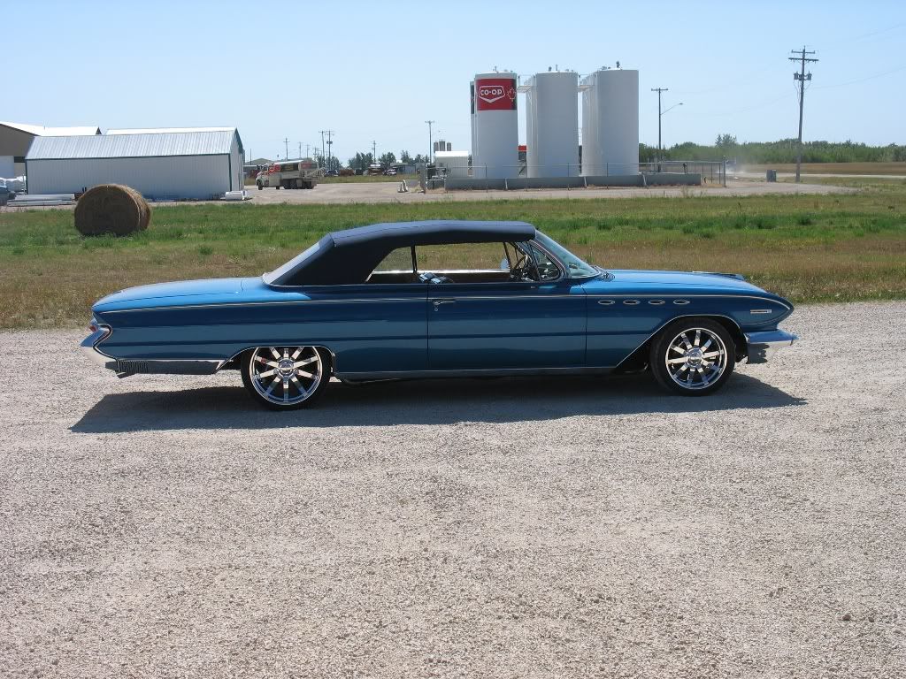

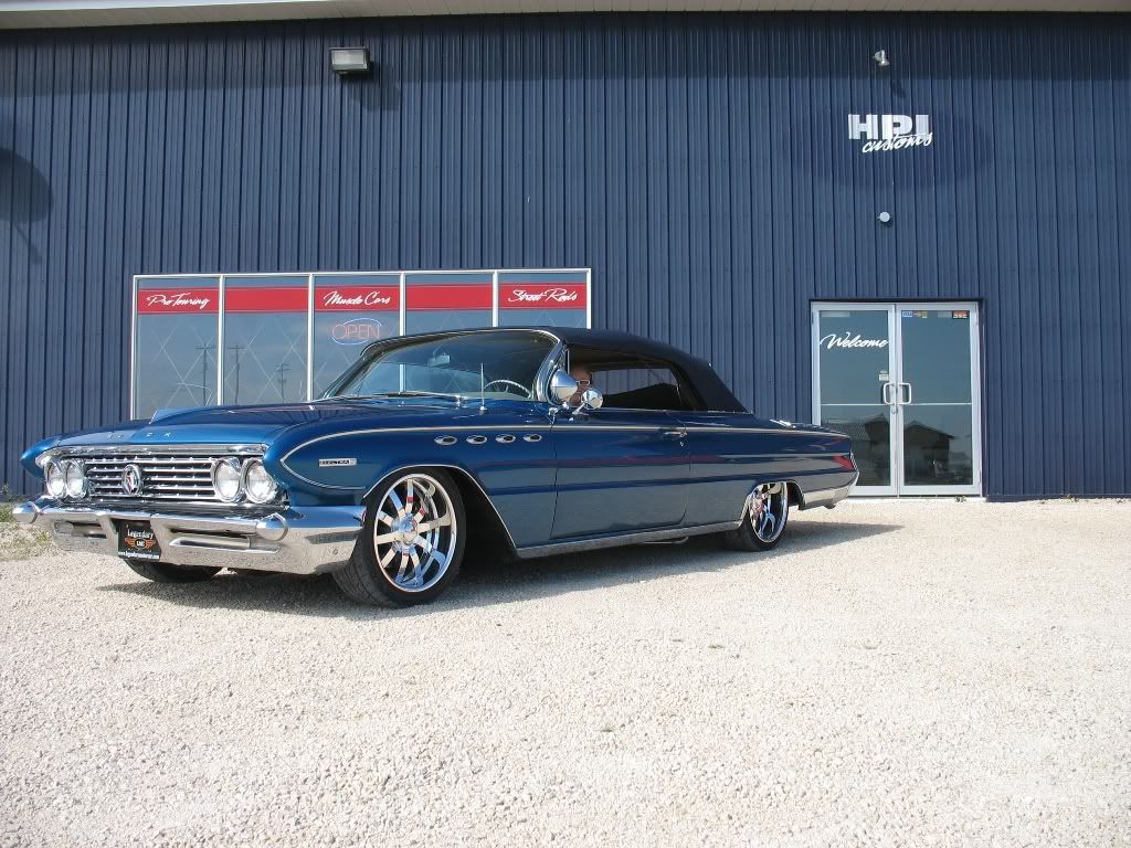

I will start with a super cool 1961 Buick Electra that we have been working on.
Quick stats: This car makes a camaro look like a Mini!
401 Nailhead

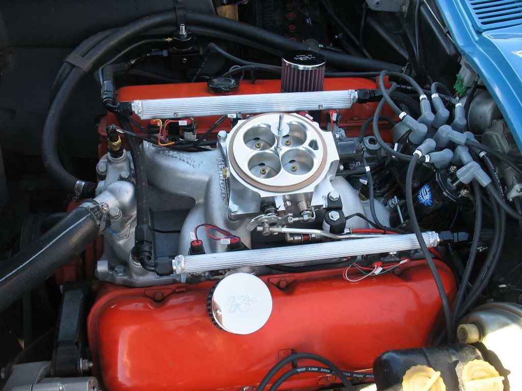

EZ EFI, hidden under stock air cleaner
MSD Ignition system
700R4 Conversion
Double adjustable shockwaves up front
Custom rear trailing arms and panhard
Rear air ride and ridetech shocks
Accuair air management
Upgraded sway bars
Custom built wilwood brake kit (no one has ANYthing for this platform..... if you ever want custom brakes on one of these, call me!!)
Schott Crossfire wheels
Nitto tires
HPI stainless exhaust system
The car runs like a champ now, for anyone wondering about EZ EFI for a cruiser or mild street machine, I give it a huge thumbs up

We are getting a few things worked out on the buick, then we are doing a photoshoot for the customer. So I will have some cool shots.....
The thing drives like a dream. Again, the FAST system that is running it is night and day over a carb. You couldn't bump the engine over if you wanted it to, it starts everytime!! For a huge heavy car, it handles really great too. I threw it into an yeild yesterday at 50 mph, it responded very well!!! If only we could get a quick ratio box for it and get rid of the two foot diameter steering wheel!
Secretly I think its my favorite car we are working on right now...... but don't tell anyone!

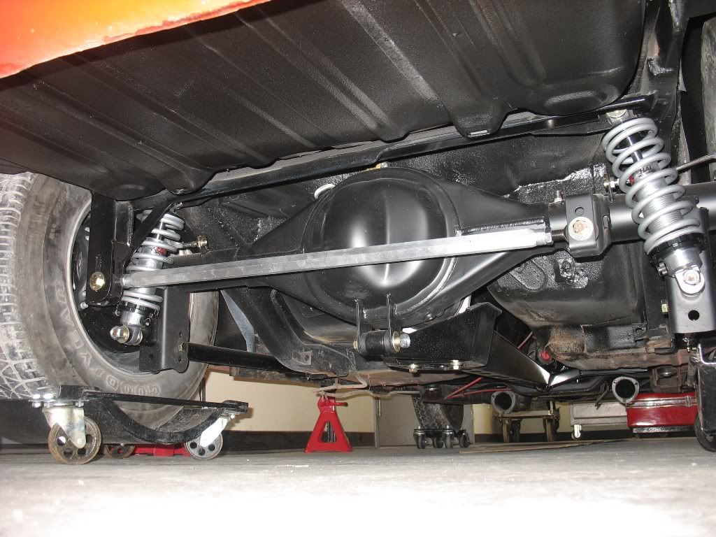

Got another Speedtech Torque arm installed in a 69. Awesome product as usual!!!

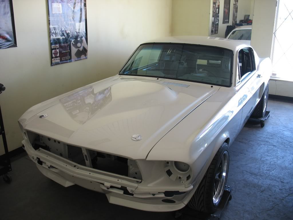

Got our 67 Mustang Fastback back from paint...... turned out real nice.
It is called white chocolate (new ford color)
more on this one later
