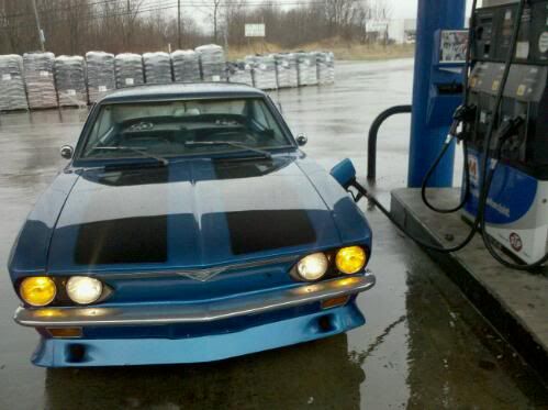

A year and a half ago, I picked up a '67 Vair in Indiana and drove it 14 hours back to NY. The drive was raining almost the entire way, but it was a helluva ride:
http://i15.photobucket.com/albums/a3...3-10-27-53.jpg
http://i15.photobucket.com/albums/a3...3-06-28-01.jpg
http://i15.photobucket.com/albums/a3...3-10-51-50.jpg

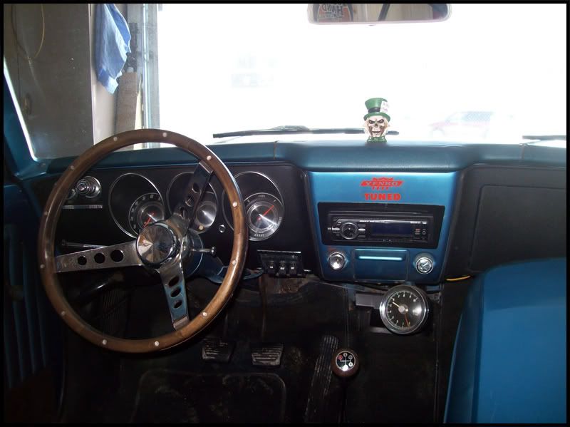

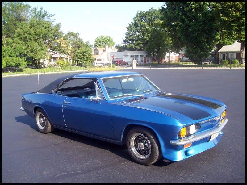

Back in the "shiny" days:
http://i15.photobucket.com/albums/a3...0_1401copy.jpg

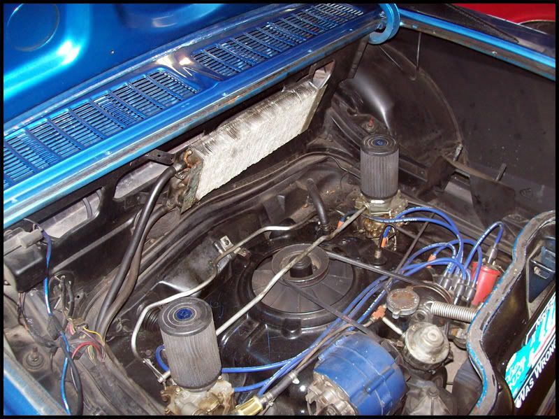

Motor:
http://i15.photobucket.com/albums/a3...0_2243copy.jpg

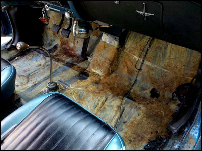

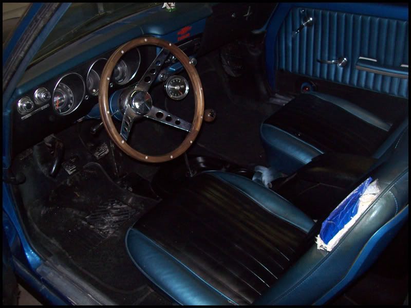

Interior:
http://i15.photobucket.com/albums/a3...0_2241copy.jpg
http://i15.photobucket.com/albums/a3...2234_1copy.jpg

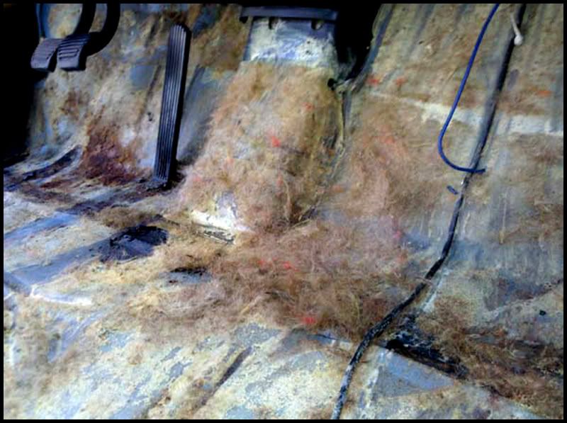

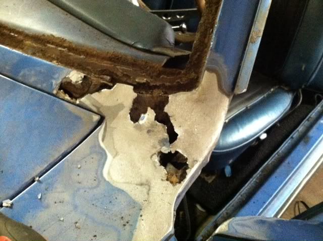

Not to confuse the progress report, but I did tear out the carpet last year to get rid of mold and moisture before putting the car away. Unfortunately, I wound up with tons of glued-in fuzz which I'll have to strip out. I won't be installing a new carpet, so the floor itself will need to look better than new before the seats go in.
http://i15.photobucket.com/albums/a3...-03-211425.jpg
http://i15.photobucket.com/albums/a3...03-2114261.jpg
This might be a sub-project that takes place along with the wheels and tires, just because it's already started. On a side note, for some strange reason the enormous floor shifter is one of my favorite parts of the car. No center console, because there's no transmission tunnel - the floor shifter is really a FLOOR shifter.

DarkoNova 08-28-2011 03:12 PM
What the hell kind of engine is that? :wow:
HotRodKush 08-28-2011 05:07 PM
Jeff, thanks. Haven't figured it out yet. Lots of scrubbing and sanding would be my guess.
Matt, it's a flat-6. Alot of guys put them in airplanes too:
http://imagedv.com/aircamper/log/ima...on-stand-4.jpg
