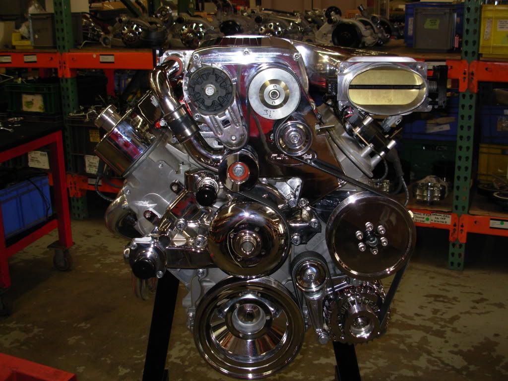

I Thought I had everything figured out for my set up a ls2 with a 2.8l Kenne Bell supercharger for my 65 Chevy II with a DSE Front clip. I tried to modify my original set up which was for a truck. This did not work because the belt was way to long and I was having a rough time lining up the pulleys. And when I went to fit the A/C on it hit the inner fender panel. So I modified the Kwik A/C bracket and I could not get the belt to run true. (see pic)

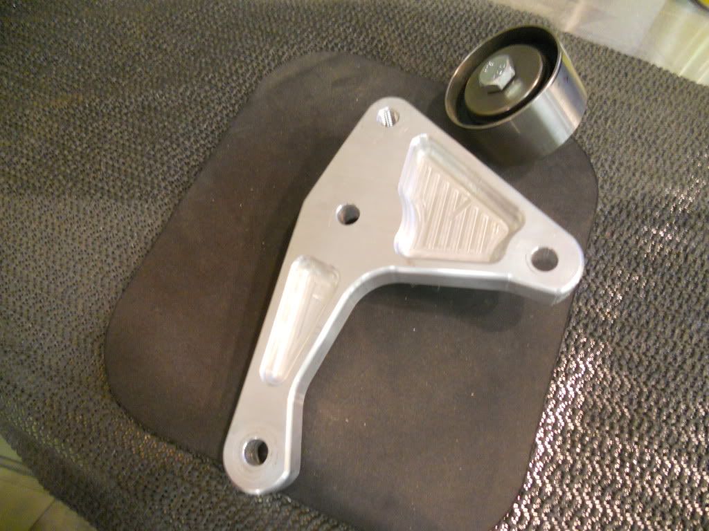

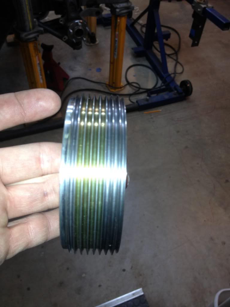

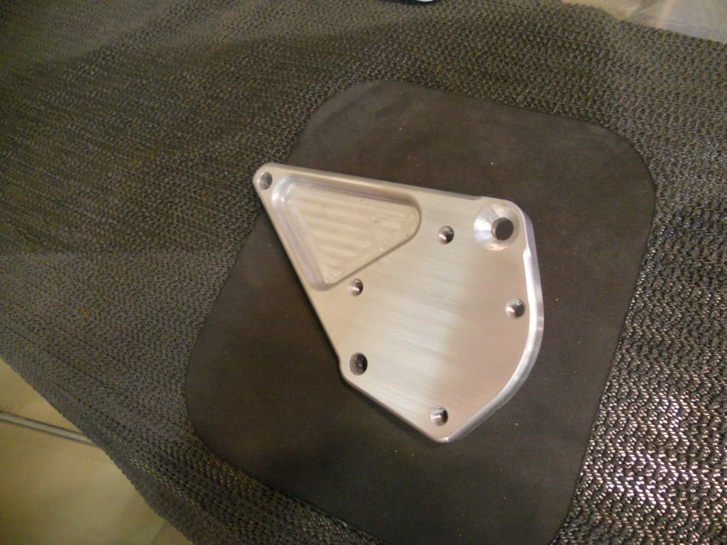

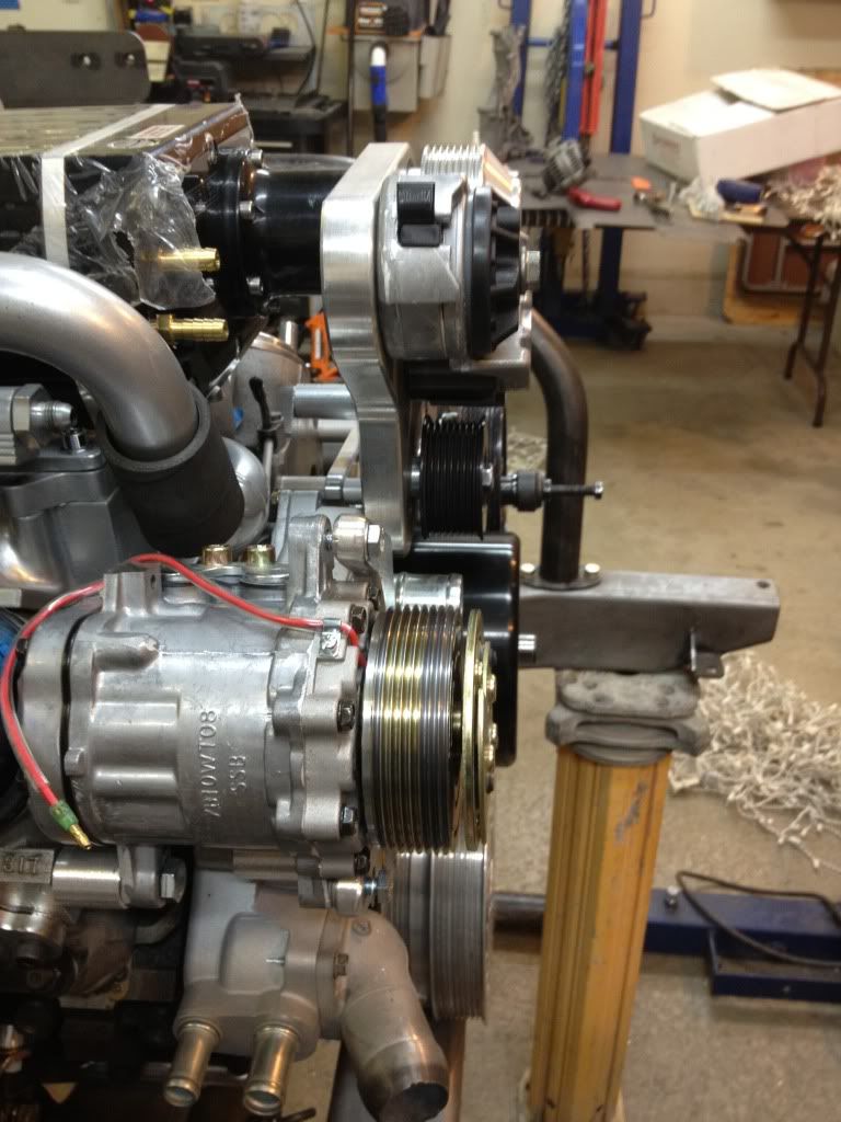

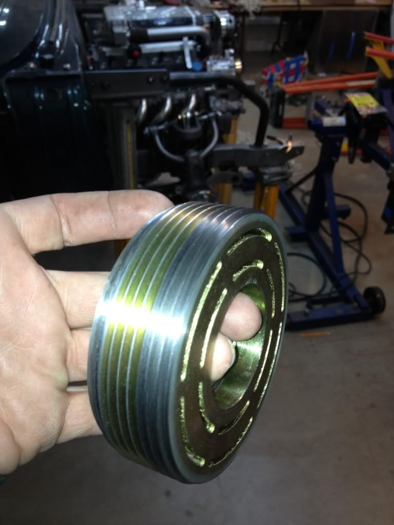

Grnova 11-15-2011 07:18 PM

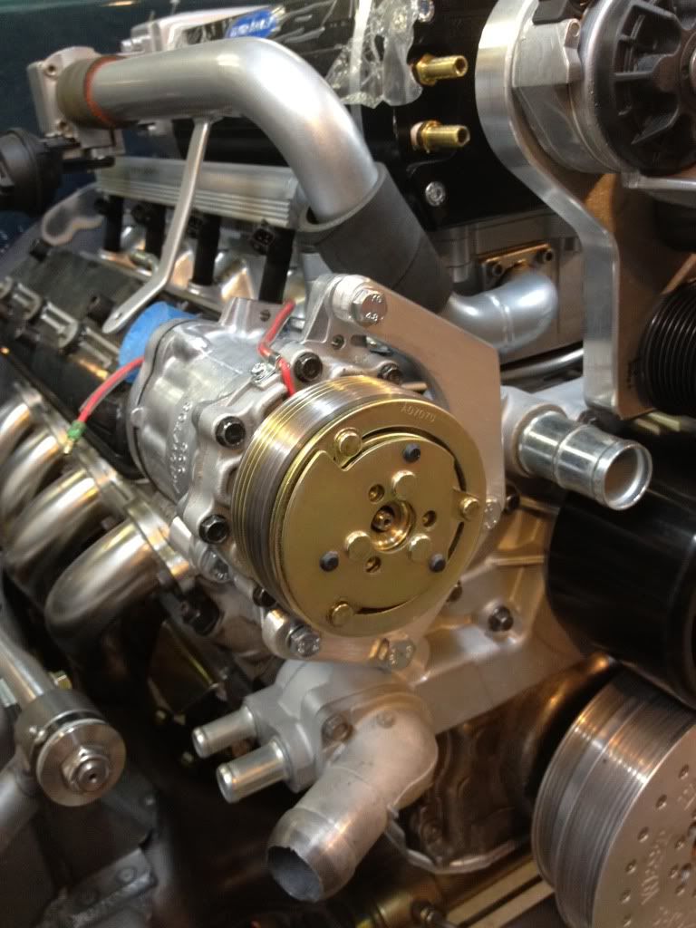

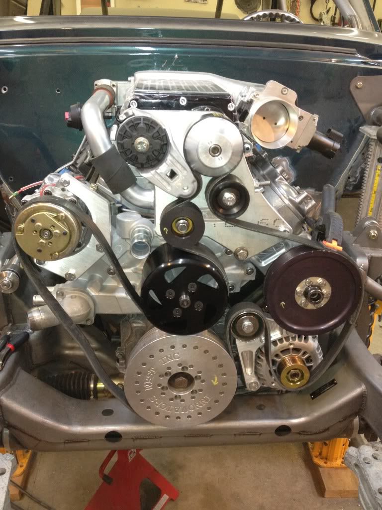

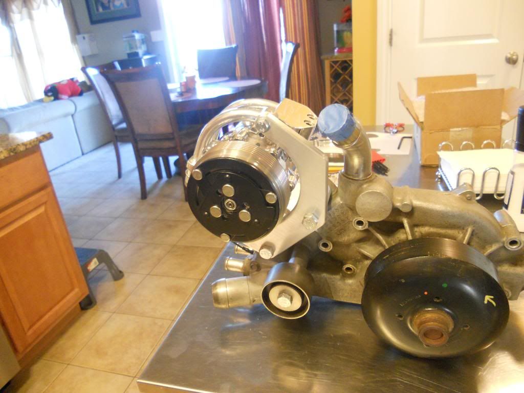

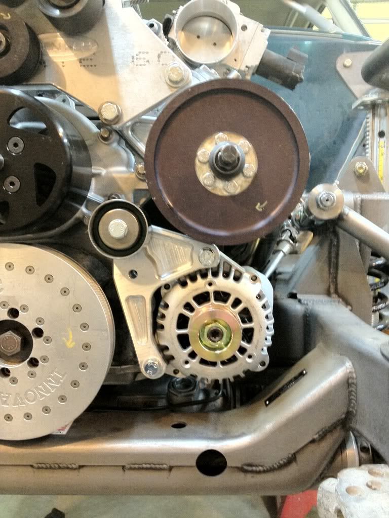

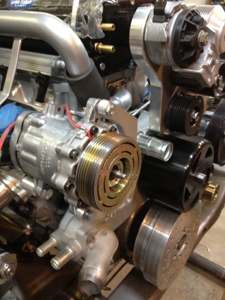

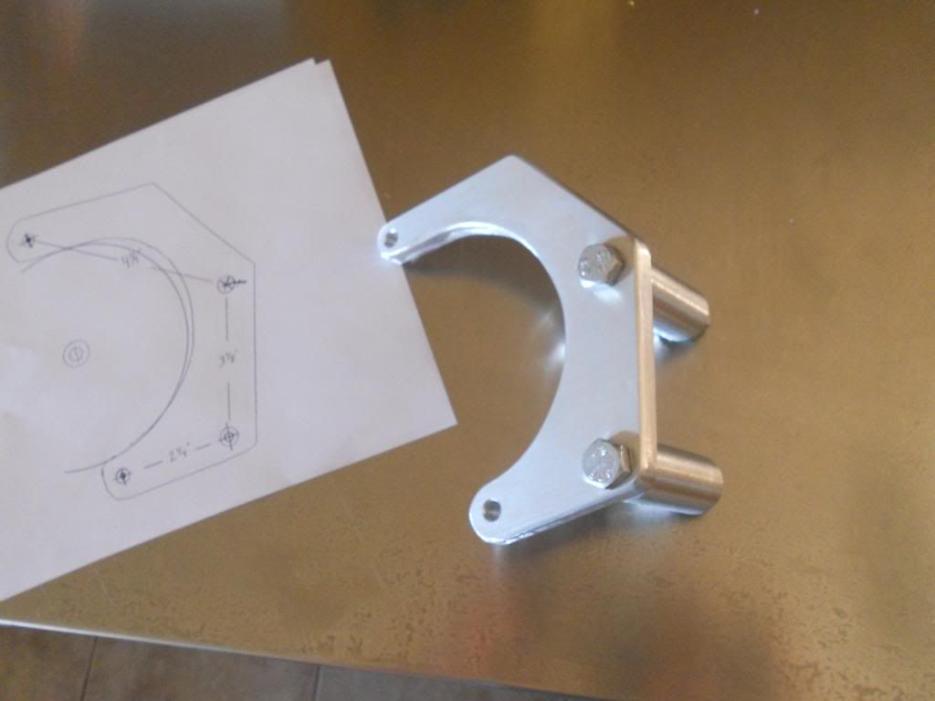

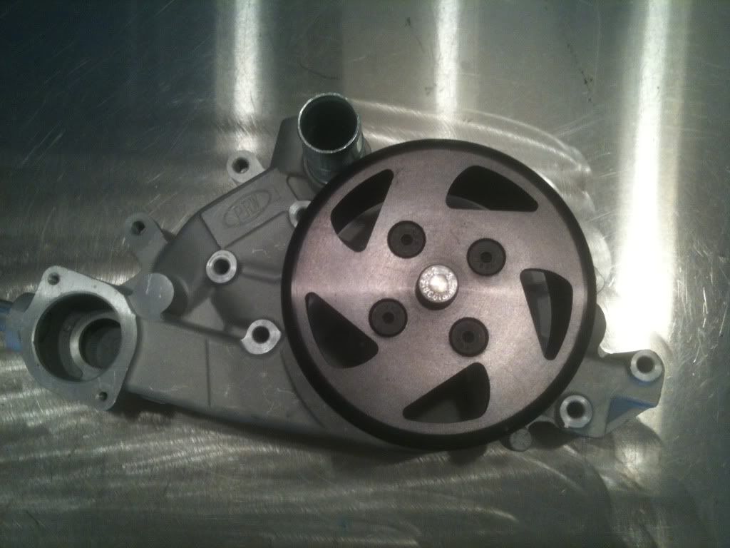

Ok, This is what I came up with! I got the 180 amp back and found an 8 rib 1.9" pulley. Just finished up the sd7 8 rib pulley. Prw water pump, and Alper Motor sports p/s alt/ bracket, Kilby enterprises alt pulley. and Turnkey blower snout support. Oh and my custom a/c bracket.
