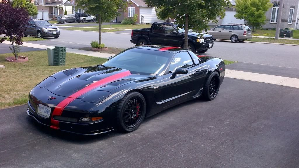

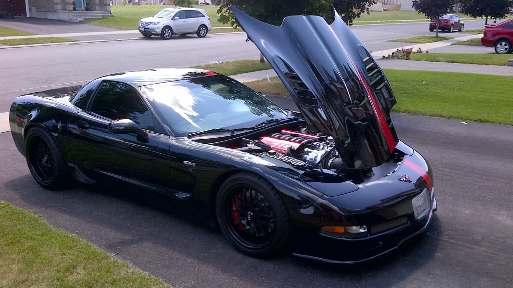

I tend to troll on here more than anything but I thought I would post my creation. After lots of time and money I am just awaiting a final tune on the car and it will be complete. I bought this car in 2003 with 17km on it (canadian car). I now have 27,000 miles on it. Only about 5000 of which are on the new drivetrain. I would love to get thing thing out to a standing mile event before anything else just to make sure its running well and see how it reacts to very high speeds. I do all the work on this car myself so it was almost like having 2 jobs for a while. What my goal was with this vehical was to create a stock mannered car with stereo, air, etc with the ability of all out performance. Its a fun buggy and hope you all enjoy the pics. take care :)

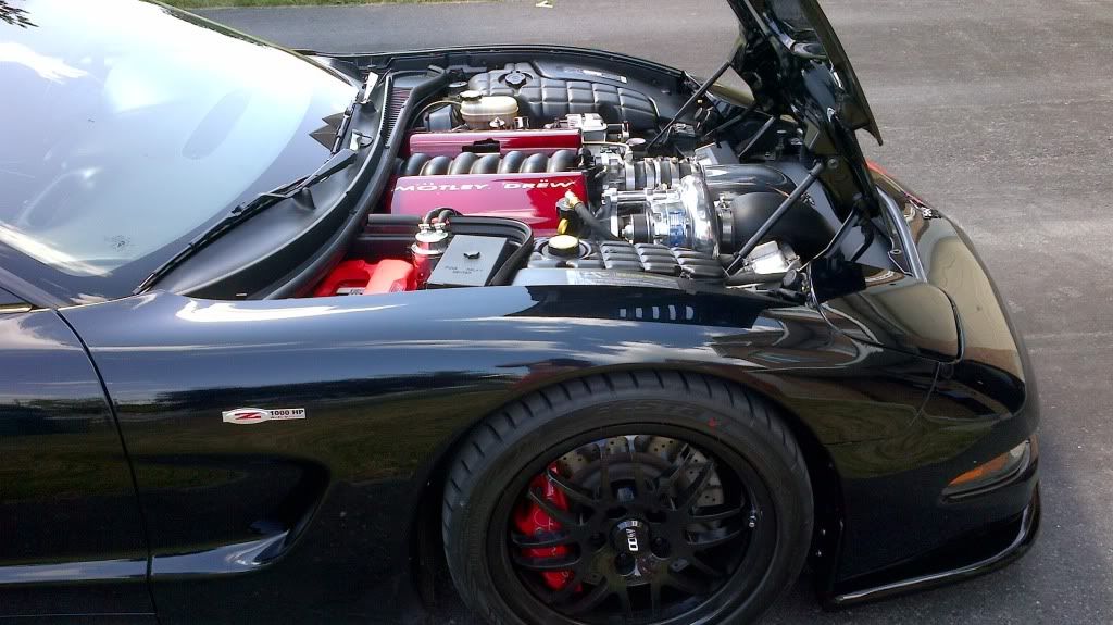

Motor:
403ci A&A Corvettes Forged and Stroked Aluminum Block LS2 Motor

A&A Vortech Polished V7 YSI-Trim Supercharger Kit
A&A Large Dongle Air Intake and Filter
A&A Air to Air Intercooler
Polished Vortech Mondo Bypass Valve
A&A 8 rib pulley setup
A&A belt Tensioner system with HD Tensioner
Champion MotorSports Pulleys
Cartek Flip Drive Pulley System
Crilly Chassis Works Custom Intercooling Piping and other modifications
