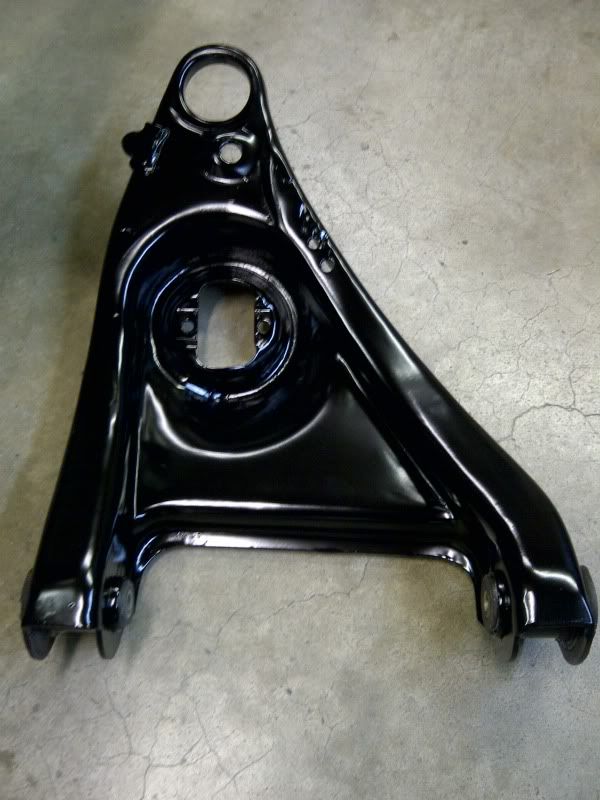

I have had this camaro for about 12 years and these are the arms that was on it. By all looks they are 69 camaro arms, they have been on a driveable car. They(new ball joint) appear to fit in the spindle as they should and in the control arm hole. I don't have the old ones they got thrown away by mistake so no comparisons. Makes me wonder now whats up since you guys are not ever hearing of this. What could be the deal. I will try to get some pics of the arms on here for you guys to look at. Thanks for all the input.
http://i108.photobucket.com/albums/n...0913-00094.jpg http://i108.photobucket.com/albums/n...0913-00095.jpg |
The new ball joint for a 70-81camaro fits this arm and the spindle I have -I don't know whats up. Hopefully someone here can see something I do not. Thanks
