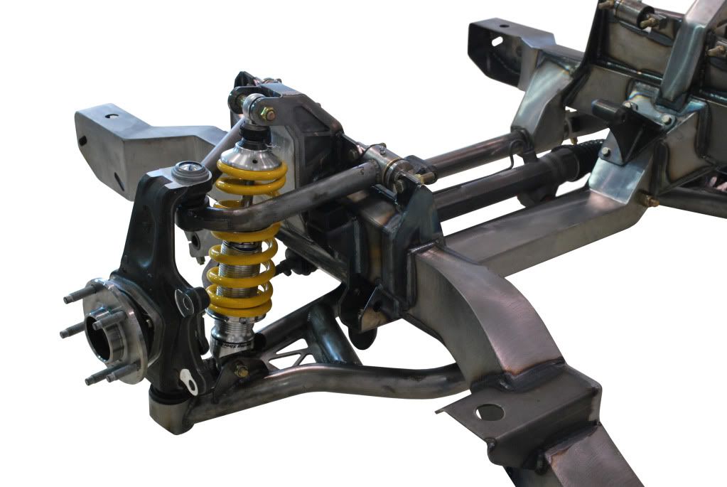

FAST TRACK '67-69 Camaro Chassis
Introducing our FAST TRACK chassis for '67-69 Camaro
This chassis system features a fully boxed frame design that greatly improves strength and rigidity over the factory unibody.
Frame Features:
  • RS Fast Track Front Suspension utilizing proprietary geometry
  • C6 Corvette spindle and Z06 hub assembly
  • Adjustable Afco billet coilovers
  • 1.25" splined front sway bar with C6 Corvette end links
  • Custom fabricated, fully boxed, 10 gage frame rails
  • Utilizes all stock body mounting locations, bumper and core support mounts
  • Lowered ride height
  • Engine mounts for SBC, BBC, or optional LS Motors
  • Custom center crossmember with adjustable, drop out trans mount
  • Mid brace crossmember with exhaust ports for up to 3" exhaust
  • HD Ford 9" housing with 31 spline axles
  • Large diameter triangulated 4-bar rear suspension

I have a question about this first will this work under a X-body car 72 Nova. Second I noticed the the upper control arms mount point are the same high as the the arm tabs. Are you not worried about fatigue on this point as it is a high stress area. I am just asking I coulf be wrong I sure you have raod tested the crap out of this this just curious.

Honestly, we have not put one under an x-body yet. We know many of the F-body structures are similar to the x, but without trying it first hand, we couldn't say for certain.
The area of the frame you were asking about is 1/4 inch plate both tied directly to the shock mount and the frame and on the other side has an 'I-beam' profile. It's incredibly solid!
