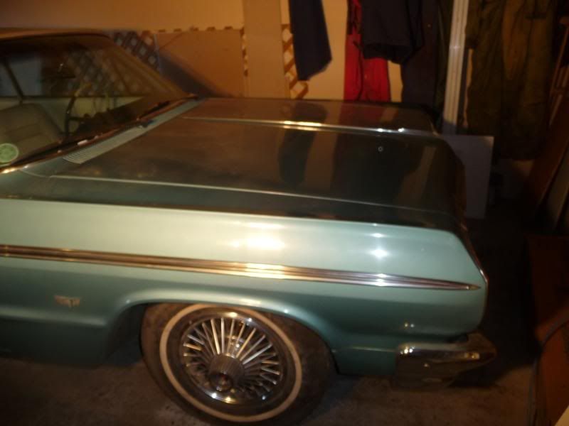

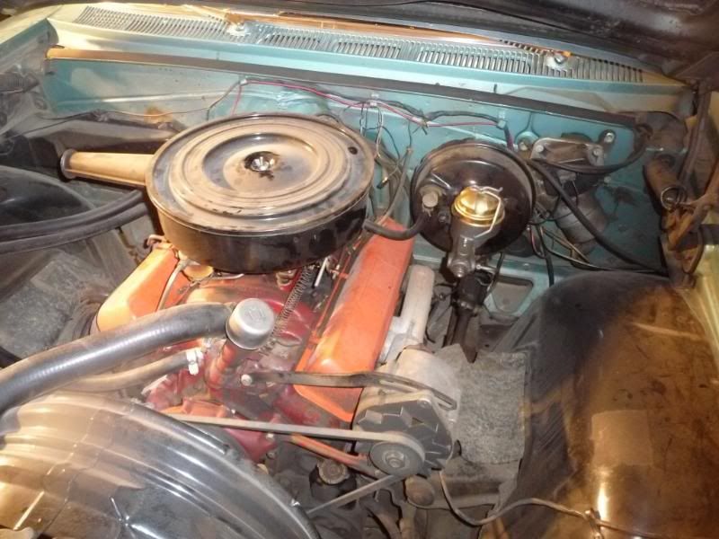

I have recently inherited a 64 Impala SS327 Convertible that my grandmother bought brand new. The car hasn't seen the road since the mid 1970's, 59K miles on the clock. It's been in heated, ambient storage all this time. I am looking for a checklist for getting the car ready to start again. I thought about the usual suspects, new plugs and maybe a carb rebuild. Any recommendations for getting it ready to fire after sitting so long? Here's a few pics as she sits now.

Fill the cylinders with marvel mystery oil and slowly turn the engine over by hand to free up the rings without damaging them, then turn over with the spark plugs out to spit out the oil. That should get the compression back up

  • Drain and clean the fuel tank
    Rebuild the carb
    Fuel Filter
    Fresh oil and filter
    New plugs
    New coolant
    New PS fluid
    Bleed the brakes
    New belts
    Trans fluid
    Air Filter
    Grease the bushings
    Prime the oil pump for 10 minutes
    Repack the front hug bearings?
    Check the rear end great or better yet, change
    Agree with oiling the cylinders and spinning it by hand first and then with the starter..

That looks awesome! Before you turn it over make sure to change the oil and use a primer tool and get the oil pressure up. Then you can put something on the crank bolt and turn it be hand. A little mystery oil in the cylinders is a good idea too. Plus everything Todd said.

First off I would see if you can turn the engine by hand. If it turns you are in great shape. Pull the plugs and squirt a little Marvel Mystery oil in them and let sit for a couple days.....
Actually...Just sell me the car. Beautiful car.
My 70 Z hadn't been started for 36 years and it was locked up tight. It is fine now and the lid has not been off the master cylinder since the car was assembled.

I'd think about replacing the fuel pump as well. The diaphram in the pump will rupture sooner than later. Great car!
