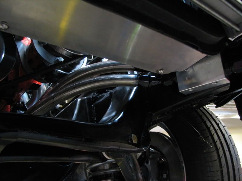

Hopefully I'll know soon, as I have the Earl's one. I do like that its plumbed for a before and after temp sender as well as a oil pressure sender.
http://i328.photobucket.com/albums/l...gSystem025.jpg
Its a nice quality piece, can't comment on the actual operation of the thermostat yet thou.
