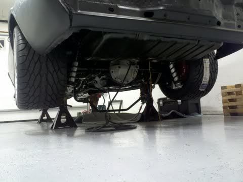

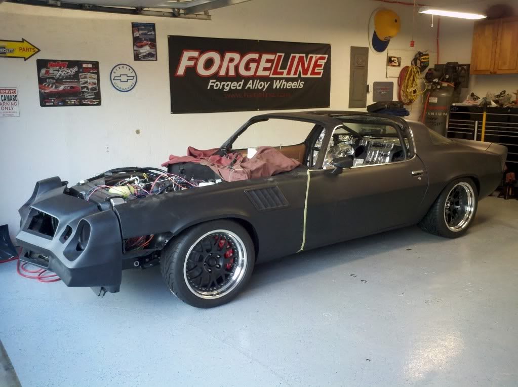

Back from the dead lol Not sure if you want a pic of mine or not but here you go,
http://i224.photobucket.com/albums/d...wn383z/ab1.jpg
http://i224.photobucket.com/albums/d...3z/carview.jpg

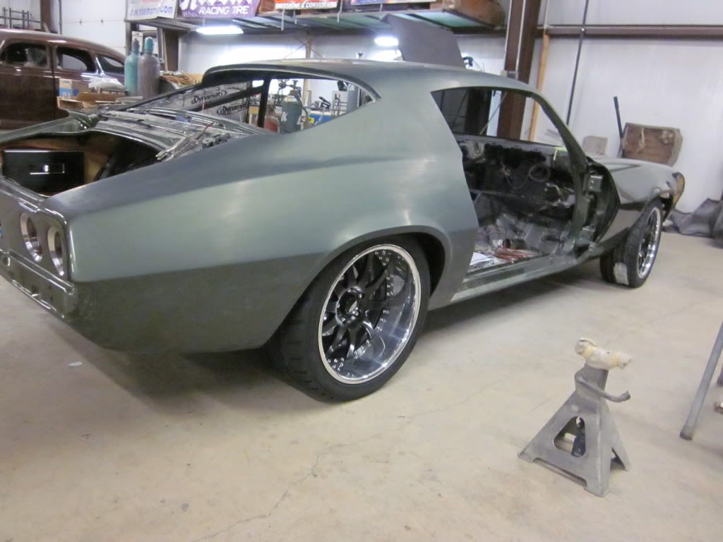

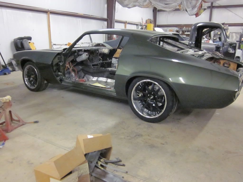

MoonMan 03-14-2012 06:48 PM
Originally Posted by maxxom (Post 401533)
Let's see some pics of those rear tires please.
Don't have too many...here's a few.
http://i835.photobucket.com/albums/z...M/IMG_1838.jpg
http://i835.photobucket.com/albums/z...M/IMG_0573.jpg
brownz 03-14-2012 06:57 PM
[QUOTE=MoonMan;401570]Don't have too many...here's a few.
Well just go and make me look bad haha,
I love the color!!! :thumbsup:
Need more info on the car
MoonMan 03-15-2012 09:49 AM
Ha, yours is looking good!
I've been meaning to start a build thread but haven't consolidated all my pics spread over three computers. I plan on doing it soon though.
The color is Natural Olive. It's a Kia color from a few years back. It's got an LS1, Heidt's 4-link rear and front suspension, Wilwood's, etc.
