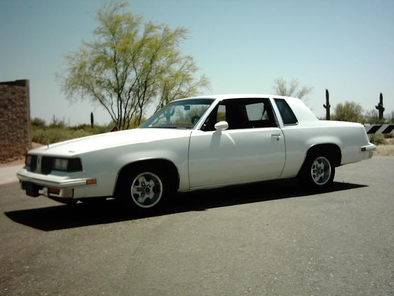

olds87 10-10-2011 07:37 PM
I wonder what gold wheels would look like on this car.

Its not an Olds, but it may give you the idea of gold wheels on a white car.

Gold wheels on white cars have always looked hot. Those Forgelines on that Caddy look BadAzz !!!
