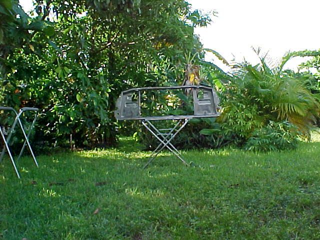

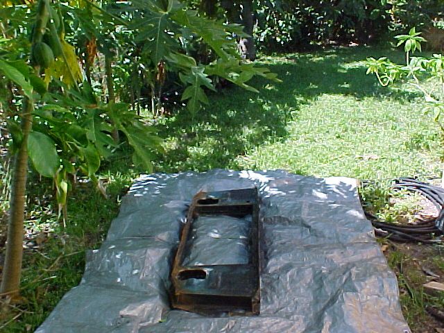

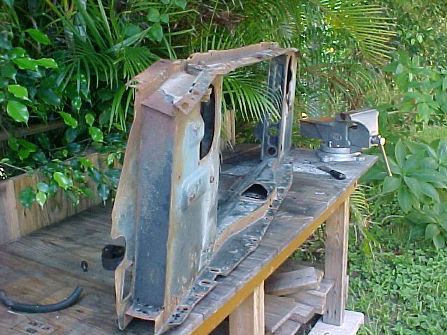

So I started the project by getting out the core support and stripping it. Gave it a good scraping to remove undercoating, wire brushed the big stuff off, wire wheeled it to get most of the heavy remaining deposits, and then sandblasted it with an Eastwood outdoor style blaster and wire wheeled it some more. I'll sand it before more work is done to it. I'm going to add some metal to stiffen it up where it attaches to the sub frame.
The 14 Car is a sort of streetfighter/G-machine, NOT a show car. So since there's a very real possibility I may ball the car up eventually I'm not trying to make things "perfect". For parts like the core support here's no smoothing/filling etc. getting done. The hours invested would be wasted if I make it look like piece of crumpled aluminum foil by smacking a tire wall or something.

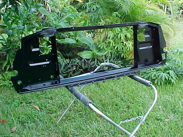

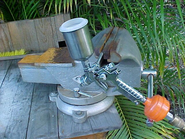

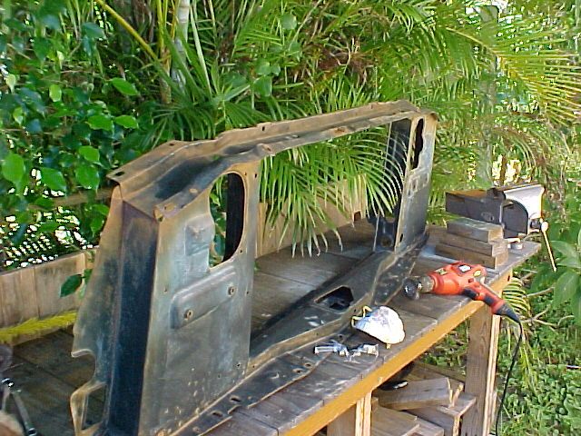

Paint day for the core support after waiting through a week of wind. I used some Chassis Saver which is a single stage rust encapsulating type of paint by Magnet Paint.

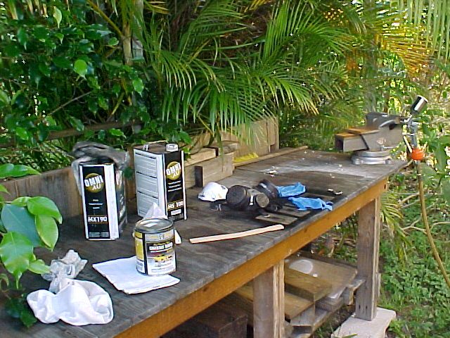

Here's my high tech mixing station! I use a HVLP jamb gun for jobs like this. The biggest hassle is making a way to hang the gun so the cup stays upright. READ DIRECTIONS (and follow them) for any type of paint.

Here's my spacious booth complete with a tropical theme. Banana, Plantain, Papaya, Mango, Avacado, Yuca (Cassava), Areca Palm, and Almond background.

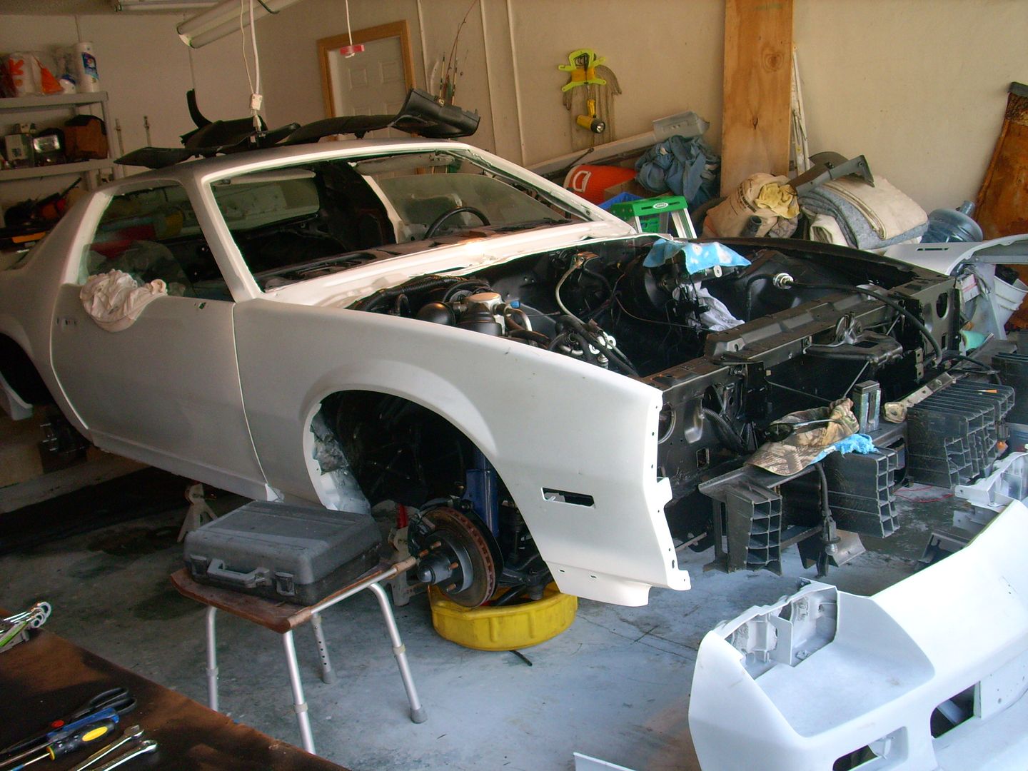

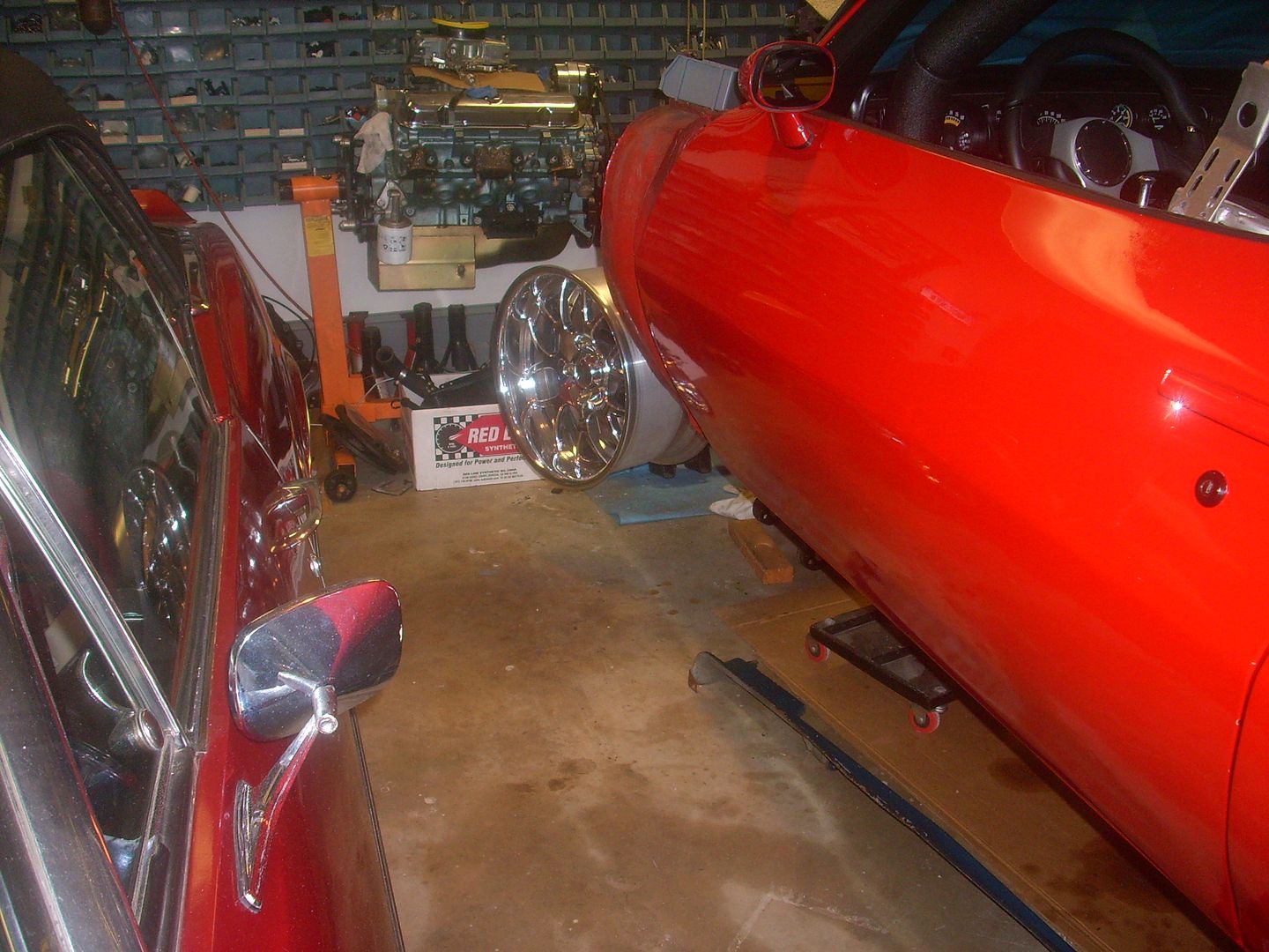

So after shuffling cars around to make the garage available without being crowded I've started taking things apart. I swapped out the 2.41 rear I normally use for street, road courses and Land speed racing for the 3.73 rear I use for drags. Then stuck the Mickey Thompson ET Streets on there so if I need to roll the car around while I'm working on the rear to install the Baers I'll be able to. I need to upgrade the rear axles to 1/2" wheel studs to match the front so the axles have to come out anyway so I can line everything up nice and straight in a drill press. I figured I might as well just pull the whole rear to make it easier to work on.
1st thing, get the car in the garage ALONE!
http://i240.photobucket.com/albums/f...y/MVC-031F.jpg
I work alone so swapping rears is a little tricky. First thing was battery disconnect and suck the fluid out of the master cylinder since all the brakes are coming out. Then remove the swaybar brackets, brakes, and disconnect the brake line flex hose and park brake cables. Then remove one shock and lower plate and swing the other lower shock plate out of the way. I carefully jack the rear while balancing it and shift it to the side without the shock, tip it down then shift it back the other direction by rolling the jack. This way I don't need to remove the springs.
http://i240.photobucket.com/albums/f...MVC-001F-2.jpg
http://i240.photobucket.com/albums/f...rapy/005-1.jpg
After swapping rears and removing front wheels so I can work on swapping the spindles.
http://i240.photobucket.com/albums/f...herapy/007.jpg
