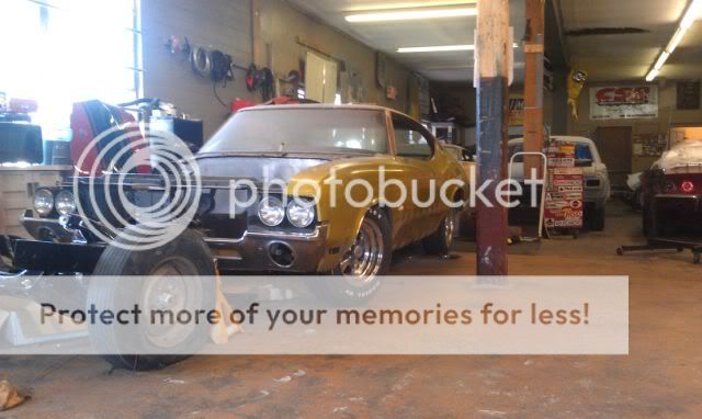

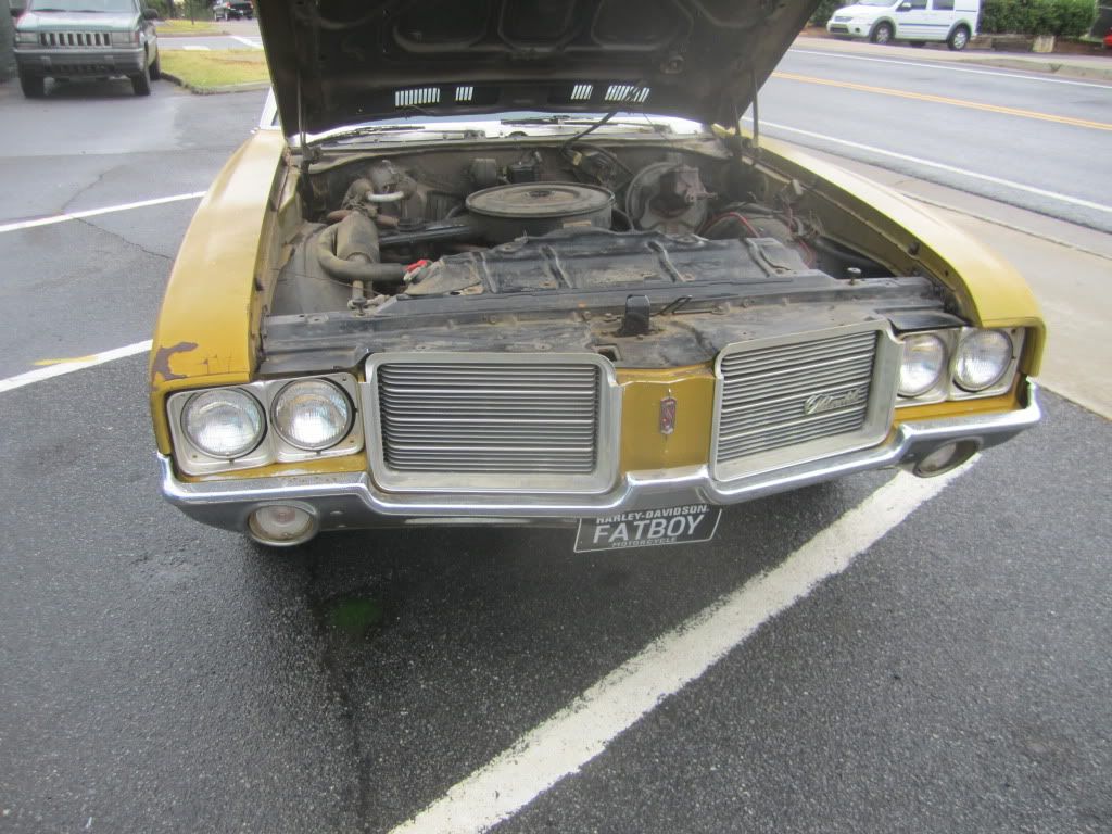

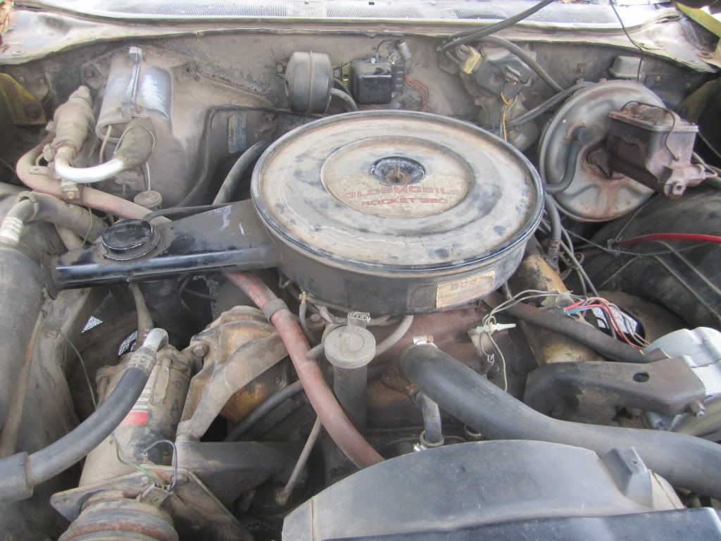

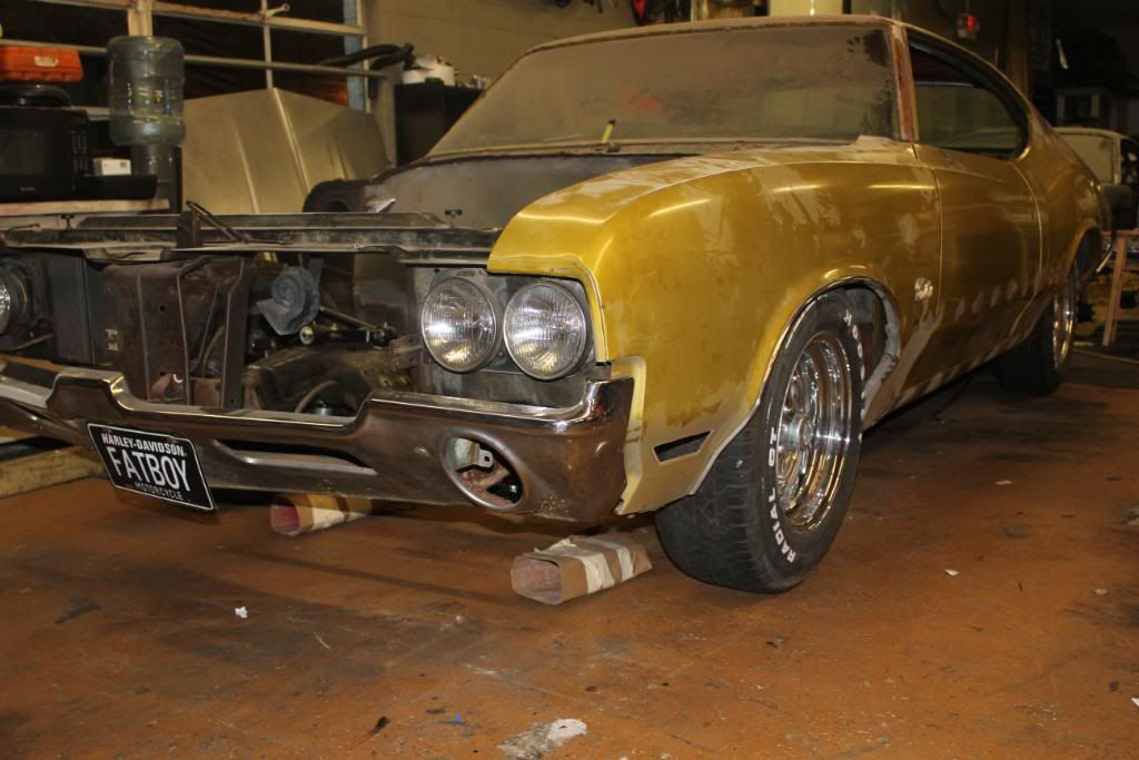

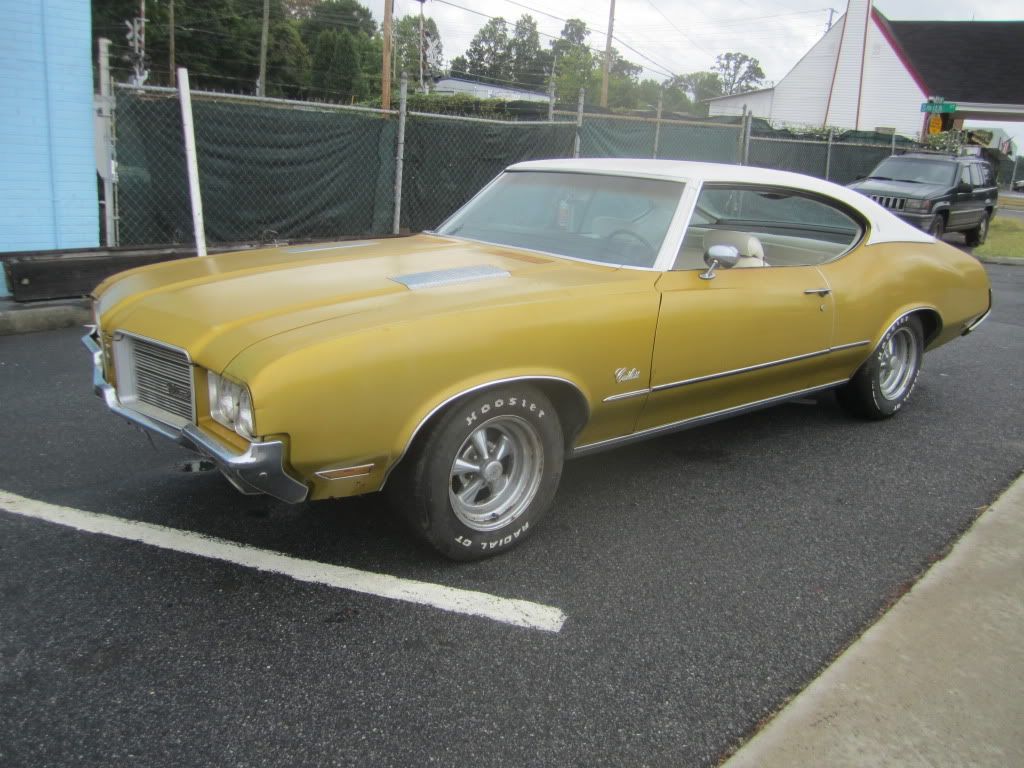

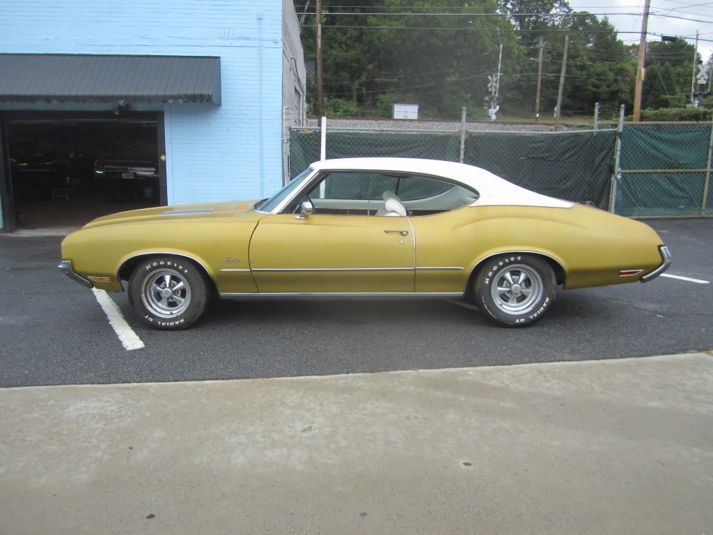

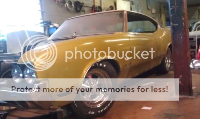

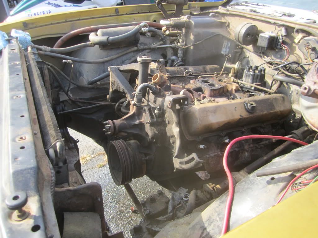

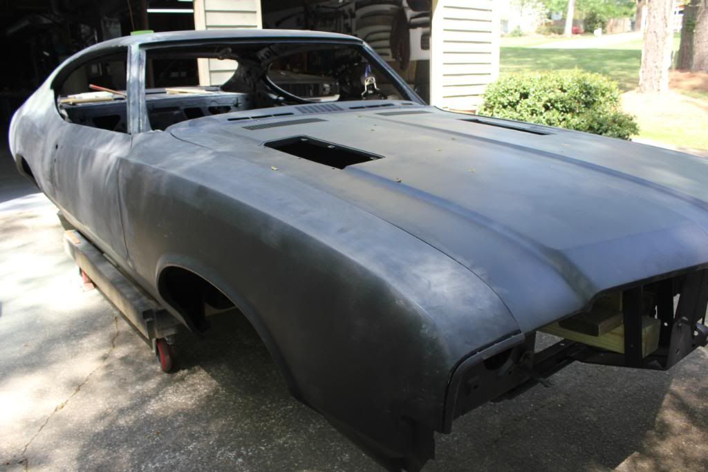

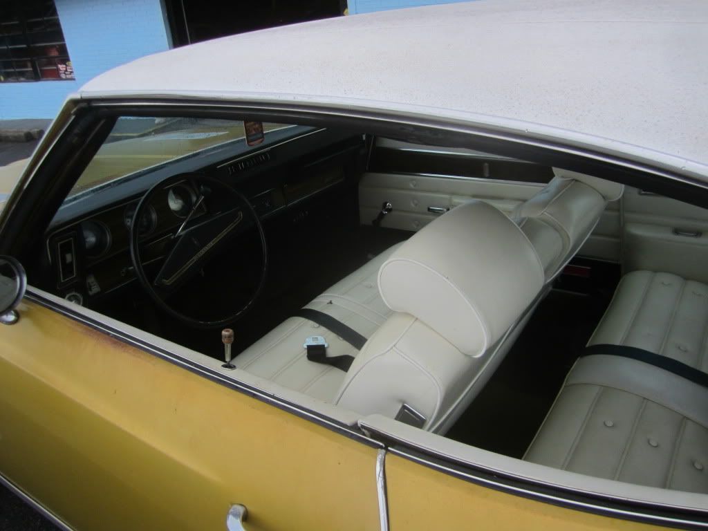

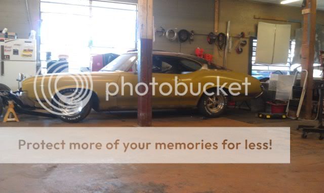

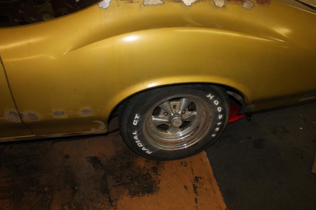

Project Sabre is underway! Here are a few shots of it the day it arrived at the shop.
http://i813.photobucket.com/albums/z...lecars/047.jpg http://i813.photobucket.com/albums/z...lecars/046.jpg She's pimpin' with that white interior! http://i813.photobucket.com/albums/z...lecars/045.jpg The "Rocket" 350, now gone to a new home in an '87 4-4-2 http://i813.photobucket.com/albums/z...lecars/044.jpg http://i813.photobucket.com/albums/z...lecars/043.jpg As Sparky mentioned, this build is intended to show that it isn't necessary to have an air-to-water intercooled American Express Black card to have a nice Pro Touring car. If you're looking for the latest widget machined from billet unobtanium, you're probably not going to find it here. We are using off the shelf parts, and in some cases parts that will soon be released to the general public. We will also be using some used parts, where deemed safe and reliable enough. For less than the cost of a new crate motor, we will have a 400+ engine with a 6 speed manual transmission and a rear end that will take anything we throw at it. Make no mistake, while this car is being built to the highest standards, it is being built with a realistic budget in mind. |

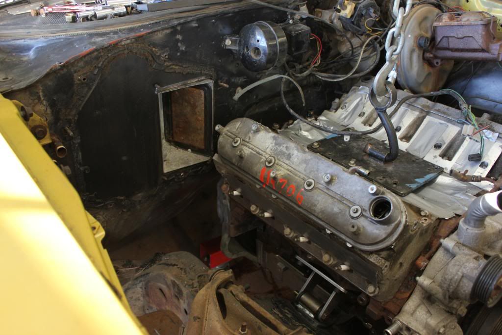

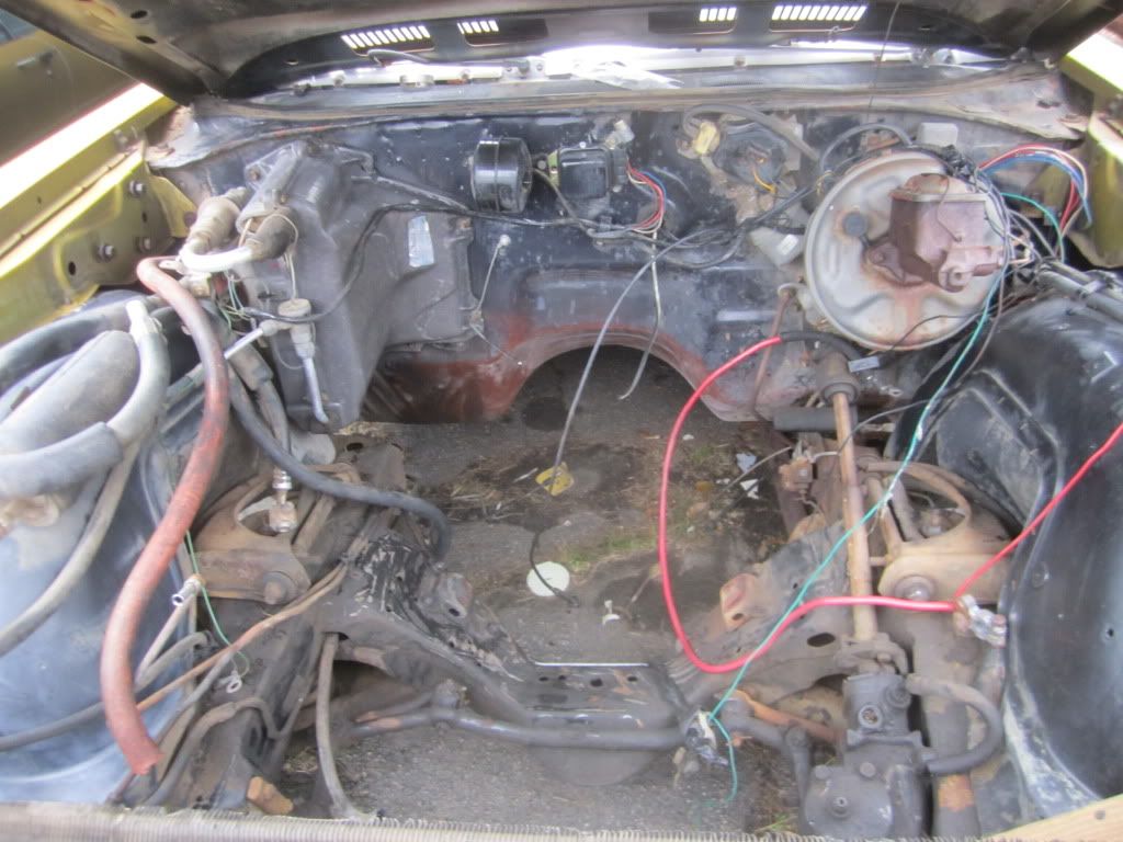

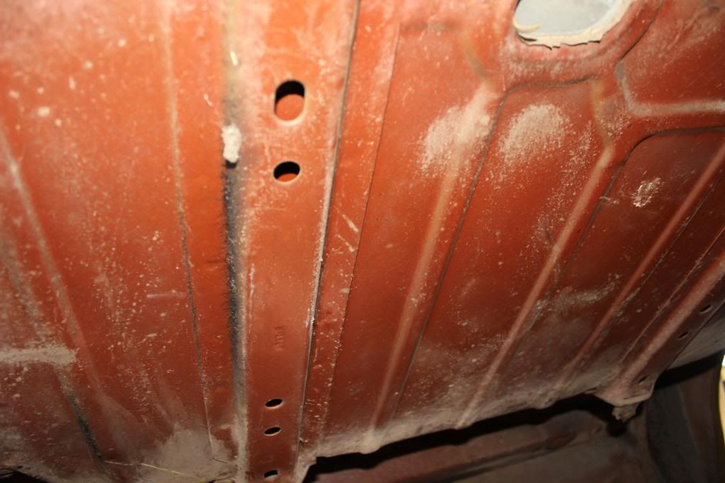

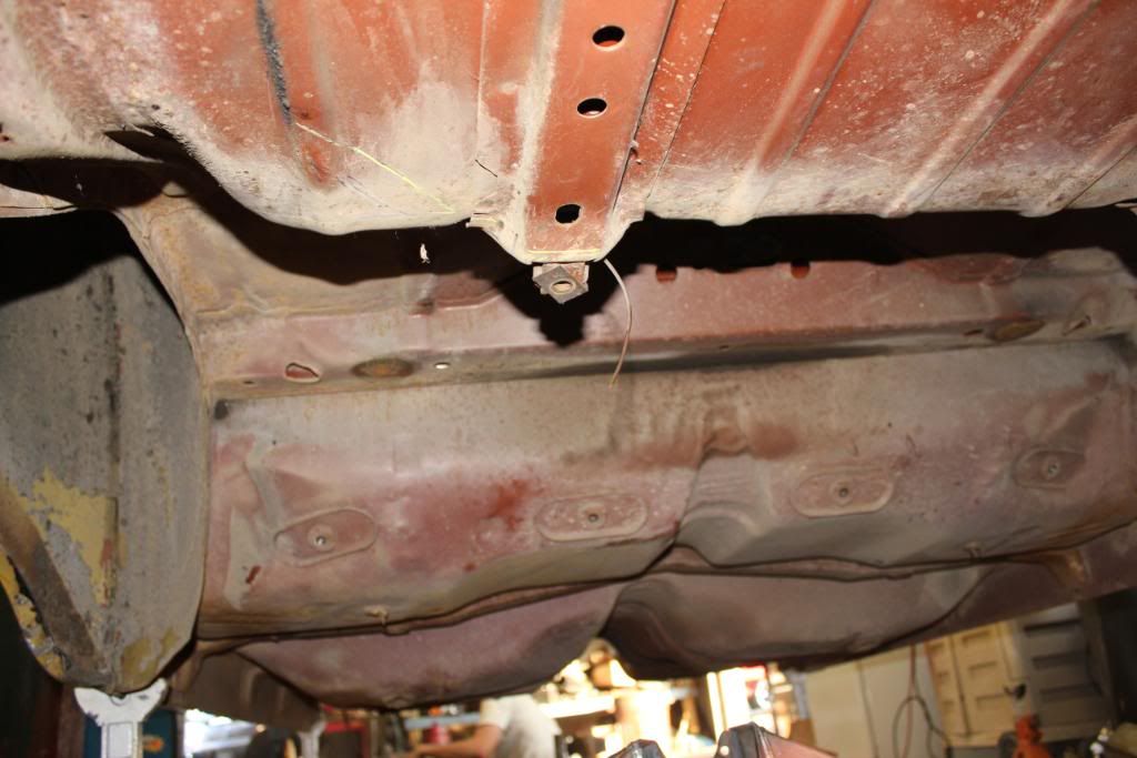

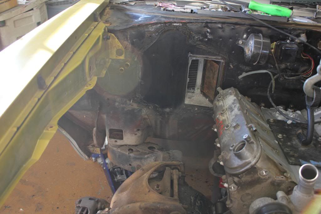

From Sparky: Throughout the build, we are going to update what we've spent on various parts. We want this build to be able to be replicated, so the prices we pay will be what are available all over, rather than just a one-in-a-million deal that no one will ever find again. We will also list the parts we use on Sabre, as well as the companies / locations where we purchase them. The best part will be early next year starting to run Sabre on courses and proving that this project not only works, but will take repeated floggings. Safety though will be of top importance. Brakes, suspension, belts, and other items are being chosen for safety AND performance, not just because they look neat. Here we are getting started on the teardown: http://i813.photobucket.com/albums/z...lecars/002.jpg The 350 removed. The firewall and undercarriage are in surprisingly good shape. I'm used to doing tons of rust repair, but there will be very little of that here. Even the factory red oxide primer is visible on the bottom of the firewall. http://i813.photobucket.com/albums/z...s/IMG_1419.jpg Somewhere underneath all that wiring and ugliness is an iron block 6.0 LQ4. We'll take care of that. http://i813.photobucket.com/albums/z...s/IMG_1417.jpg The seller of this T56 failed to mention it was painted flourescent snot green...that is going to be fun to strip off. http://i813.photobucket.com/albums/z...s/IMG_1418.jpg |

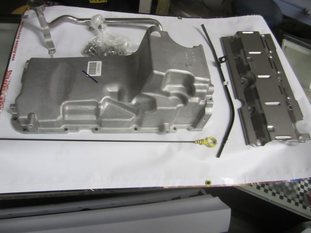

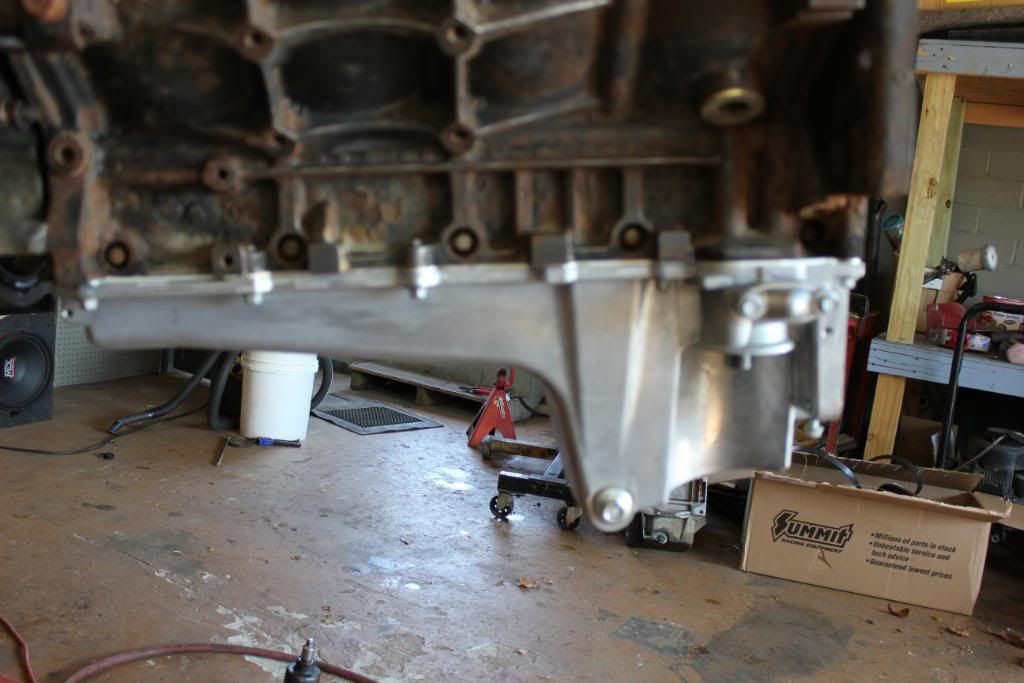

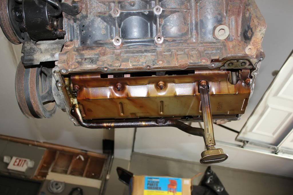

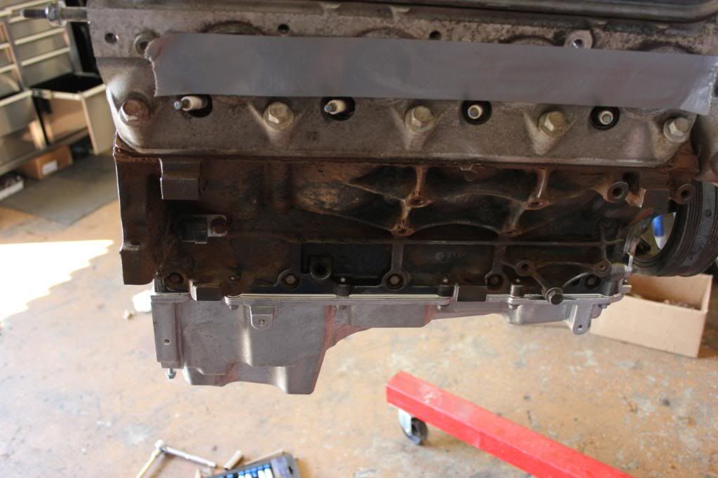

The truck oil pan isn't going to work with the BRP/Musclerods mounts (or anybody's, for that matter), so Sparky ordered the GMPP Musclecar Pan Kit, PN 19212593. This came from our own Jeff Tate at Day's Chevrolet.

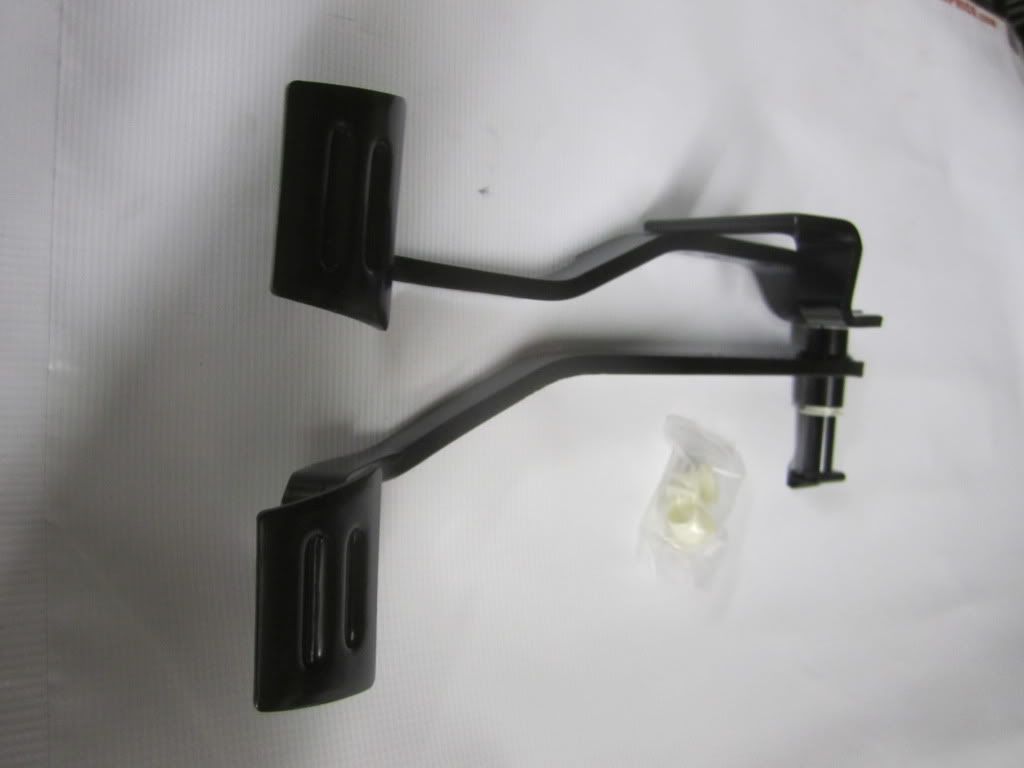

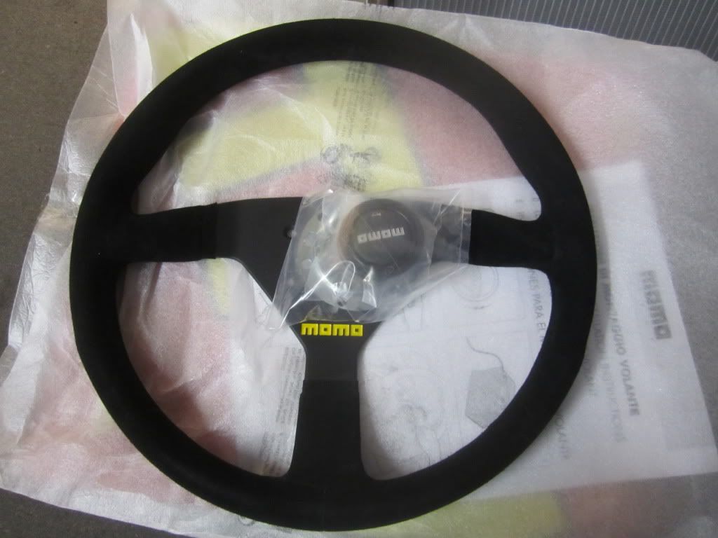

http://i813.photobucket.com/albums/z...s/IMG_1422.jpg The Cutlass had an automatic, so a set of pedals was ordered. http://i813.photobucket.com/albums/z...s/IMG_1421.jpg The stock steering wheel has to go. In its place, this one from Momo. http://i813.photobucket.com/albums/z...s/IMG_1420.jpg |

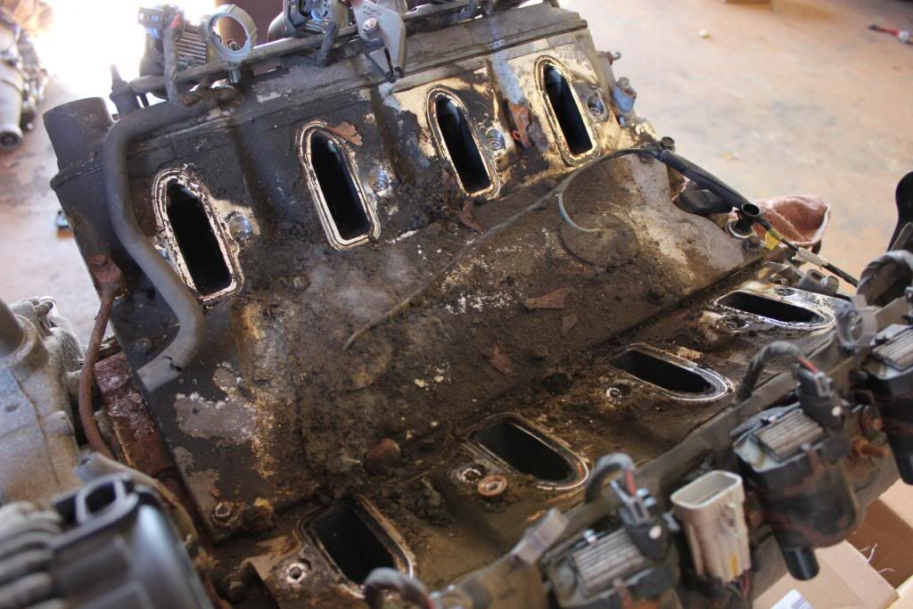

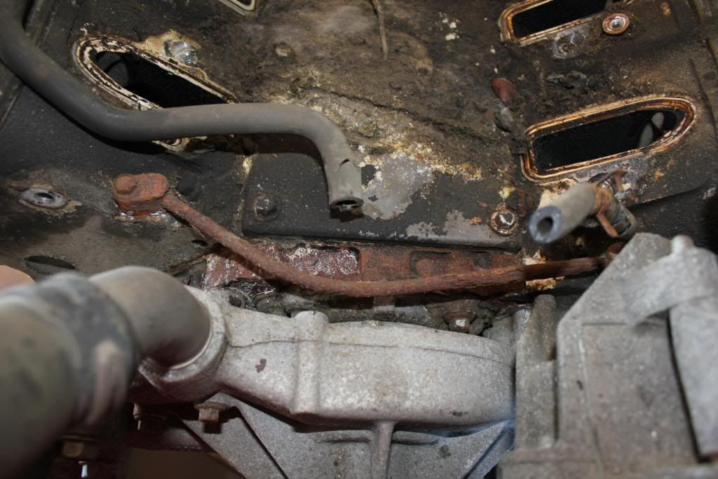

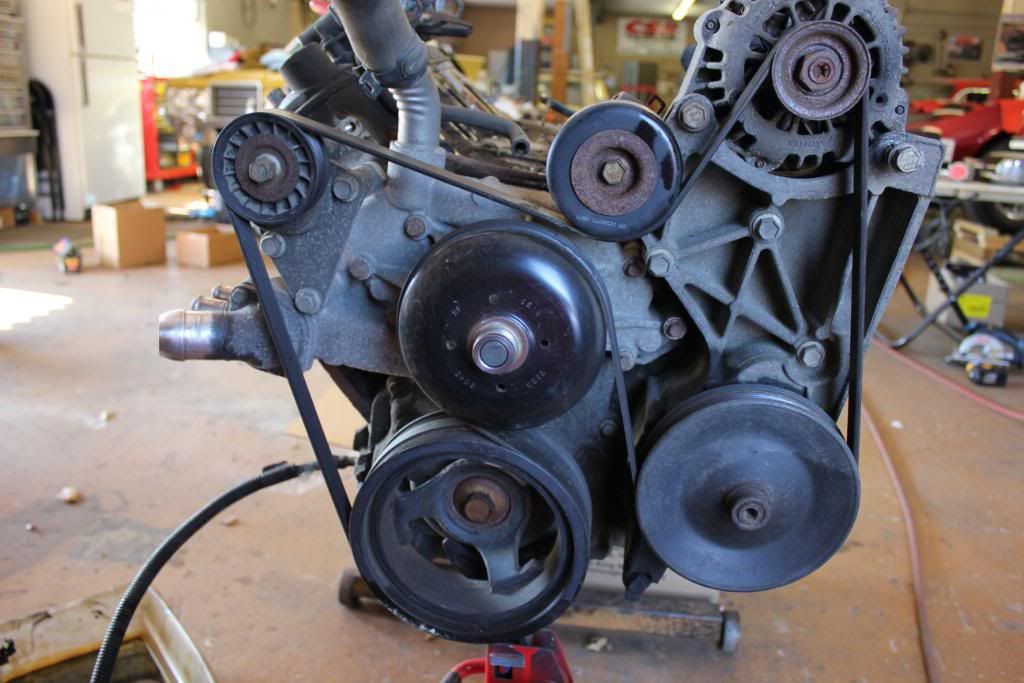

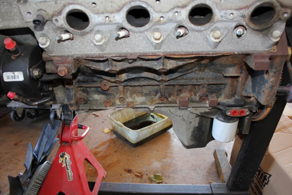

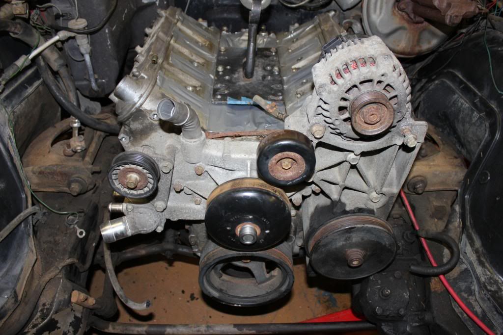

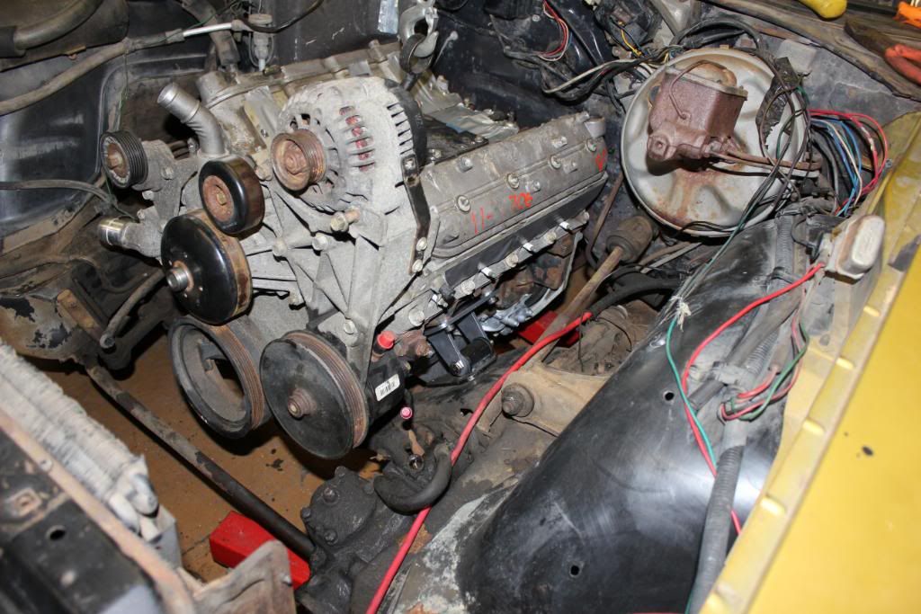

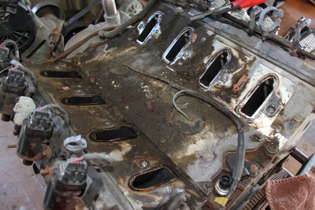

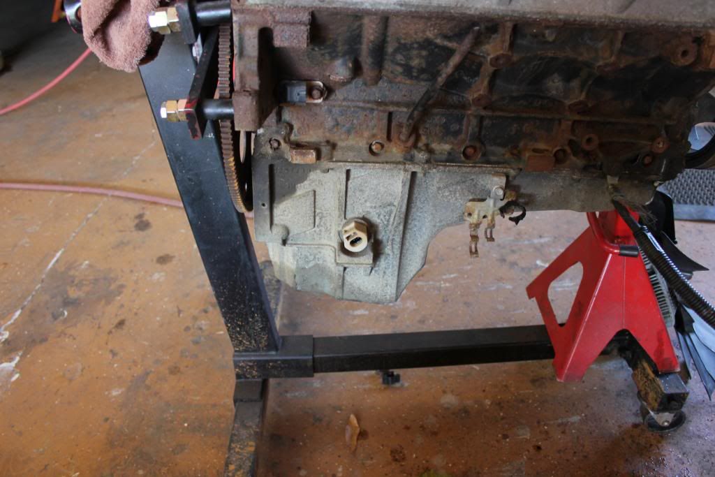

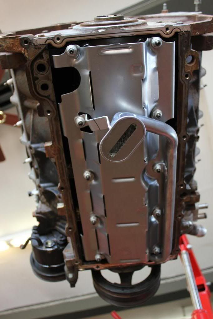

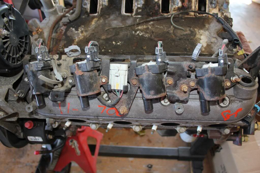

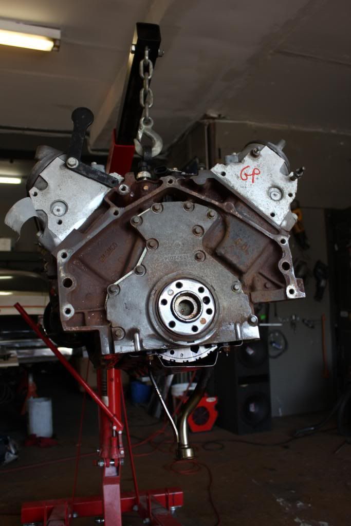

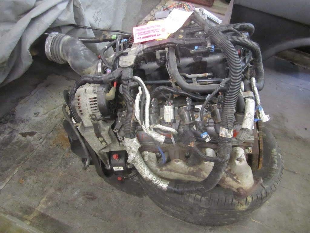

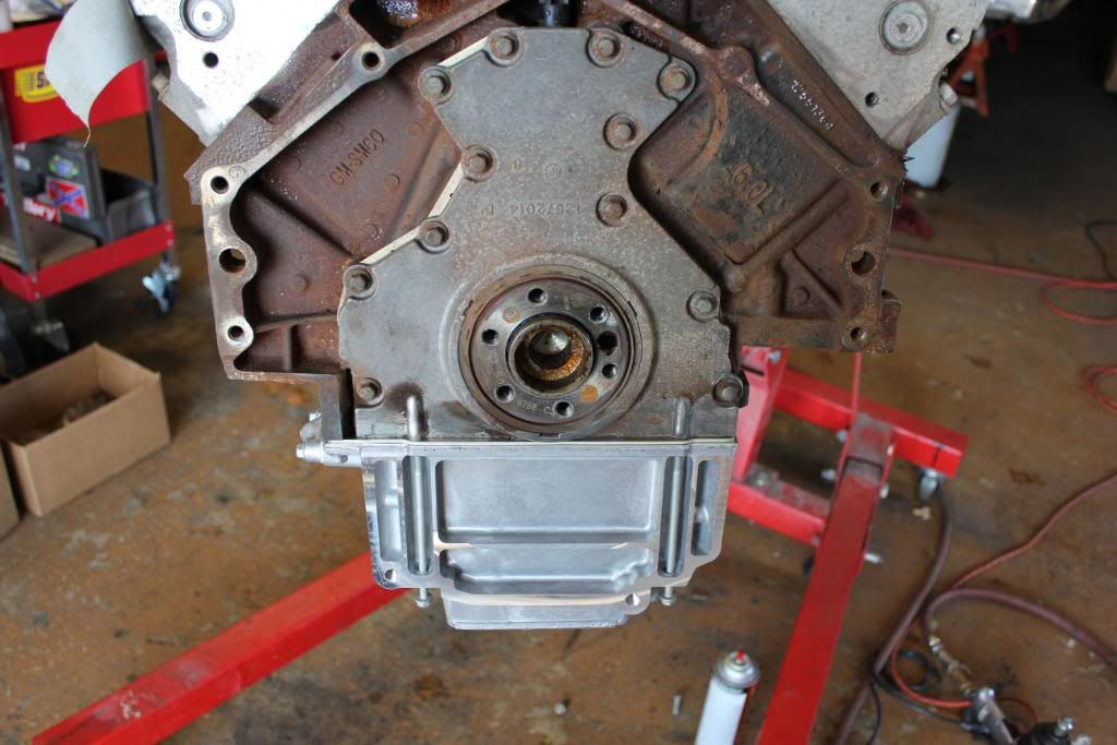

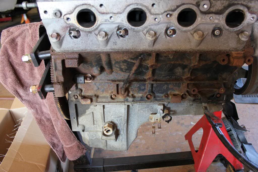

Here are a few pics of the engine, a 6.0 litre LQ4 from an '03 Chevy van. You can tell this isn't a passenger car engine, since it has a mechanical fan, "tall" accessory brackets, and the tall truck-style intake. Plus, it has an iron block. In this pic, I have just removed the intake, and you can see all the accumulated nastiness underneath. A shop vac and a wire brush made quick work of it, though.

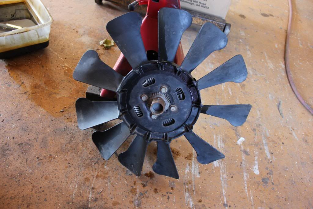

http://i813.photobucket.com/albums/z...e/IMG_0001.jpg The coolant tubes are pretty rusty, too...that'll need to be replaced. http://i813.photobucket.com/albums/z...e/IMG_0002.jpg The fan, which will be replaced with dual electrics, from RnD Fabrication, of course. http://i813.photobucket.com/albums/z...e/IMG_0005.jpg http://i813.photobucket.com/albums/z...e/IMG_0006.jpg http://i813.photobucket.com/albums/z...e/IMG_0007.jpg http://i813.photobucket.com/albums/z...e/IMG_0008.jpg The original truck-style oil pan. http://i813.photobucket.com/albums/z...e/IMG_0009.jpg http://i813.photobucket.com/albums/z...e/IMG_0010.jpg http://i813.photobucket.com/albums/z...e/IMG_0011.jpg And removed... http://i813.photobucket.com/albums/z...e/IMG_0012.jpg The old windage tray and pickup: http://i813.photobucket.com/albums/z...e/IMG_0013.jpg http://i813.photobucket.com/albums/z...e/IMG_0014.jpg The new... http://i813.photobucket.com/albums/z...e/IMG_0015.jpg |

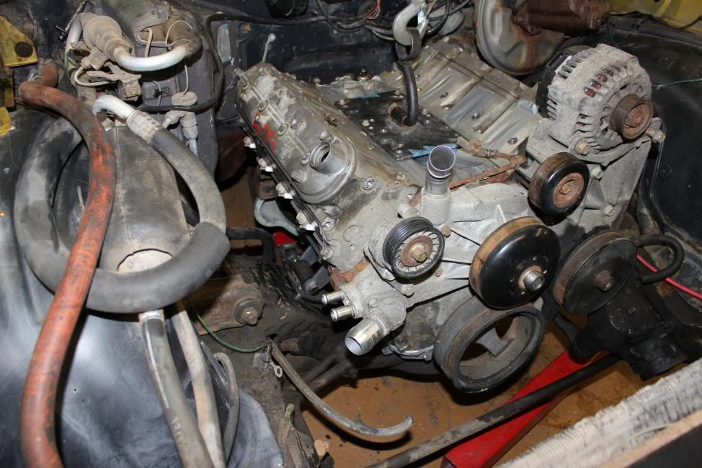

GMPP Musclecar Pan Kit Installed (minus the dipstick and tube; this is just mockup)

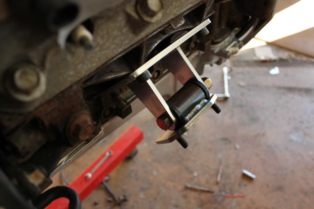

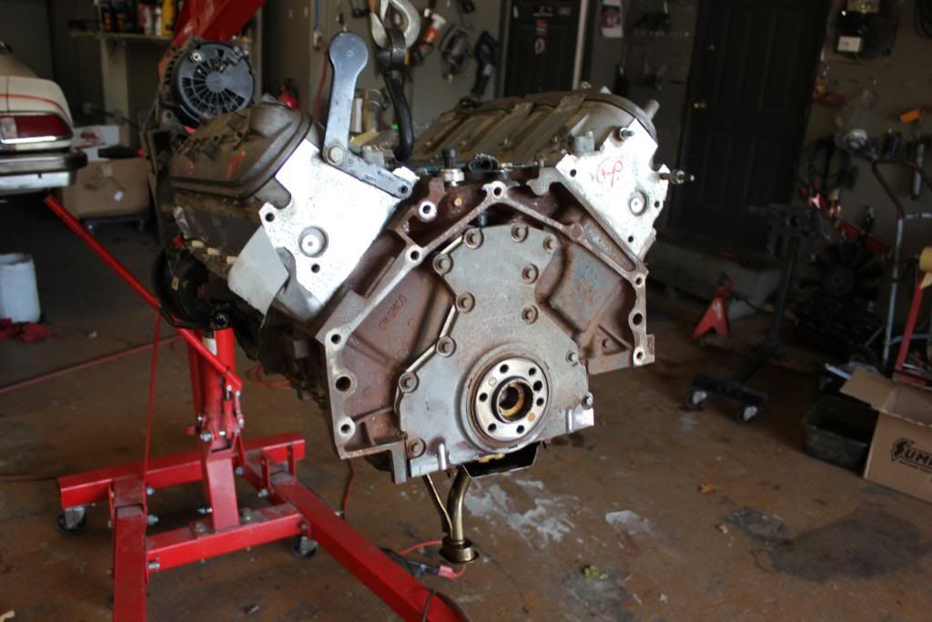

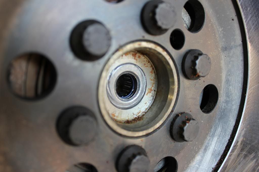

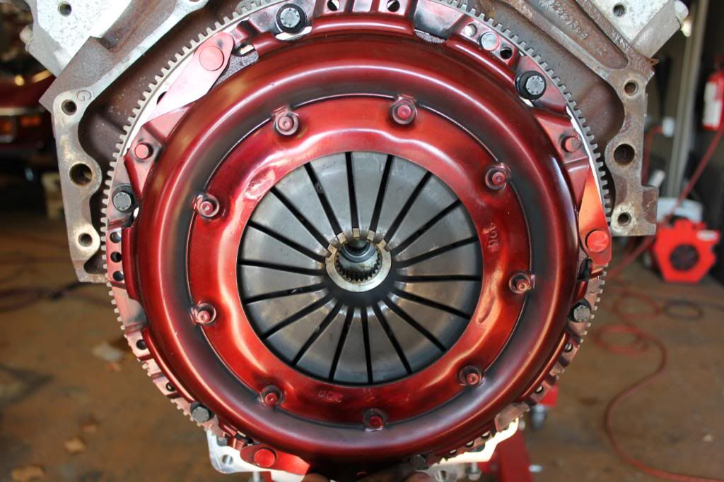

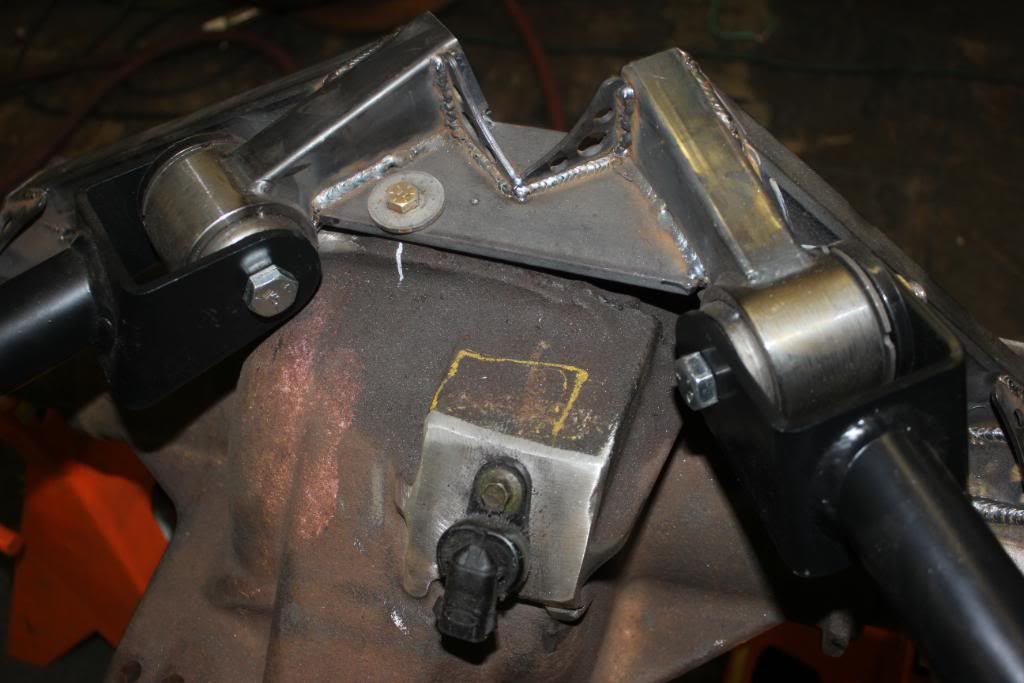

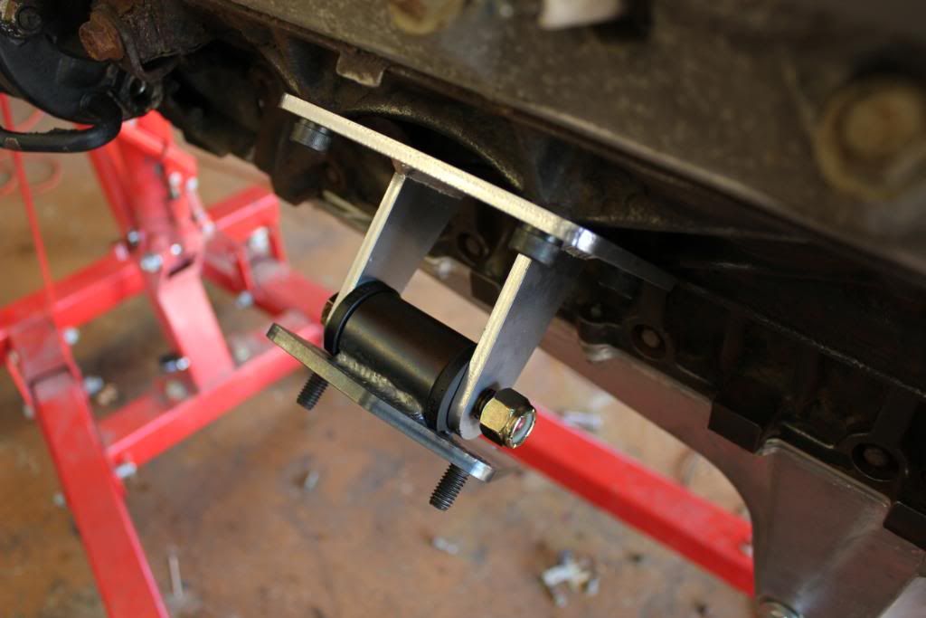

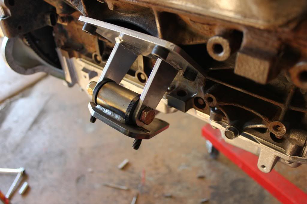

http://i813.photobucket.com/albums/z...e/IMG_0016.jpg http://i813.photobucket.com/albums/z...e/IMG_0017.jpg http://i813.photobucket.com/albums/z...e/IMG_0018.jpg If you're using a T56 with an engine that had an auto, don't forget the pilot bearing: http://i813.photobucket.com/albums/z...e/IMG_0019.jpg Clutch assembly installed http://i813.photobucket.com/albums/z...e/IMG_0020.jpg BRP/Musclerods Motor Mount installed http://i813.photobucket.com/albums/z...e/IMG_0021.jpg http://i813.photobucket.com/albums/z...e/IMG_0022.jpg http://i813.photobucket.com/albums/z...e/IMG_0023.jpg http://i813.photobucket.com/albums/z...e/IMG_0024.jpg |

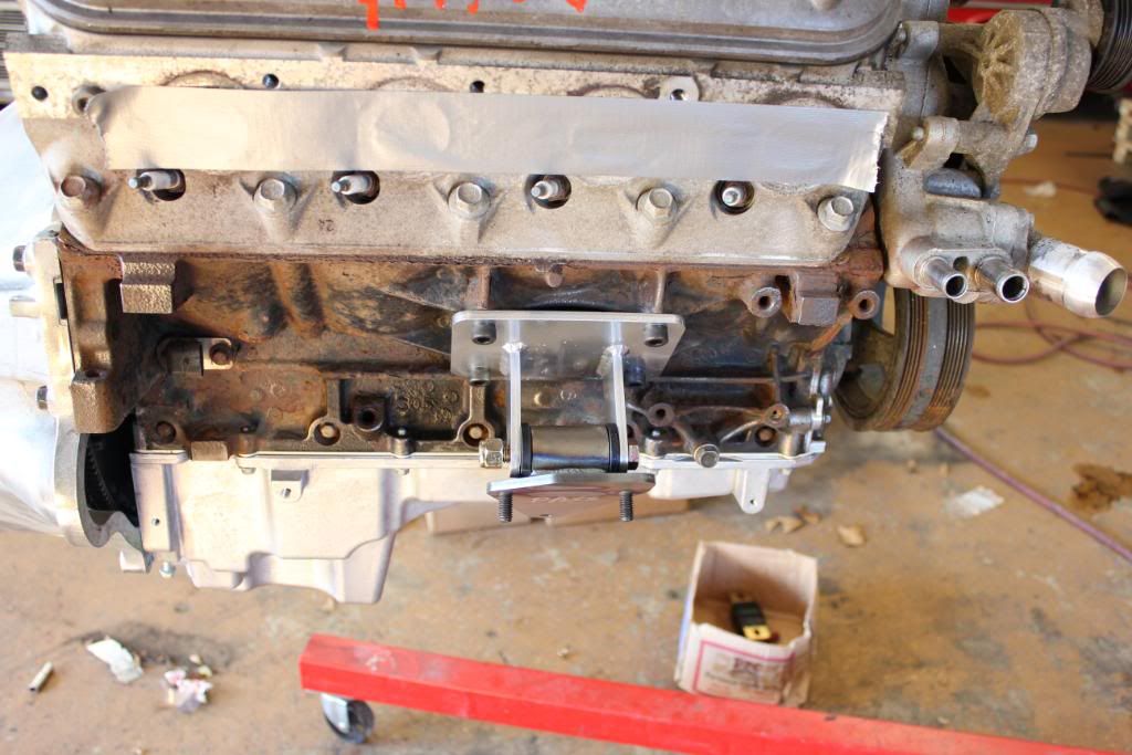

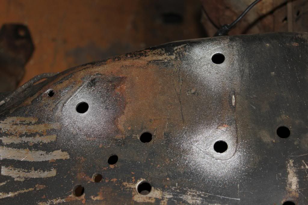

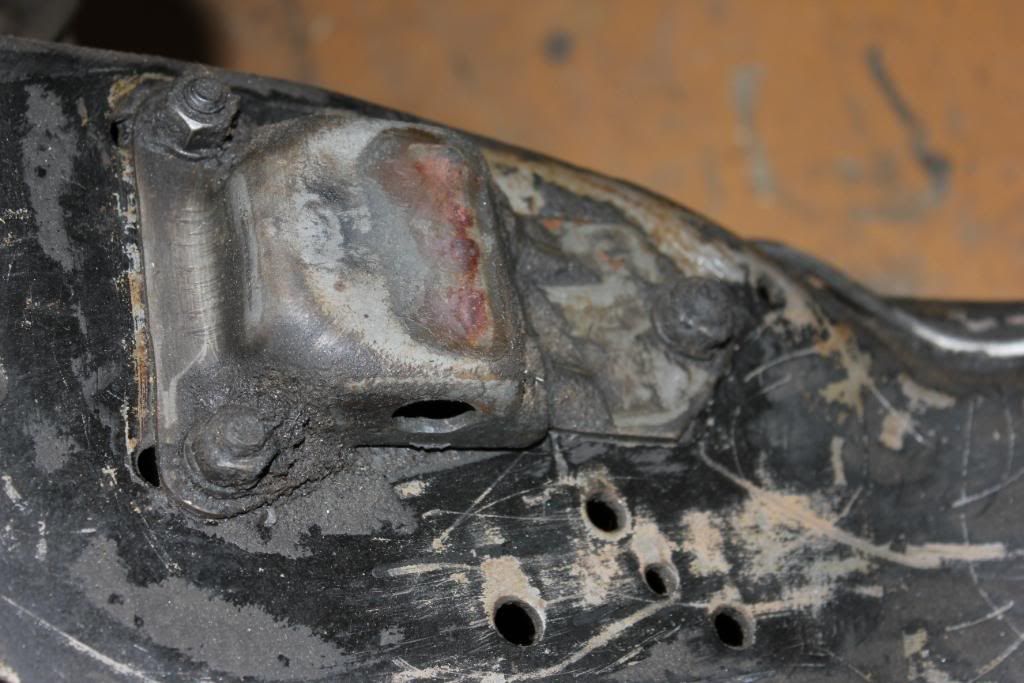

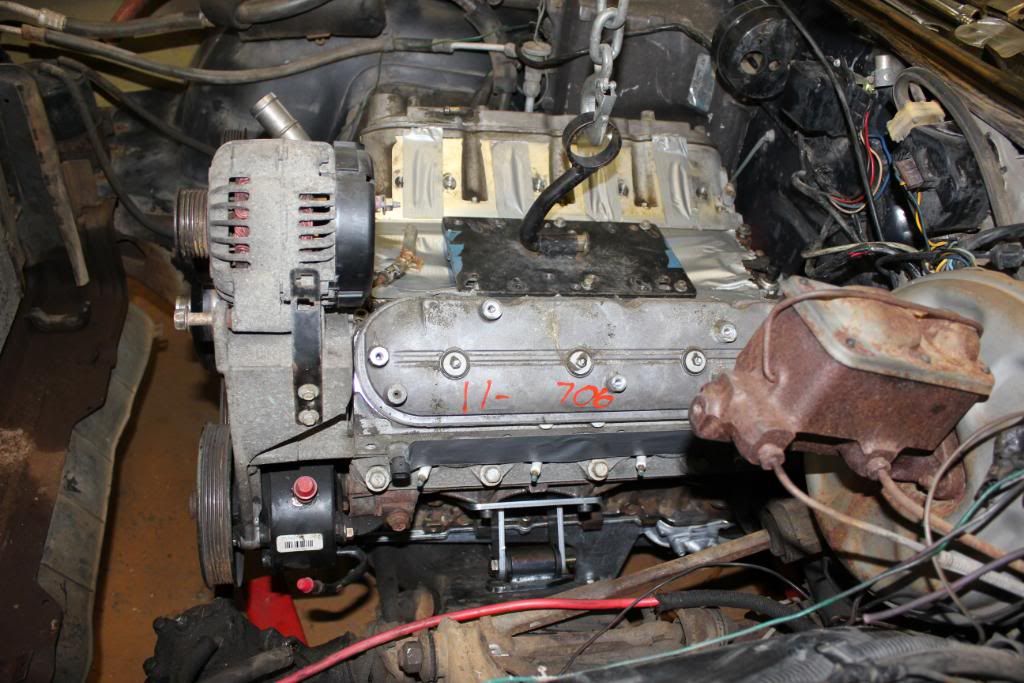

The mounts bolt up to the same ones as the original Olds mounts; no drilling required. I hit the holes with a little silver spray paint for clarity.
http://i813.photobucket.com/albums/z...e/IMG_0025.jpg One of the original mounts http://i813.photobucket.com/albums/z...e/IMG_0026.jpg This shot gives a better idea where the engine mounts up: http://i813.photobucket.com/albums/z...e/IMG_0027.jpg Mocked up (trans isn't in place yet) http://i813.photobucket.com/albums/z...e/IMG_0028.jpg http://i813.photobucket.com/albums/z...e/IMG_0029.jpg http://i813.photobucket.com/albums/z...e/IMG_0030.jpg The last shot shows my trusty TPIS "Happy Hooker"...its an older one, but we drilled it for LS engines as well as several extra carb patterns. http://i813.photobucket.com/albums/z...e/IMG_0031.jpg The old gas tank is also out, but no pics of that yet. |

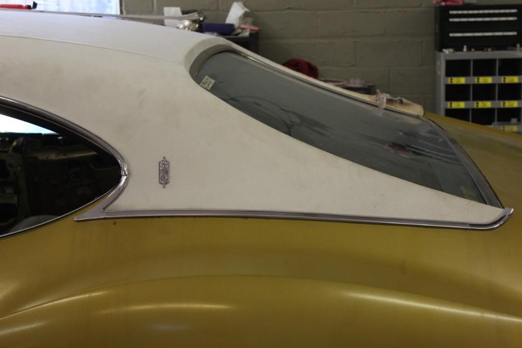

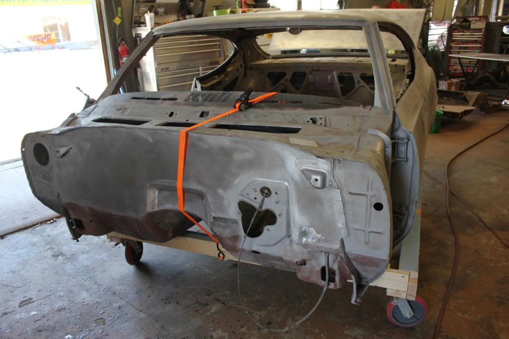

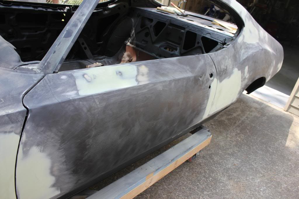

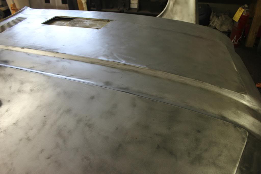

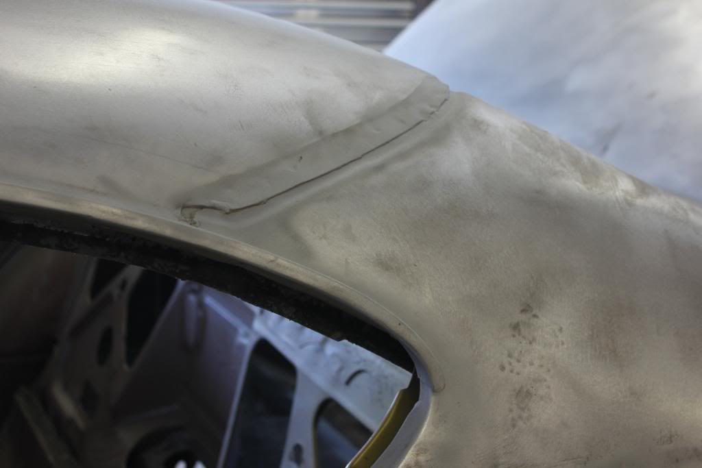

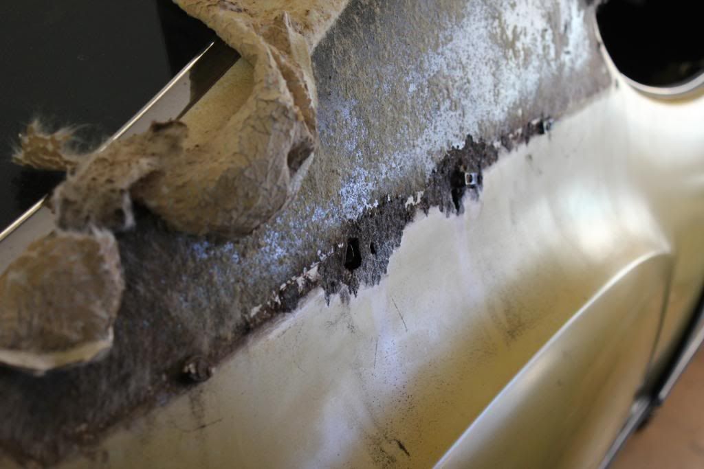

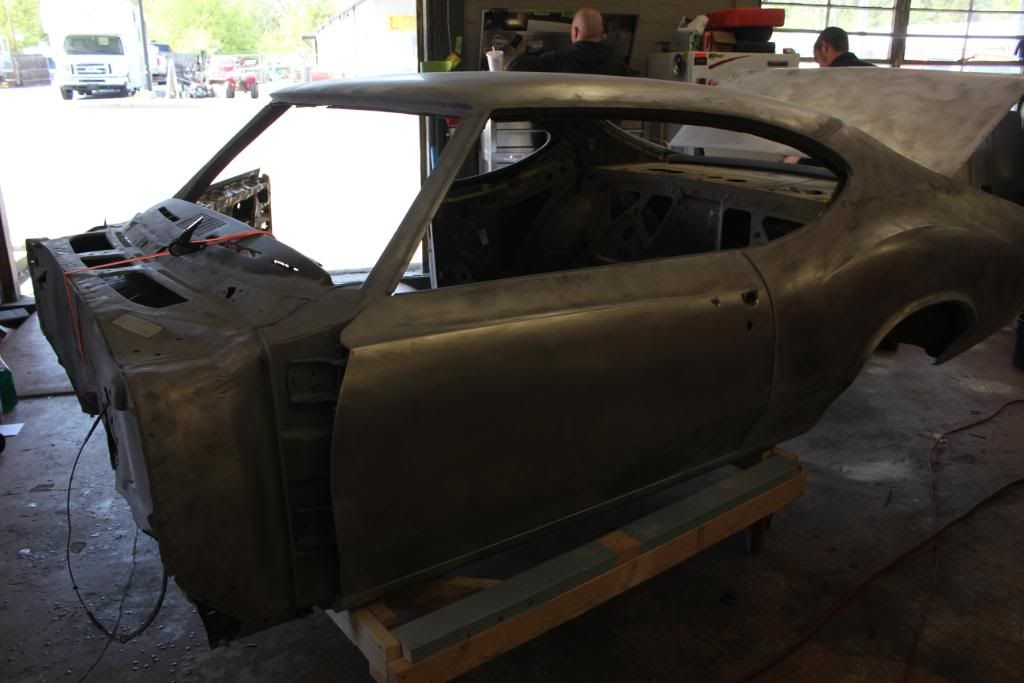

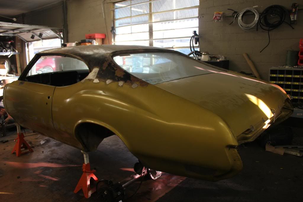

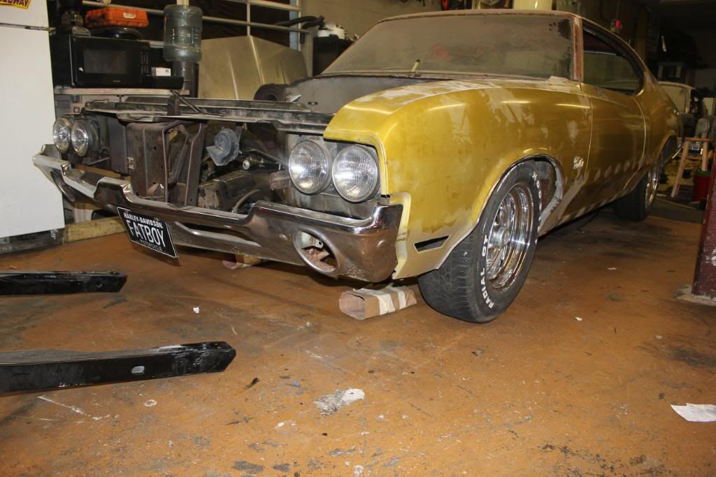

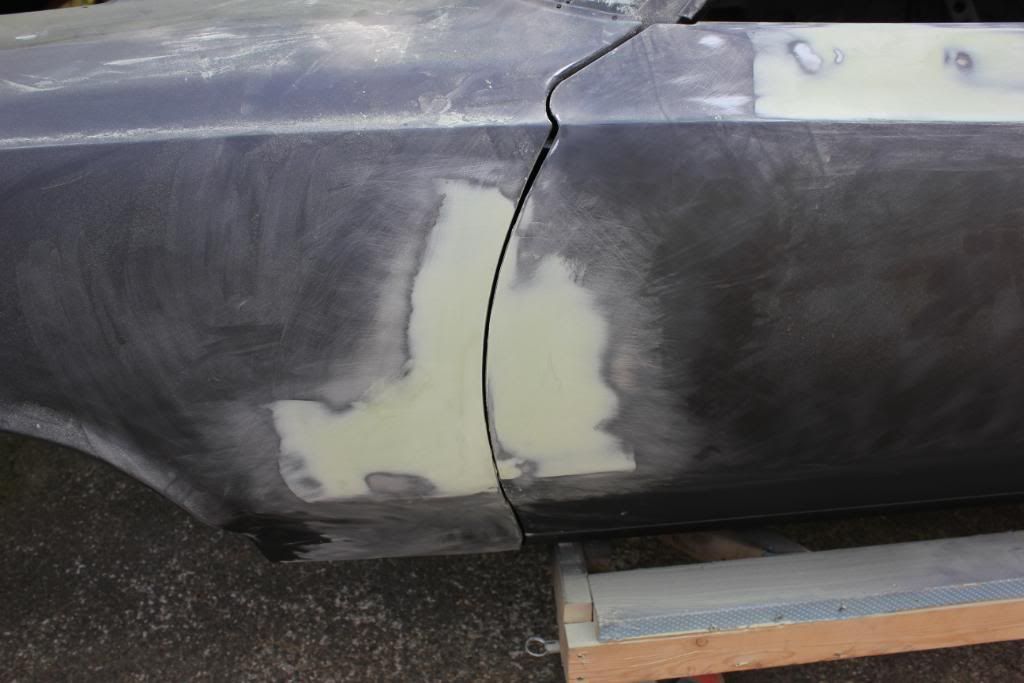

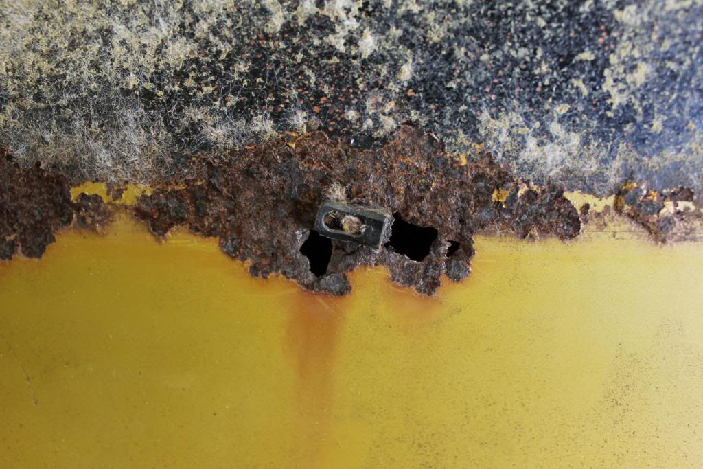

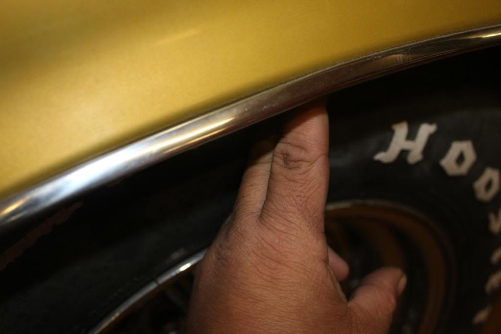

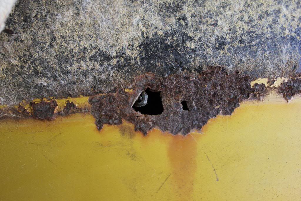

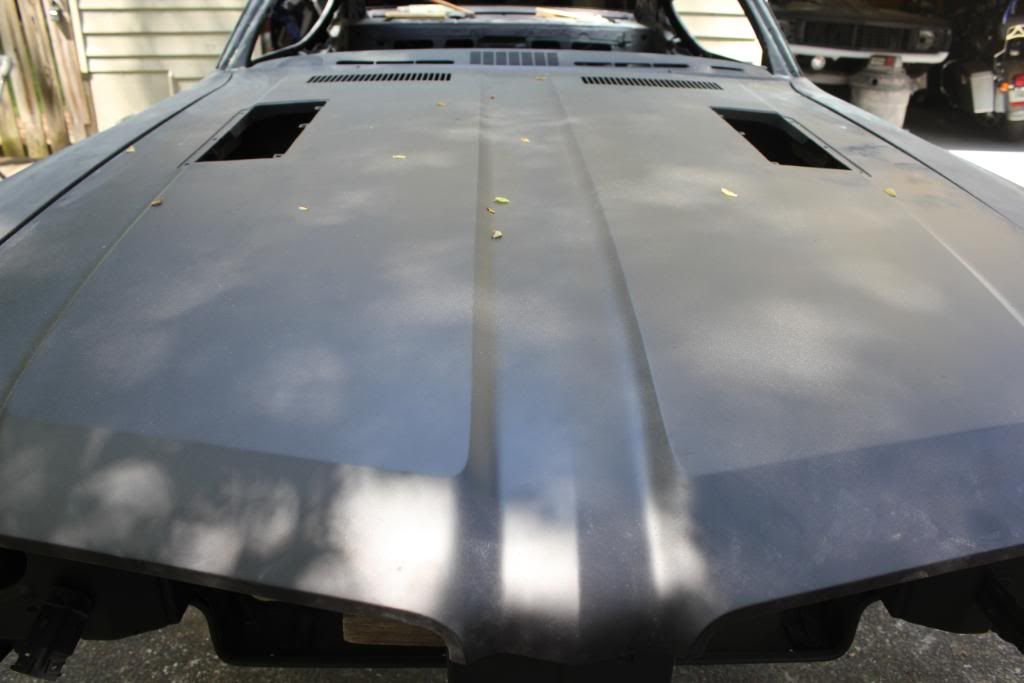

When I saw that Sabre had a vinyl top, I initially cringed...the rust under a vinyl top is usually pretty bad, with lots of pitting in the metal. This one is in very good shape, considering...at least on the driver's side.

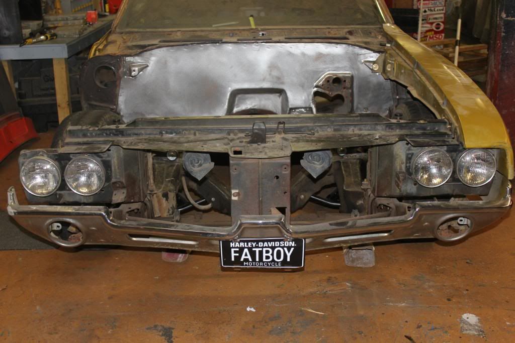

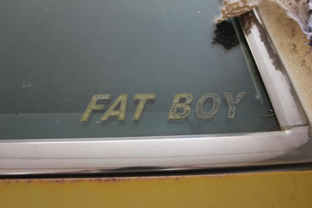

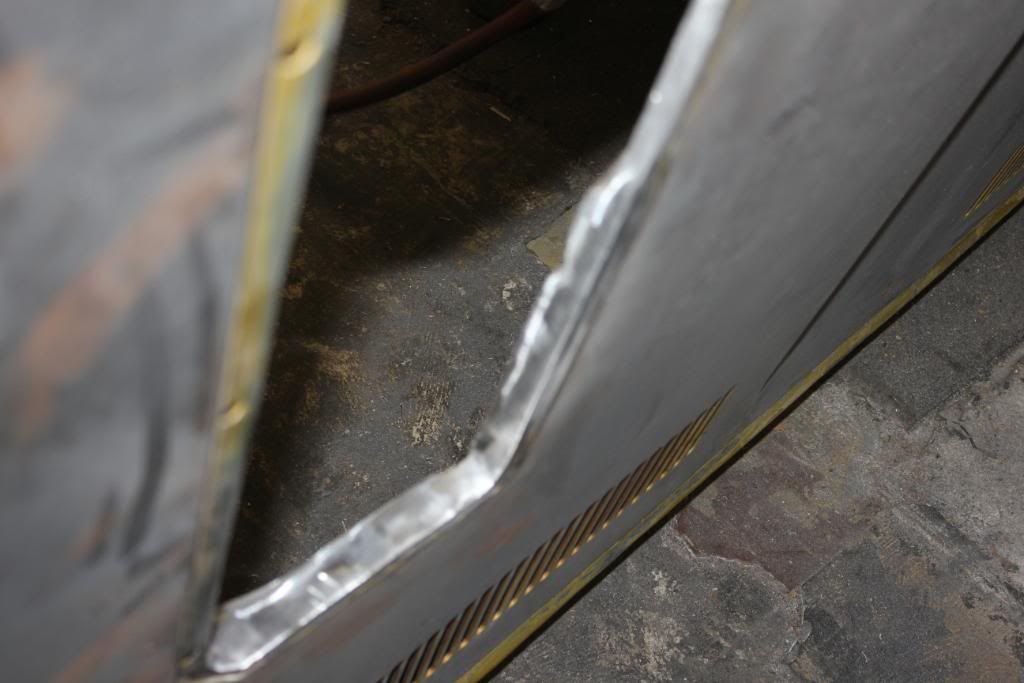

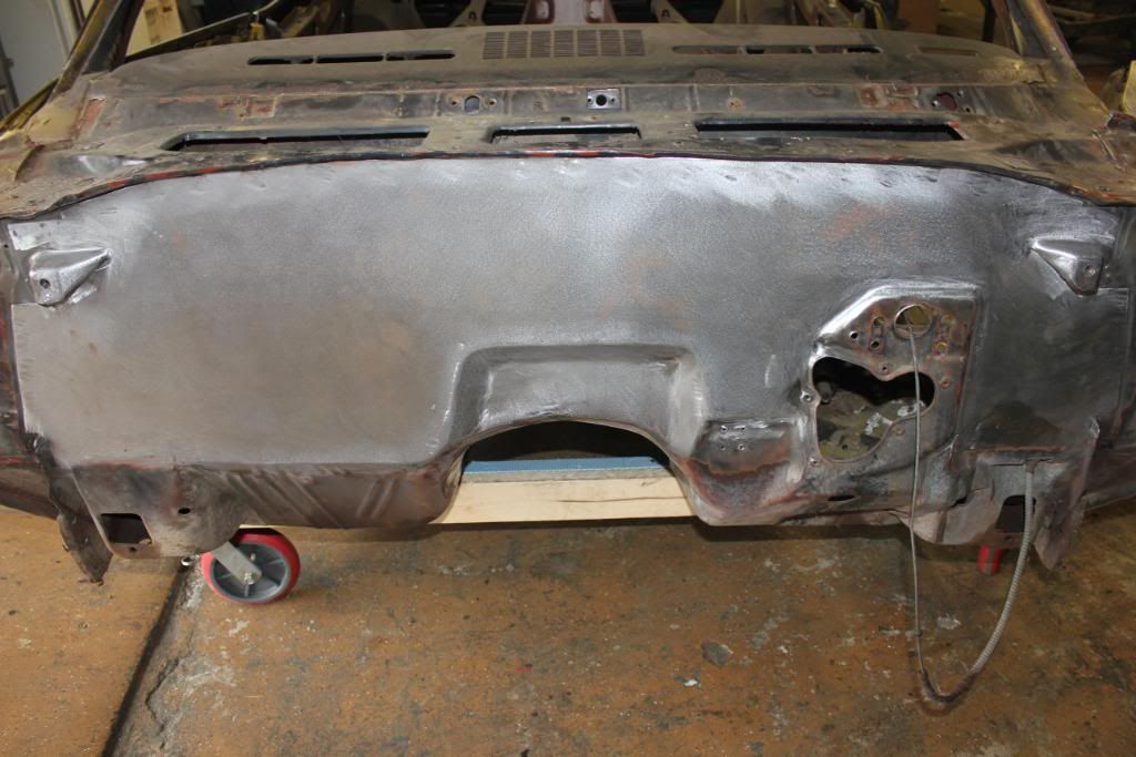

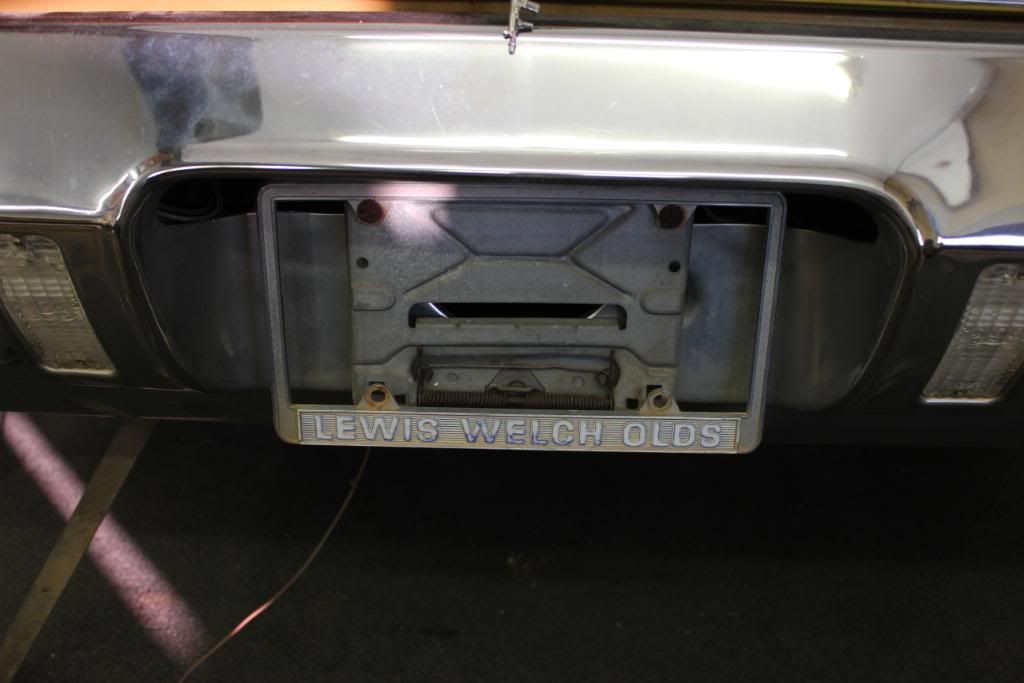

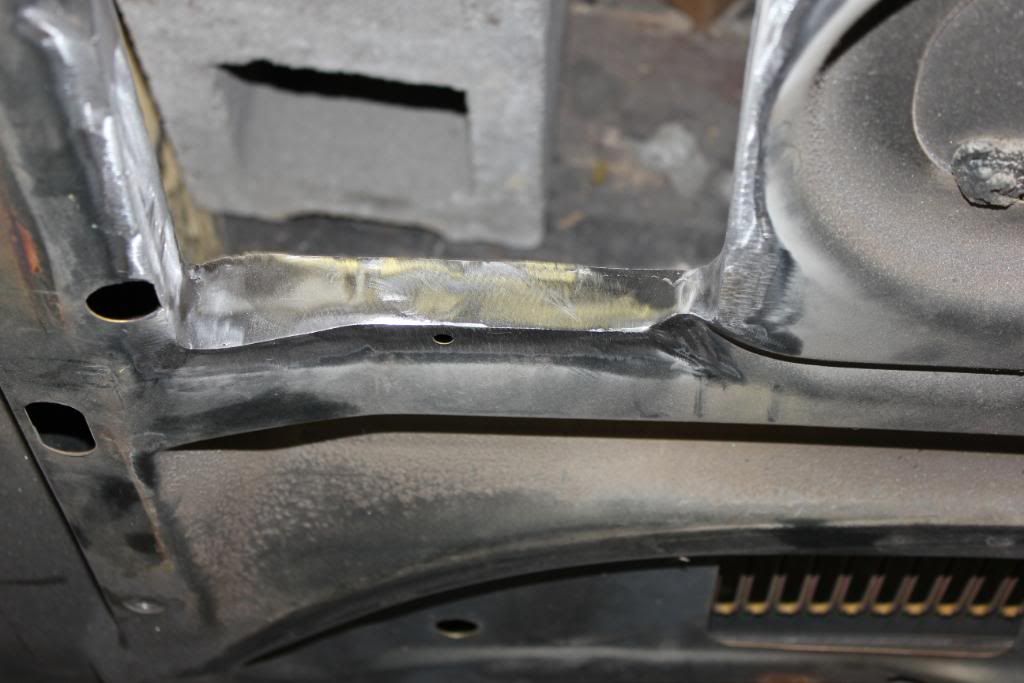

http://i813.photobucket.com/albums/z...e/IMG_0036.jpg The passenger side wasn't quite so good. There was evidence of rust under the bottom molding, and a couple of small holes in the metal. This isn't really that bad, though, and will be easily fixed with a fabricated patch. This is the worst part of the whole car. http://i813.photobucket.com/albums/z...e/IMG_0037.jpg http://i813.photobucket.com/albums/z...e/IMG_0038.jpg http://i813.photobucket.com/albums/z...e/IMG_0039.jpg The previous owner's nickname, apparently... http://i813.photobucket.com/albums/z...e/IMG_0040.jpg We'll be filling the hole in the firewall with a fabricated panel, and adding Vintage Air. http://i813.photobucket.com/albums/z...e/IMG_0042.jpg http://i813.photobucket.com/albums/z...e/IMG_0043.jpg In sort of an odd coincidence, I worked for Lewis Welch Olds briefly in the early '90s. http://i813.photobucket.com/albums/z...e/IMG_0041.jpg |
