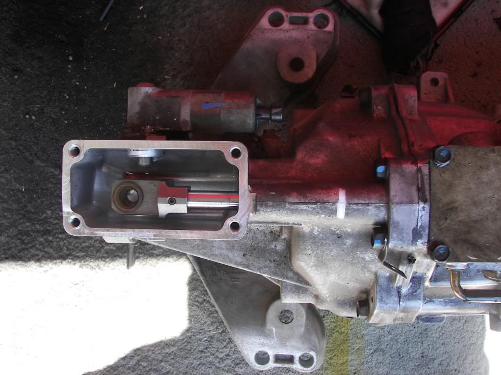

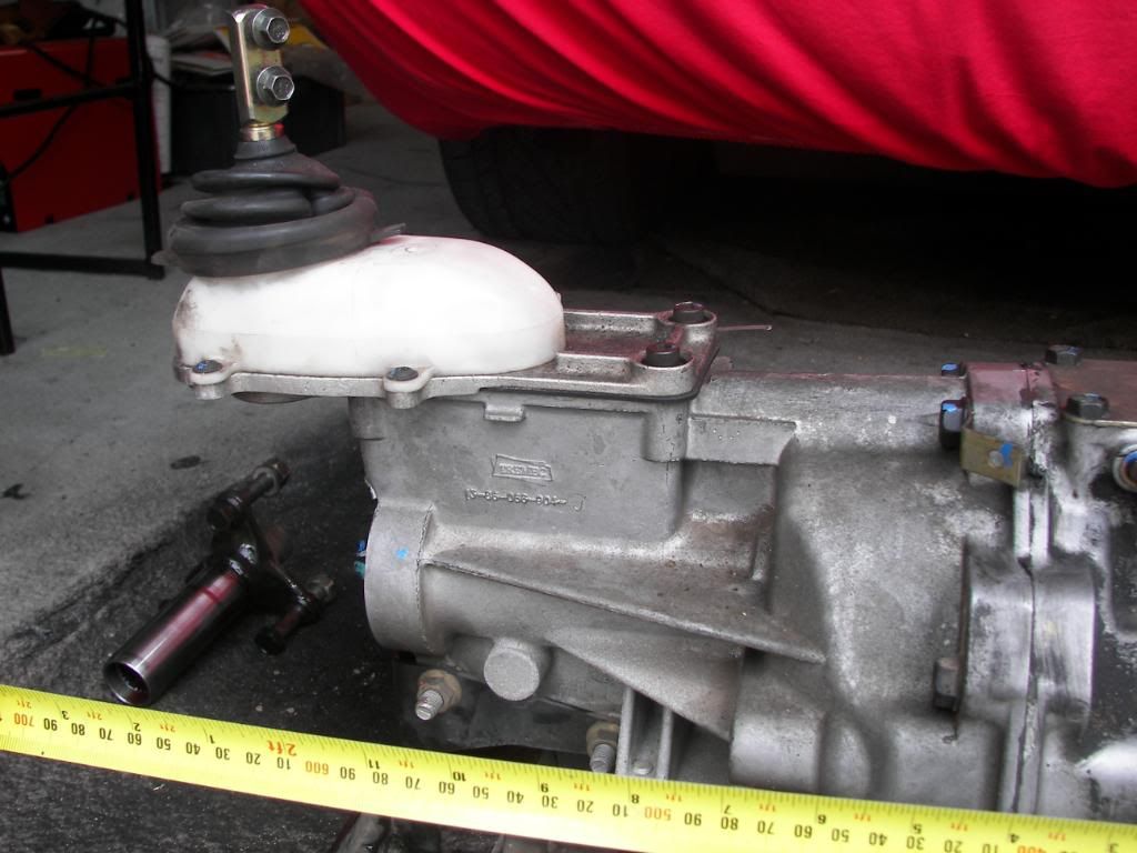

I have here an aussie Ls1 tremec T56 6 speed that needs a shifter. I have looked at most shifter pics (aftermarket ) but they dont look like they have the same size bottom plate which holds shifter to box. These boxes are in the GM Ls1 commodore 2002 model and have the shifter set way back behind the housing.
Can any-one recomend a shifter that will bolt on that will bring it foward as much as possible ? Its going into a Right Hand Drive 69 camaro without a console .
any help is appreciatted .
Gav
http://i221.photobucket.com/albums/d...IFTERX2001.jpg
http://i221.photobucket.com/albums/d...IFTERX2002.jpg
http://i221.photobucket.com/albums/d...OMEFEST025.jpg

Gav, looks like you have a GTO style T56. You can probably use any of the F-body shifters like Hurst, B&M or Mcleod.

I used the Red Roberts (McLeod) shifter on my GTO T56. The offset is 2" left and 2" rearward but it can go forward 2" and up to 2" either left or right from center point. I can get you a better pic if you'd like.

usa-69z 10-31-2011 03:15 PM
that looks perfect ! could you possibly get me some more info please???
maybe the measurements of the plate ?
mine is L= 5 5/8 by w= 2 7/8 aprox
also a link or where do i find these and whats this product called.. thanx !
BBPanel 10-31-2011 03:35 PM
Its a std f-body plate. I bought mine directly from Red (he works out of his garage to make them) but they are on McLeod's site also:
http://www.mcleodracing.com/categories/Shifters.mcl There isn't one pictured for the T56.
Just in case you don't know Red founded the company in 1971. If you call McLeod tech support Red is often there answering questions.
Should also mention his shifter does not require changing out the ball recepticle (I forgot the "correct" name for it).
