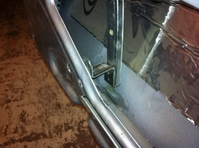

I have no idea what is the correct name of this adjuster screw on pic below ( from chevelle ) but i have lost mine and cant find it as repop for 69 camaro anywhere:willy:
http://i4.photobucket.com/albums/y14...i/Adjuster.jpg And it goes here between the door frame and lower end of the window frame http://i4.photobucket.com/albums/y14.../adjuster2.jpg Ideas?? |
If u are working on a 69 Camaro they are not used on the doors but they are used on the quarter Windows

Are you really sure? If not how is lower part of the window channel mounted and angle of the door window adjusted? |

I'm sure I just built the doors on one of my 69's it bolts to the bottom and it adjusts at the top where it bolts up should be slotted now the quarter Windows use 3 of those per side to adjust
Thanks guys, double checked it in AIM and there are no adjuster screws in doors !
