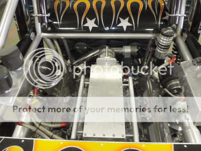

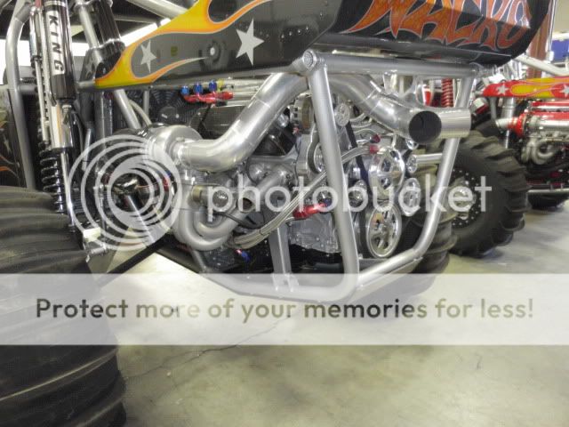

I'm going to run the same engine as we do in our sand rails.
http://i548.photobucket.com/albums/i...i/P5260604.jpg
http://i548.photobucket.com/albums/i...i/P5260605.jpg
http://i548.photobucket.com/albums/i...i/P5260606.jpg
