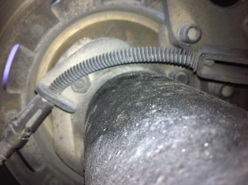

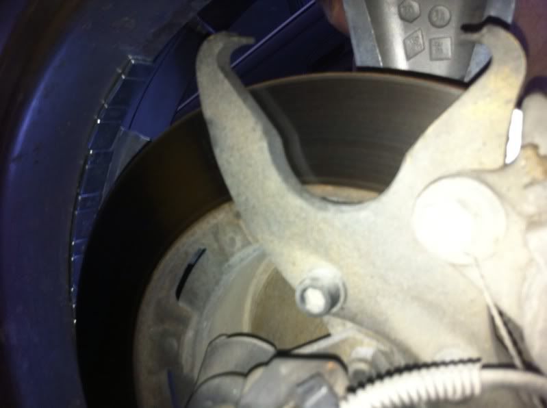

OZ Duster 11-21-2011 12:55 AM
Camaro Wilwood park brake
Can anyone advise what is needed to hook up a park brake for Wilwood brakes. The park brake cable is not hooked up to the rear brake at all. The following photo shows the mounting plate for the caliper. Dont know what is needed as nothing is identified on the Wilwood site. Is there a cable operated caliper in adittion to the hydraulic caliper?
http://i75.photobucket.com/albums/i2...A/b68c2231.jpg
http://i75.photobucket.com/albums/i2...A/91977877.jpg

tandk22 12-14-2011 11:50 PM
I am running a 9" rear end on my 69 with 12", 4 piston wilwood setup on the rear with stock leafs and stock parking brake pedel and cable no problems. Had to have my father inlaw make me an adapter to fit the stock cable to the wilwood parking brake. I have the drum style parking brake. Todd
