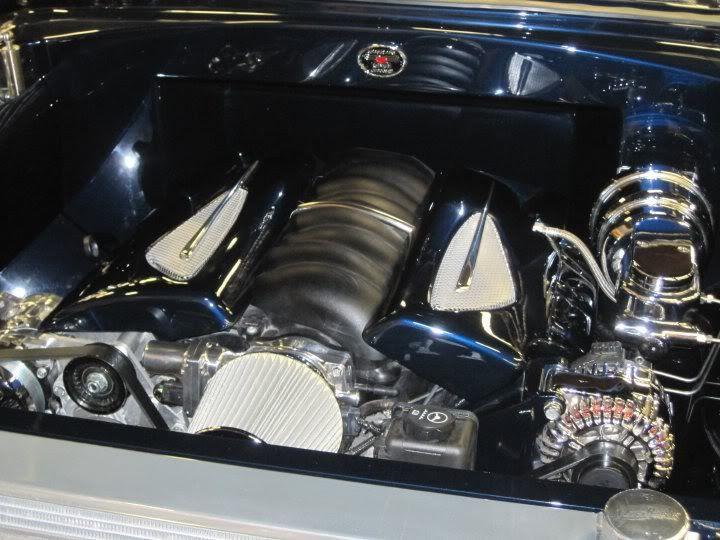

Heartland Customs presents "Blue Belle"
Built by Heartland Customs
Complete build time - 13 months
www.Heartlandcustoms.us

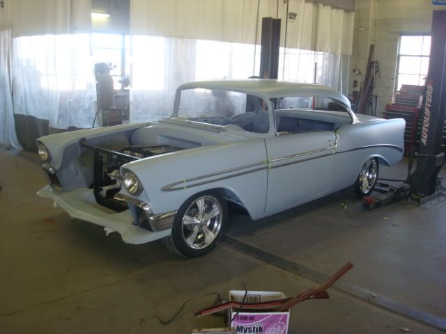

Complete frame off rotisserie restoration
Every single thing in this car is brand new except the body and the trim, every nut and bolt is new and stainless steel
Custom built Art Morrison chassis with coilover suspension
Chassis is painted to match the body

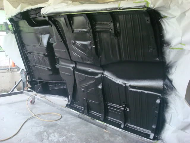

Under body is slick undercoated and painted to match
Strange Engineering Ford 9" Rearend with 31 spline axles
Stainless steel brake and fuel lines
Stainless steel fuel tank
Centech wiring harness
All external lights except headlights are L.E.D.
Halogen Headlights
12" Rotors with Wilwood disc brakes and chrome calipers
Power rack and pinion steering
Custom built, ceramic coated 2.5" Borla exhaust system with chrome tips
Custom ceramic coated headers
Corvette crate LS3/450hp Crate 4L60E automatic transmission
Intro wheels - 17x8, and 18x10
Toyo T1R tires - 245/45/17, 275/40/18
PPG Black Sapphire Metallic paint
All original trim refinished and polished
Billet hood hinges
Custom inner fenders with hinge pockets
Custom smooth firewall
Smoked glass
Chrome engine accessories
Vintage A/C and heat with defrost
Cruise control

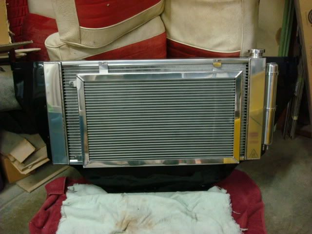

Custom polished aluminum radiator and condenser
Custom built core support
Chrome master cylinder and booster
All wiring and A/C and heater lines are hidden inside the custom inner fenders

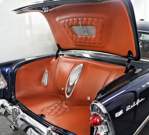

Interior

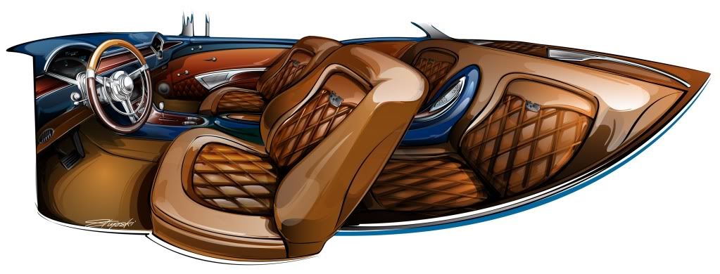

Completely custom designed interior and trunk
Saddle Italian leather
25 one off billet parts and mesh
Custom clear coated real red rosewood accents-not hydrographics or laminate
Custom shifter handle
Custom steering wheel with rosewood and leather split grip
Polished Ididit column
Full length console that splits rear seat into two bucket seats
Dakota digital gauges
Custom stereo system with Ipod and bluetooth
German square weave carpet
Custom headliner with billet and rosewood accents
Billet knobs and cranks
Billet A/C controls
Billet A/C vents with custom enclosures
Custom kickpanels with one off billet speaker grilles
Custom pakage tray with one off billet speaker grilles that match door panels
Custom designed door panels with one off billet and rosewood accents
Custom built seats with Bentley diamond pattern inserts
Custom leather sill plates with BelAir emblems
Custom designed smooth dash with glove box delete
All interior panels smoothed and painted then cleared with soft touch clear

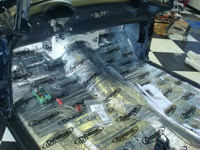

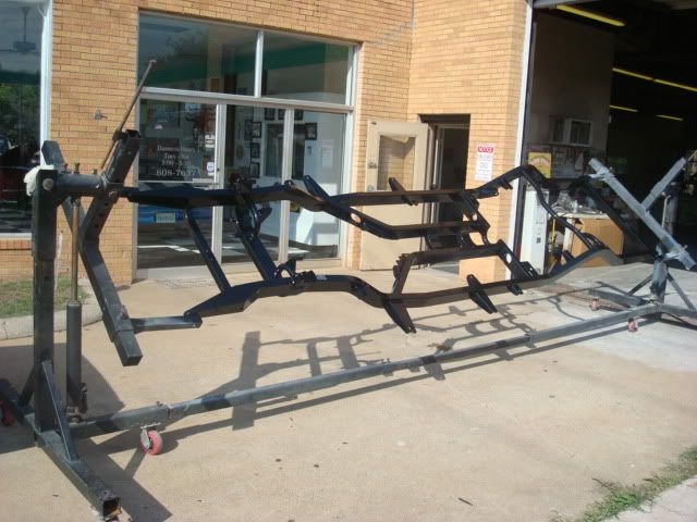

Heartlandrods 11-30-2011 07:06 PM

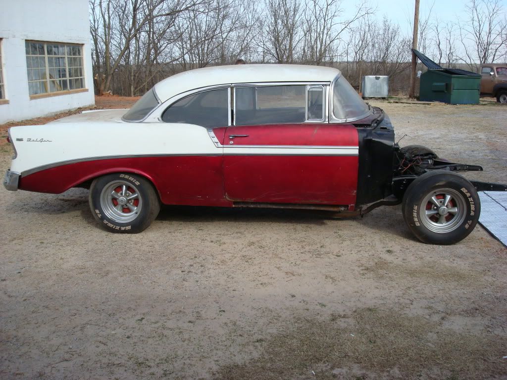

Donor Car
http://i1228.photobucket.com/albums/...e/DSC00258.jpg
http://i1228.photobucket.com/albums/...e/DSC00260.jpg
