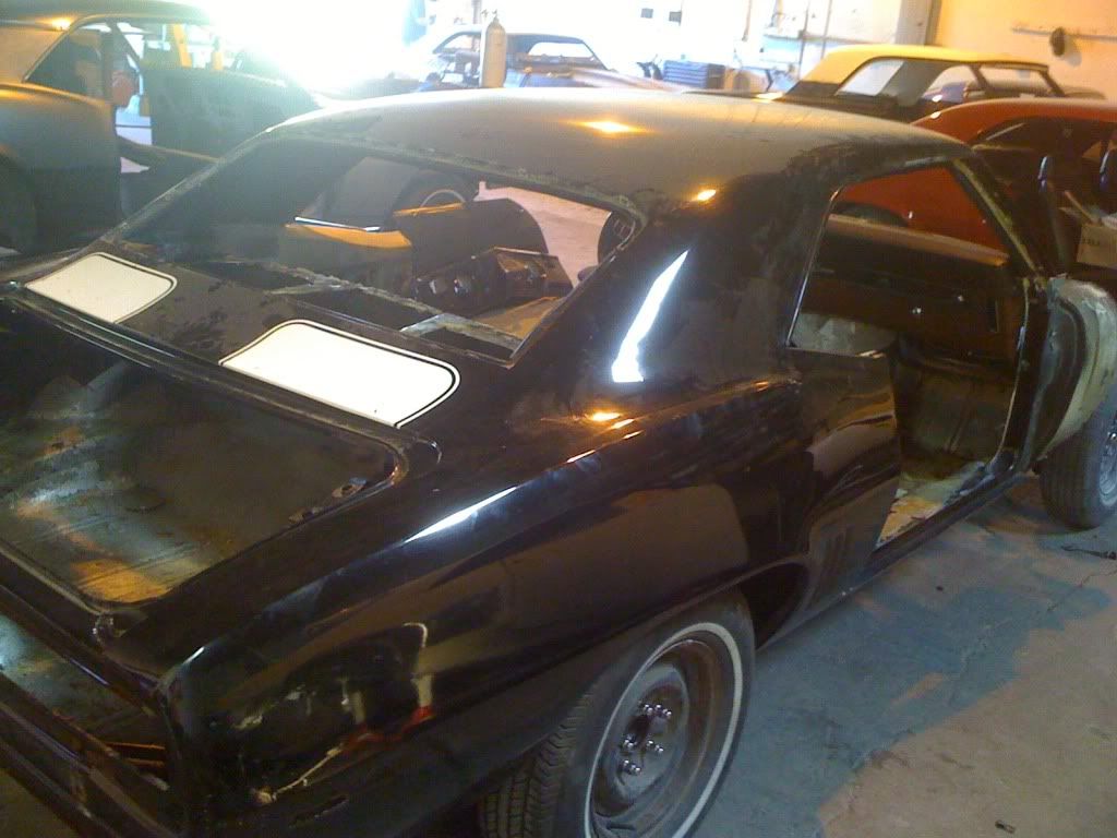

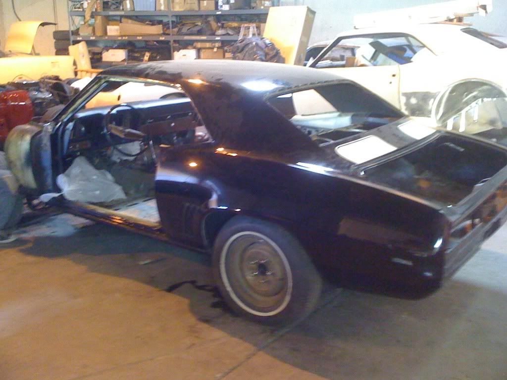

Well about 4 years ago now I was able to pull the trigger and picked up a really nice 69 Camaro badged as a Z/28. She was a beautiful black with white rally’s, had deluxe houndstooth interior with a good start on the suspension including 4 wheel disc brakes and Hotchkis drop spring. The 350 was solid but with the TH350 and a 3.42 12 bolt it was slow out of the hole and around town.
http://i855.photobucket.com/albums/a...oolcars-40.jpg
http://i855.photobucket.com/albums/a...rointerior.jpg
The car came with records and receipts dating back about 15 years so I had an idea of how it got to its current state. The paint was a great 5 footer… had some checking in the lacquer paint and some rust over both rear wheel wells. Soon the itch and inability to leave well enough alone took over and I started checking in to what it would cost to fix the rust and checking.

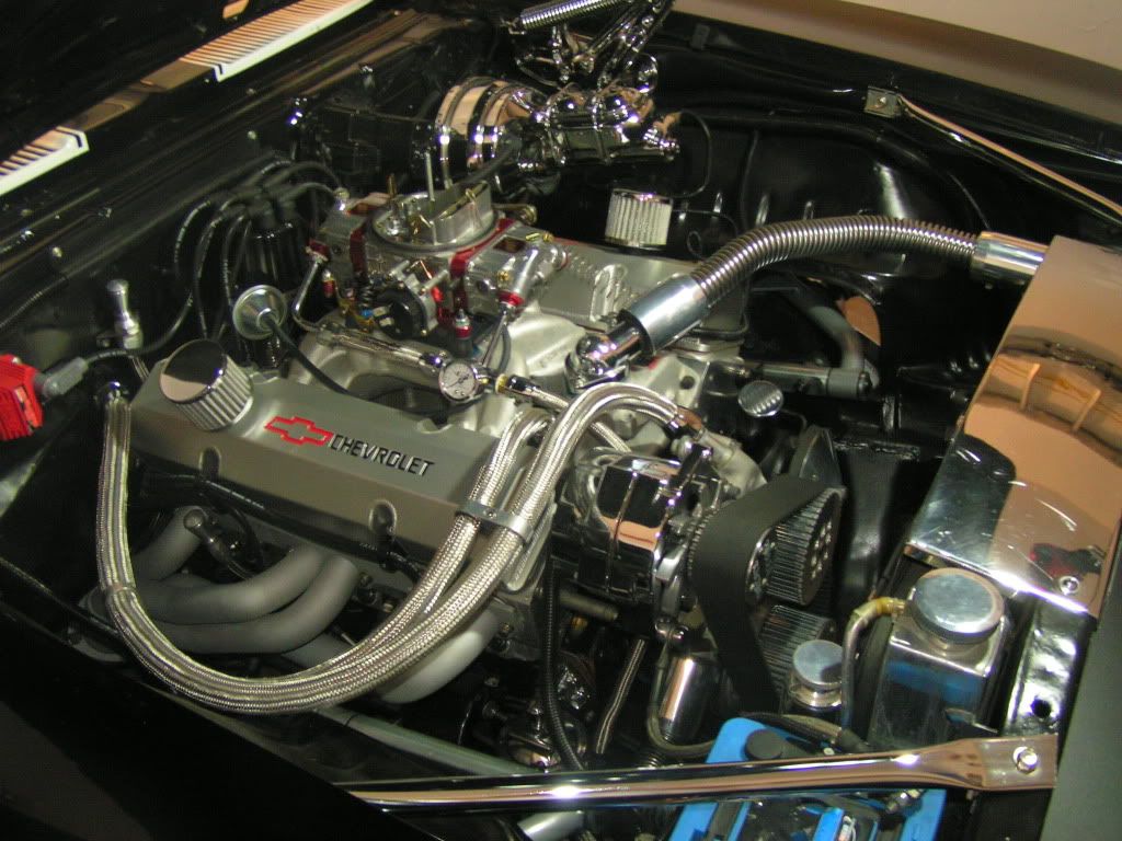

Started with this - love the belt drive BTW
http://i855.photobucket.com/albums/a...oolcars-02.jpg

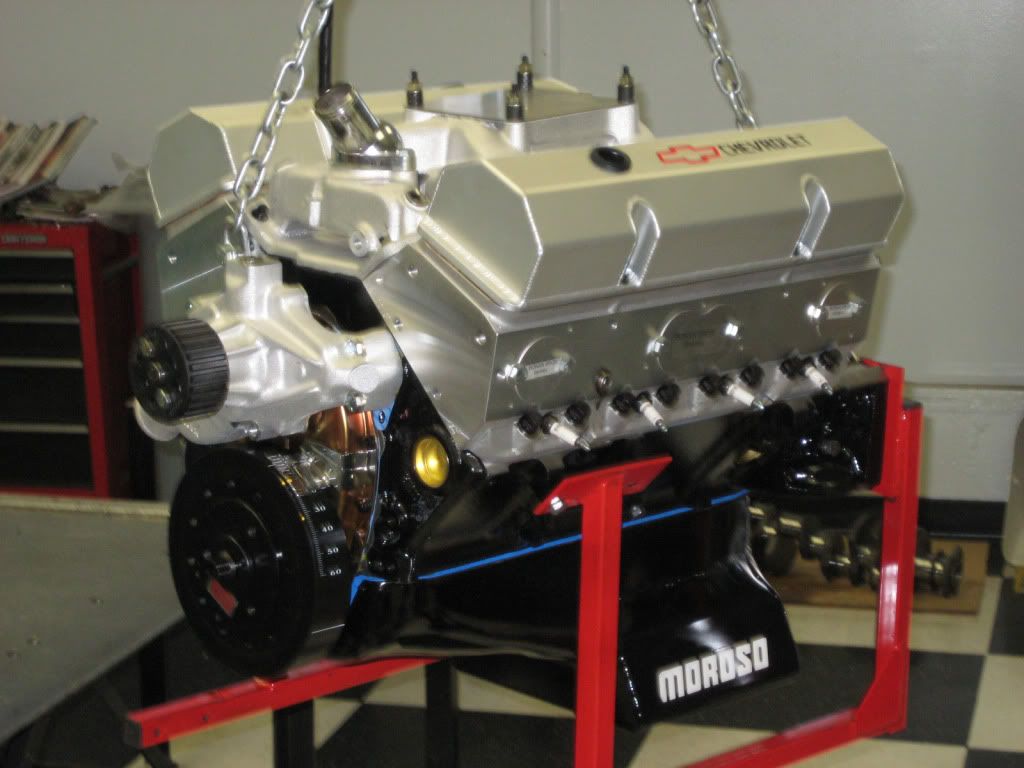

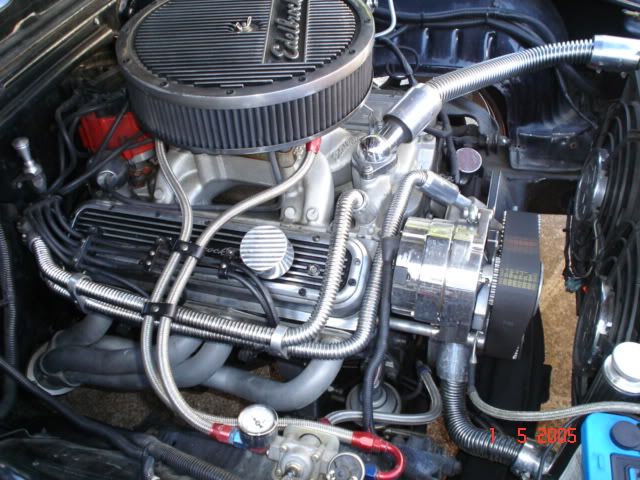

Ended with this - a little 383 stroker
http://i855.photobucket.com/albums/a...hio1/motor.jpg
http://i855.photobucket.com/albums/a...1/PICT0011.jpg

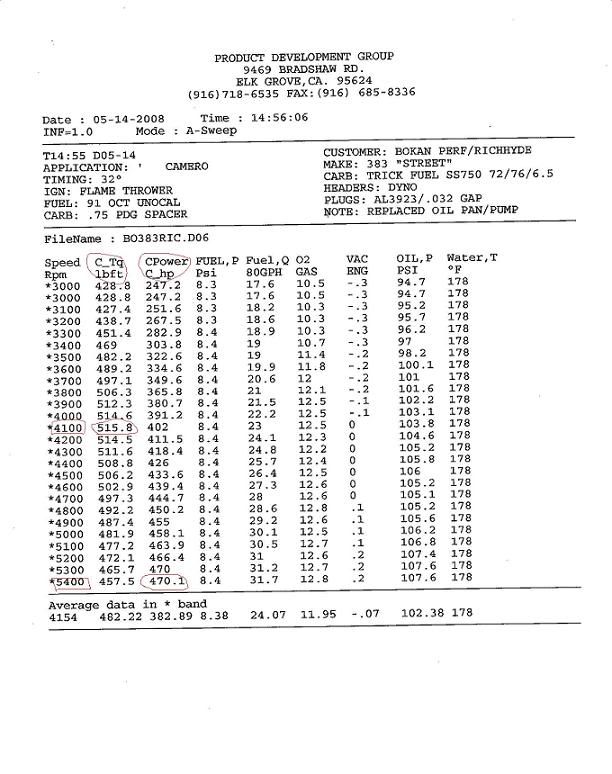

At break in it dynoed 470HP and 515TQ ... a definite improvement

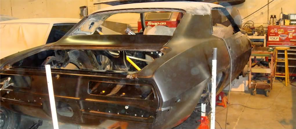

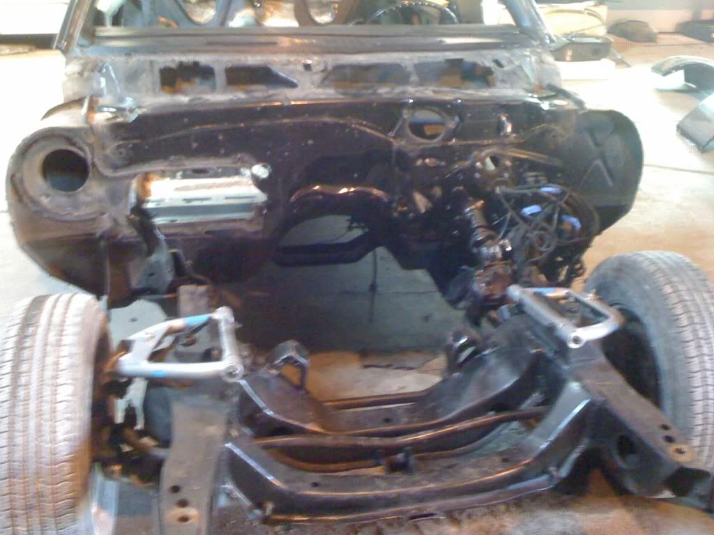

So the start of the "evolving" project... since we were going to basically have the back half of the car off we might as well minitub it right? So new quarters, trunk, valance, tail panel and frame rails went in along with a set of DSE minitubs.
http://i855.photobucket.com/albums/a...1/DSC01614.jpg
Unfortunetly all of the good pictures of the panel replacements were lost by the builders. (Camera issues) Above you can see the driver side wheel well out and the new quater on the passenger side.
http://i855.photobucket.com/albums/a...C01613-1-1.jpg
All the new sheet metal back on. It only took about 4 months to get to this point.

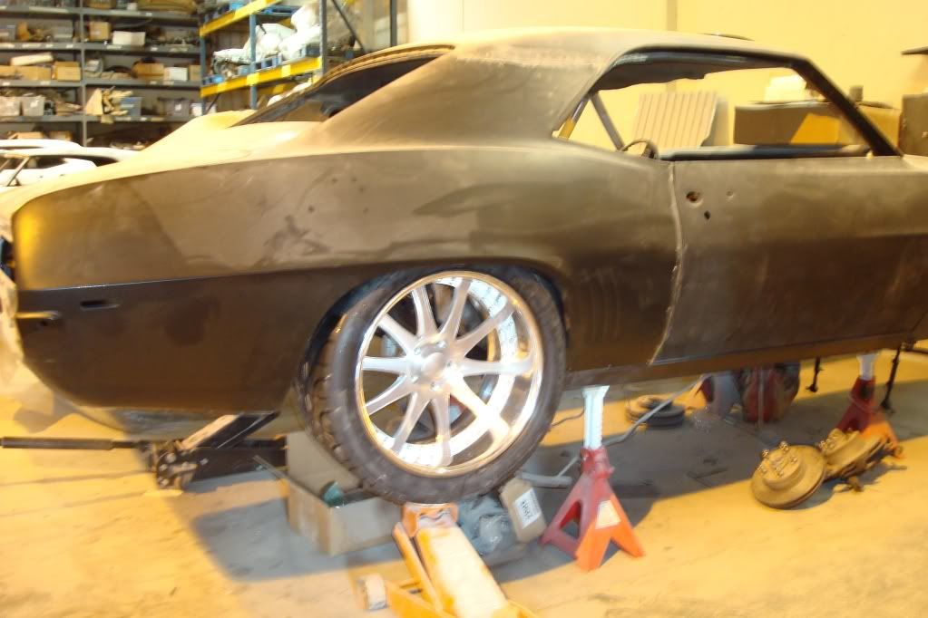

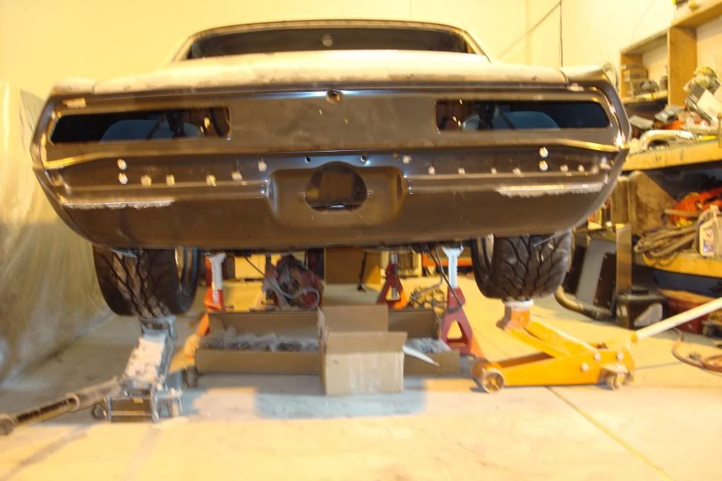

Mock up with the wheels for rear end measurements
http://i855.photobucket.com/albums/a...1/progress.jpg
http://i855.photobucket.com/albums/a.../progress1.jpg
As you can see the Rated X's will fit Nicely. Once we had the rearend out I did some research on the numbers. Come to find out it was out of a Chevelle and the upper control arm brackets had been cut off and ground down. Another nice little surprise. So that led to the next decision... suspension. I have always loved the the look of a slammed 69 so I decided to swap out the suspension and go with AirRide. Since I was going to have to shorten the rearend to accommodate the back space I wanted on the wheels I decided to just get a Moser setup from Frank at Prodigy with all the bracketry already in place.

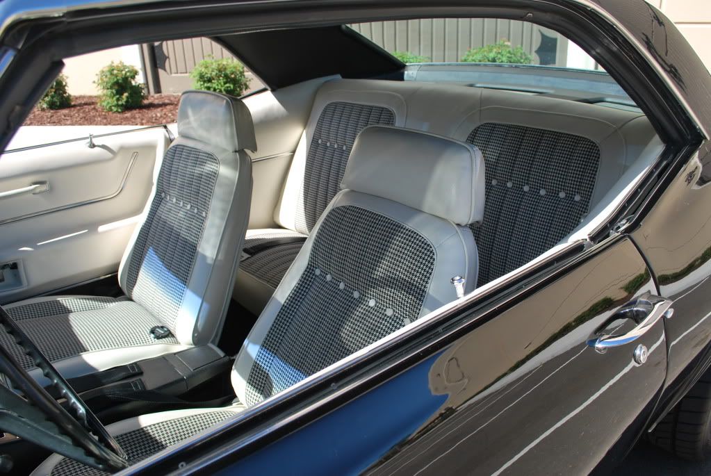

I Love the white Houndstooth Interior:thumbsup:

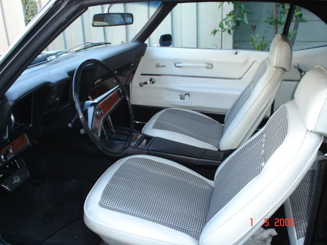

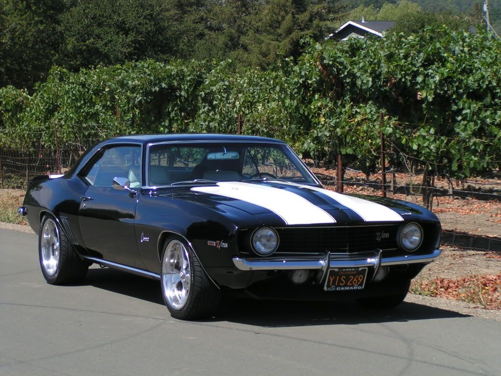

I do too. I fell in love with the car as soon as I saw it. The interior was in perfect shape and really looked great with the black with white rallys.
http://i855.photobucket.com/albums/a...aro0909012.jpg
I even upgraded to the TMI Sport buns & covers which are a great upgrade for someone wanting to keep it looking kinda stock.
