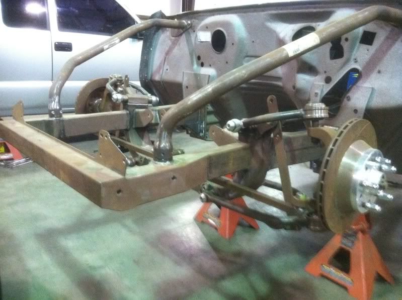

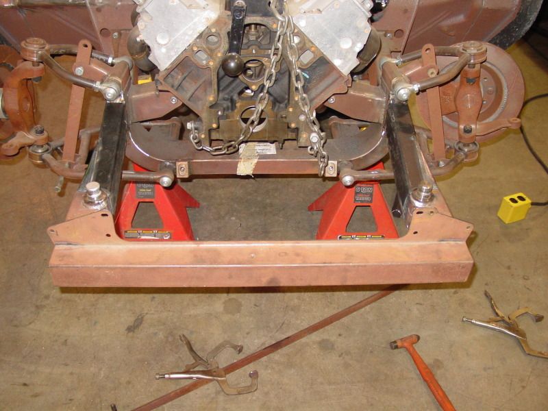

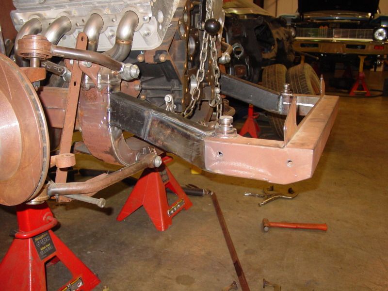

Chassisworks front clip- altered the ride height so the car sits 2.5" lower
Chassisworks canted 4-bar

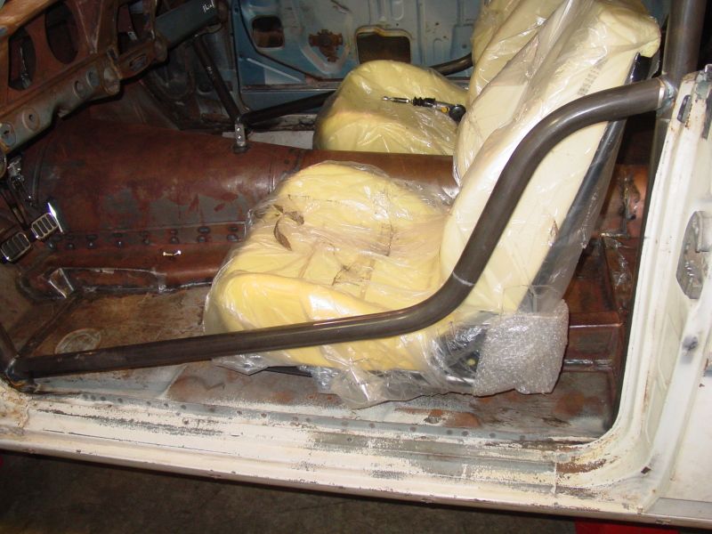

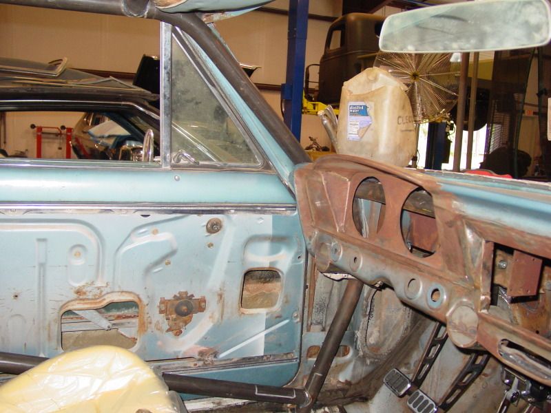

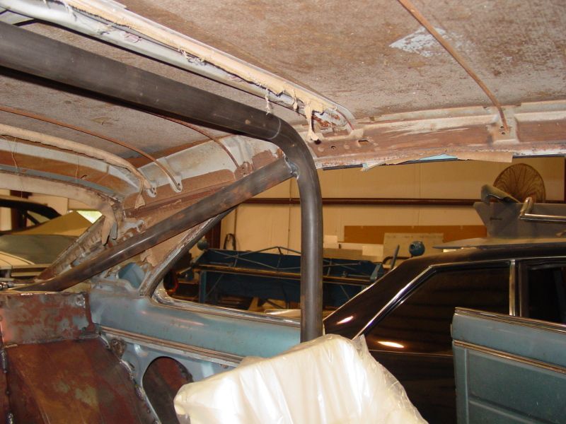

Custom roll cage and sheetmetal

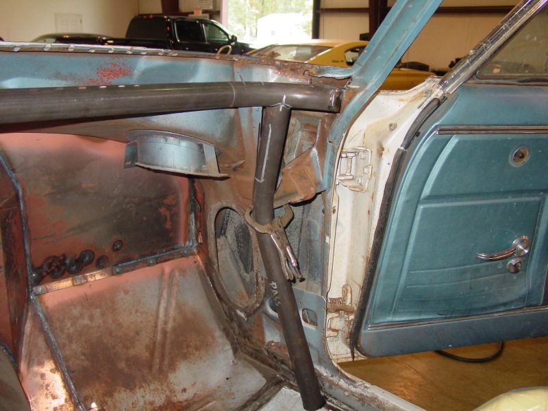

The next updates will be the stretching of the rear wheel openings (not sure how much I am going yet???) and the roll cage followed by the sheetmetal

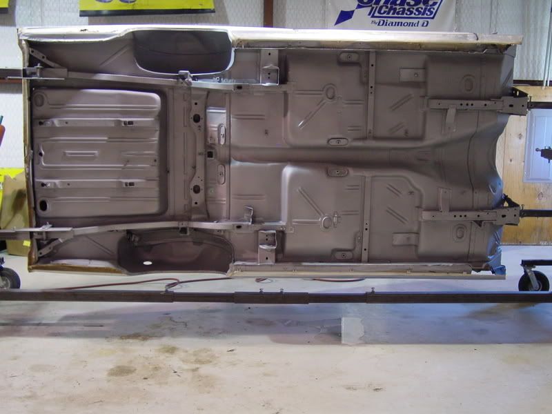

Where it started
http://i43.photobucket.com/albums/e3...h/6b34f559.jpg
http://i43.photobucket.com/albums/e3...h/18b1f08d.jpg
http://i43.photobucket.com/albums/e3...h/cd293234.jpg
http://i43.photobucket.com/albums/e3...h/9cefb174.jpg

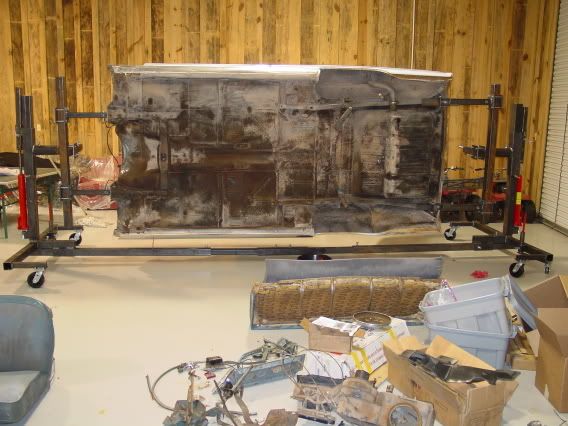

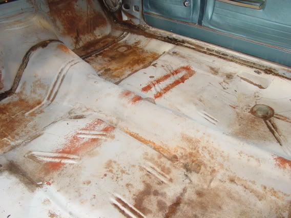

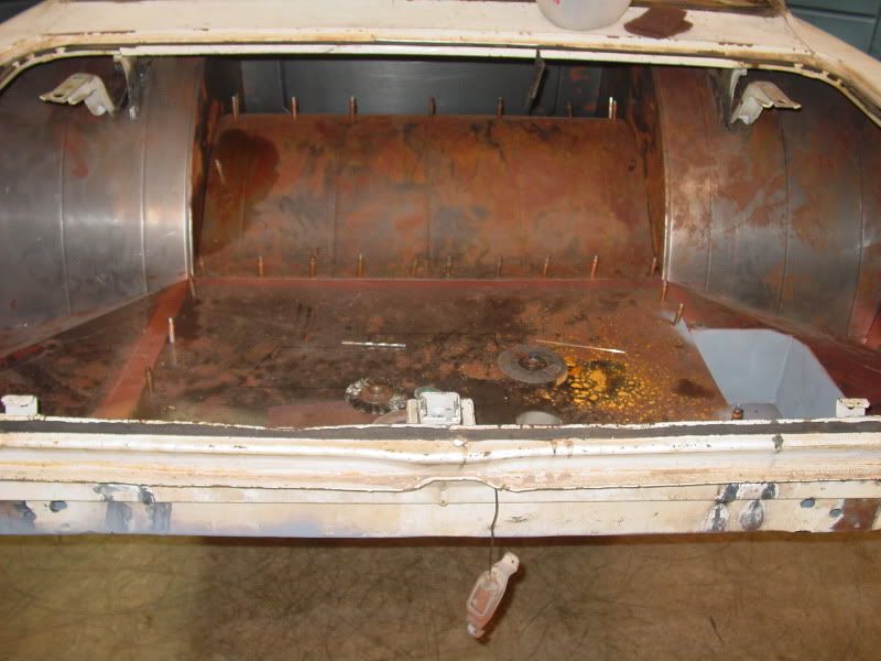

All of the undercoating
http://i43.photobucket.com/albums/e3...h/ade2272b.jpg
http://i43.photobucket.com/albums/e3...h/7a61341a.jpg

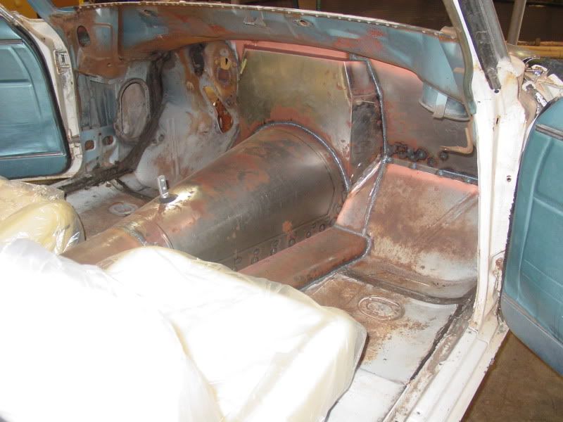

Now its clean
http://i43.photobucket.com/albums/e3...h/DSC00133.jpg
http://i43.photobucket.com/albums/e3...h/DSC00132.jpg

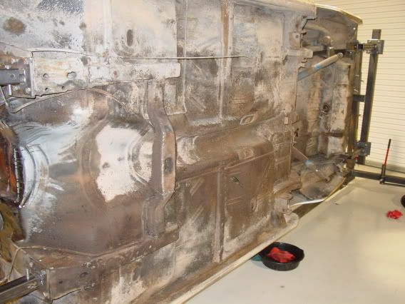

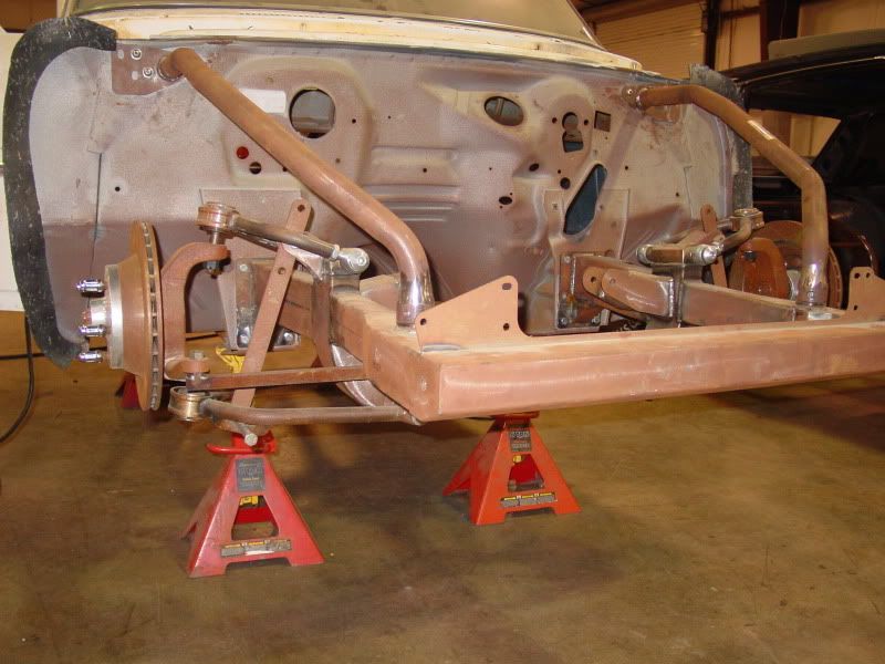

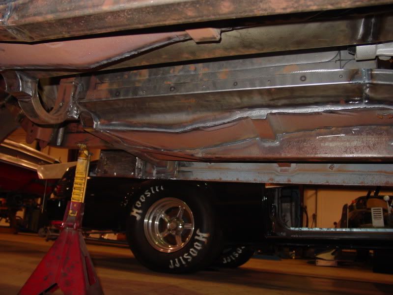

You can see where the clip was raised in the car
http://i43.photobucket.com/albums/e3...h/DSC00334.jpg
http://i43.photobucket.com/albums/e3...emy99h/028.jpg
http://i43.photobucket.com/albums/e3...emy99h/027.jpg

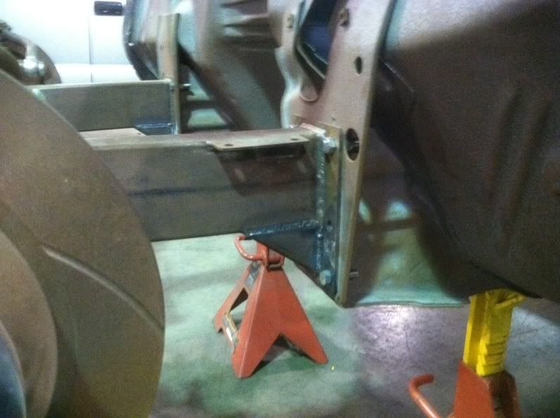

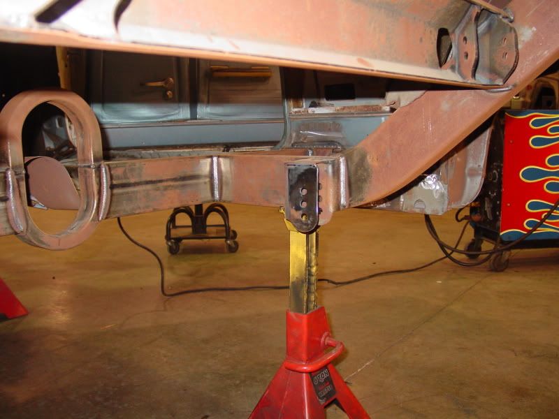

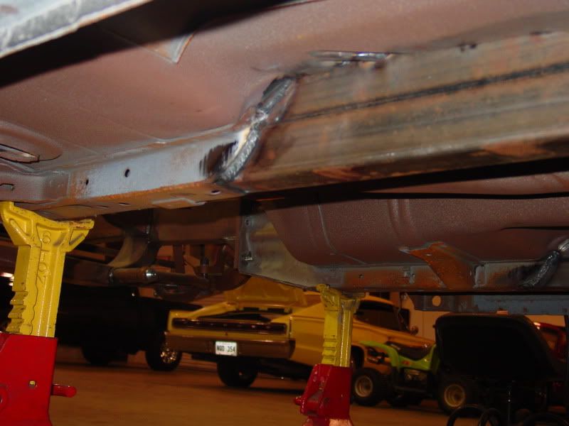

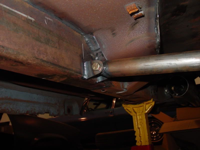

Rear clip welded into place
http://i43.photobucket.com/albums/e3...emy99h/026.jpg
http://i43.photobucket.com/albums/e3...h/DSC00330.jpg

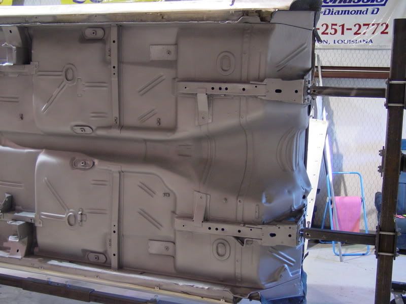

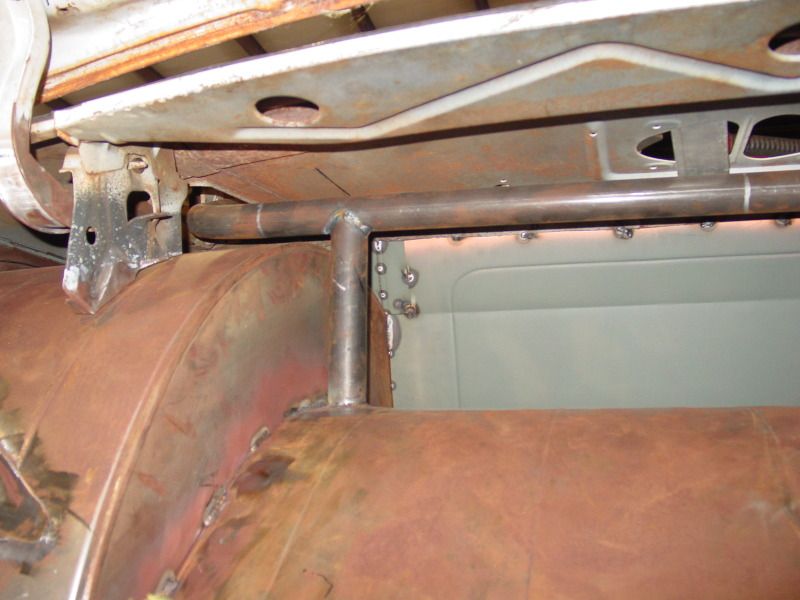

This is where the rear clip was tied into the frame
http://i43.photobucket.com/albums/e3...h/DSC00328.jpg
http://i43.photobucket.com/albums/e3...h/DSC00332.jpg

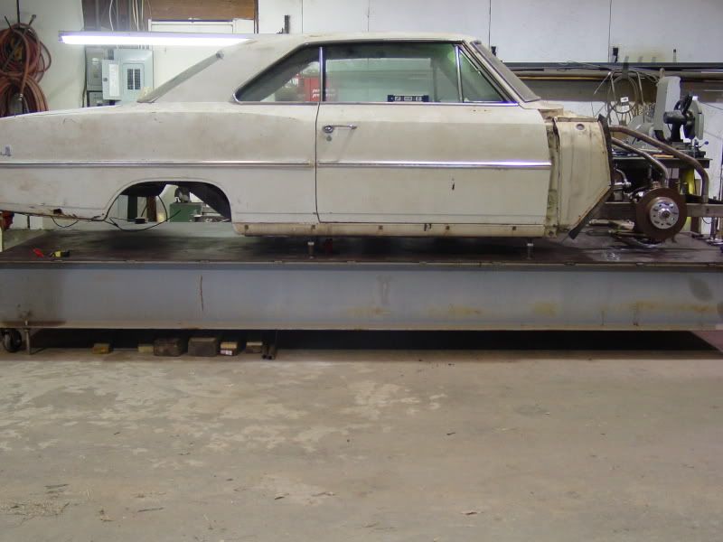

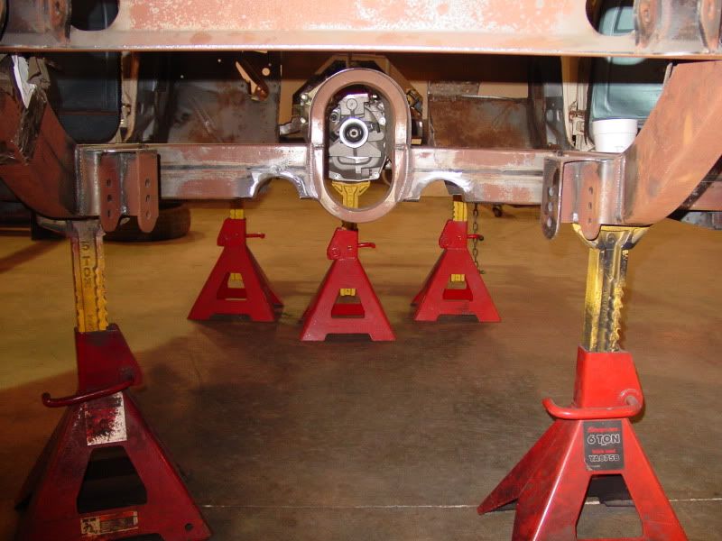

jh99 12-06-2011 03:12 PM

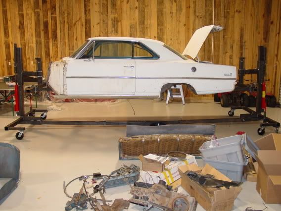

Here is the car at ride height. The front rocker is 5" and the rear is 5.75." I will have a little room to play with the adjustability of the rear shock mounts.
Any suggestions on how much rake?
http://i43.photobucket.com/albums/e3...emy99h/012.jpg

nice work...i like a 1" rake however...66-67's have funky wheel well openings so a 0- 3/4" would translate better.

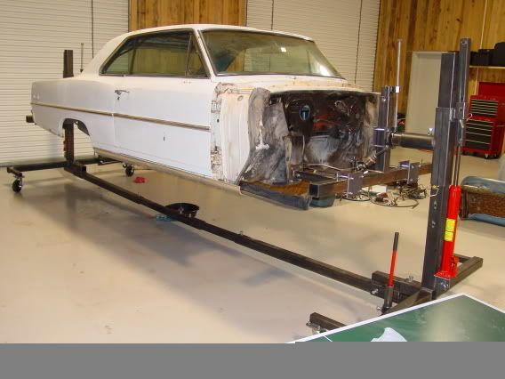

I have to ask -- tell me about your frame table... I will be looking to build one at some point and just like to hear the reasoning behind how people built theirs and the pros/cons etc..
jh99 12-07-2011 02:52 PM
Originally Posted by wiedemab (Post 382752)
Subscribed!
Thanks! My I-beam you can see on the frame table is 15inch. There are three, 8inch I-beam running perpindicular to the 15inch you can see in the pic. I had to build some braces to the top plate for strenght. Three pieces was not enough. Then it has a piece of 1/2" plate that covers the entire table.
The table needs to be as solid as possible where there is no deflection. The more braces in the center the better.
If i had to do it again, I would have the 15" on the bottom still, but put the 8" on top of the 15" every couple of feet. Then plate the top. Hope this helps.

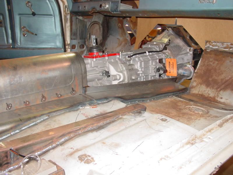

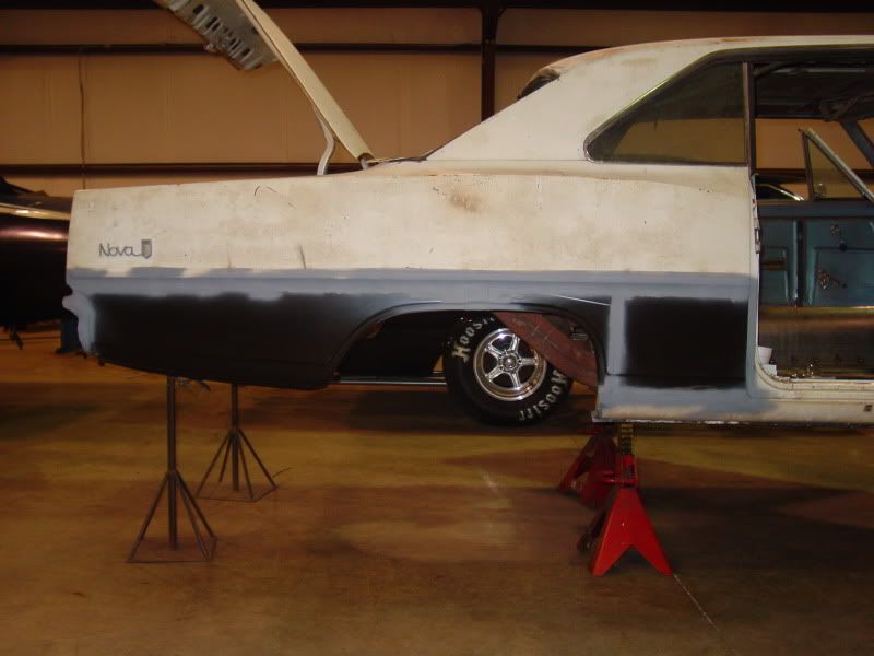

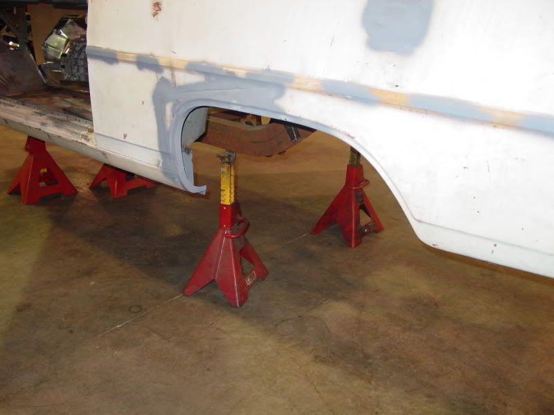

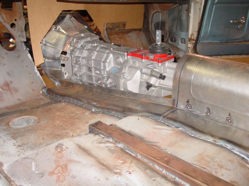

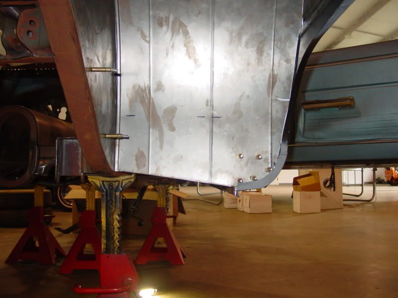

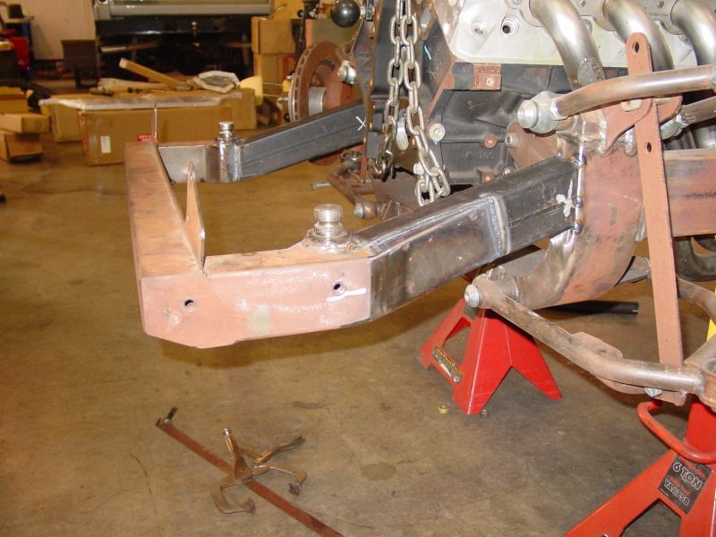

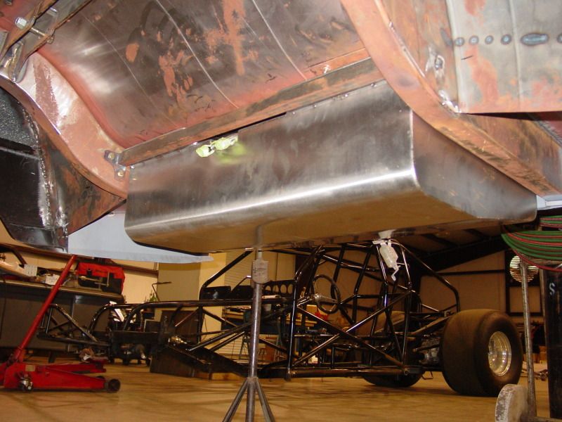

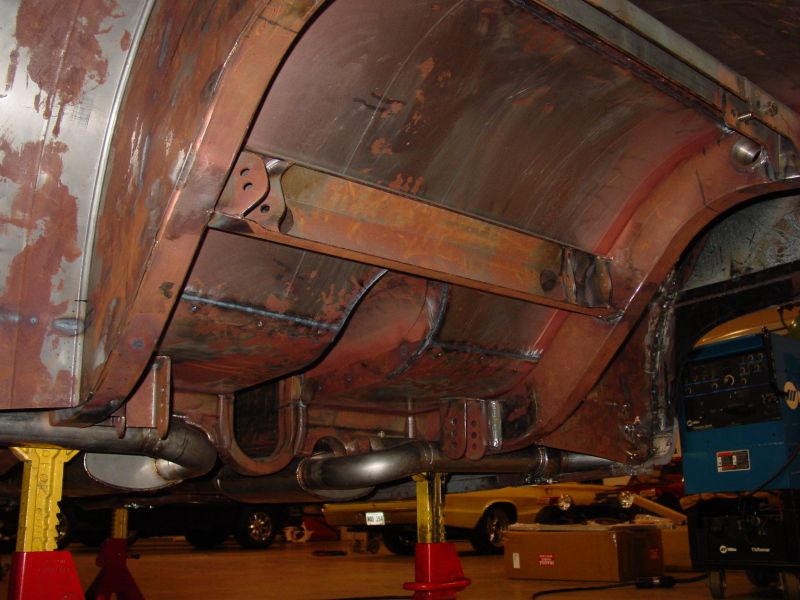

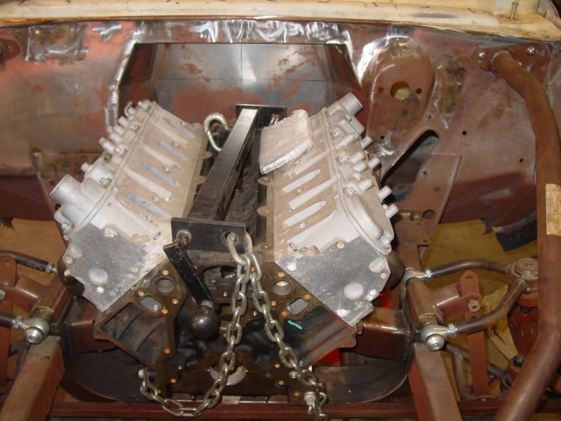

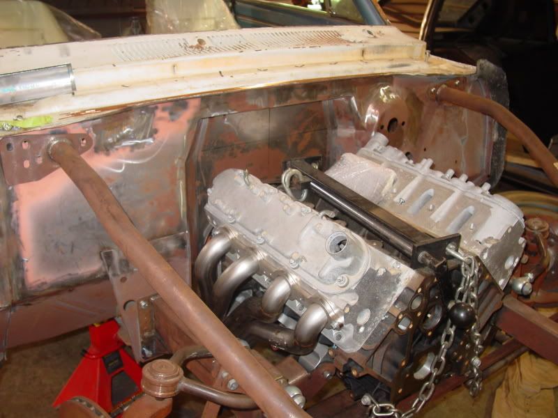

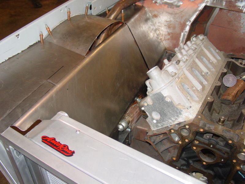

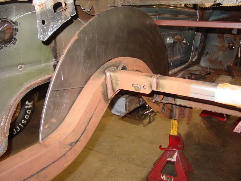

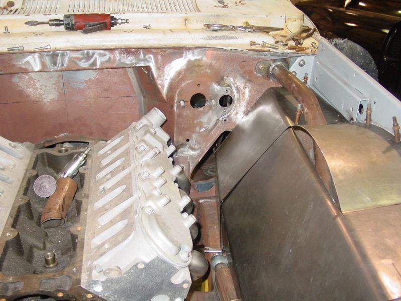

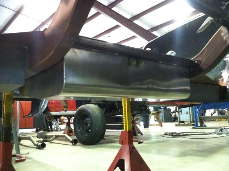

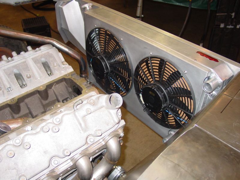

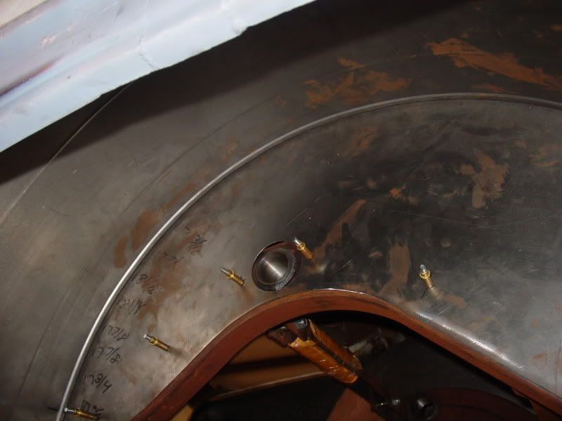

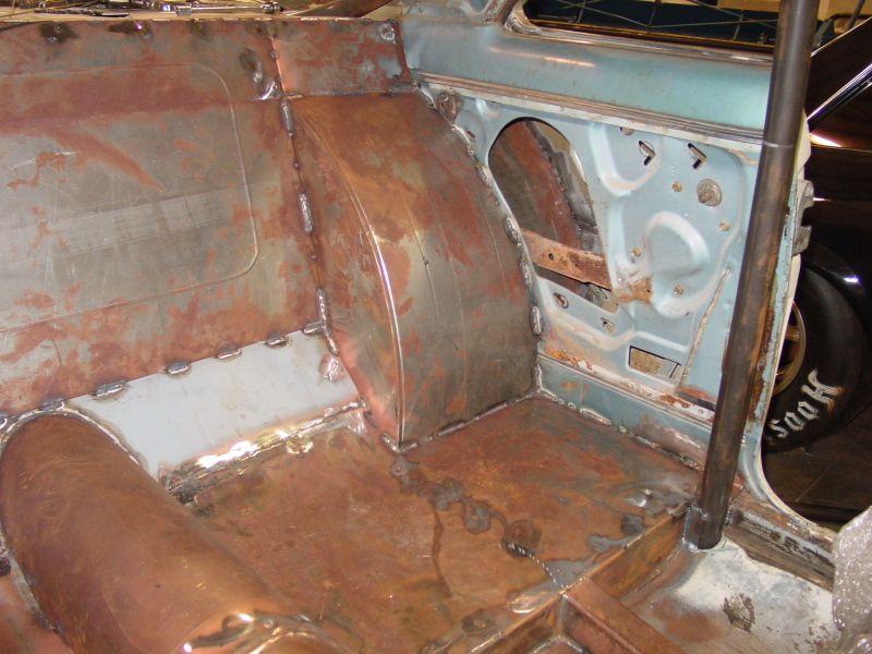

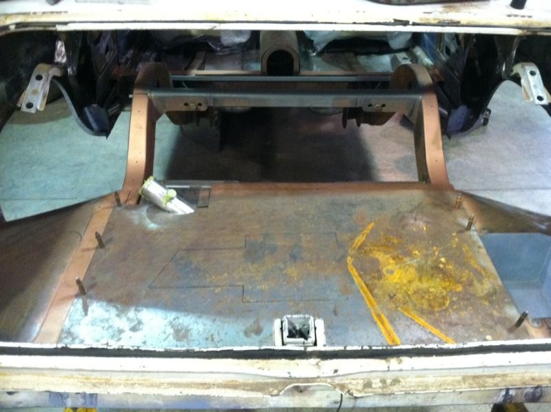

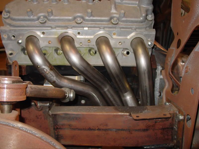

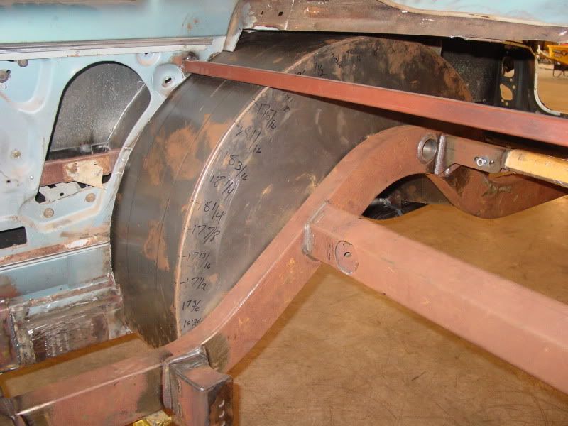

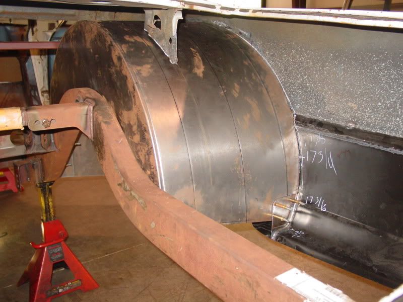

Here are a few updates. The rear quarters have been stretched, have the block and transmission mocked up, and started to sheet metal the tunnel.
Stretched rear quarters
http://i43.photobucket.com/albums/e3...y99h/010-1.jpg
http://i43.photobucket.com/albums/e3...y99h/011-1.jpg

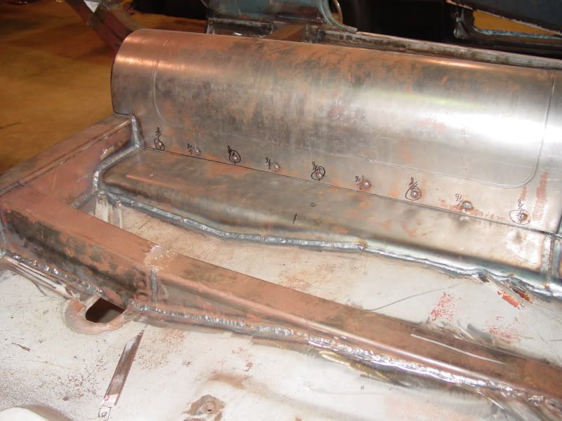

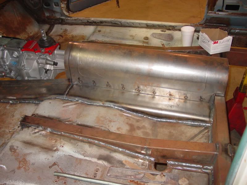

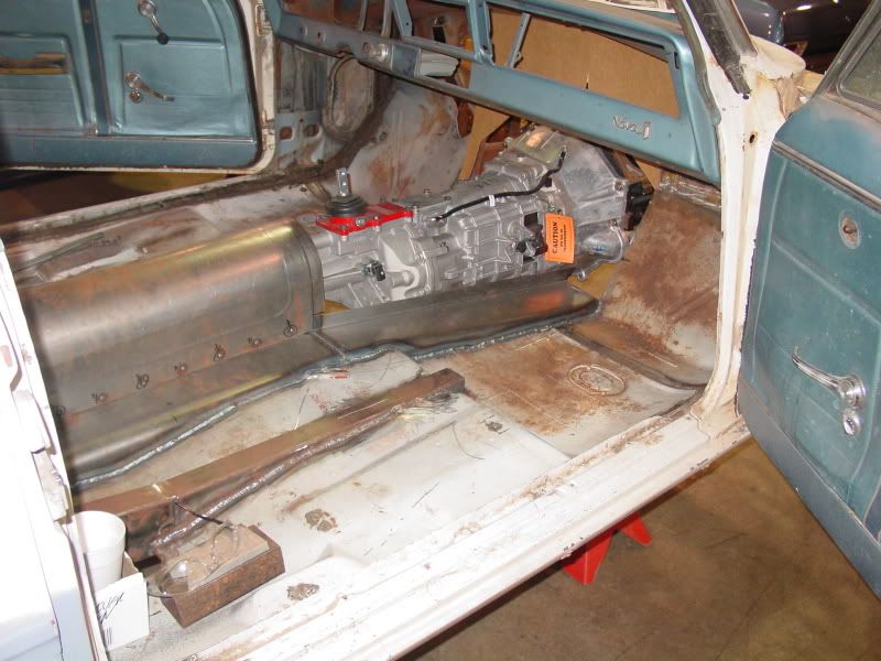

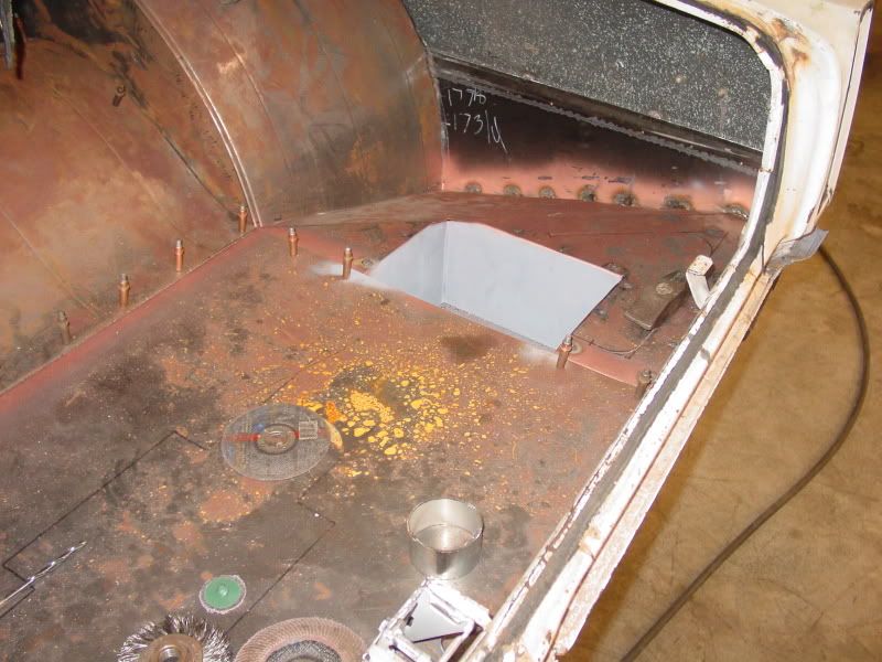

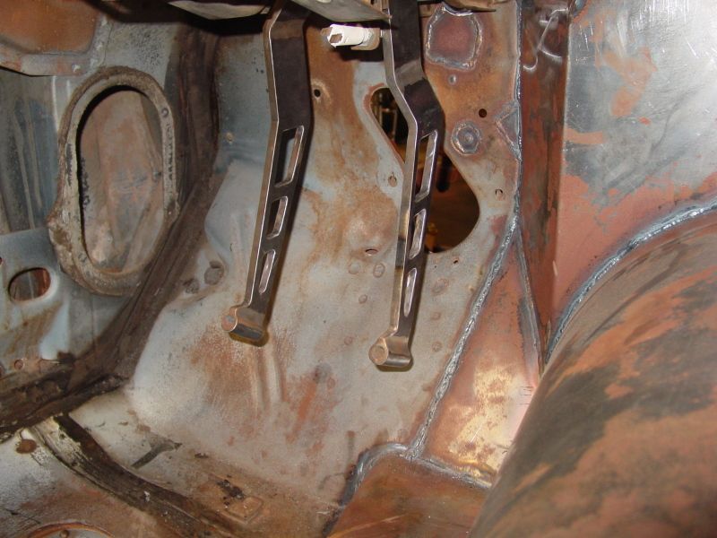

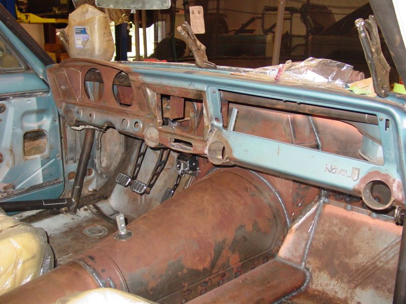

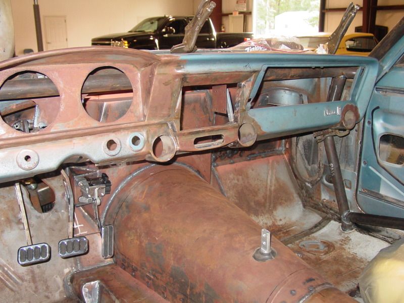

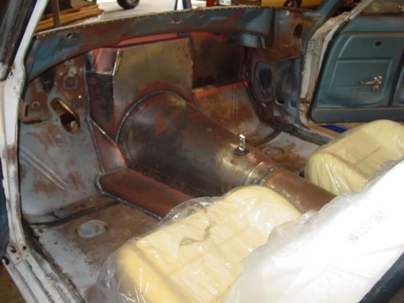

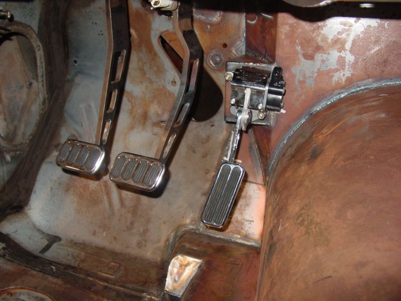

Start of the trans tunnel
http://i43.photobucket.com/albums/e3...y99h/001-1.jpg
http://i43.photobucket.com/albums/e3...y99h/005-1.jpg
http://i43.photobucket.com/albums/e3...y99h/002-1.jpg
http://i43.photobucket.com/albums/e3...y99h/003-1.jpg
http://i43.photobucket.com/albums/e3...y99h/004-1.jpg

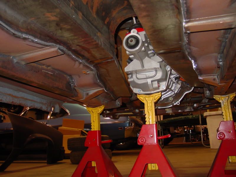

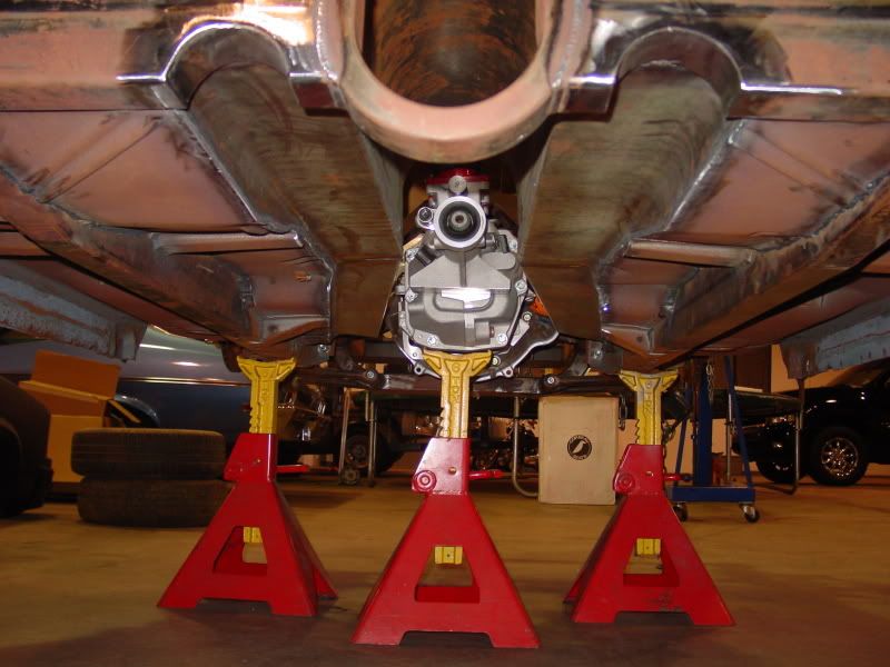

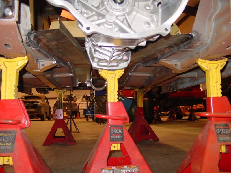

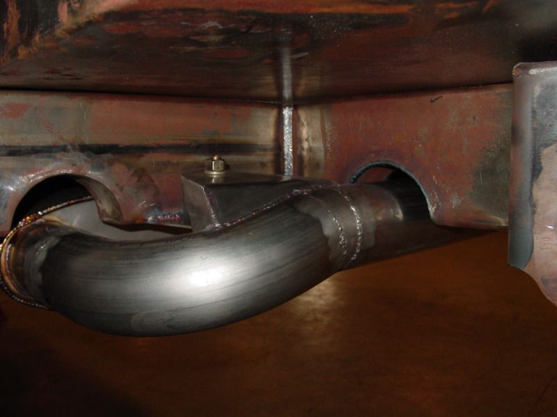

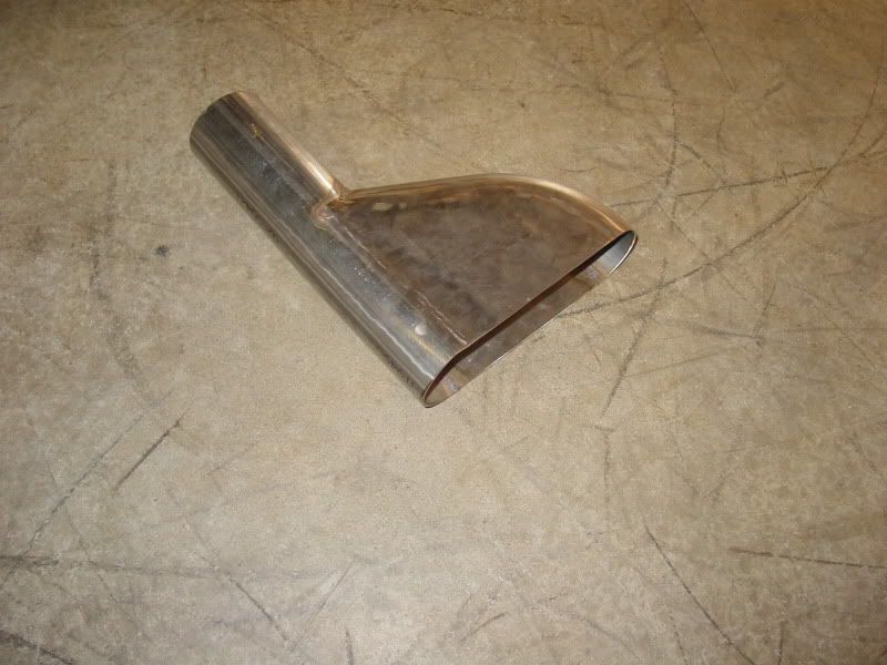

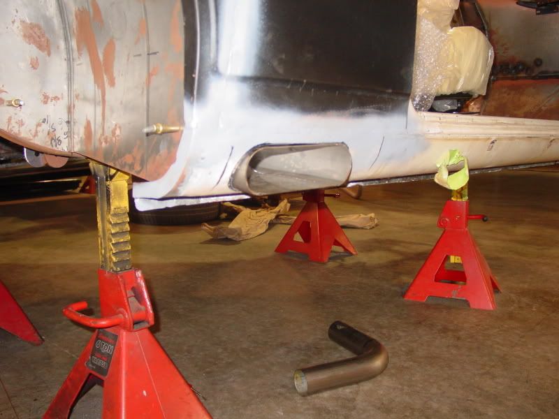

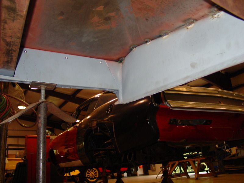

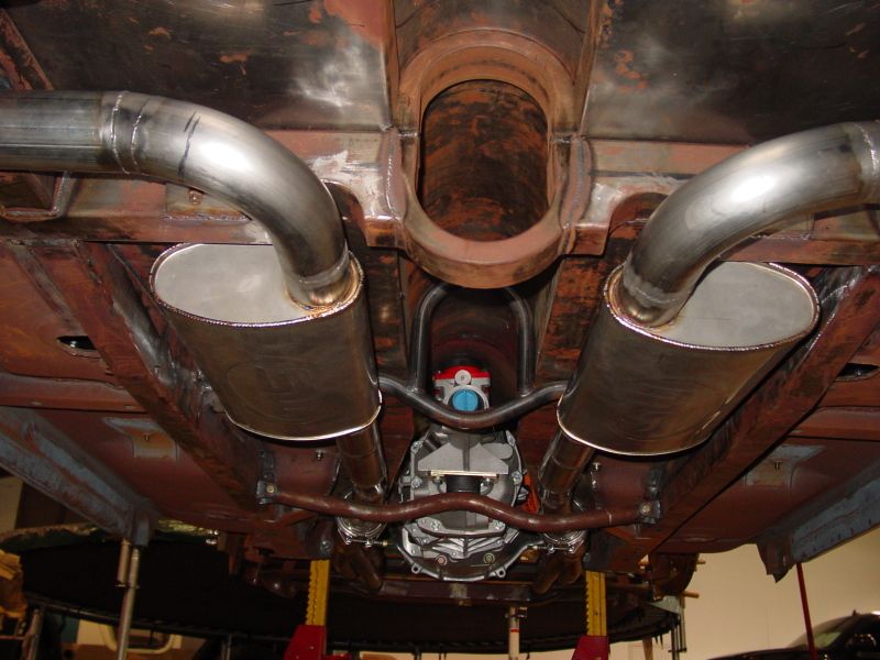

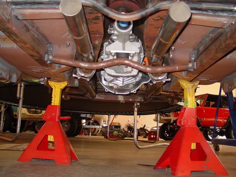

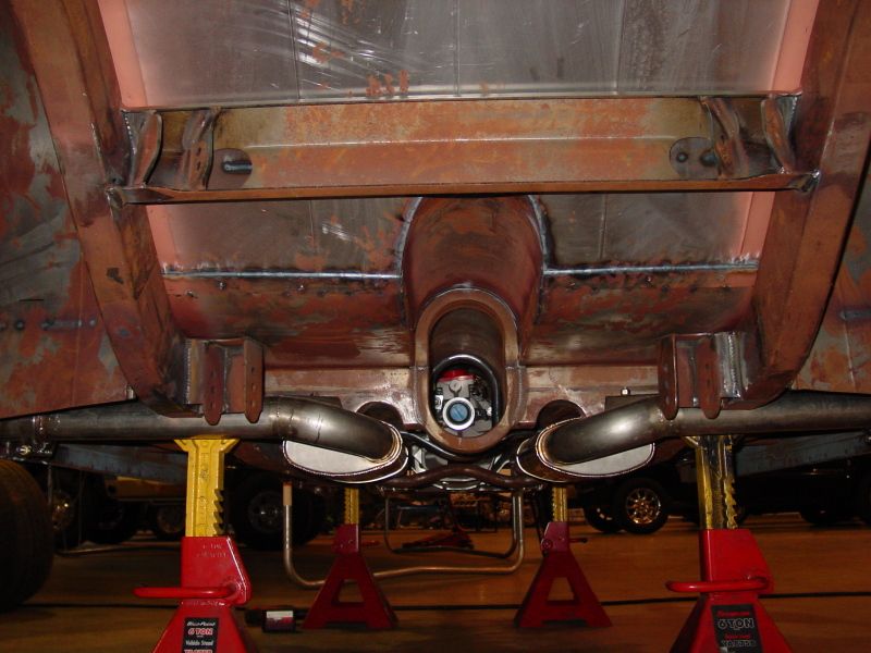

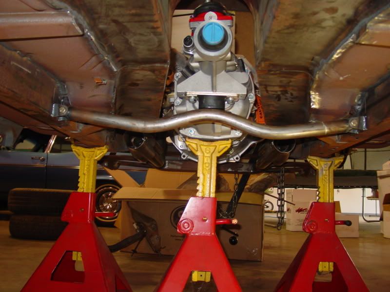

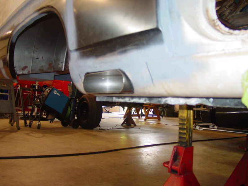

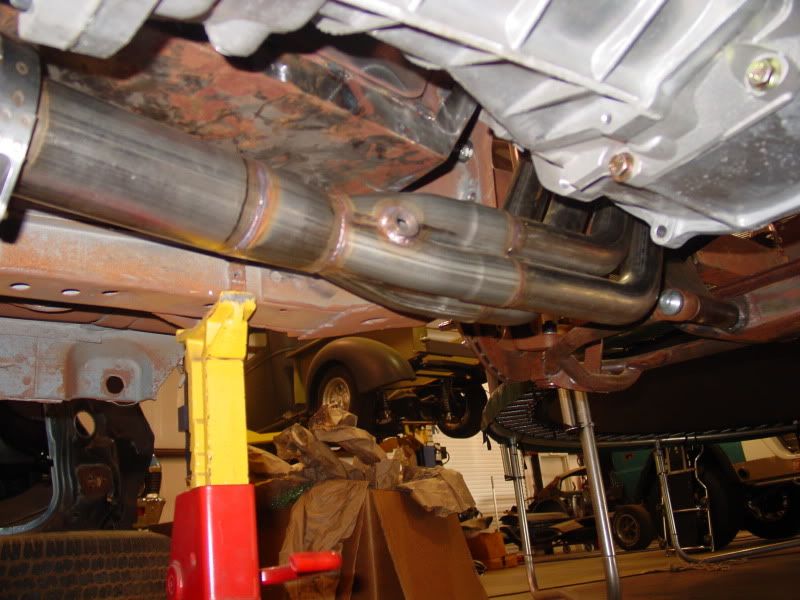

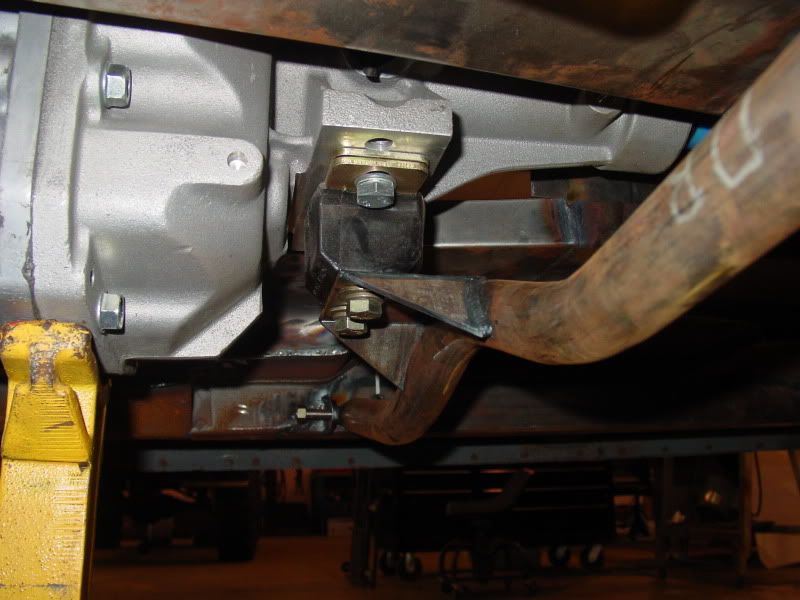

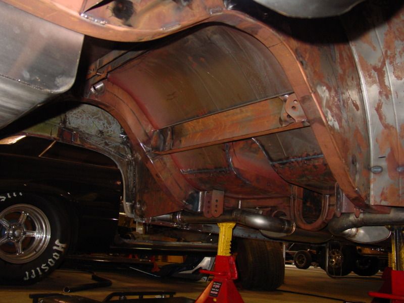

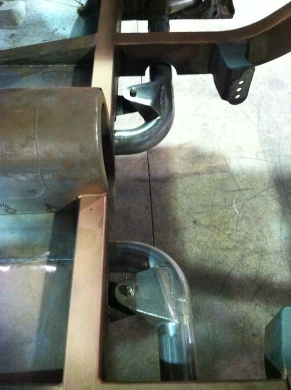

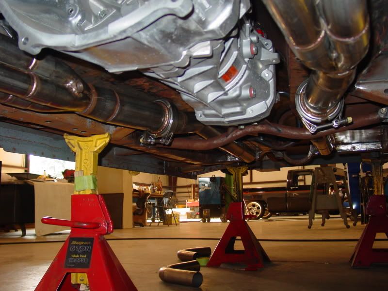

Exhaust cutouts and some views of the bottom
http://i43.photobucket.com/albums/e3...y99h/006-1.jpg
http://i43.photobucket.com/albums/e3...y99h/009-1.jpg
http://i43.photobucket.com/albums/e3...y99h/007-1.jpg
http://i43.photobucket.com/albums/e3...y99h/012-1.jpg
http://i43.photobucket.com/albums/e3...y99h/008-1.jpg
Hoping to have more done in the next week or so. Next is the firewall, then the rest of the tunnel.
