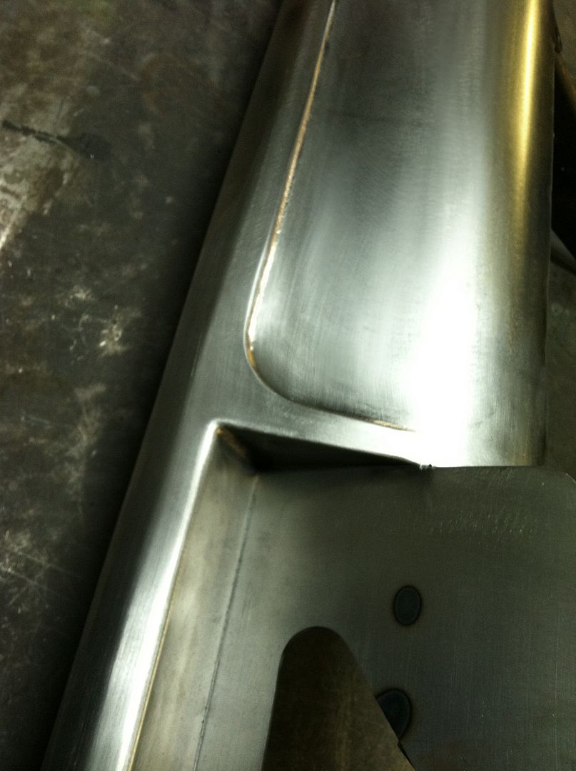

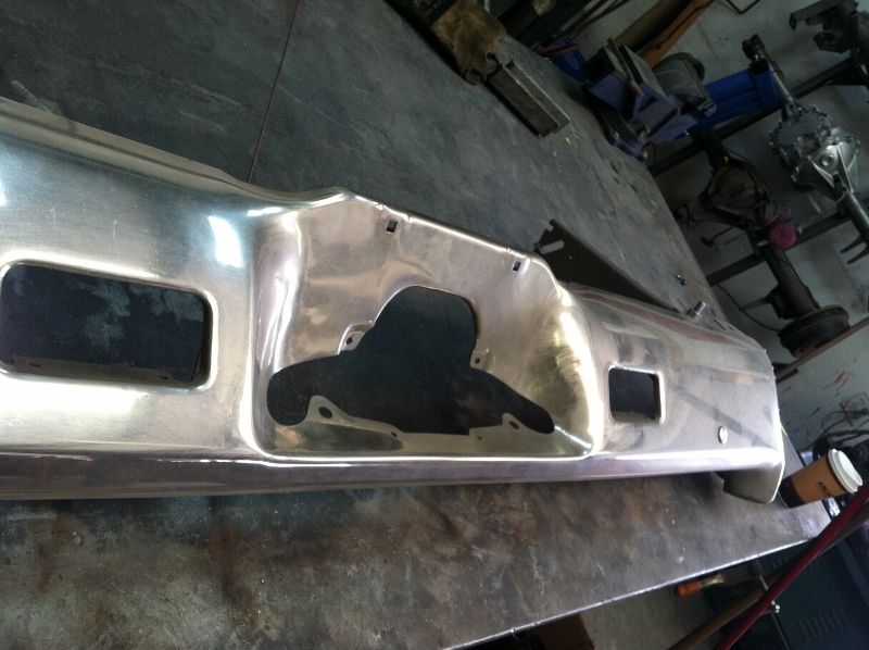

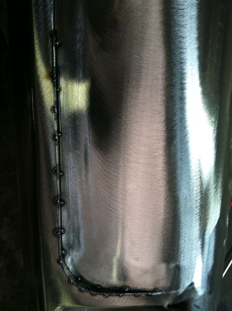

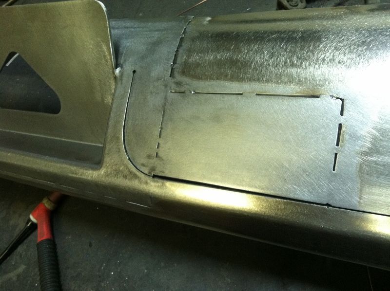

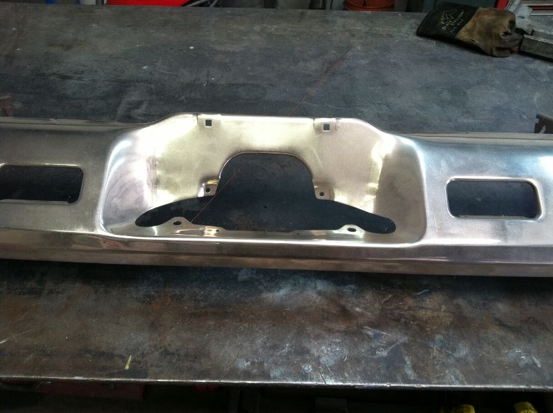

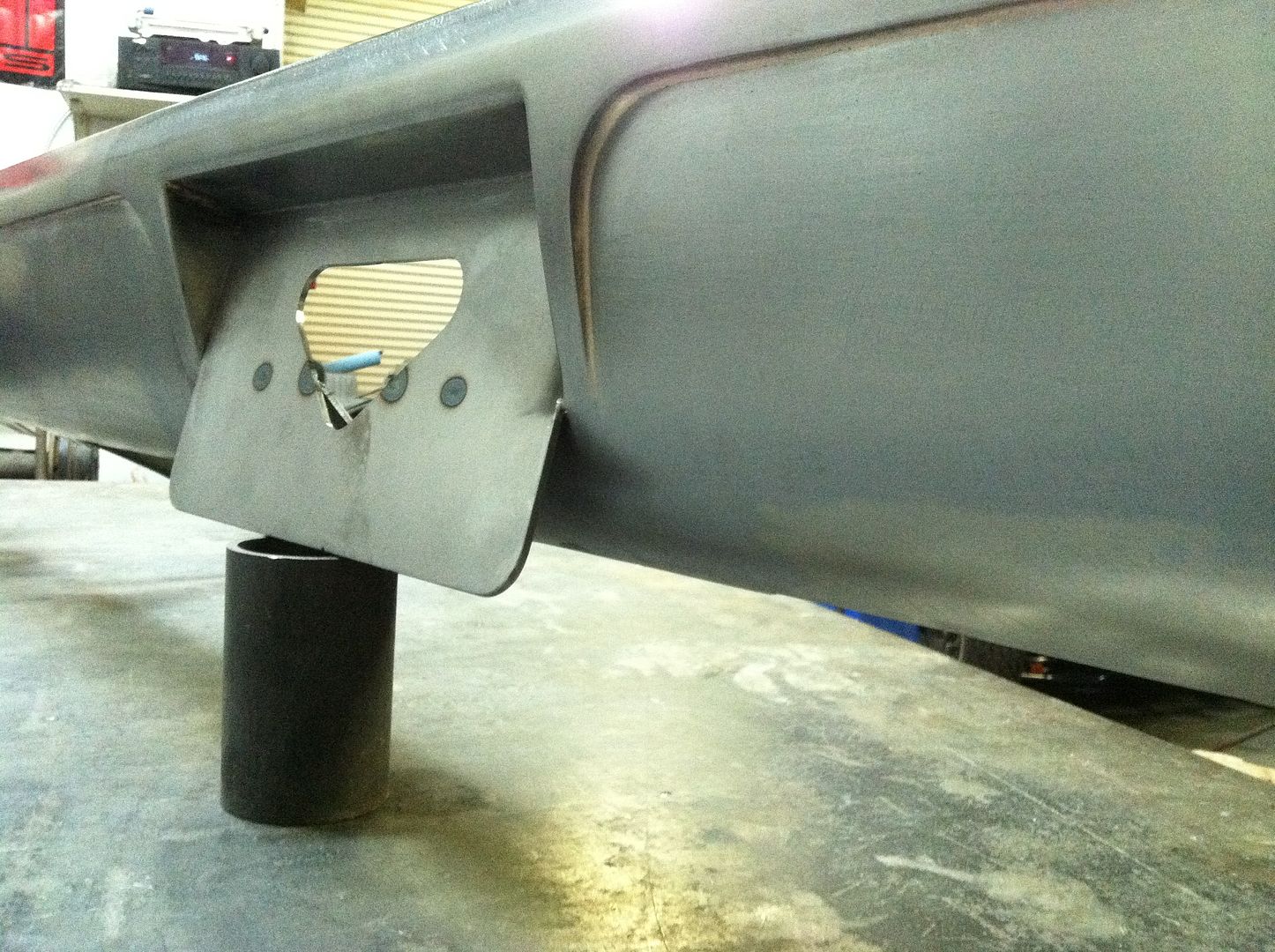

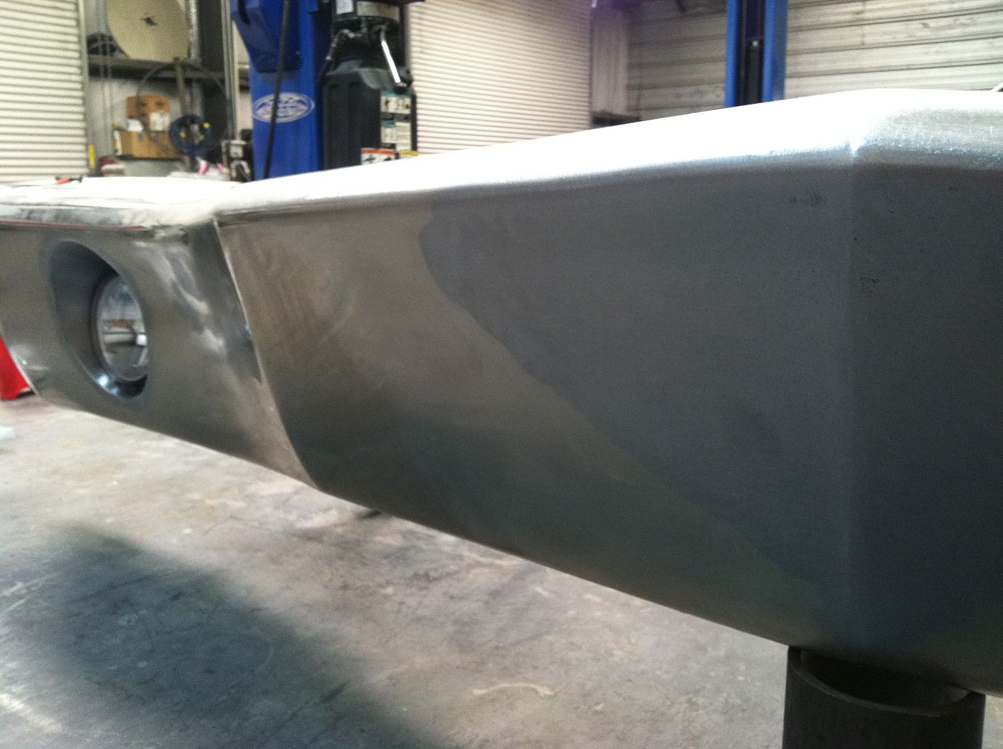

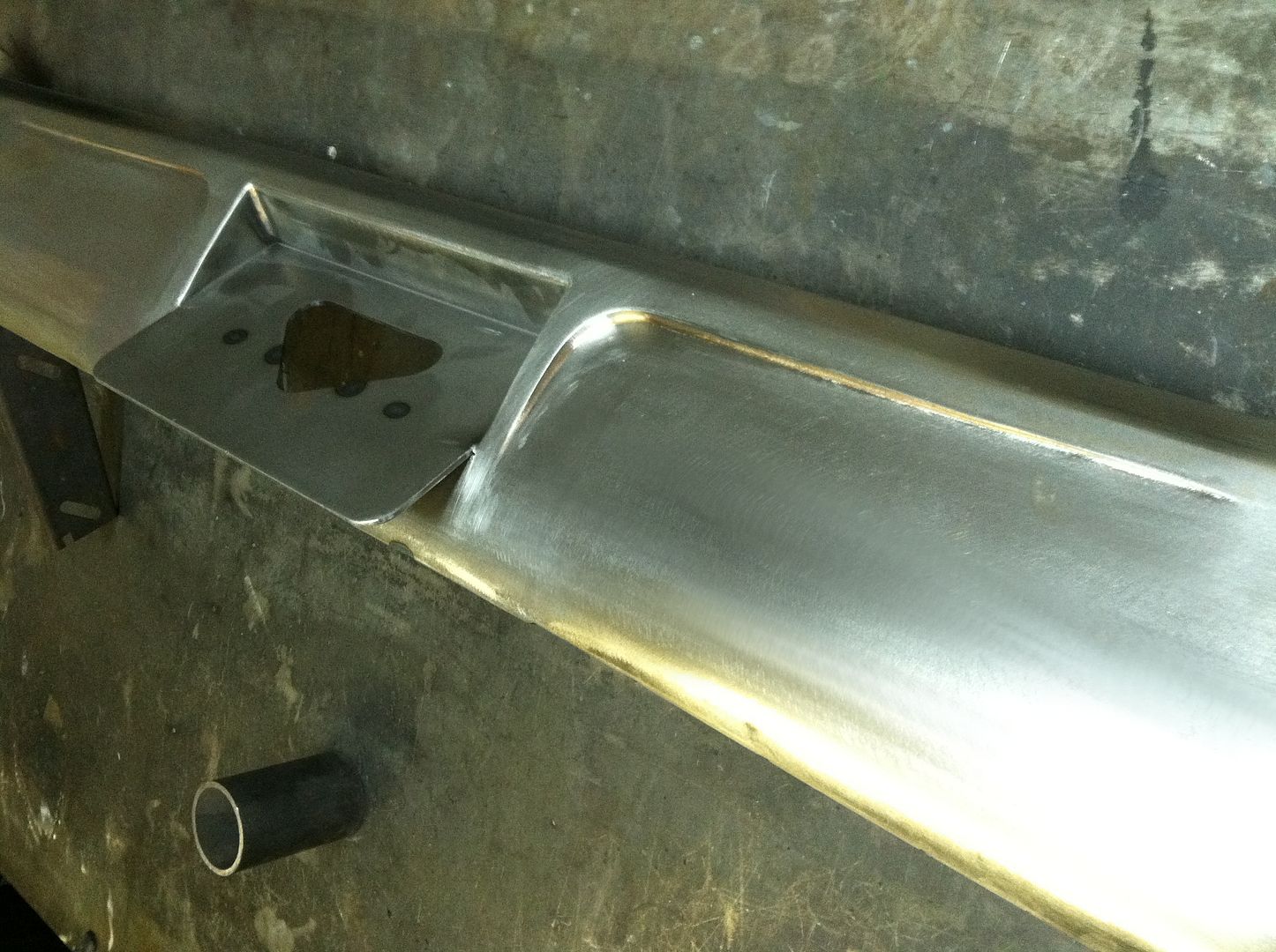

Sucked the rear bumper in just a bit and narrowed it 3/4". A little reshaping and tightening up the gaps.

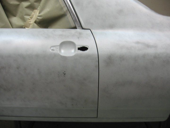

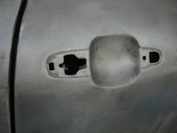

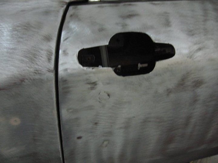

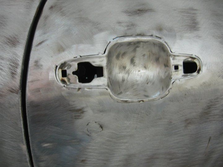

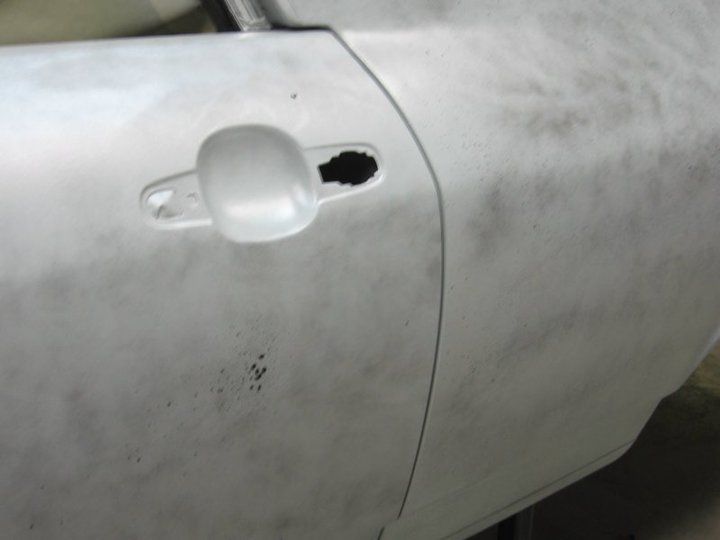

To follow the smooth look of the body, we transplanted a set of late model Toyota handles.
http://i5.photobucket.com/albums/y18...mino/EC005.jpg
http://i5.photobucket.com/albums/y18...mino/EC006.jpg

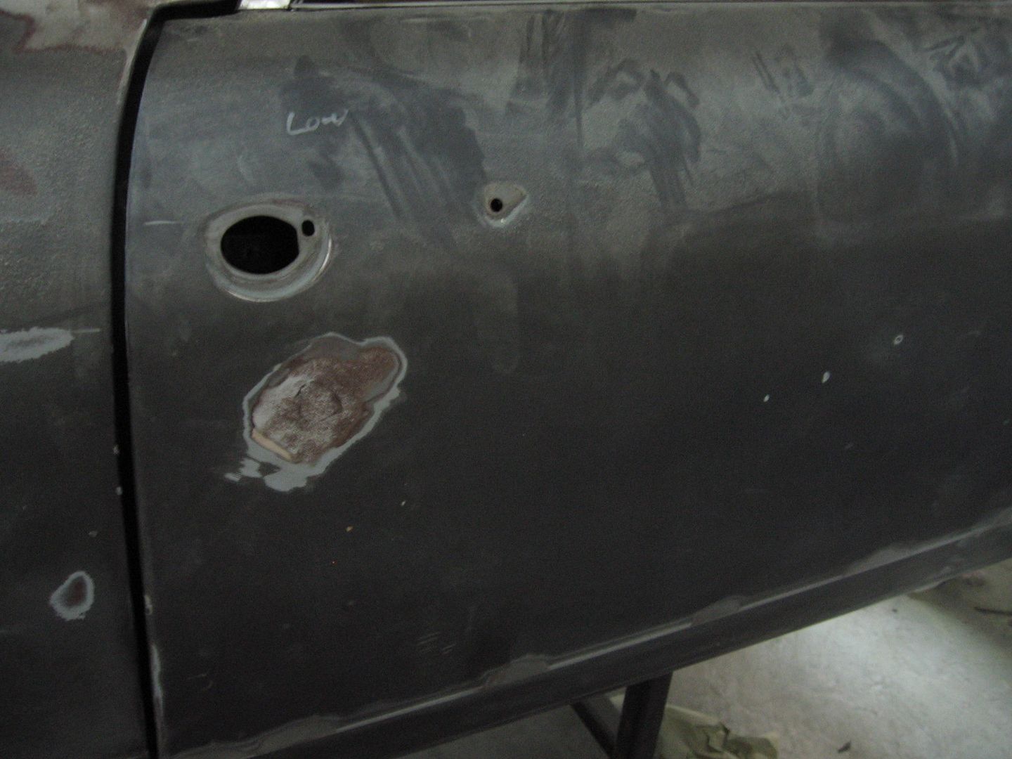

http://i5.photobucket.com/albums/y18...mino/EC008.jpg
http://i5.photobucket.com/albums/y18...mino/EC009.jpg

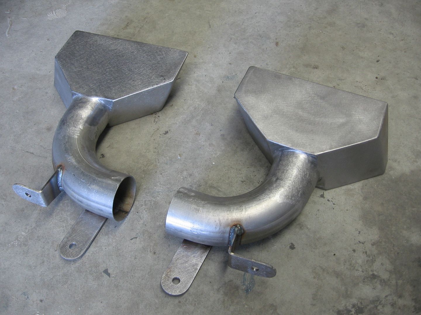

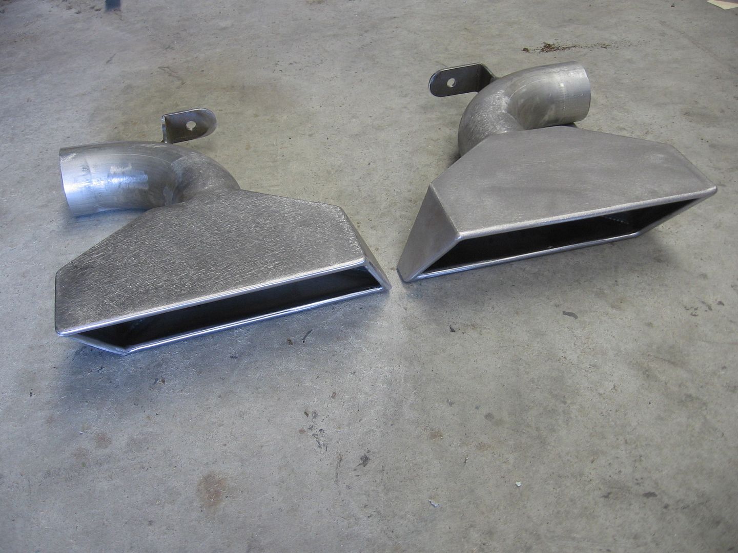

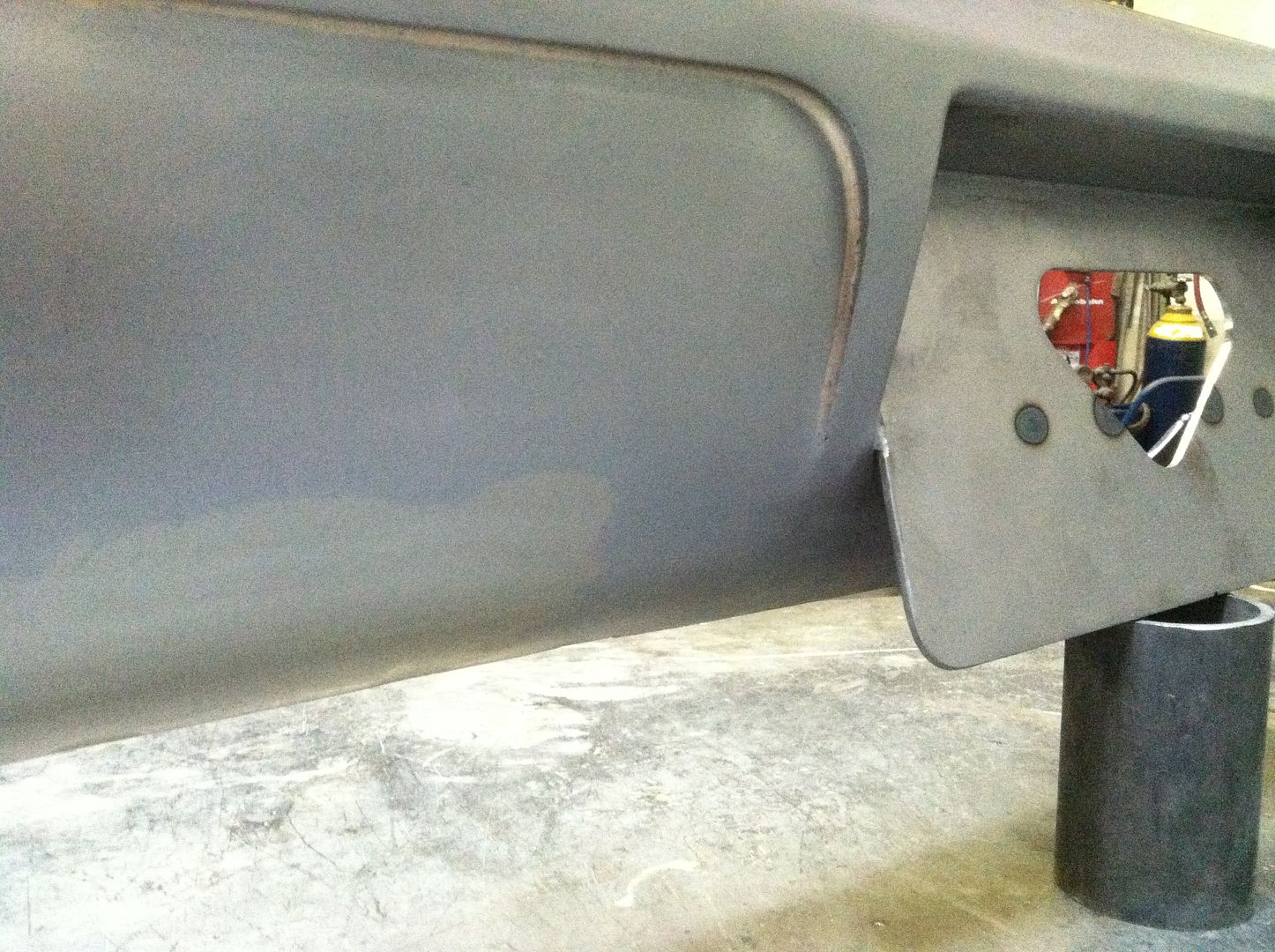

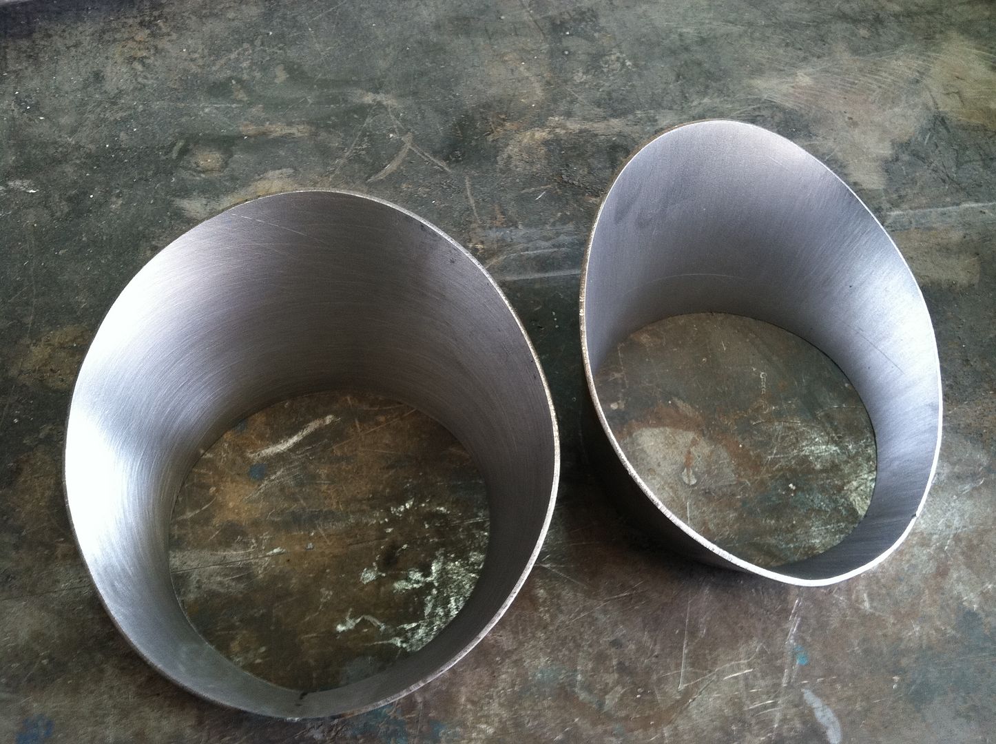

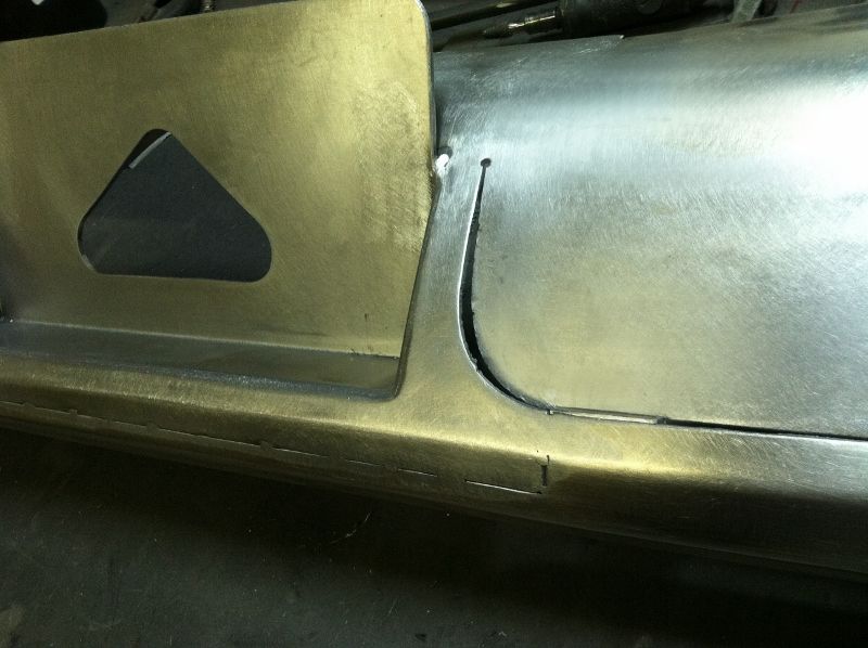

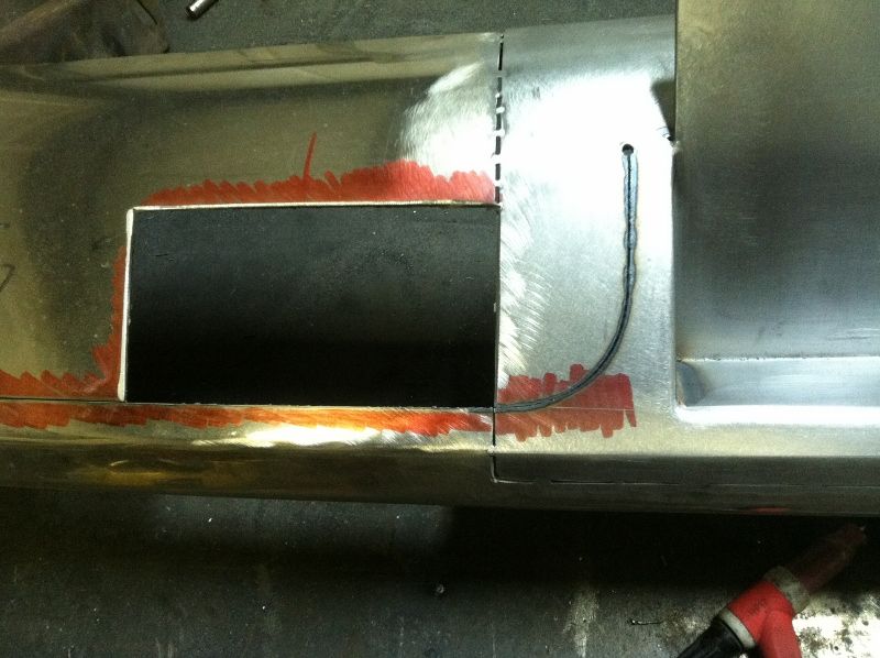

After contemplating how to exit the exhaust, we decided on a cutout in the body behind the rear wheel opening. Made a set of tips to fit the bill. More on those later...
http://i5.photobucket.com/albums/y18...mino/EC010.jpg
http://i5.photobucket.com/albums/y18...mino/EC011.jpg

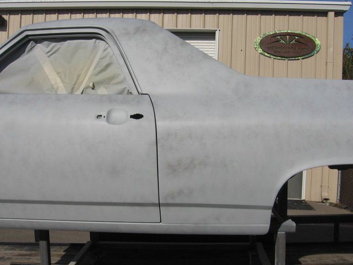

settintrendz 12-12-2011 01:26 AM

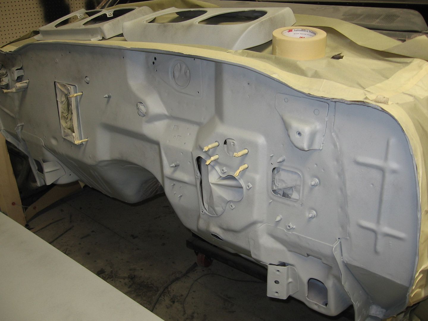

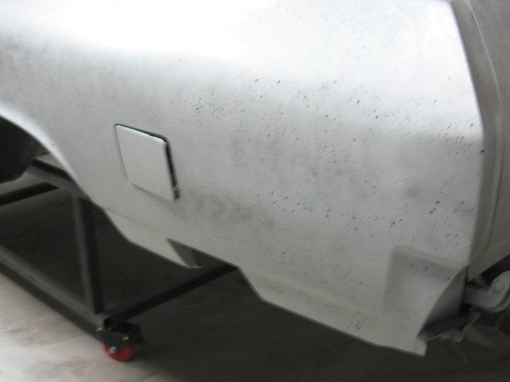

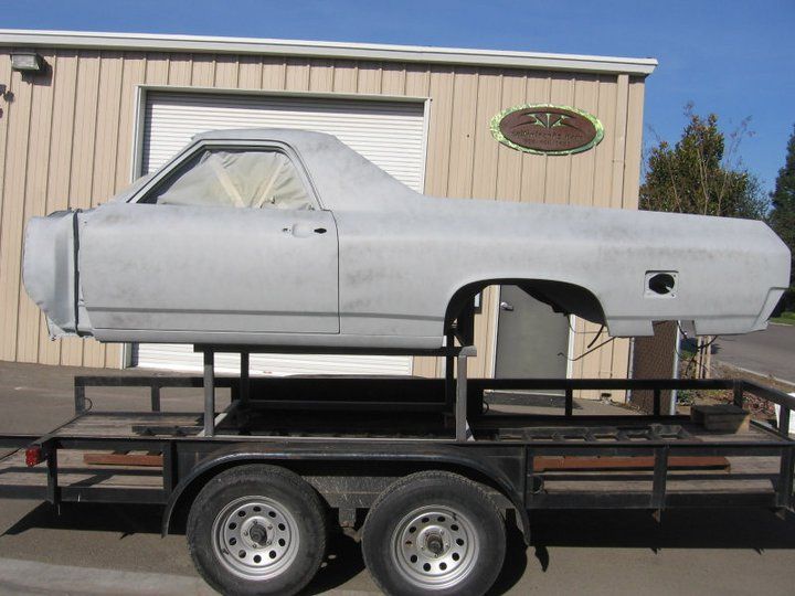

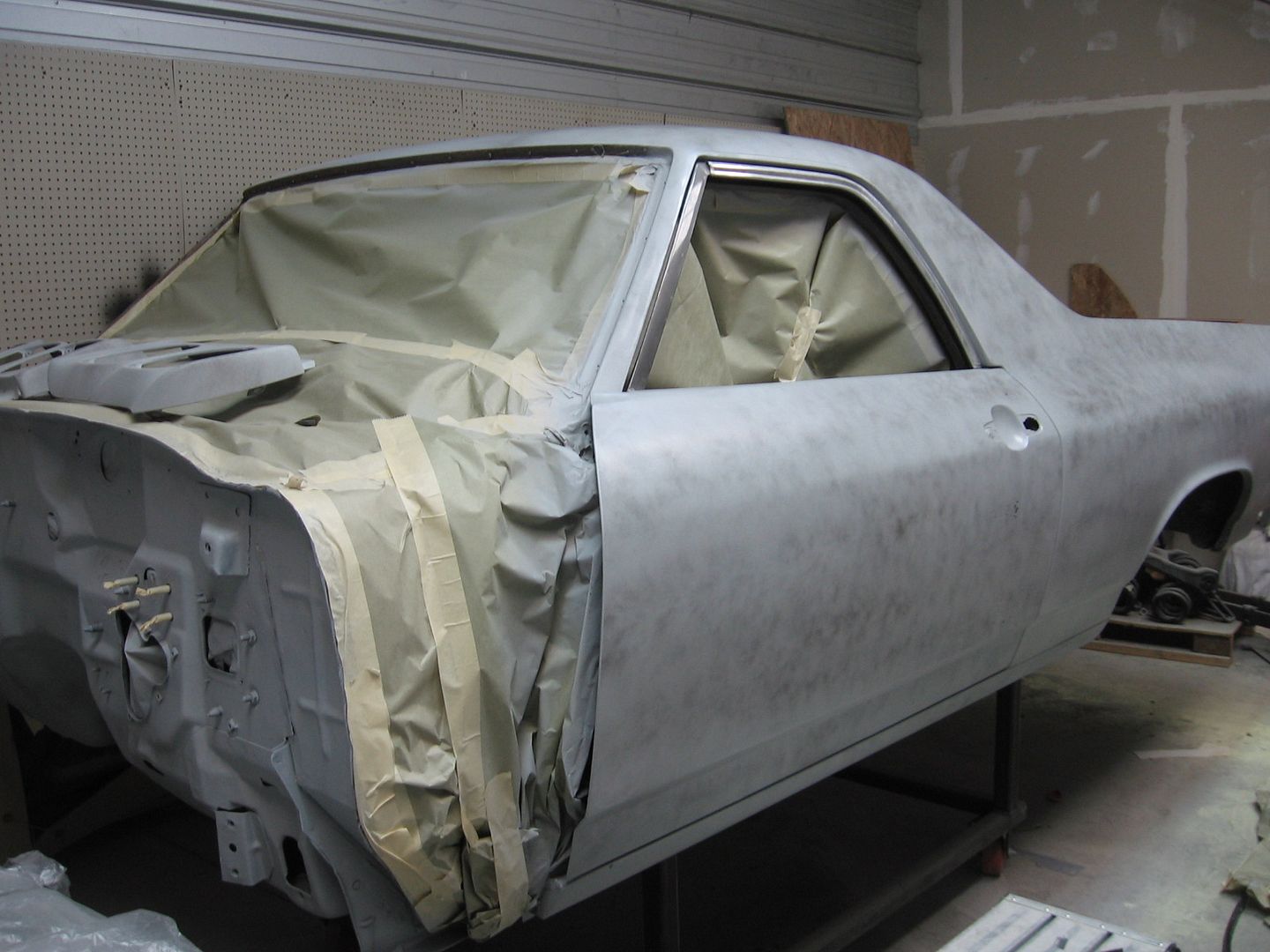

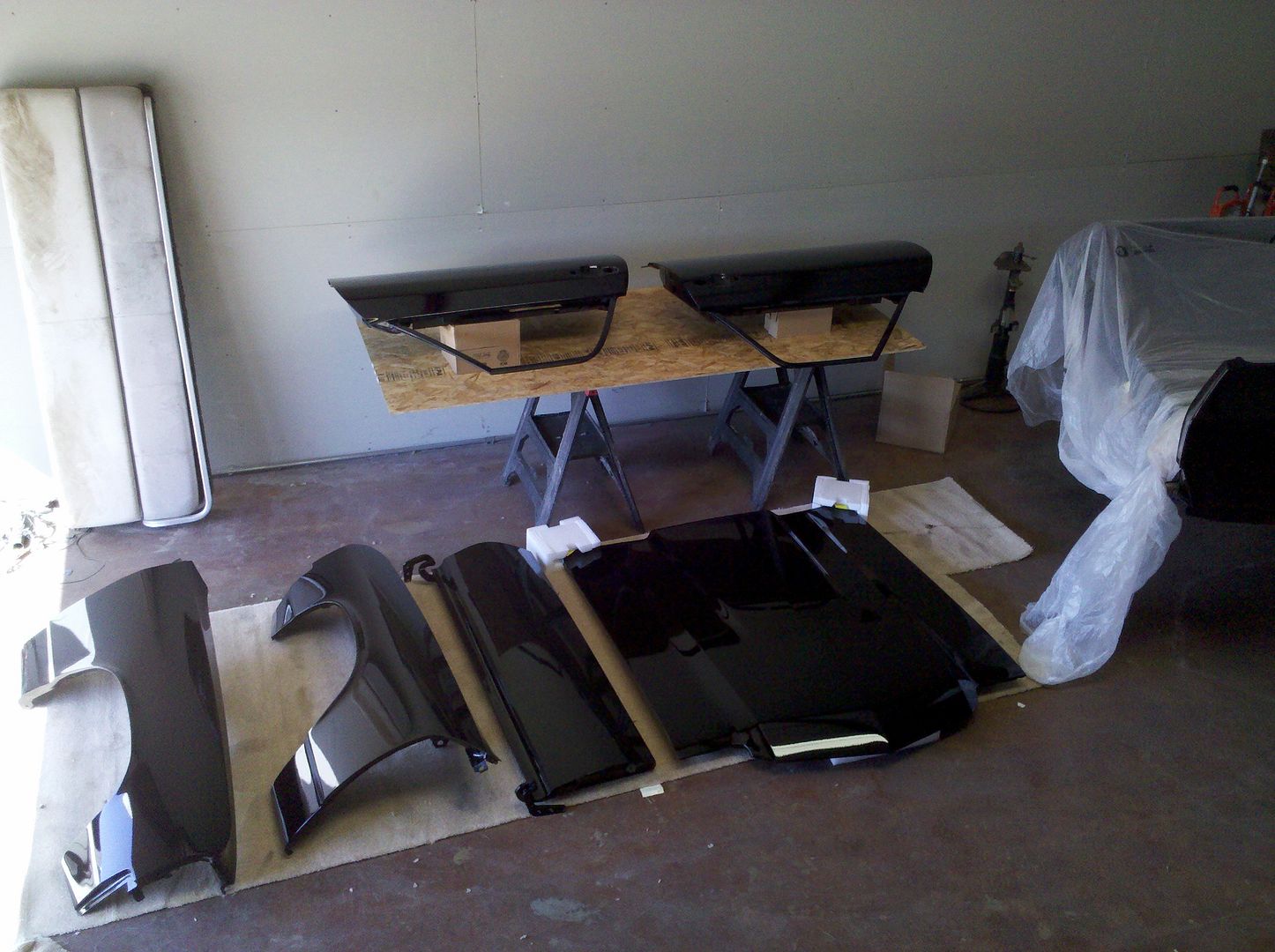

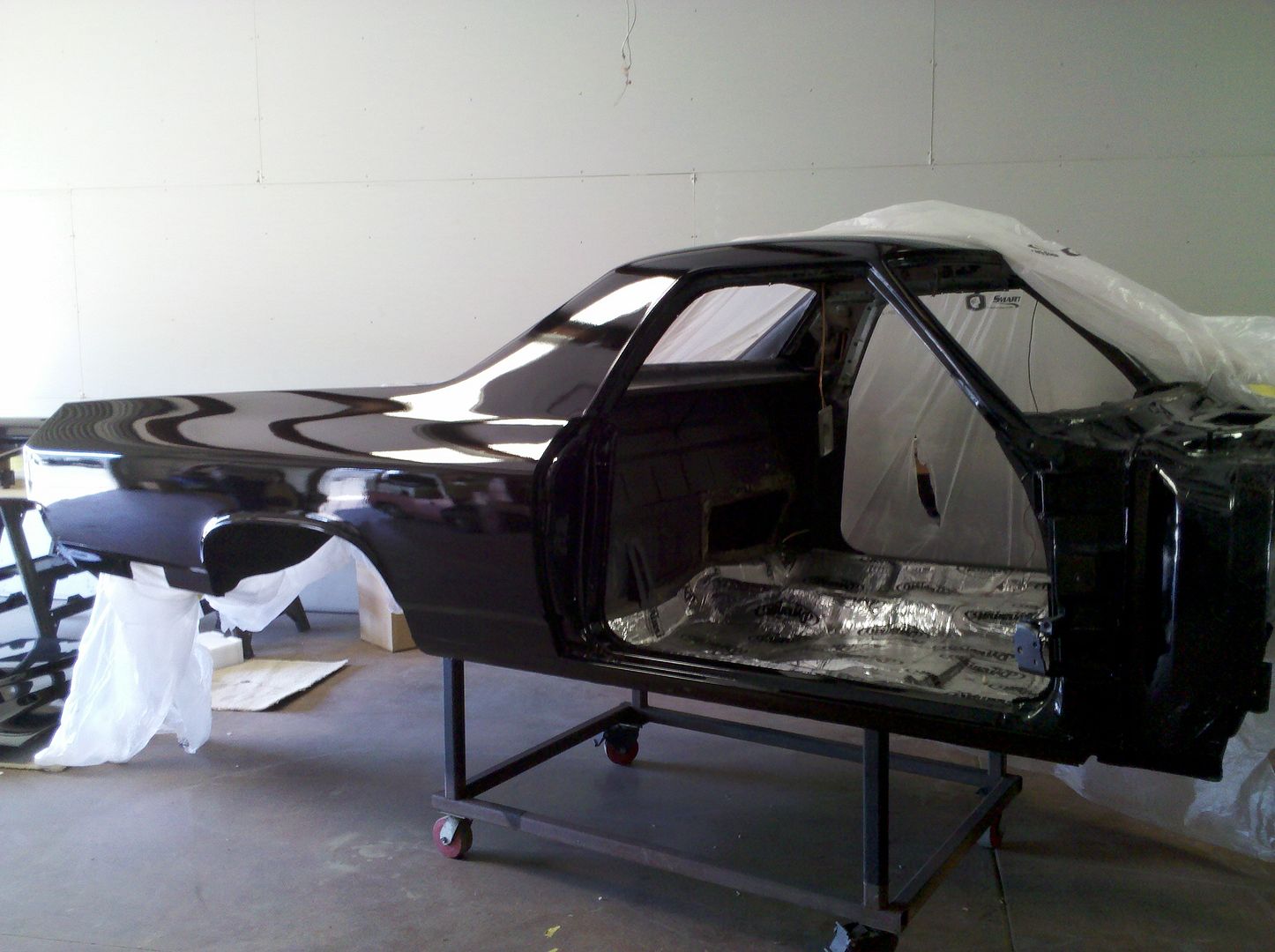

Metalwork complete. Panels aligned/ gapped. Blasted. First round of bodywork done. Just outta the booth.
http://i5.photobucket.com/albums/y18...mino/EC012.jpg
http://i5.photobucket.com/albums/y18...mino/EC014.jpg
http://i5.photobucket.com/albums/y18...mino/EC015.jpg
http://i5.photobucket.com/albums/y18...mino/EC016.jpg
http://i5.photobucket.com/albums/y18...mino/EC017.jpg
http://i5.photobucket.com/albums/y18...mino/EC018.jpg

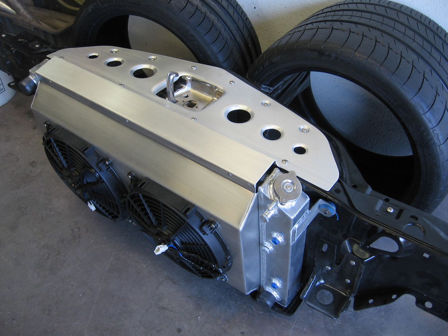

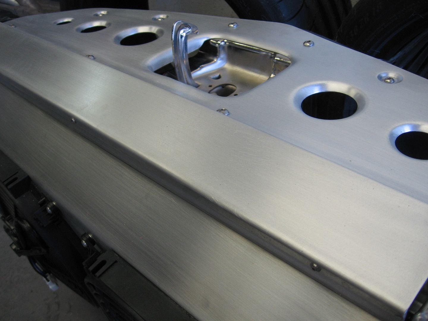

Got the radiator mounted, shroud and close-out almost done. Still undecided on whether to keep it brushed or 60% gloss black.
http://i5.photobucket.com/albums/y18...mino/EC037.jpg
http://i5.photobucket.com/albums/y18...mino/EC036.jpg

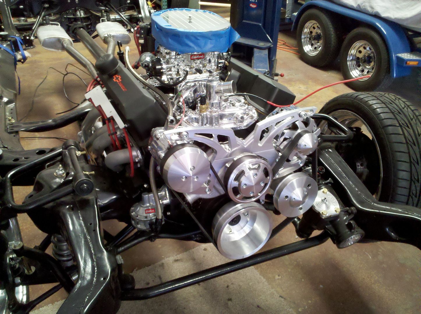

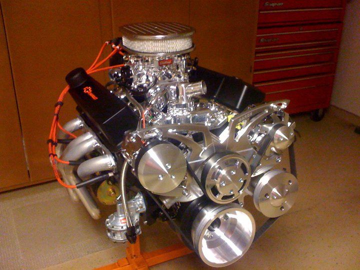

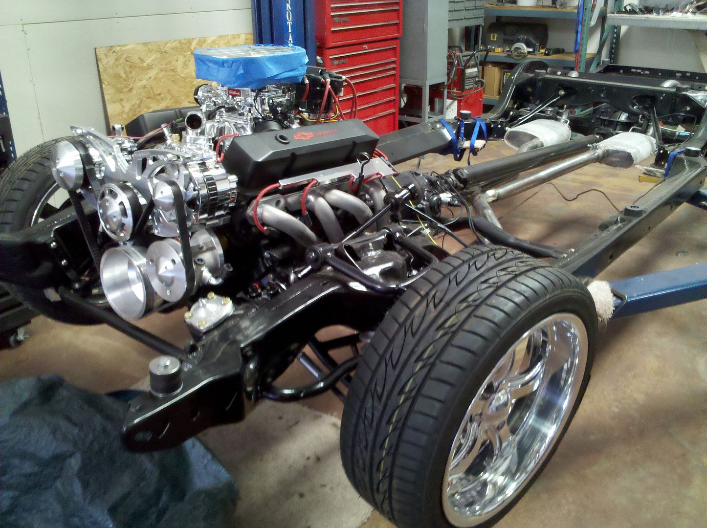

Motor is done. Chassis and parts back from p/c. Startin' to put the puzzle back together.
http://i5.photobucket.com/albums/y18...mino/EC022.jpg
http://i5.photobucket.com/albums/y18...mino/EC025.jpg
http://i5.photobucket.com/albums/y18...mino/EC028.jpg

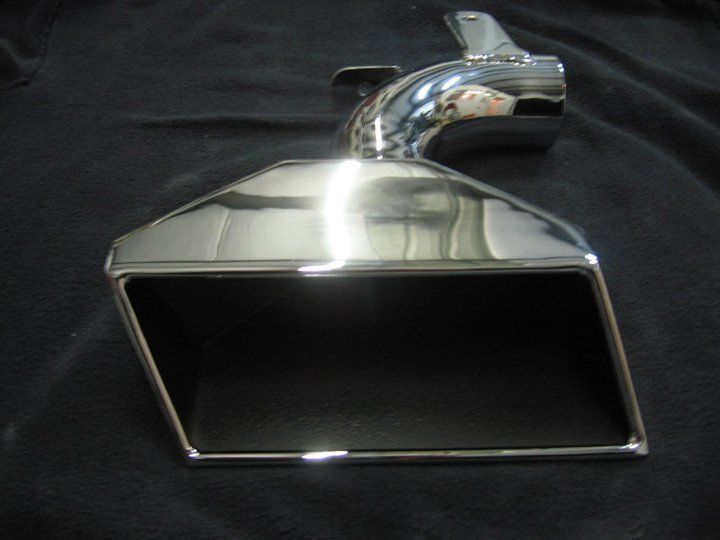

Not a lot of chrome or polish going on this build. On the exterior, other than the wheels, the only polish will be the trim around the windshield and rear glass, the trim around the two grill openings, and the ehaust tips. All of which are rectangle in shape. This is it for the brightwork. Off to chrome...
http://i5.photobucket.com/albums/y18...mino/EC040.jpg

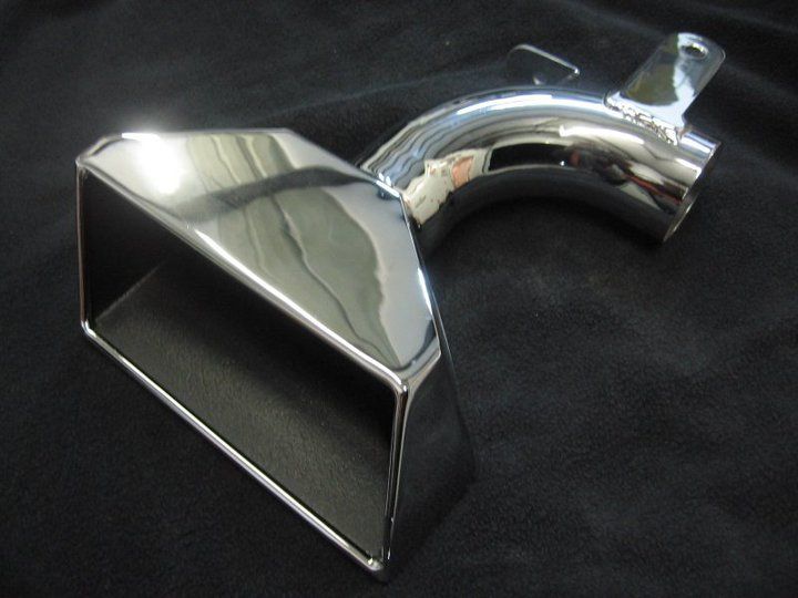

Tips are done...
http://i5.photobucket.com/albums/y18...mino/EC029.jpg
http://i5.photobucket.com/albums/y18...mino/EC030.jpg

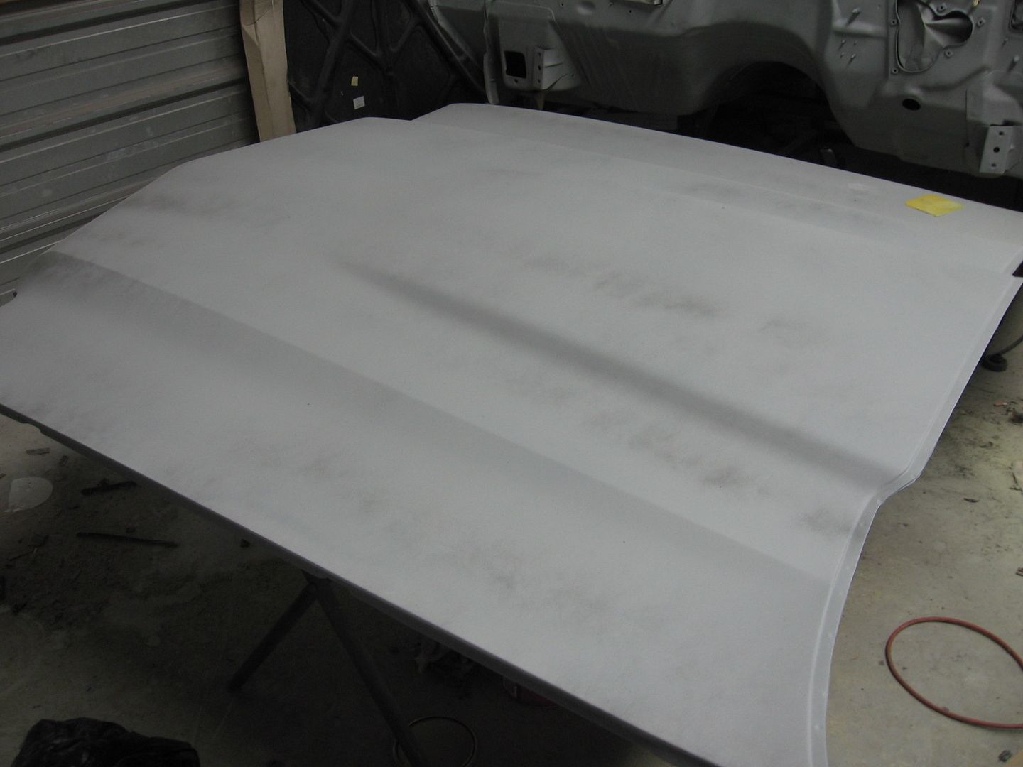

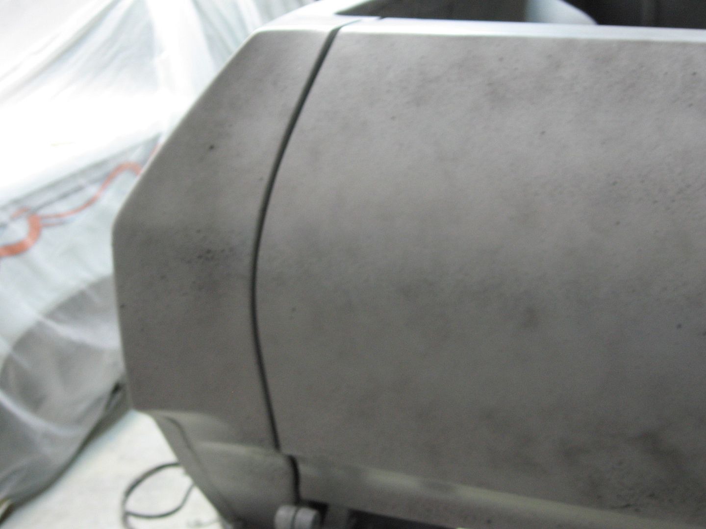

Final blocking.

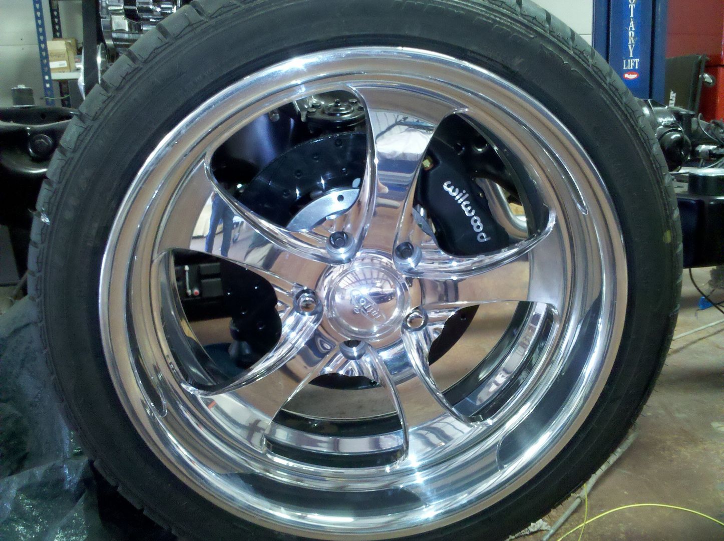

Finally got some pictures organized.

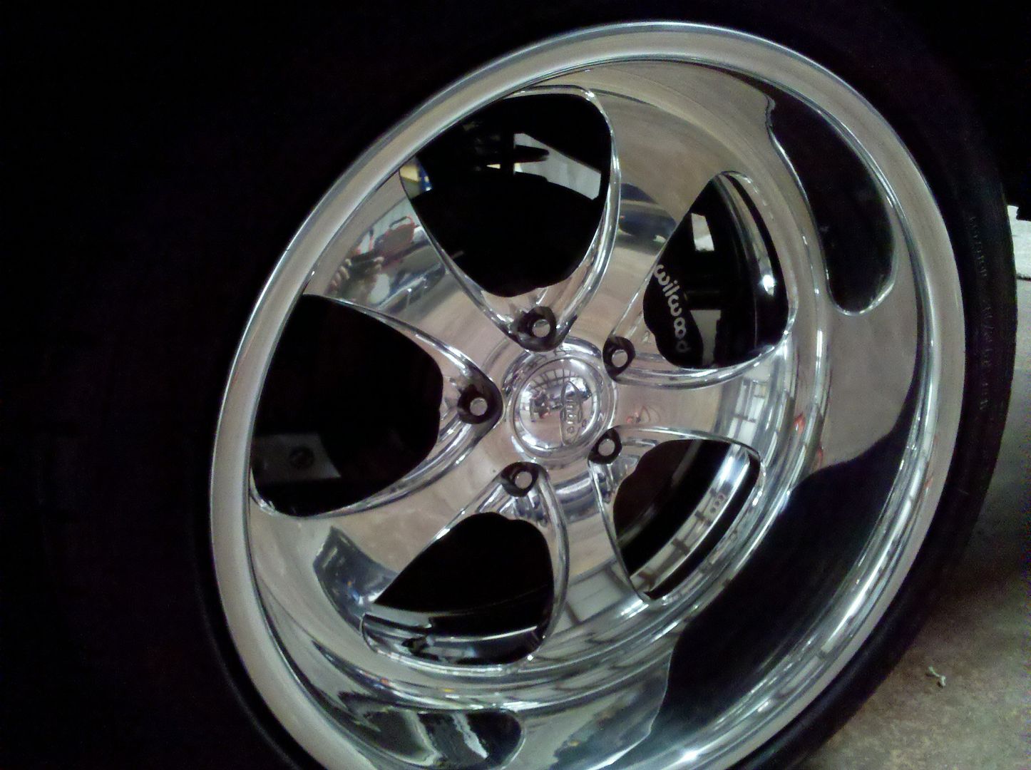

The owner wanted a simple 5 spoke design. The 18x8 and 19x10 Intro Pentias will work well...
http://i5.photobucket.com/albums/y18...mino/EC056.jpg
http://i5.photobucket.com/albums/y18...mino/EC026.jpg

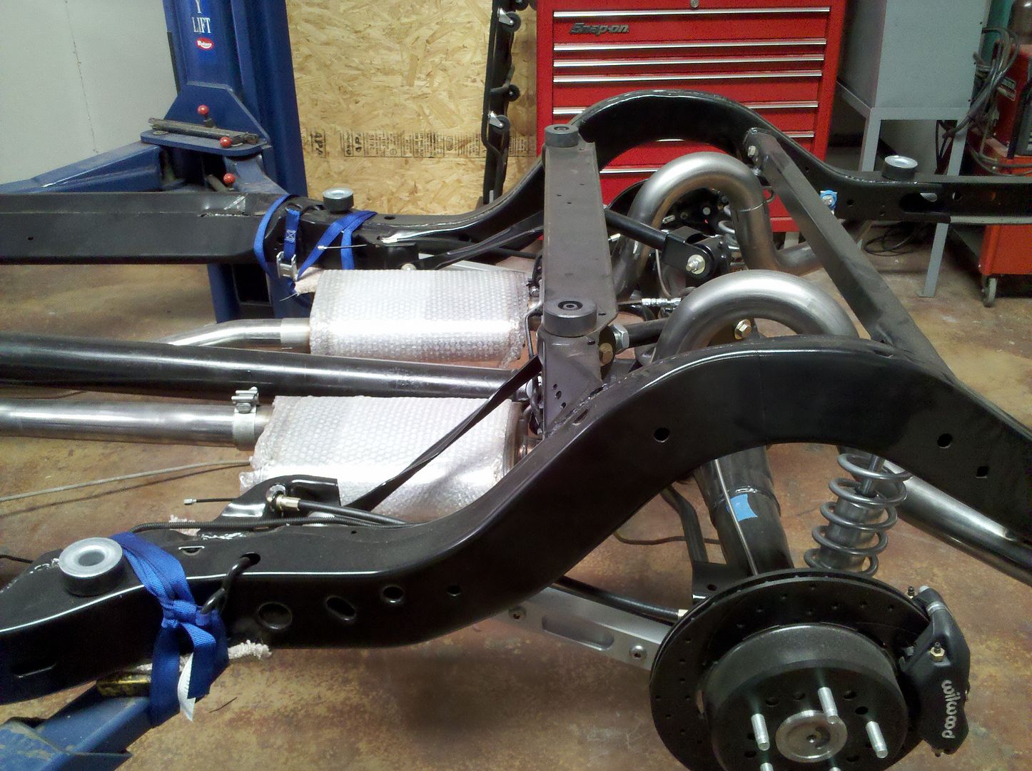

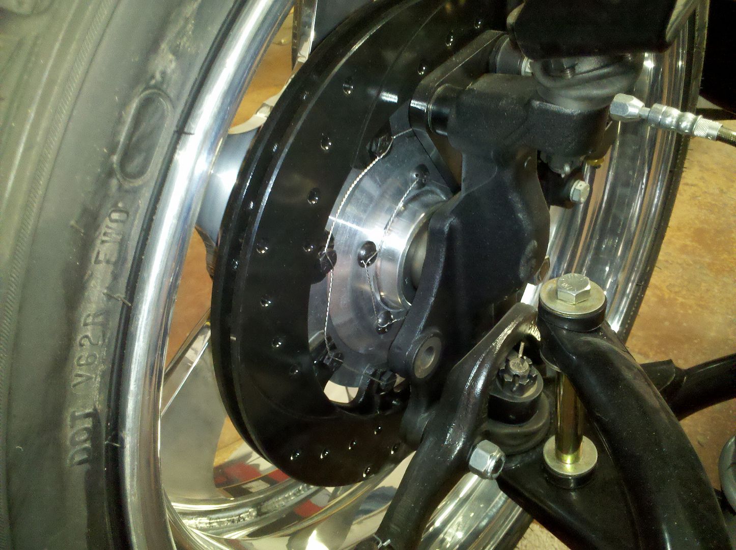

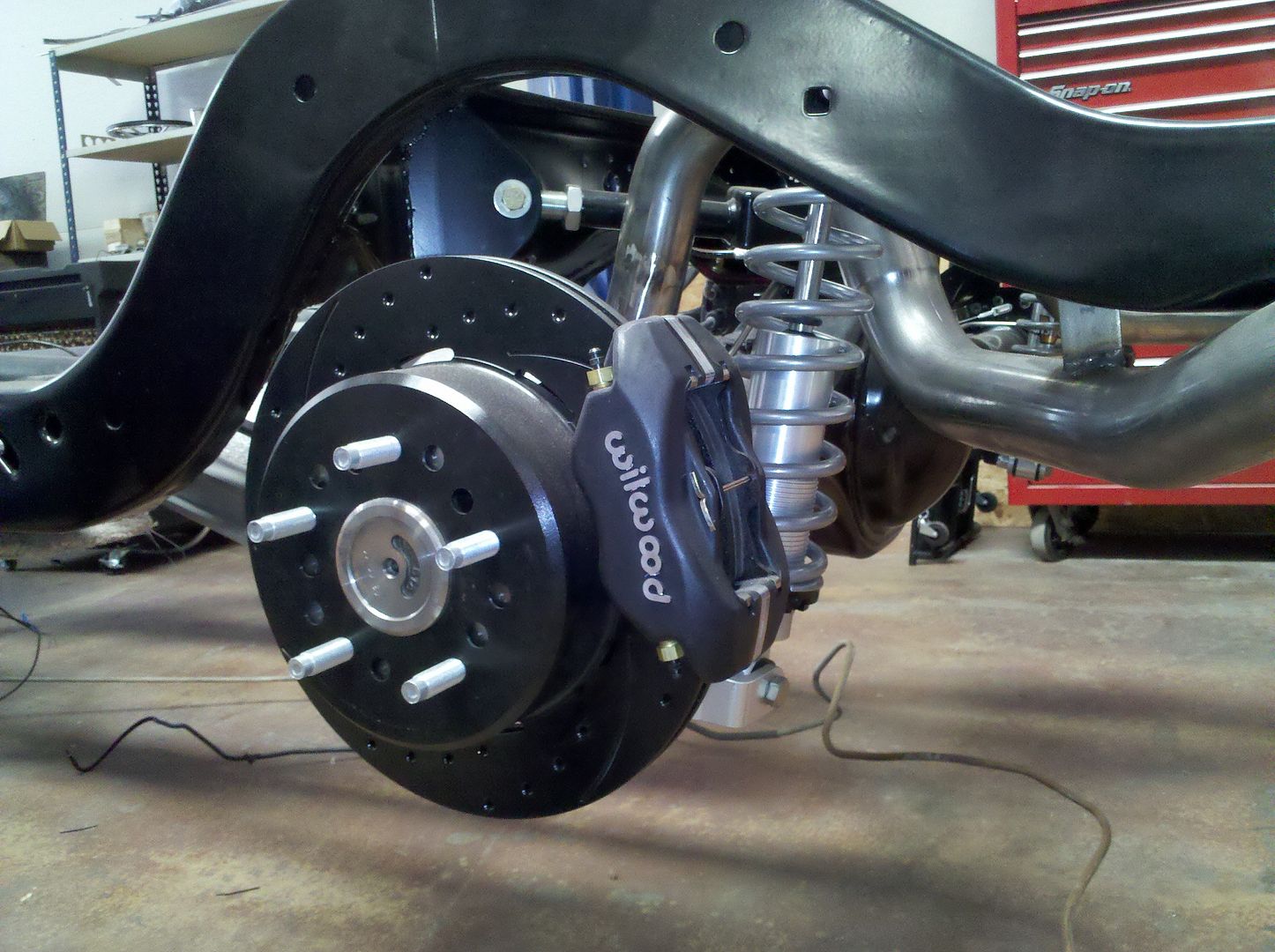

Chassis is almost complete. Chris Alston coilover conversion front and rear. Basic Wilwood set-up.
http://i5.photobucket.com/albums/y18...mino/EC023.jpg
http://i5.photobucket.com/albums/y18...mino/EC024.jpg
http://i5.photobucket.com/albums/y18...mino/EC027.jpg

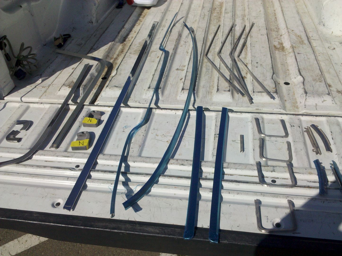

bed pics
If you get a chance could you post more pics of the bed trim part as I am also doing an elcamino and want to remove most of the chrome trim. Damn that thing is going to be sick when it’s done.
Yes, I sure can. I'll have to dig them up, but I will.
