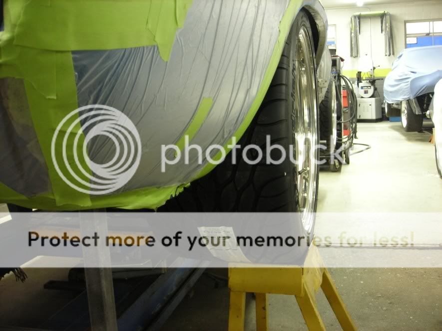

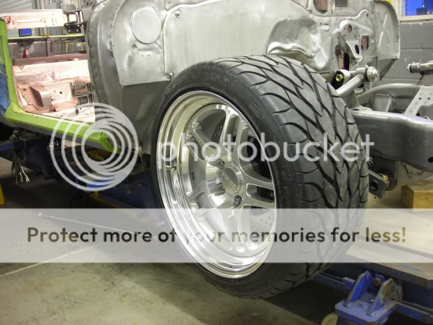

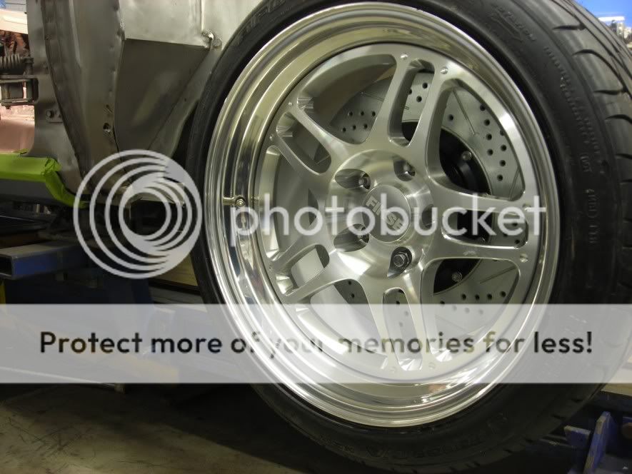

Originally Posted by Jamess113 (Post 266831)
We got the Fikse wheels back from Forgline yesterday. We had Forgline widen them and they came out great! The seemed to be pretty good to deal with and took them about a month to get them done. We were able to reuse the old BFG 275/35 18's the were on the rear by putting them up front, and got a new set of BFG 335/30 18's for the rear. Here's a couple pic's
