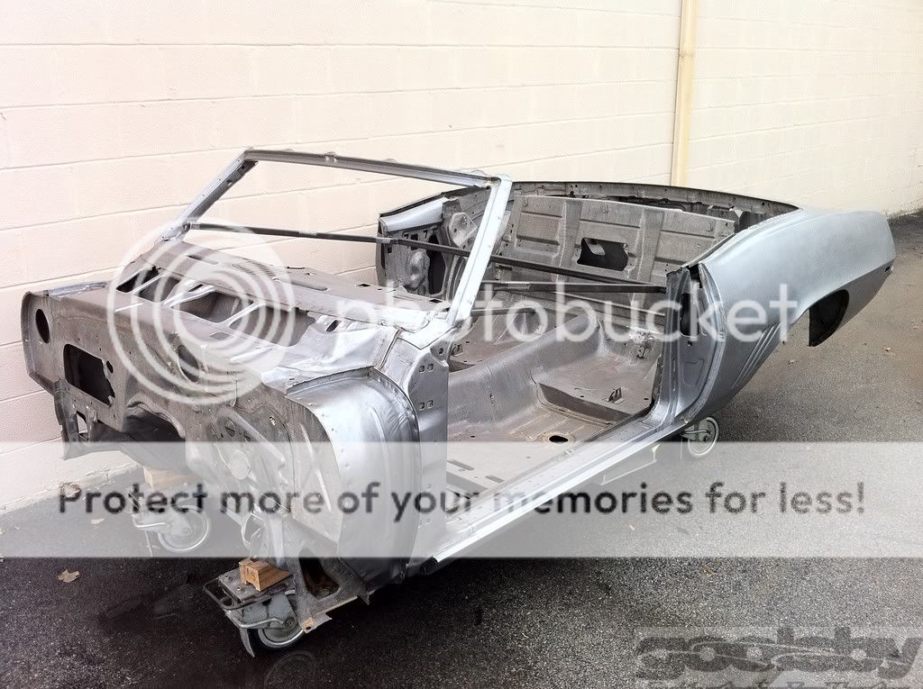

Goolsby Customs is proud to announce we have begun the build for Lokar on their 69 Camaro convertible to debut at Sema 2012. We are extremely honored and privileged to be chosen to build a car for such a great company with a tremendous reputation, and look foward to working with many great friends/partners on this project and creating something pretty special.
The talent pool of Ben Hemance was once again tapped to put some ideas on paper and he of course knocked it out of the park once again.
http://i767.photobucket.com/albums/x.../rendering.jpg

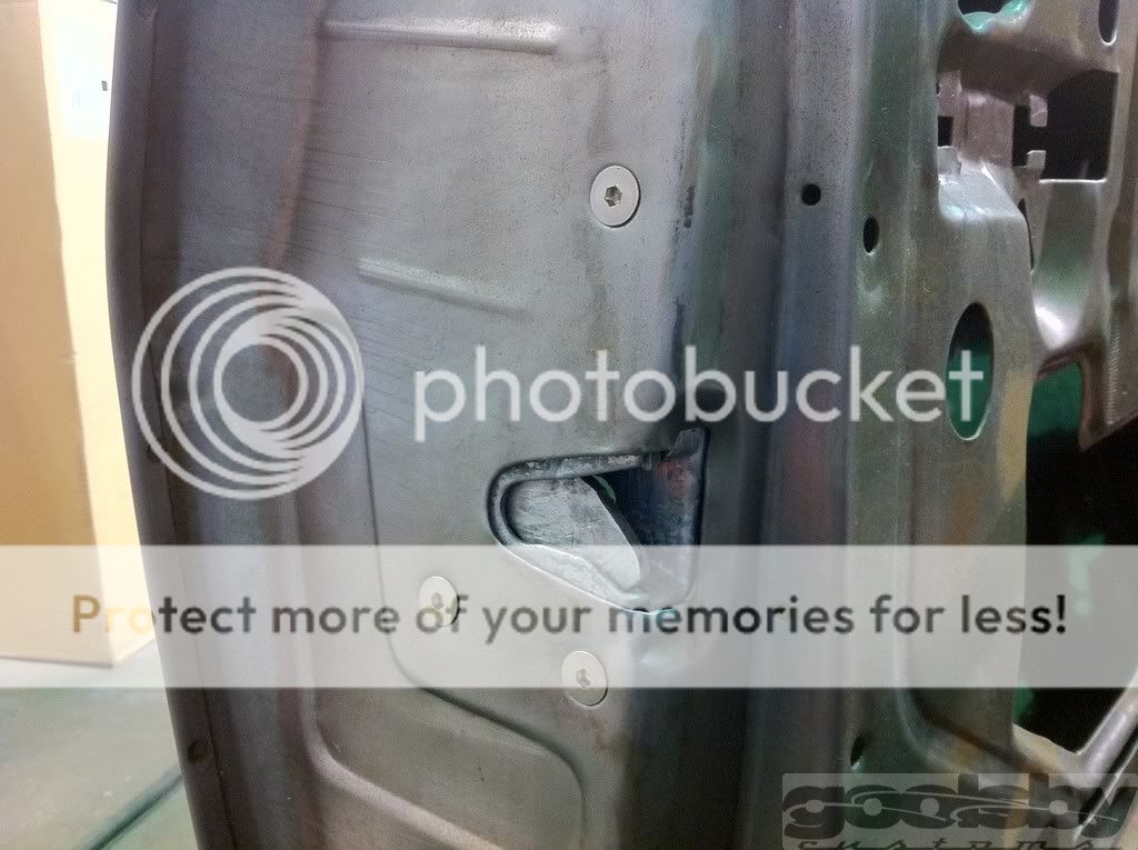

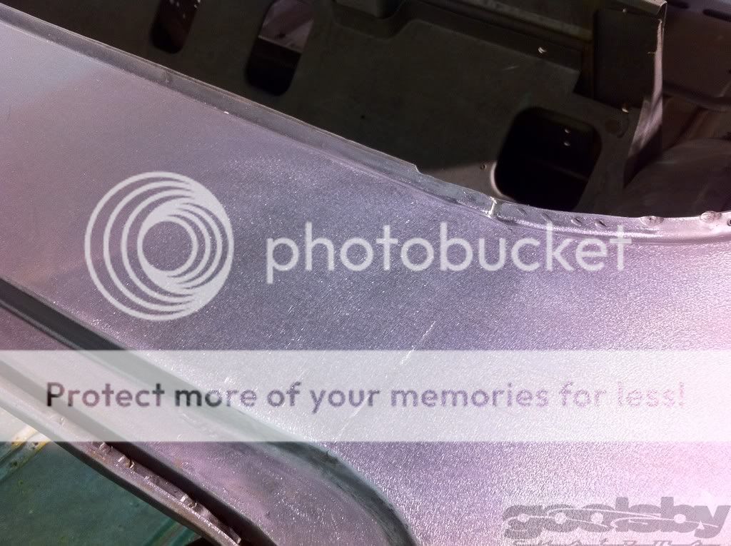

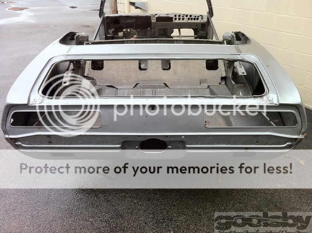

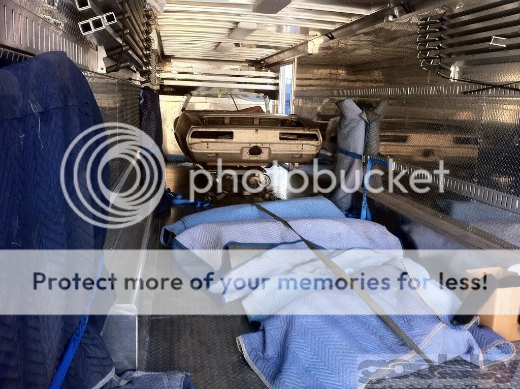

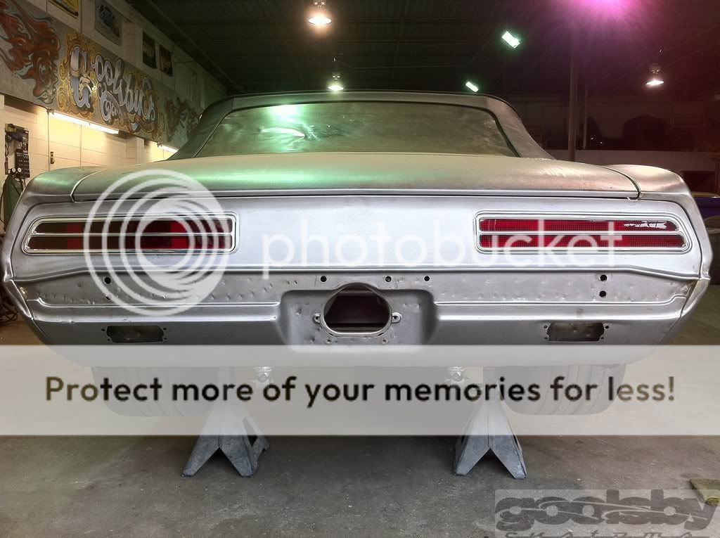

Lokar came down and brought us what turned out to be the nicest 1st gen we have probably ever seen ....
http://i767.photobucket.com/albums/x...Image00013.jpg
http://i767.photobucket.com/albums/x...Image00011.jpg
http://i767.photobucket.com/albums/x...Image00018.jpg
http://i767.photobucket.com/albums/x...Image00016.jpg
http://i767.photobucket.com/albums/x...Image00012.jpg
http://i767.photobucket.com/albums/x...Image00010.jpg
http://i767.photobucket.com/albums/x...Image00008.jpg
http://i767.photobucket.com/albums/x...Image00027.jpg

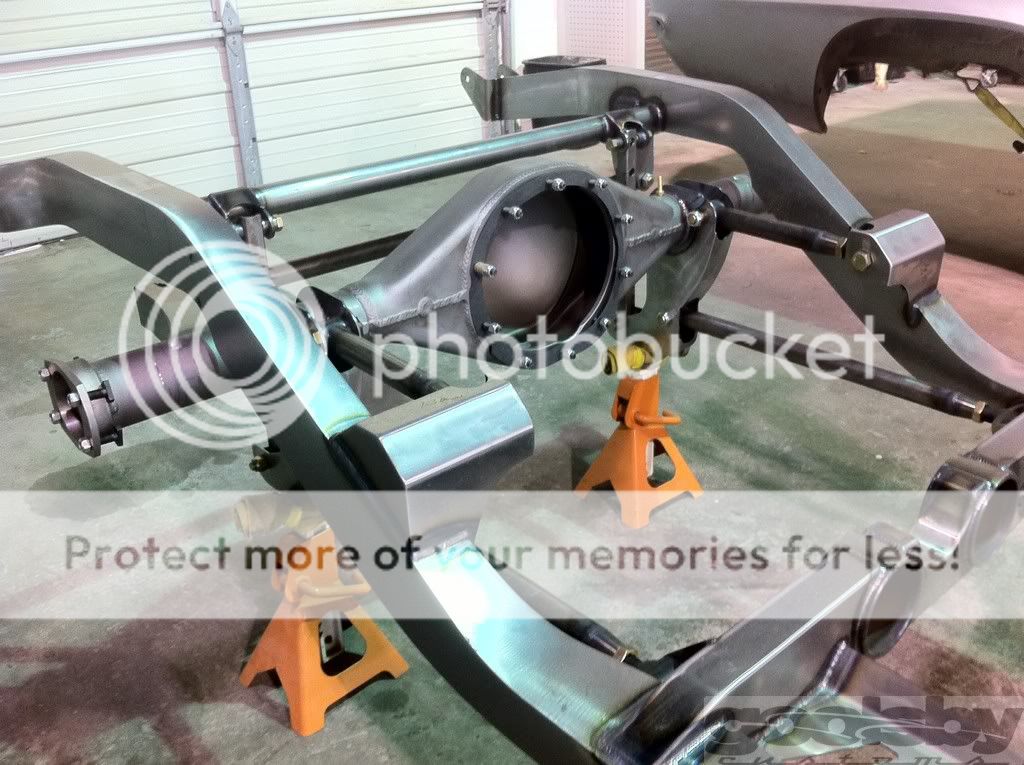

GoolsbyCustoms 12-15-2011 03:01 PM

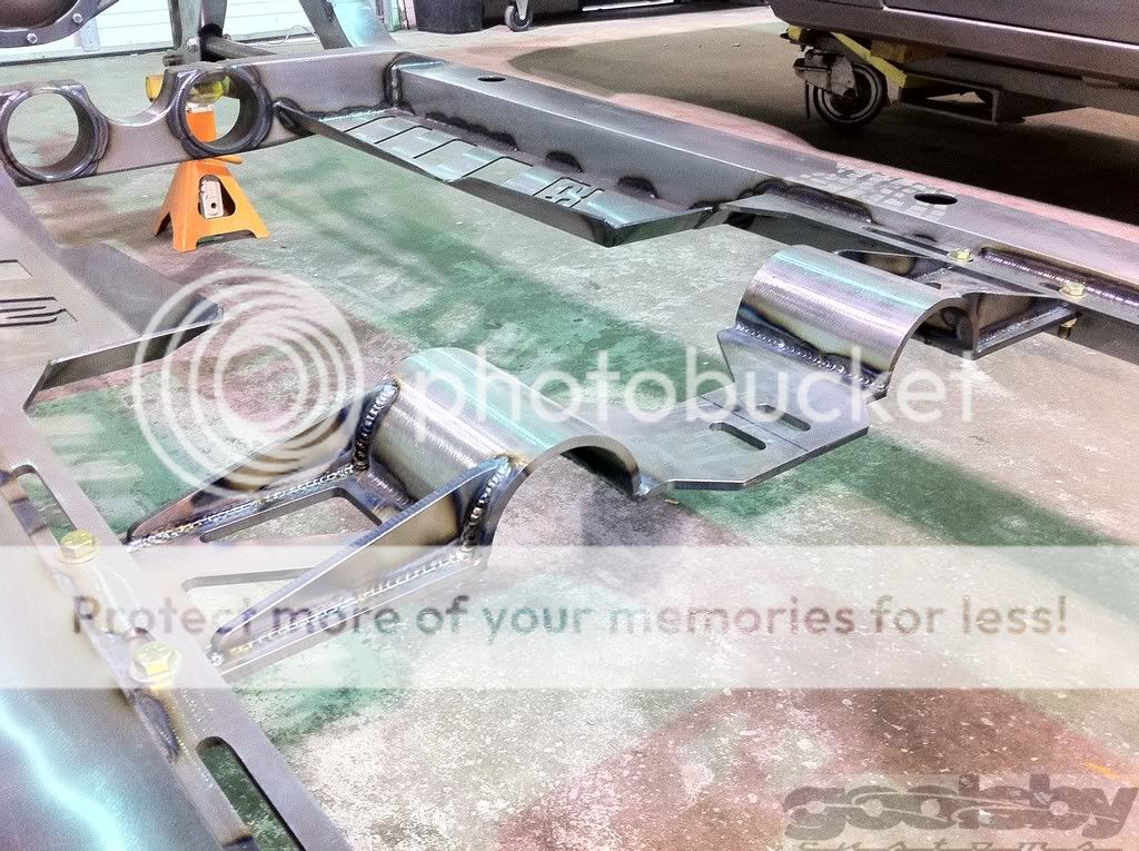

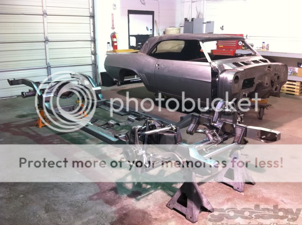

From the start of this build we knew we wanted to turn to our friends and those "all around great guys" at the Roadster Shop for another one of ther Fast Track Chassis. We have been using several of their frames lately and we have always said how great they were but when we got this chassis in I must say they do build them low, strong ,and fast
http://i767.photobucket.com/albums/x...Image00019.jpg
http://i767.photobucket.com/albums/x...Image00021.jpg
http://i767.photobucket.com/albums/x...Image00023.jpg

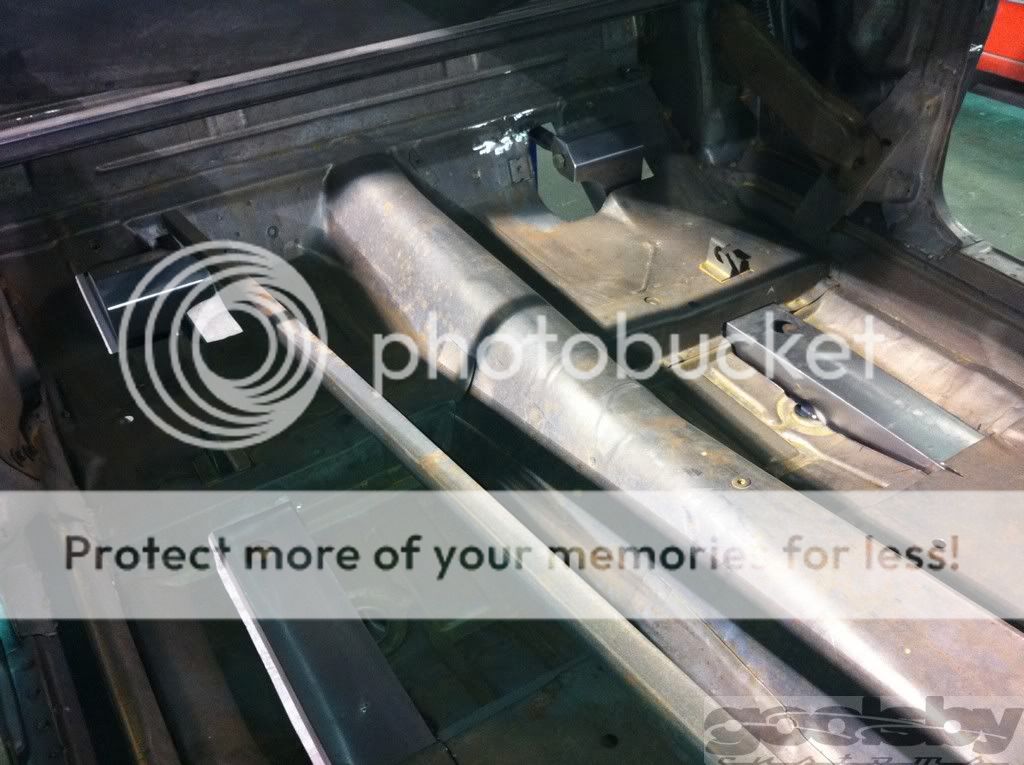

Does that chassis require the complete floor cut out or how does it install?

GoolsbyCustoms 12-16-2011 08:35 AM
Originally Posted by Rybar (Post 384338)
Wow cool build, I can't believe I read 2 posts in a row with unreal shells to start with? Where are people finding these things :lol:
This car is unreal but I dont know the story on where it came from exactly

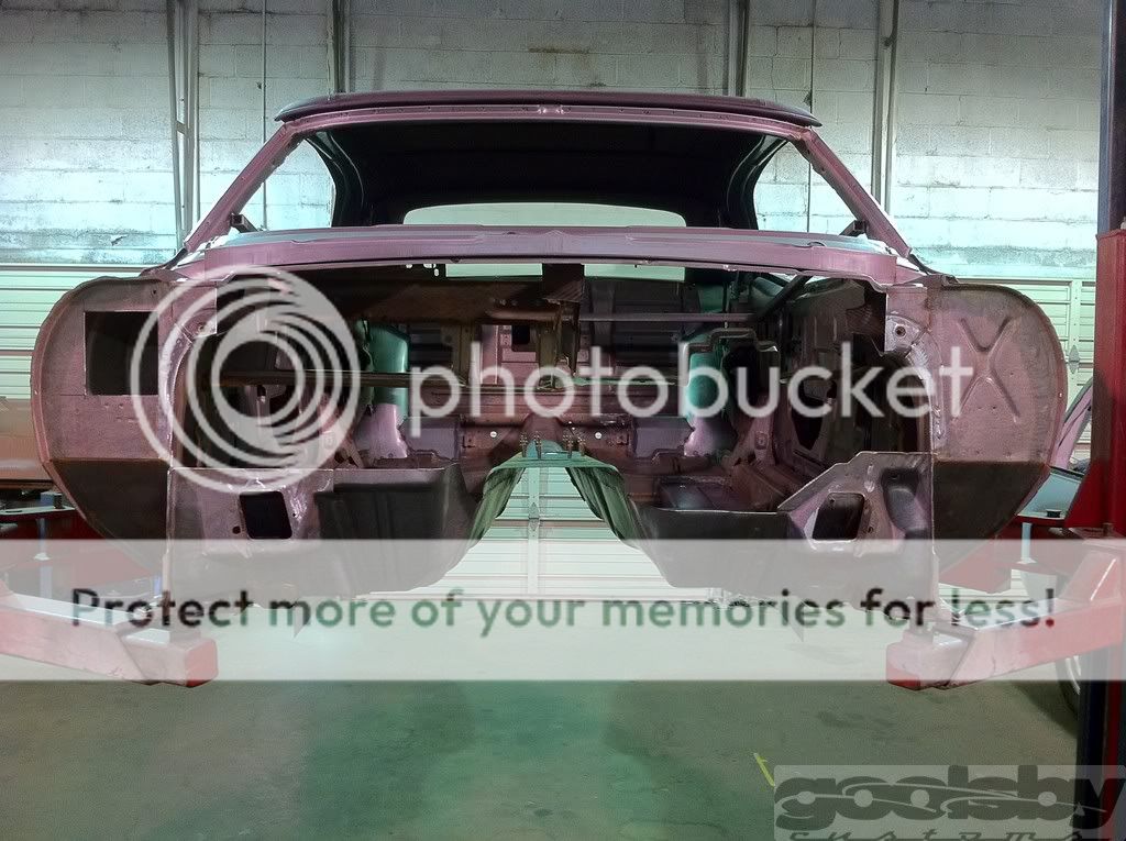

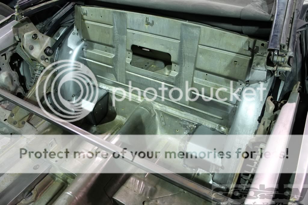

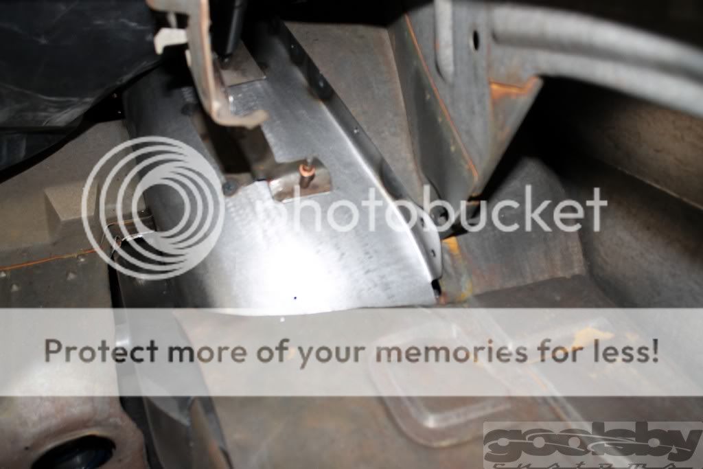

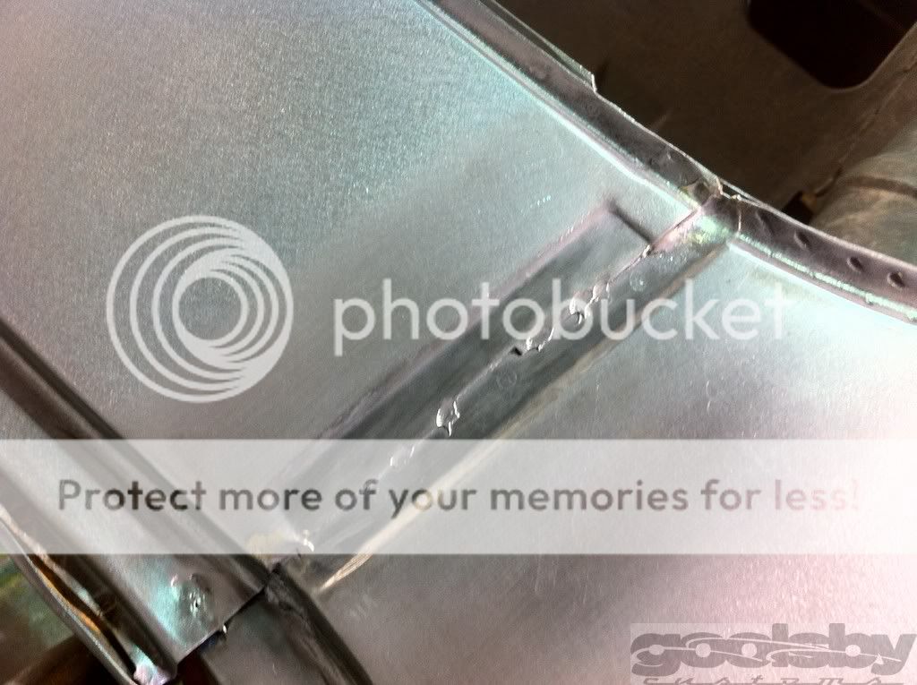

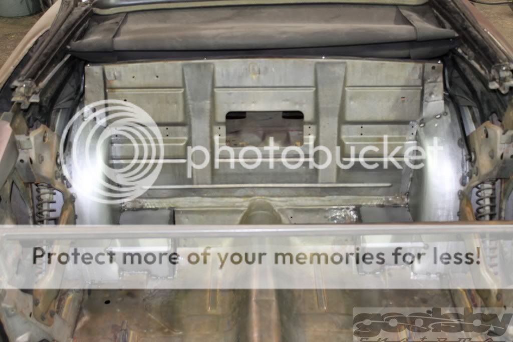

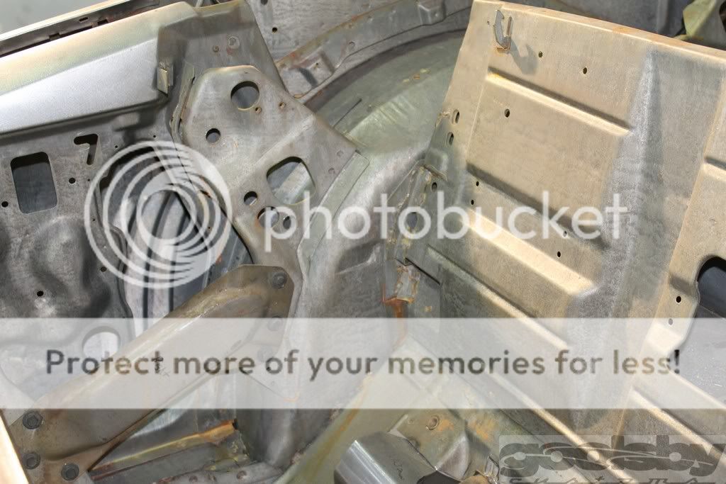

The chsssis only requires minimal cuts to the floor, about the size cut you would make for sub-frame connectors and then a hole under the rear seat for the lower four link mounts, and lastly remove the rear sub-frame rails, I will post pics of that shortly

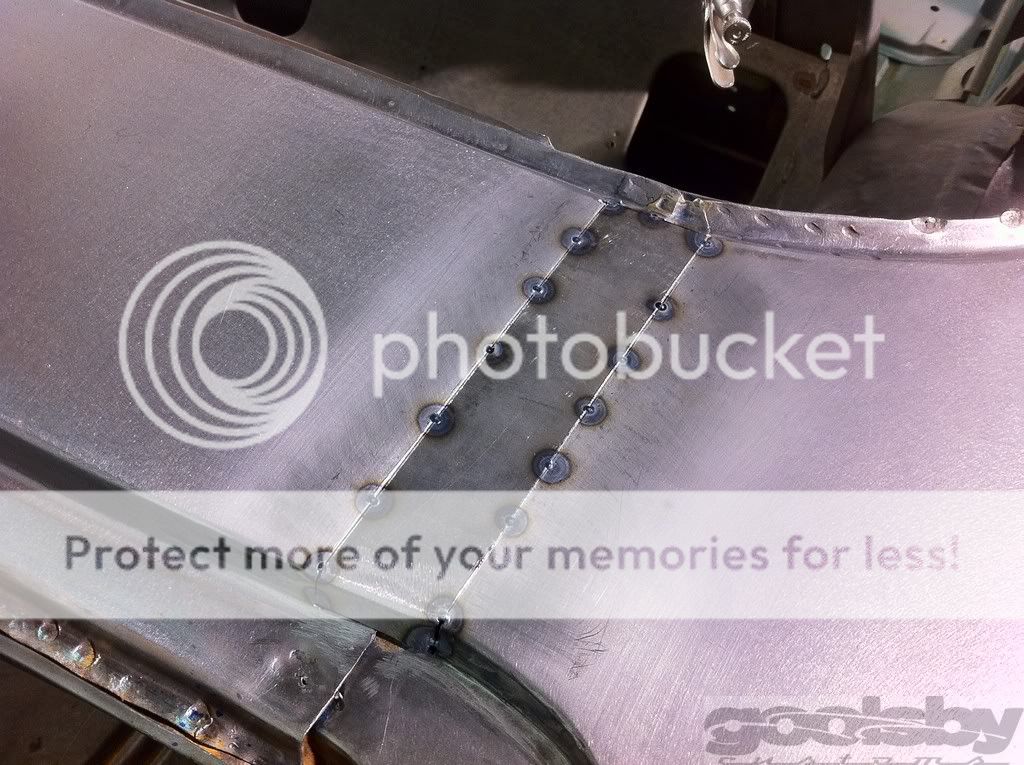

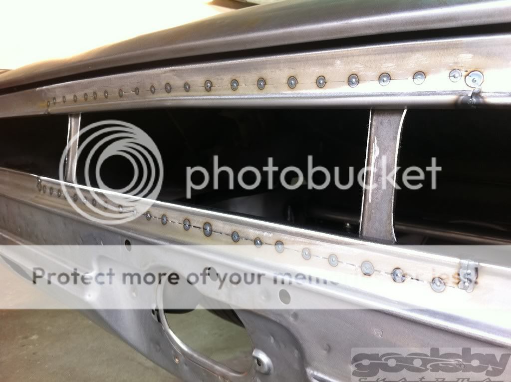

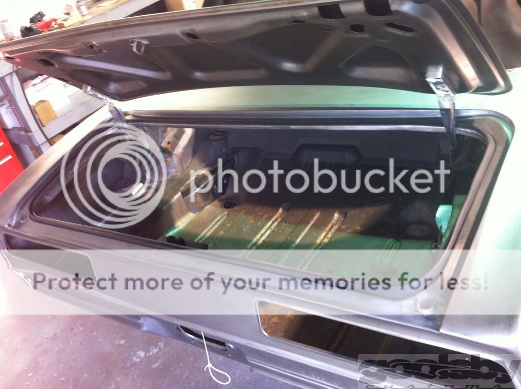

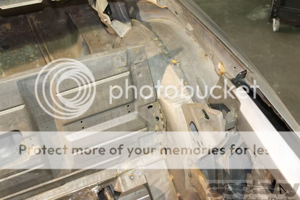

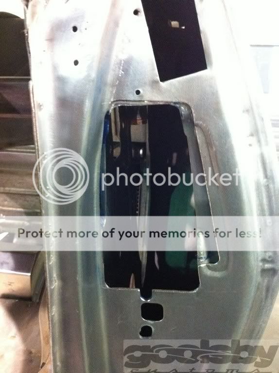

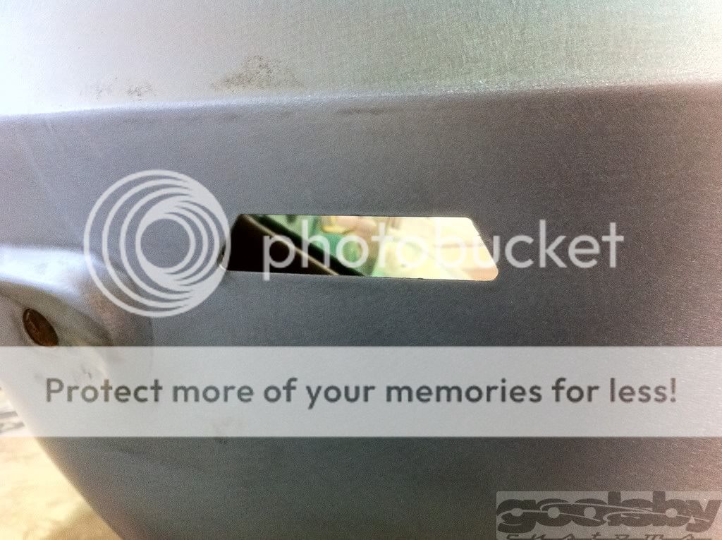

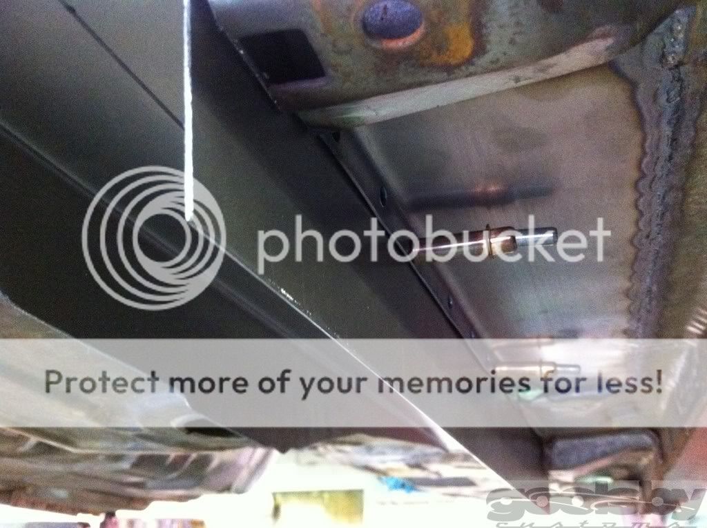

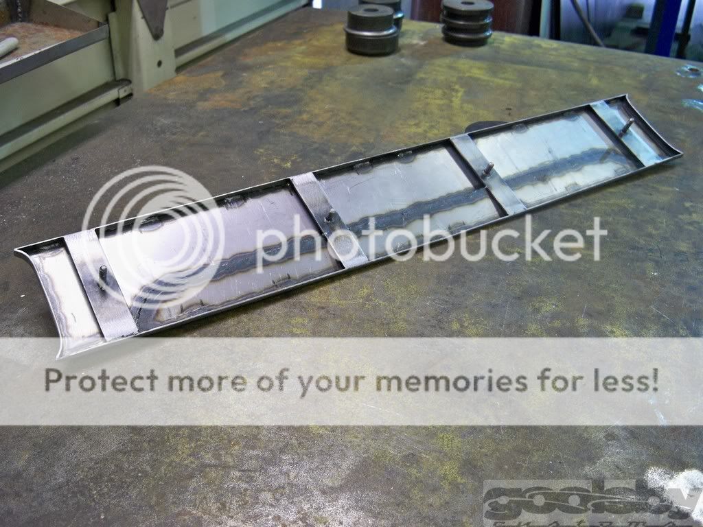

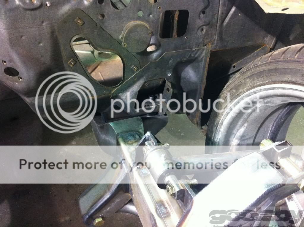

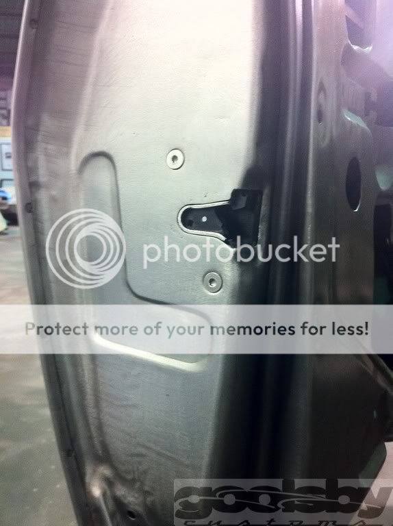

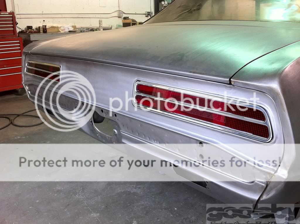

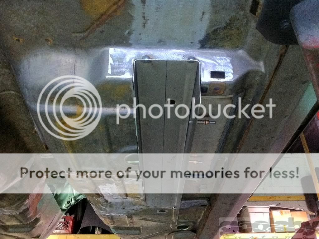

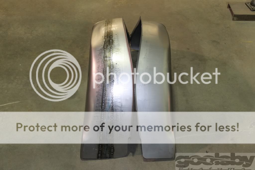

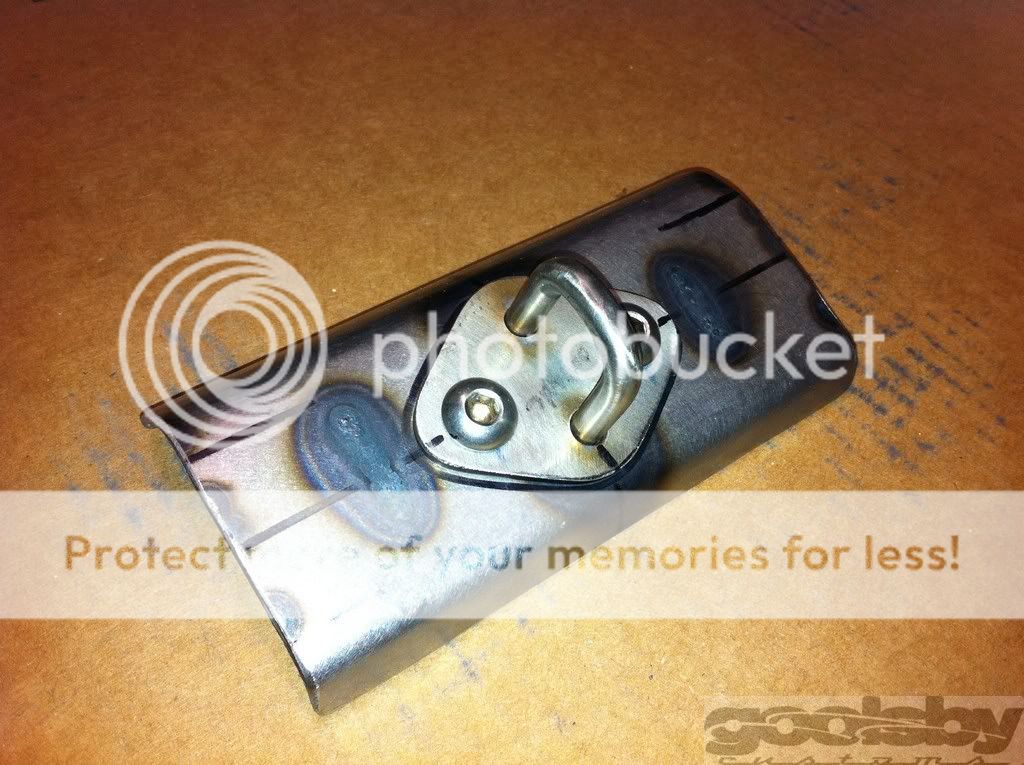

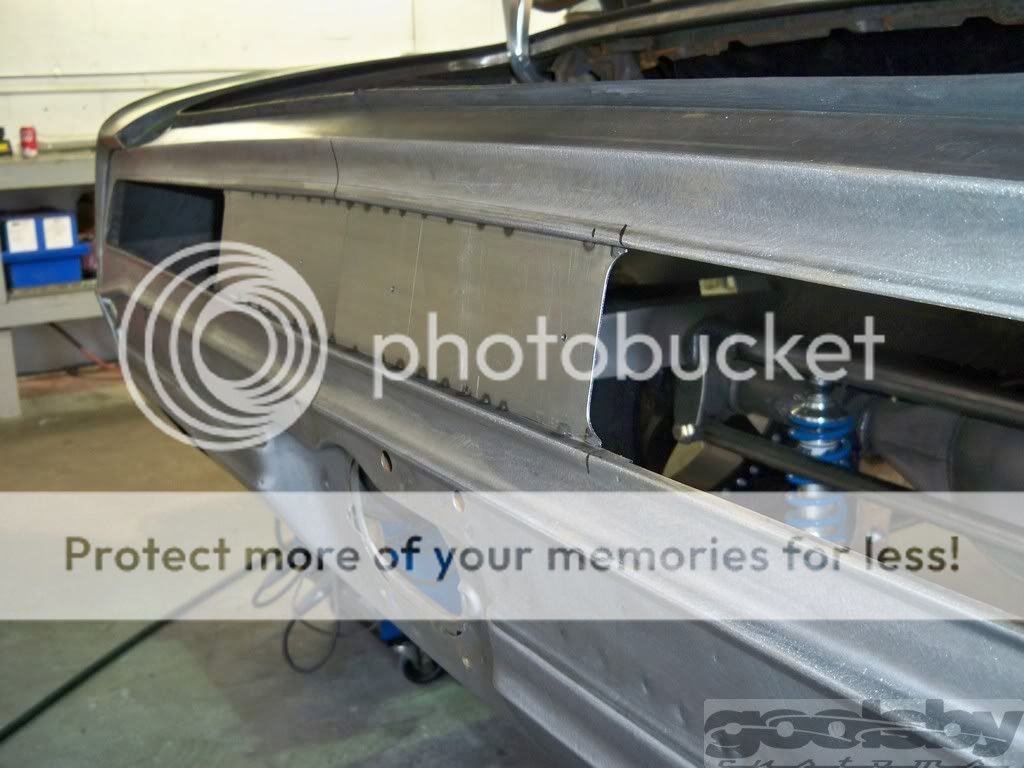

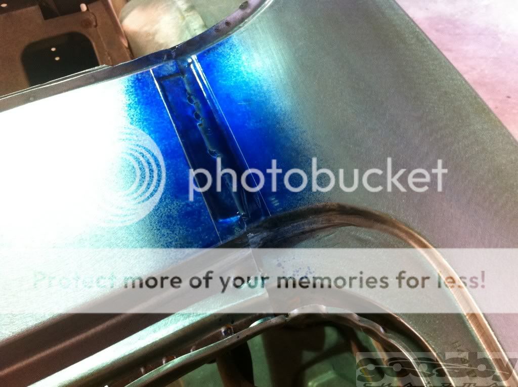

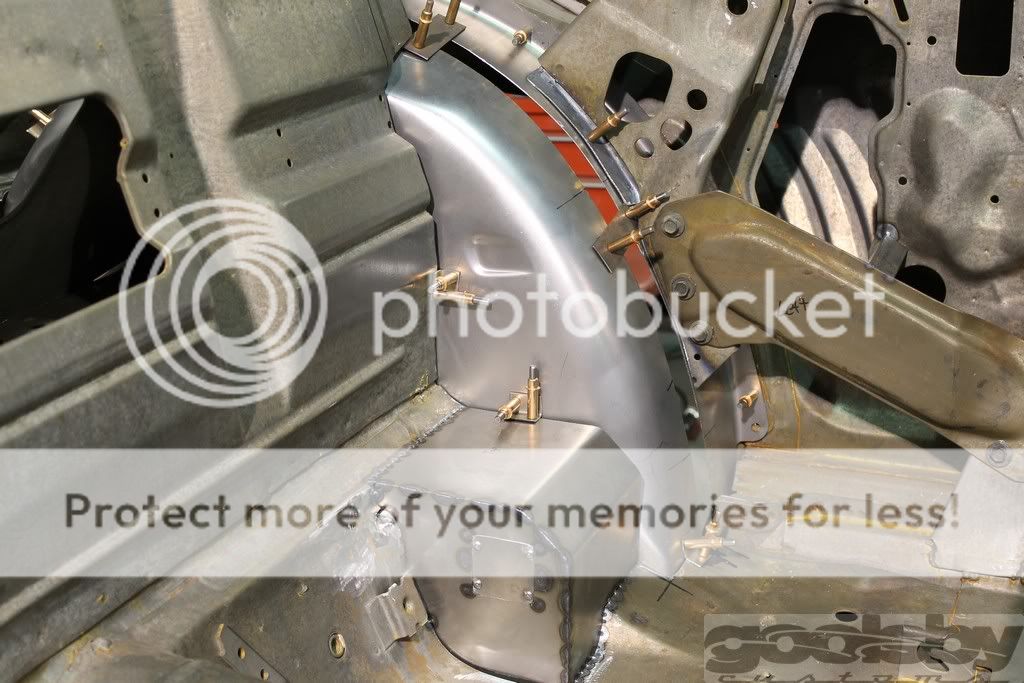

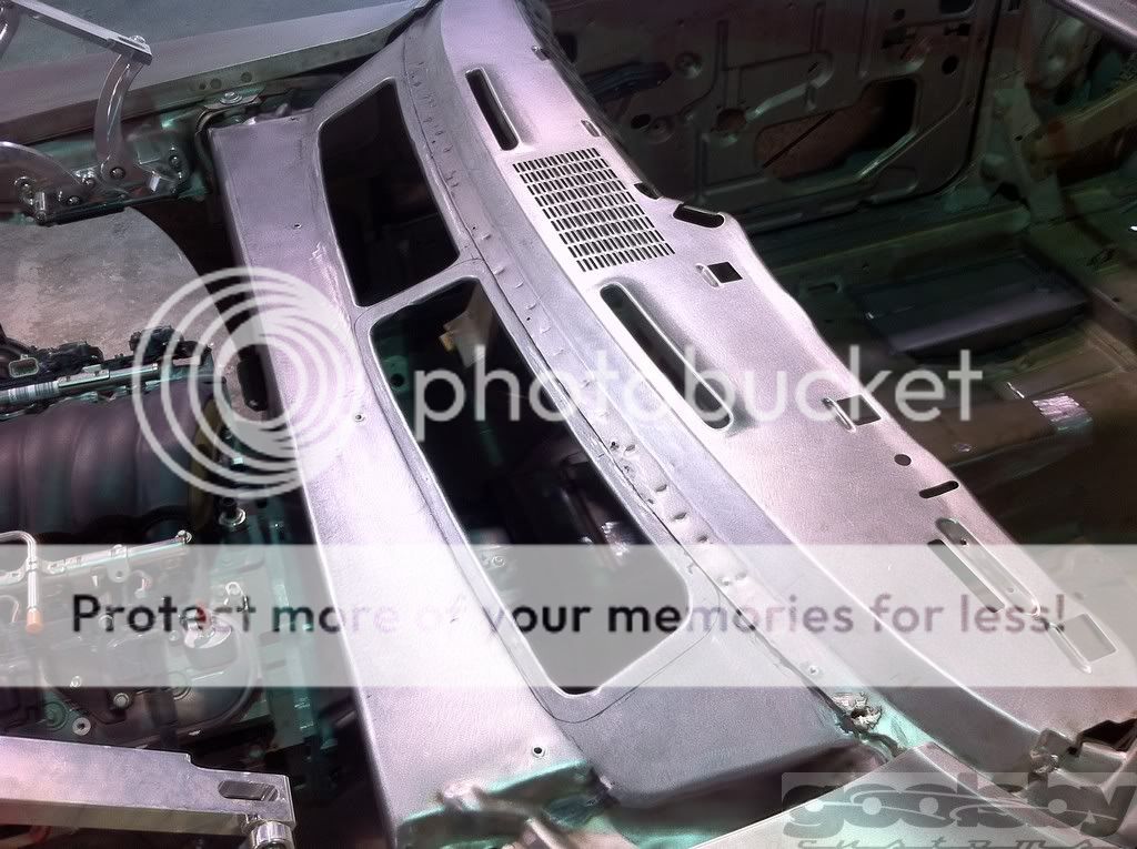

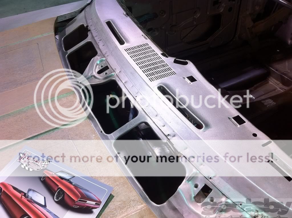

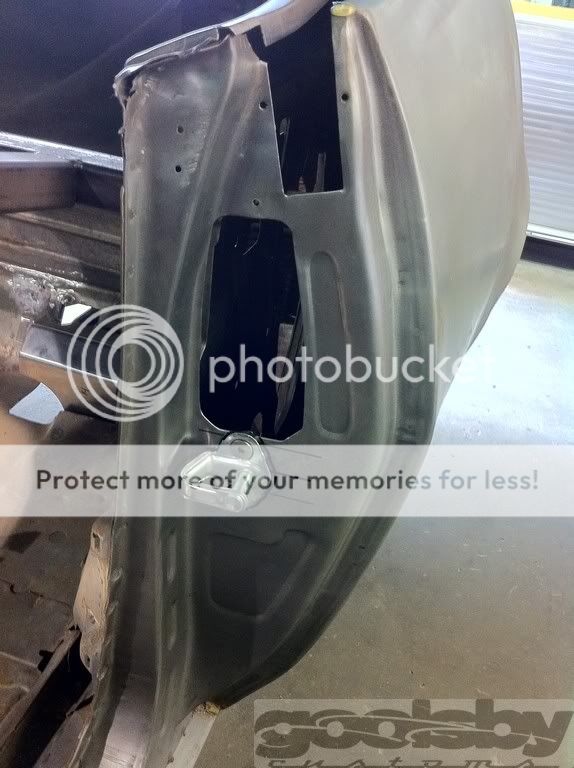

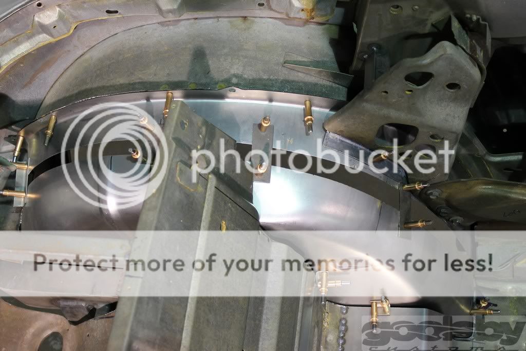

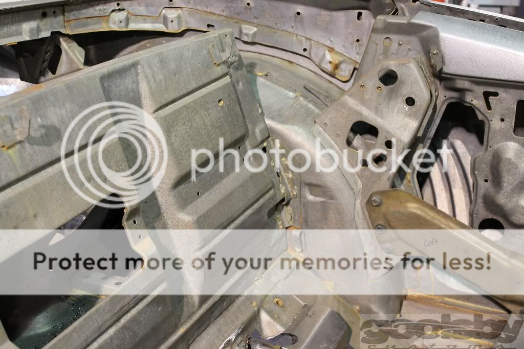

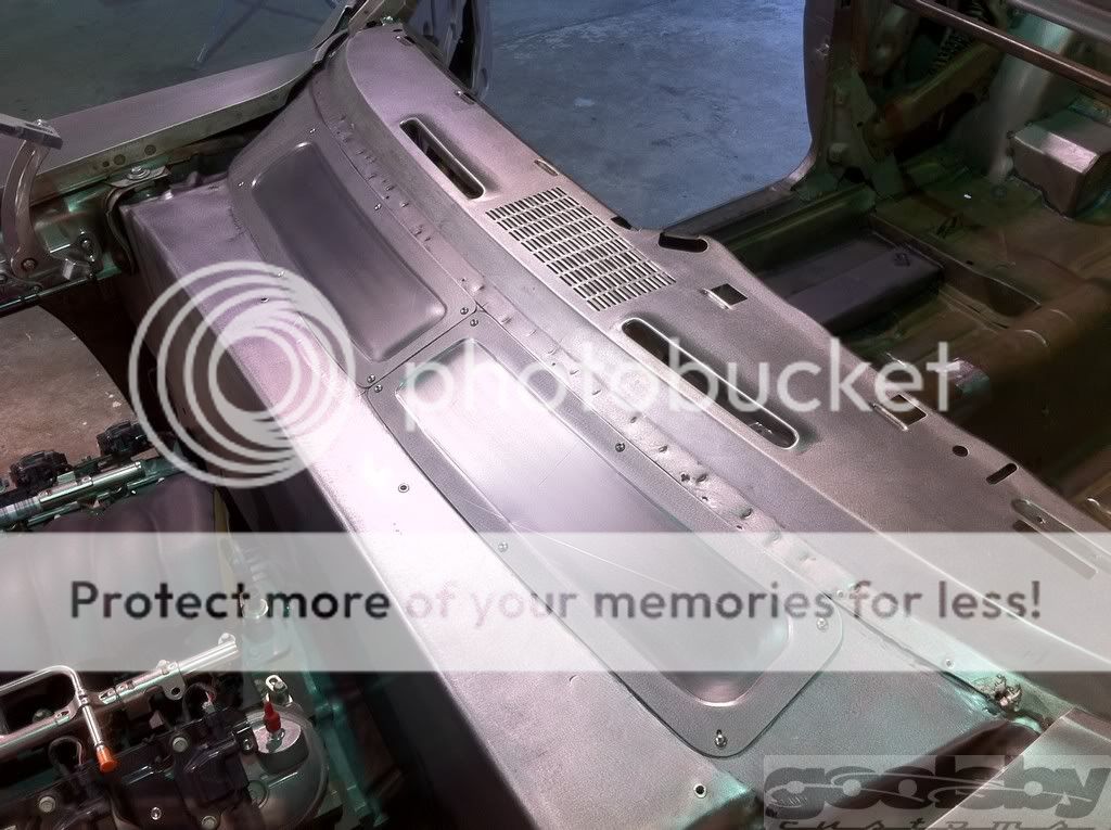

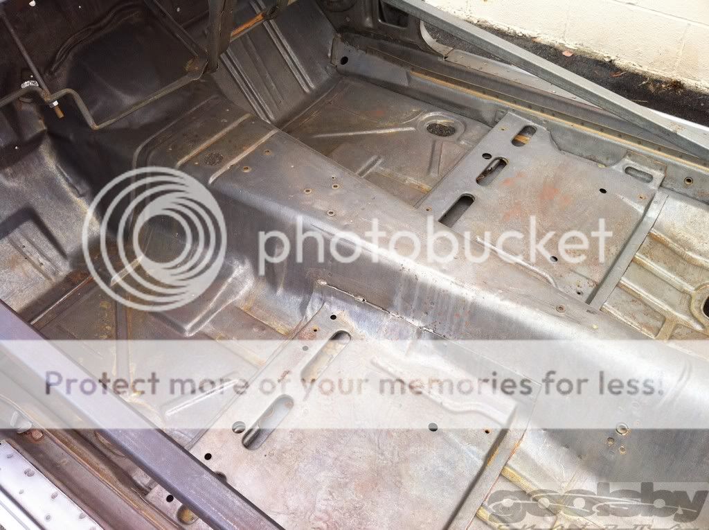

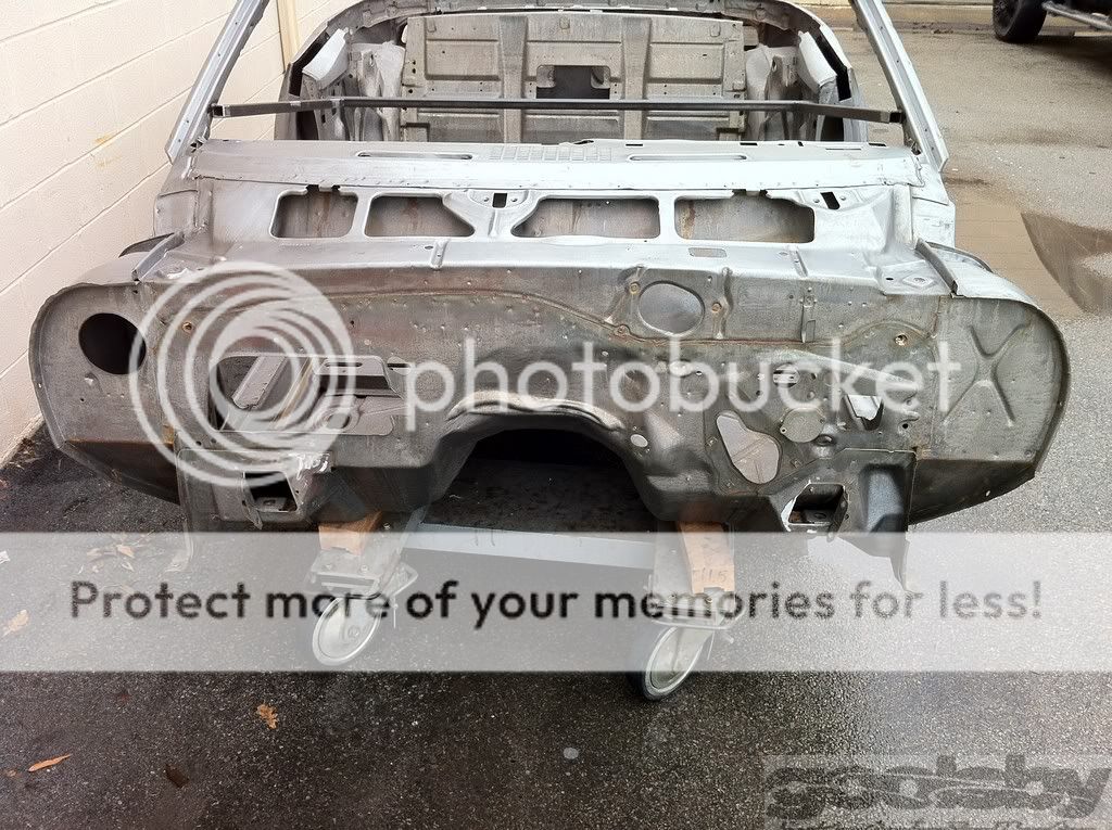

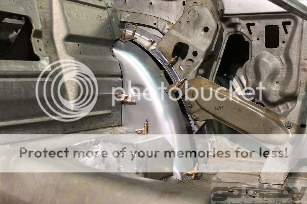

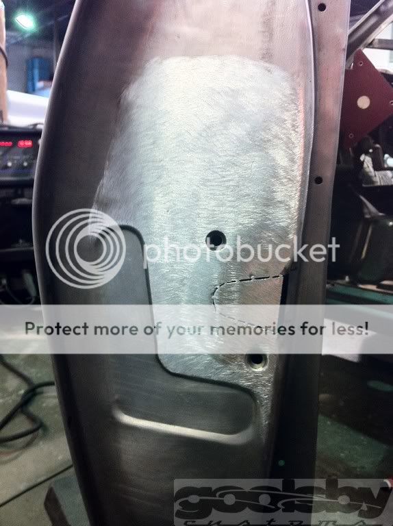

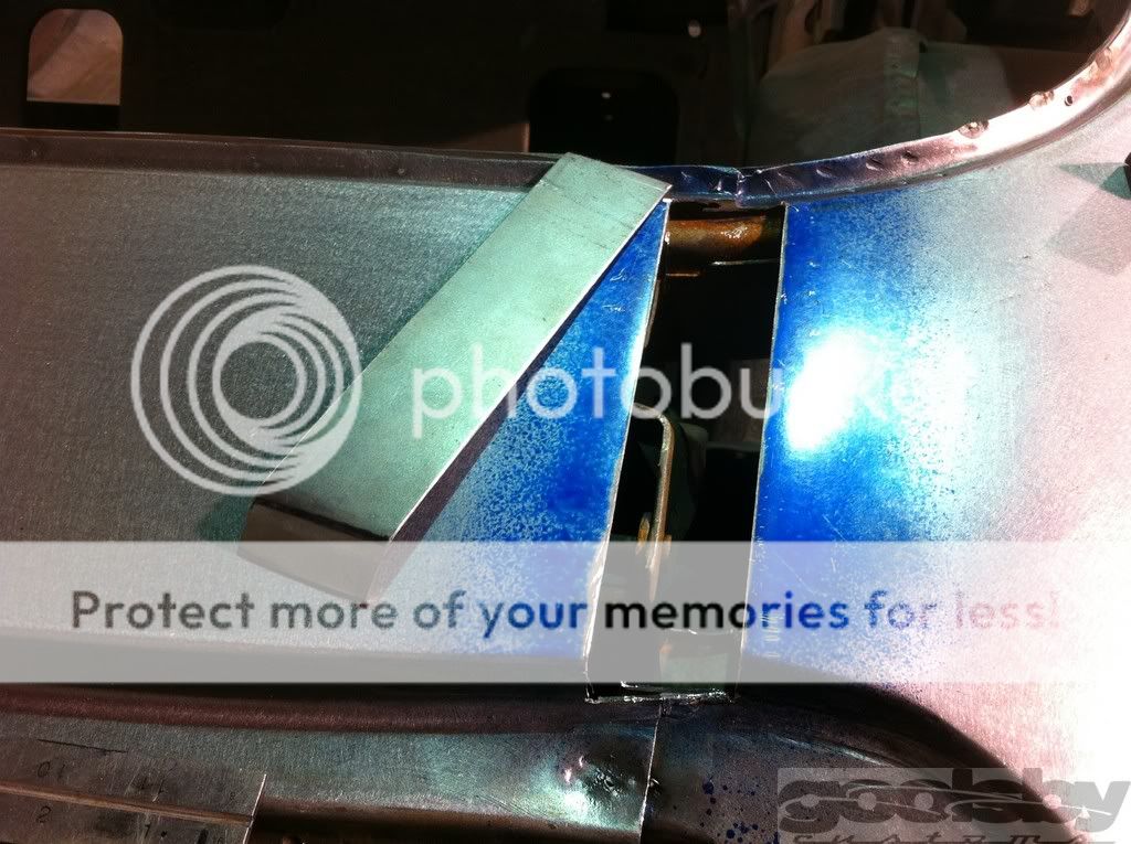

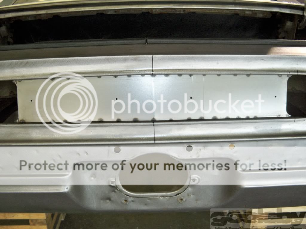

GoolsbyCustoms 12-16-2011 02:48 PM

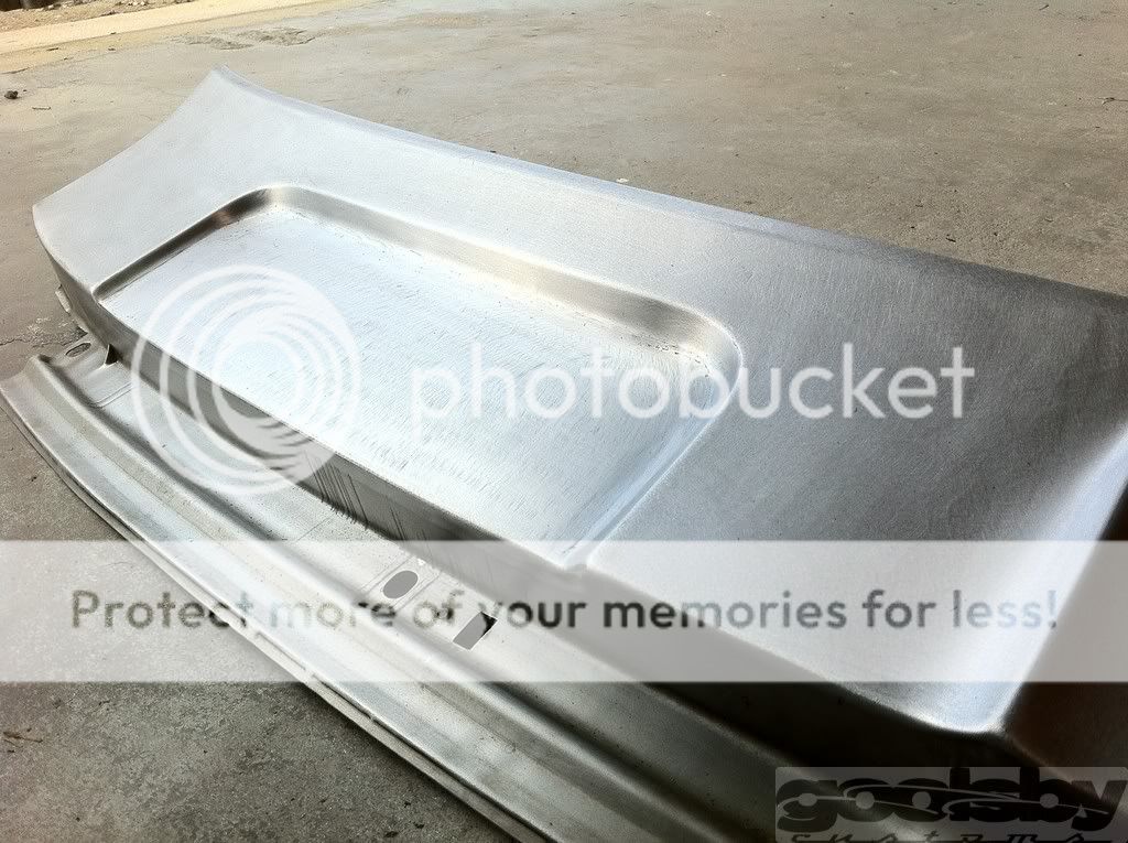

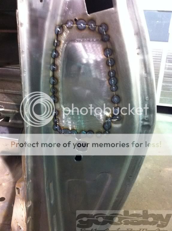

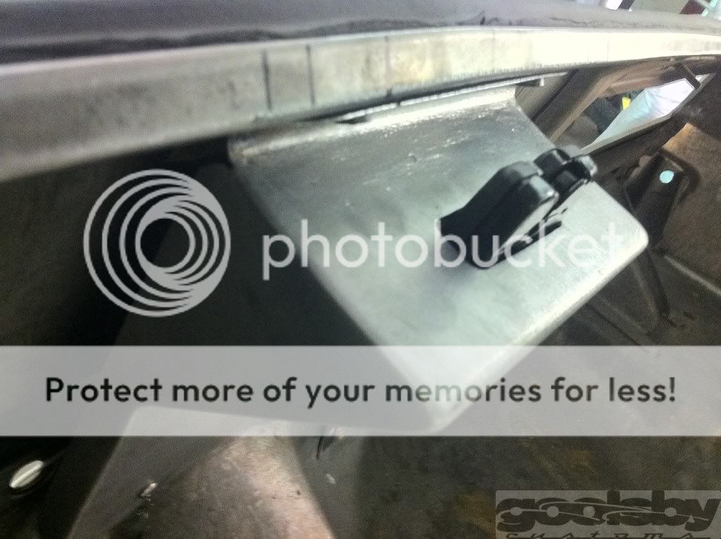

Here is a few that shows some of the cuts needed for the frame , as well as a little patch panel work
http://i767.photobucket.com/albums/x...Image00076.jpg
http://i767.photobucket.com/albums/x...Image00069.jpg
http://i767.photobucket.com/albums/x...Image00083.jpg
http://i767.photobucket.com/albums/x...Image00036.jpg
http://i767.photobucket.com/albums/x...Image00033.jpg
http://i767.photobucket.com/albums/x...Image00032.jpg
http://i767.photobucket.com/albums/x...Image00031.jpg
http://i767.photobucket.com/albums/x...Image00038.jpg
http://i767.photobucket.com/albums/x...Image00037.jpg
http://i767.photobucket.com/albums/x...Image00030.jpg
http://i767.photobucket.com/albums/x...Image00029.jpg
